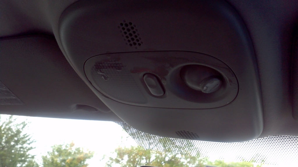

Leaking from inside light
Car  Arctic 182FF
As stated in title. Anyone know what I can do about this?
phase 1 clios leak there due to the aerial being at the front.
As you're phase 2 the only thing that would cause any leak like that would be the sunroof.
I'm sure there's a guide about on how to re-seal the sunroof :)
Mine did this no sunroof no ariel but all i did was peeled top seal and run a bead or silicone down it then pressed down the seal again and its not let a single drop in since
Should've mentioned that it's a phase 2. Which is it more likely to be, sunroof or top seal? Thanks
I have this exact problem (ph2), the water sloshes all over me or my passengers when going around corners. I also have a strange drip the turns up after much rain, its from the headlining by the bottom right side of the drivers sun visor. My top seal...if I'm talking about the right part, is sort of wonky, could be this?
yupp lol, i found out yeasterday mines leaking. had it dripping on me from the drivers sunvisor area. could see the wet patch from pillar to interior light
