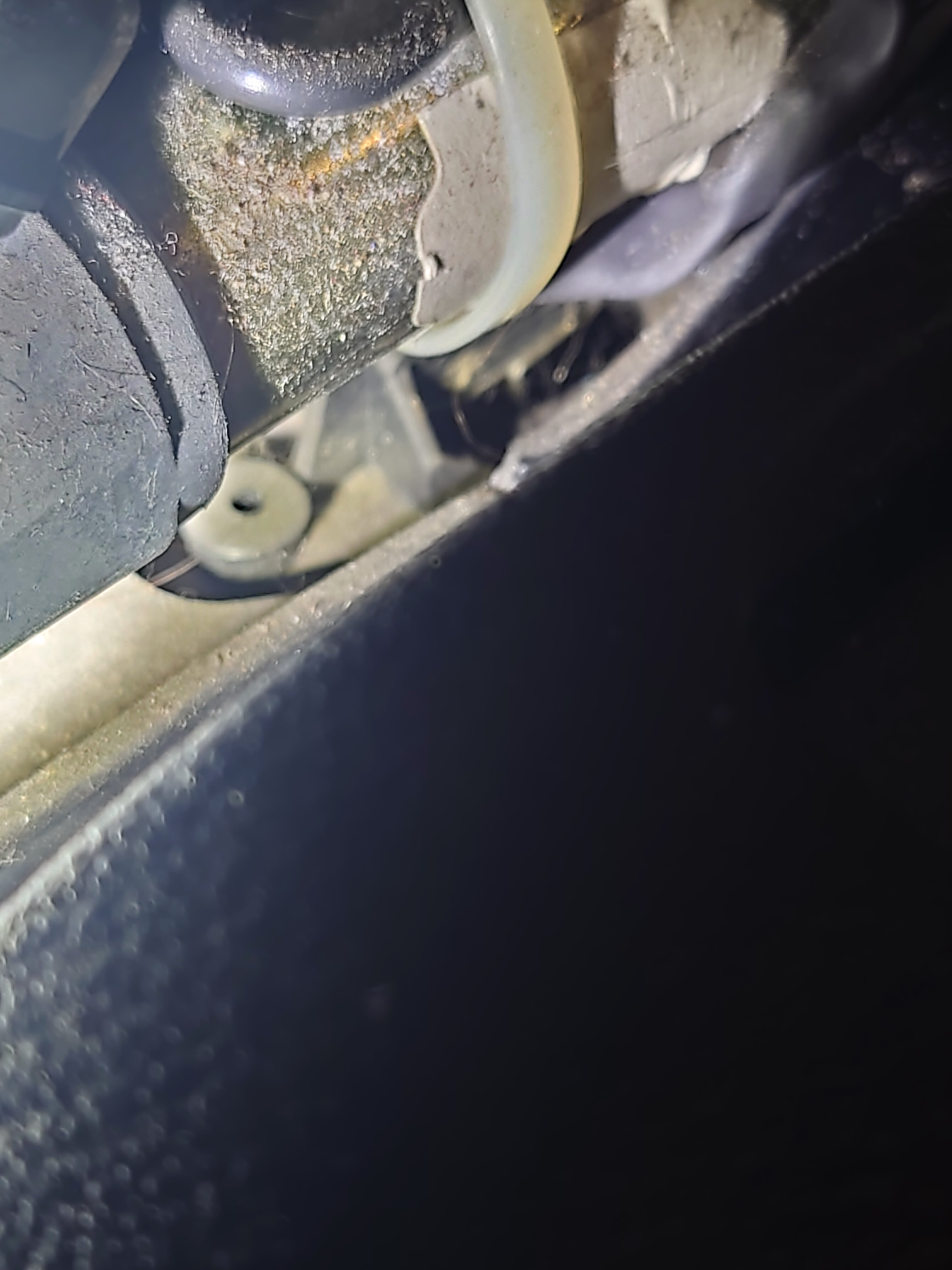

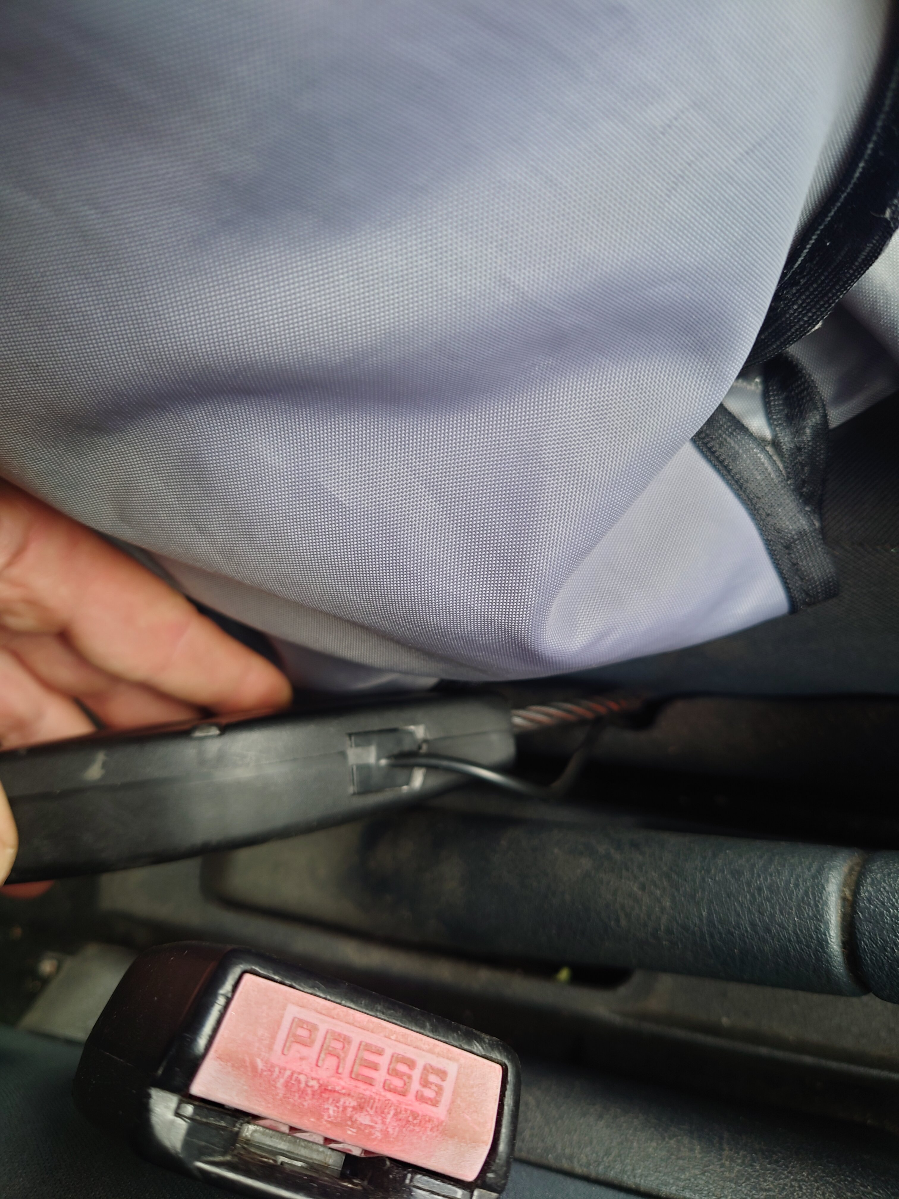

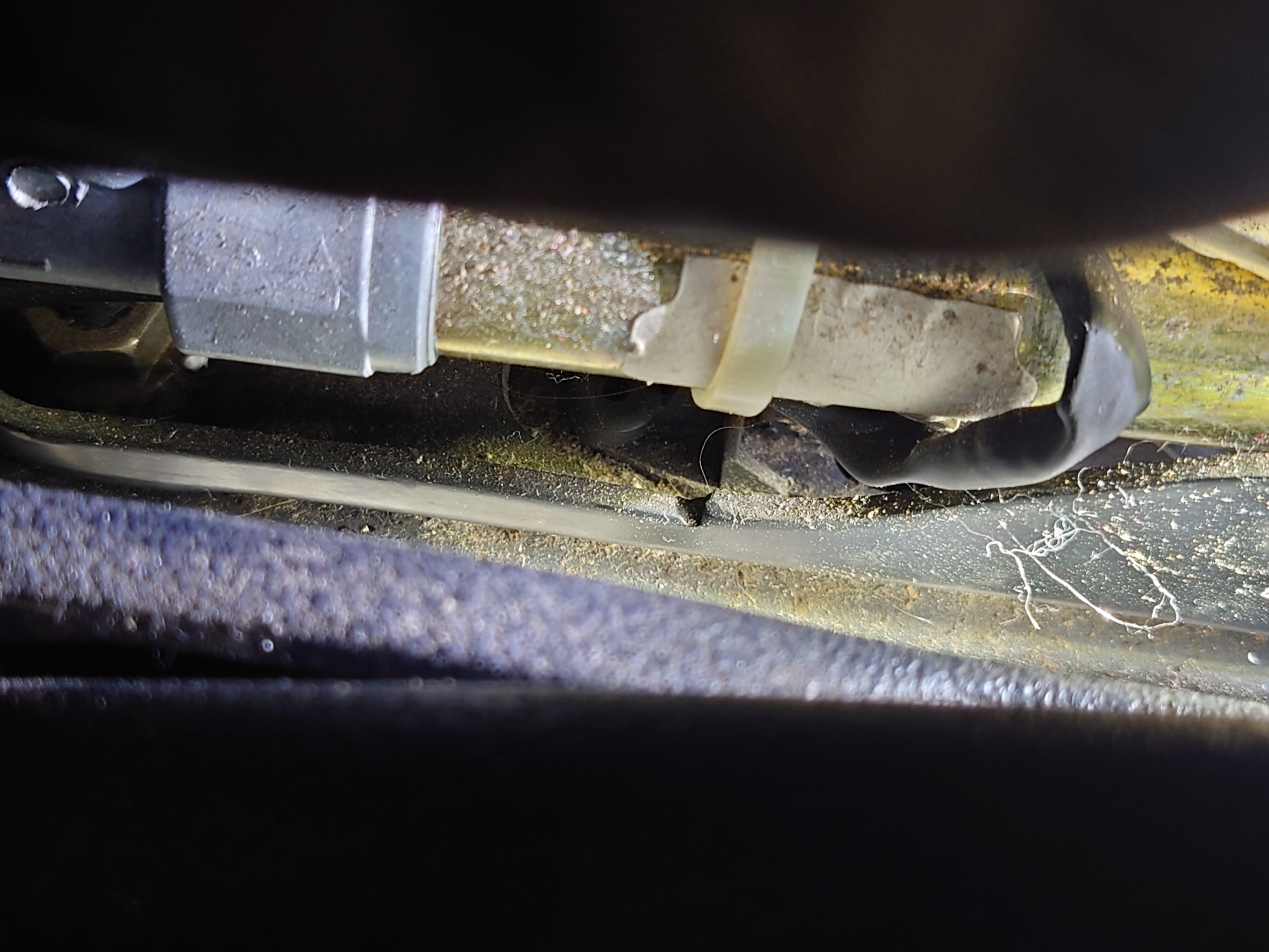

There s nothing attached to the seat rails , see if you got those wires connected to your seat belt stalk im thinking theres a switch inside , i will take mine appart but a bit later...
Hi

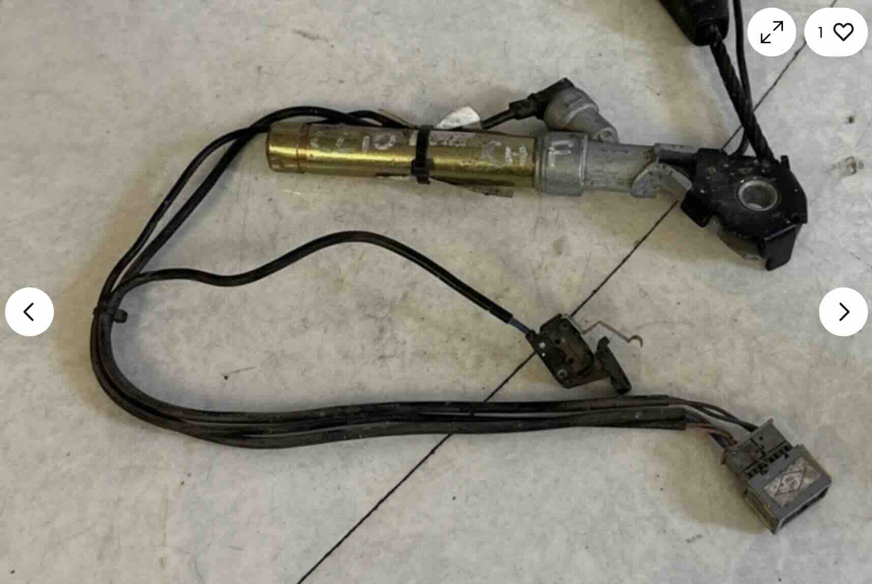

Thanks for the pic, I have a cable running to my seatbelt and the light goes out once depressed. What I'll do is put a pic up of the whole pre-tensioner to see if it jogs anyone's memory.

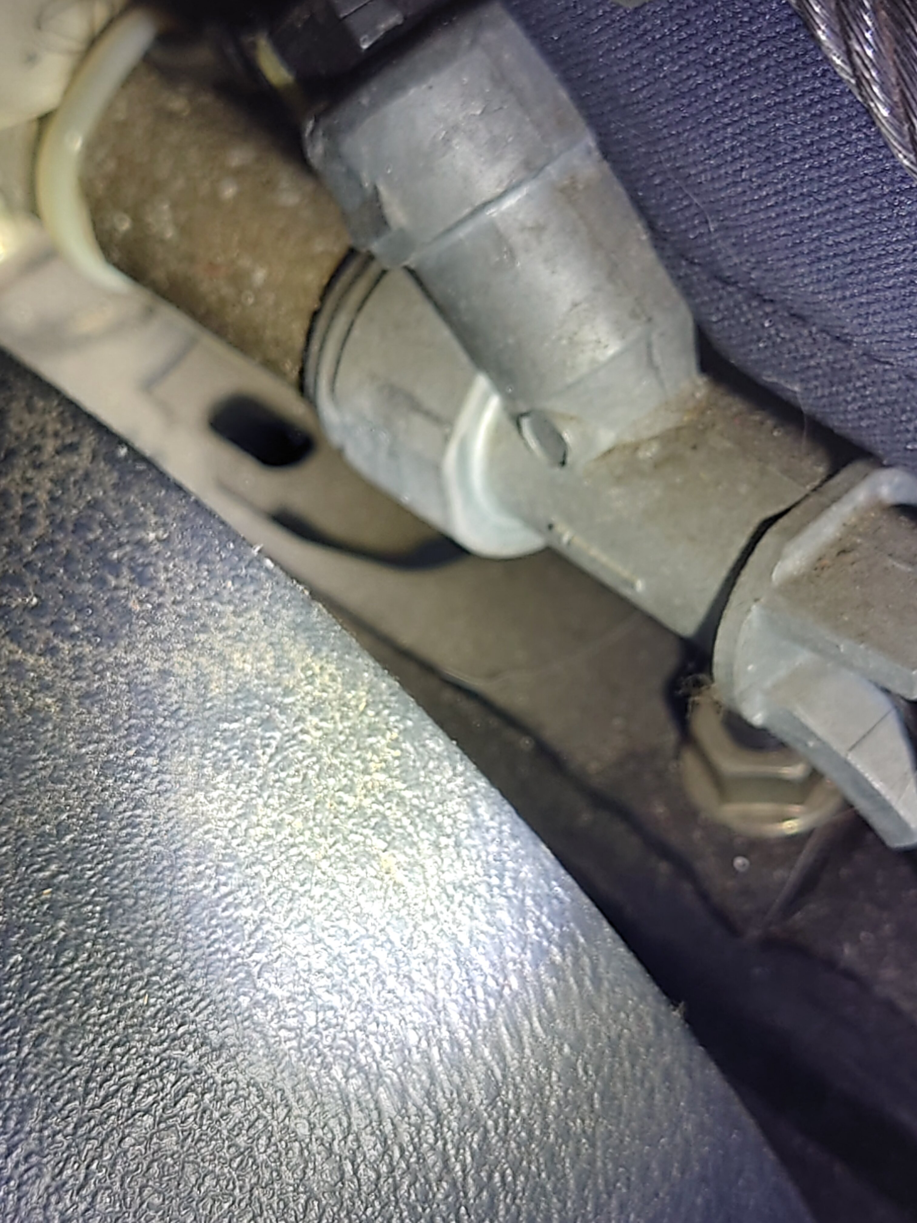

Im at work doing a dash issue , after i finish that i will get my car in and have a look at it , you made me curious 🤔
That sensor sits on the seat rail under the pre tensioner when is bolted down

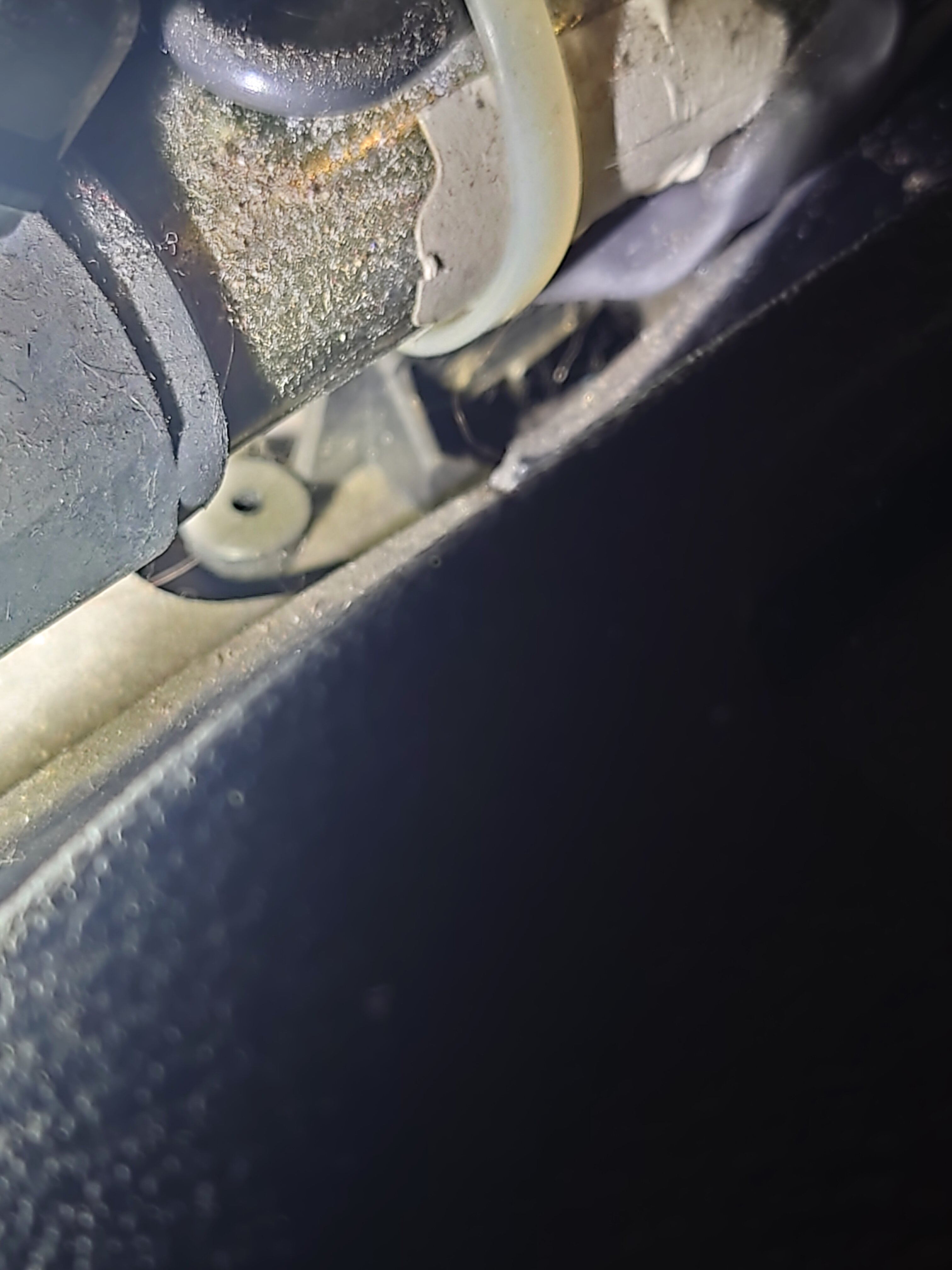

Thanks for this although I can't quite see the switch. Is this something one can plug in with the seat in situ or best to remove in order to get some space do you think?
better if you remove it , possibly you need to get the seat rail off , that switch has a plastic clip that holds the switch to the actual rail

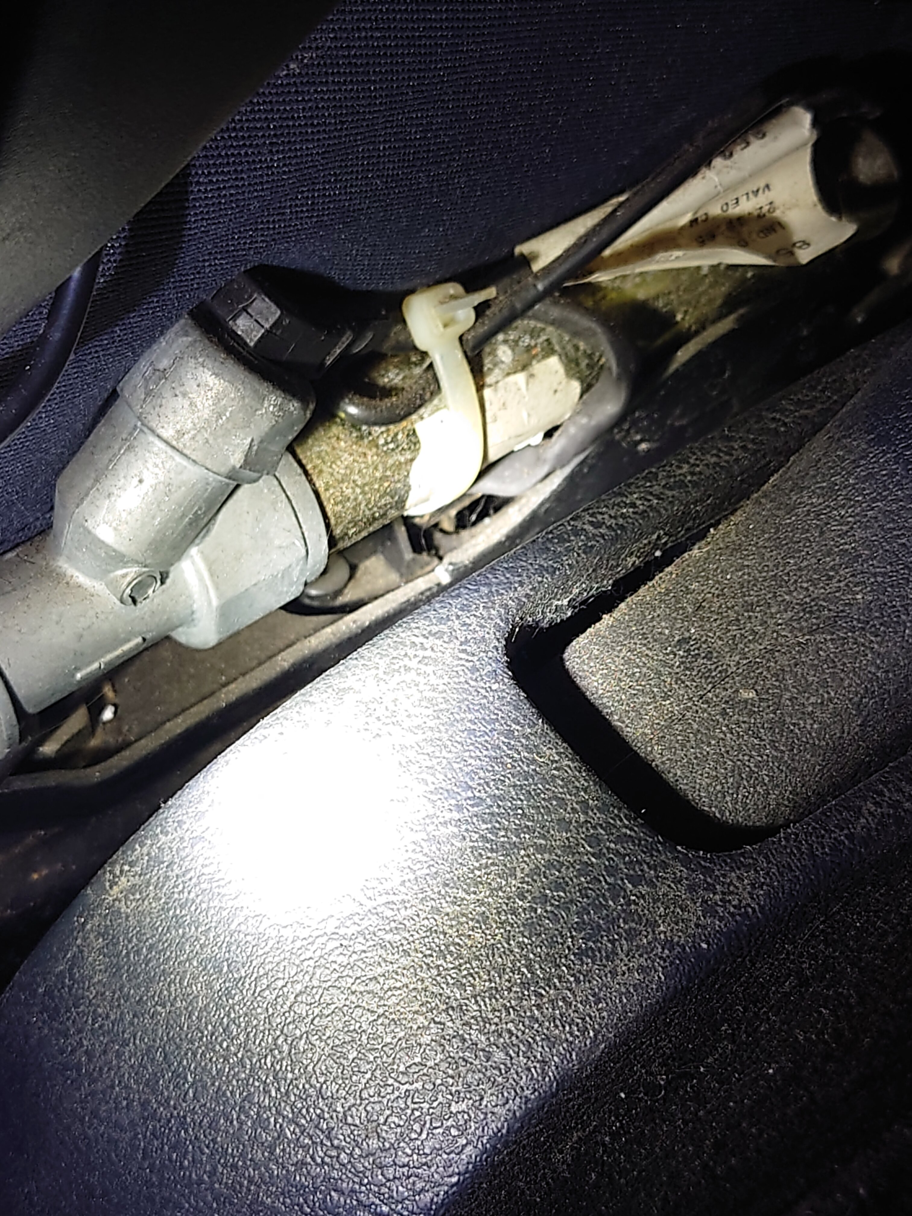

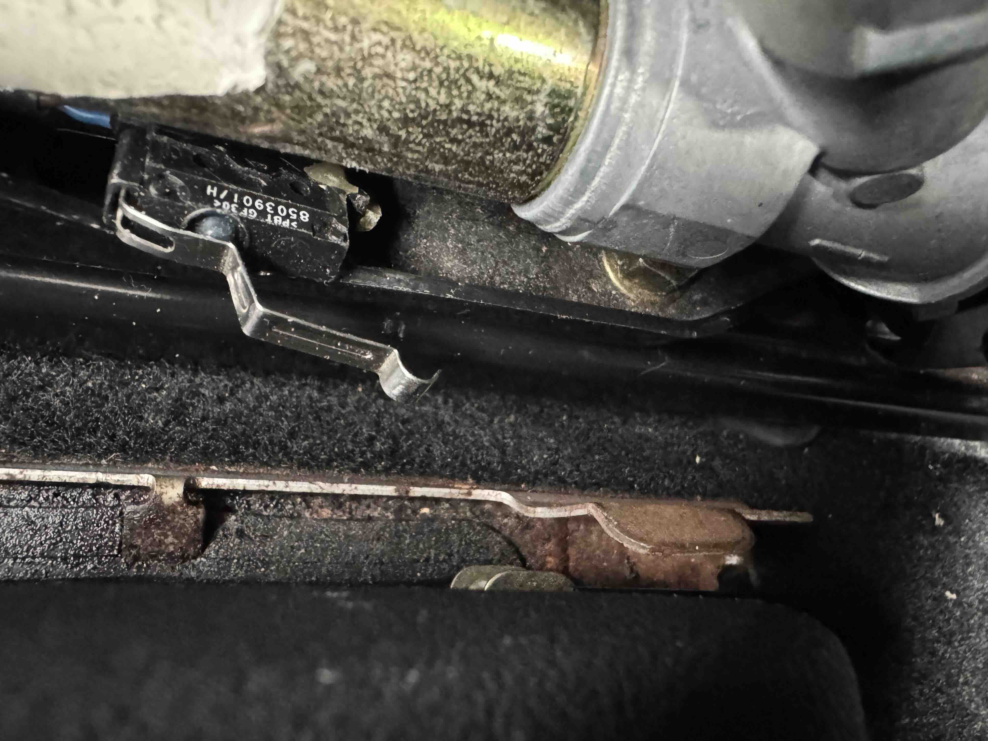

The seat rail is made of 2 parts upper and lower one , this switch sits on outside of upper part with that metal bracket touching the lower seat rail , the lower seat rail has some small dents where the round parts of that metal bracket rest when you move the seat forward or backward . The upper part of seat rail should be a hole where this switch needs to go in , regarding wires they are just put as best as they can be as long they don t touch anything in there . If you remove the seat from seat rails i think is easy to see where everything goes in i know it a seat out but hopefully fixes your issue .

This is brilliant, thanks so much. I'll try looking in that space of my Clio too. I'll let you know, thanks again!

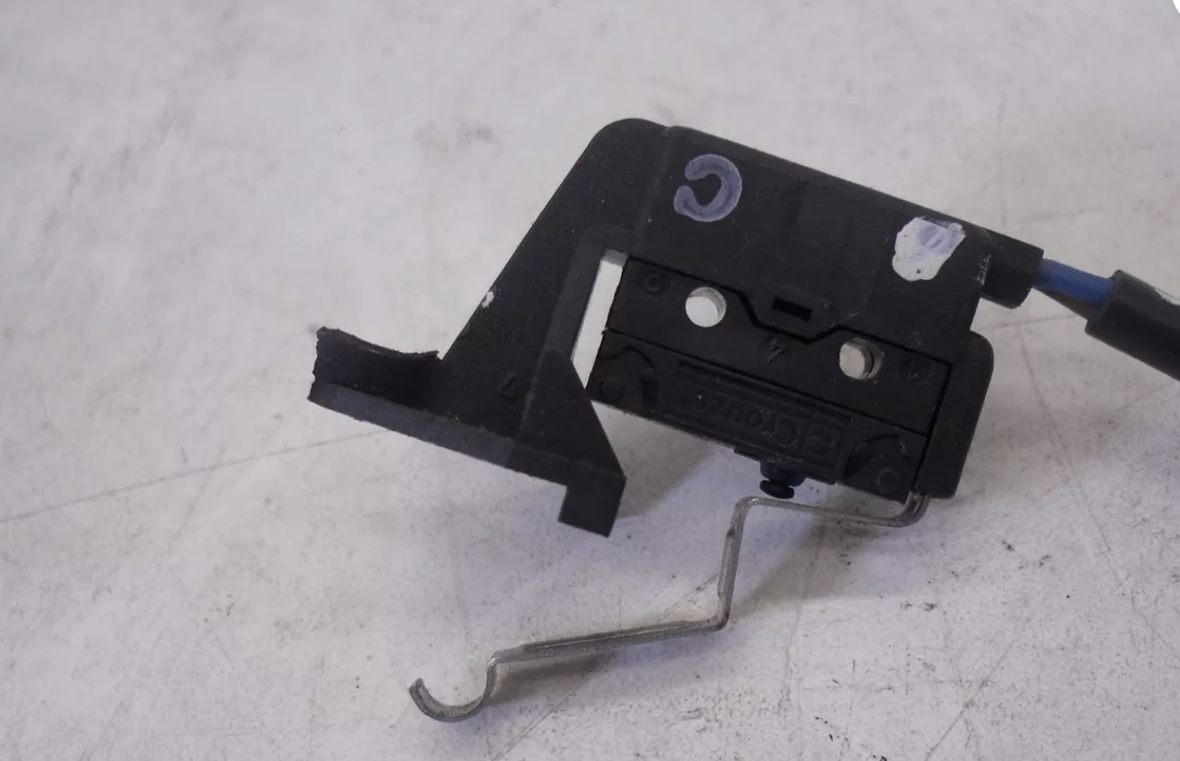

I've found out where it goes but unsure where the little metal clip with the groove on clips into. Does the whole clip stand upright or go in on it's side? Space is very cramped and I can't quite see in the photo's. Thanks
I think that metal clip goes inside , the lower seat rail has some tiny holes spaced at a certain distance, that what i see on my car .
