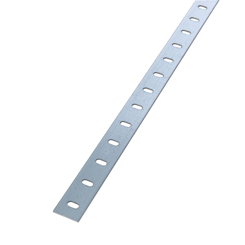

Might have to use something like this

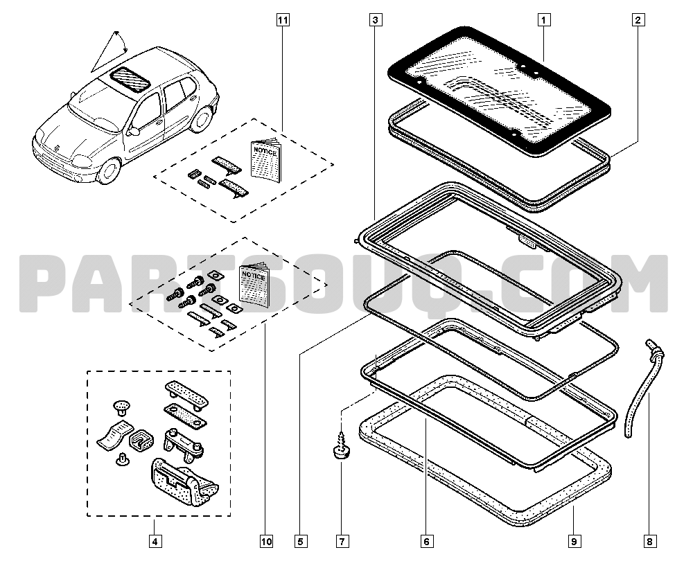

Part no 6: 7701045041

PartSouq Link for image and part numbers
  Clio
Thanks but it's not shown on that. The screws (#7 in diagram) go through it before fastening into (#6). It's like a 30cm section of this link below, only with holes for the screws. I prob will just end up rust treating it, if there's enough of it left.
  Clio
Sorry, you are indeed correct. I first looked at it in the dark with a torch and thought it was a separate piece but it is #6.
Just alot of surface rust and very orange, but it isn't as bad as I thought. Will probably just clean it off and rust treat it when I do the job. Thanks.

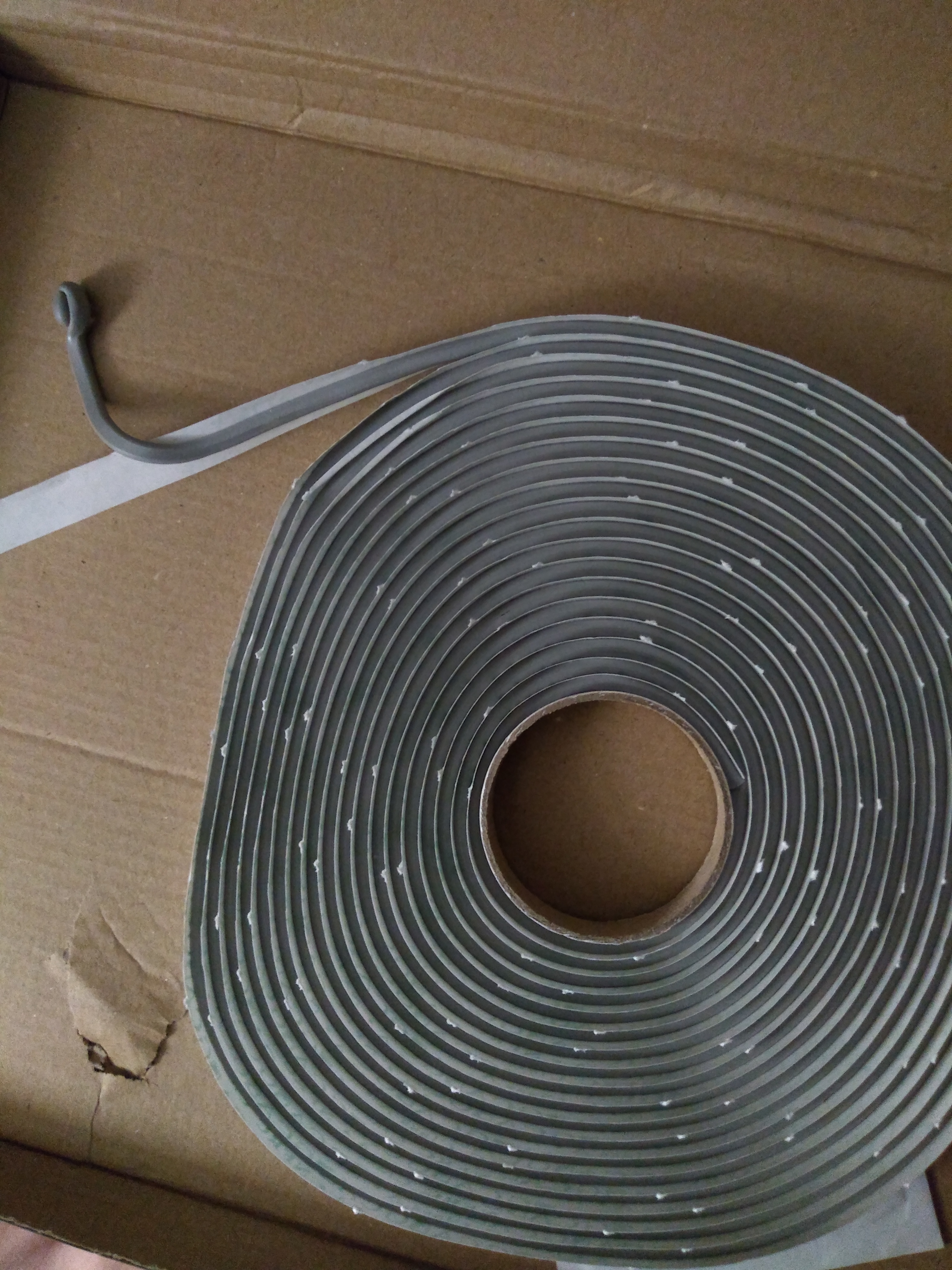

I'd already ordered some butyl rubber, and read it's perfect for the job.

The butyl rubber is great, like plasticine and forms a great seal, and if it every has to be removed it doesn't create a mess like silicone.

You'll want butyl tape like the below, that's what people recommend for the door seals and the sunroof will be similar.
  Clio
I used 3mm butyl round cord from eBay but it's available on Amazon too, and bought Amazon basics ratchet spanner set, I can't remember but I think it was the 13mm but better to buy the set.
