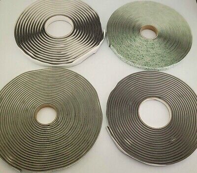

  Clio
For anyone else looking 4mm butyl mastic has been recommended on various forums
