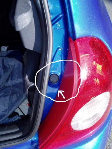

It will be the little grommets by the rear clusters common problem i sealed mine
Gromits - 99.9%..
Take the gromits out, clean the painted surface and then put a ring of tigerseal or something similar on there on the outside surface and squeeze them back in so no water can now .
That's all I did and I went from having a lake in the boot quite literally inches deep (how the previous owner didn't realise I'll never know.........) to being completely dry in there all winter.

mine had water under the back seat.. coming in from the black gromit things.. i got black water proof sealant from halfords.. never leaked since.
