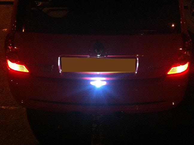

I see there are a few posts regarding led boot lights, but none actually say exactly which led bulb to get.
can anyone link me up or give me the name of what I need?7
I want one for the clio and the grand scenic
cheers
MarcB
  Too Many

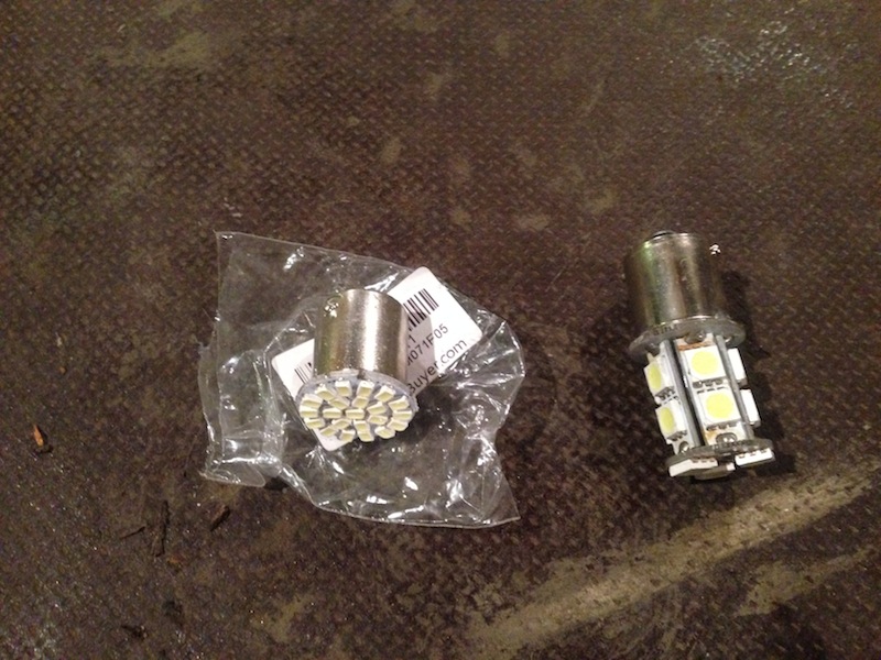

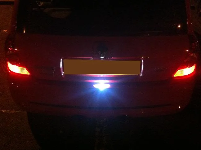

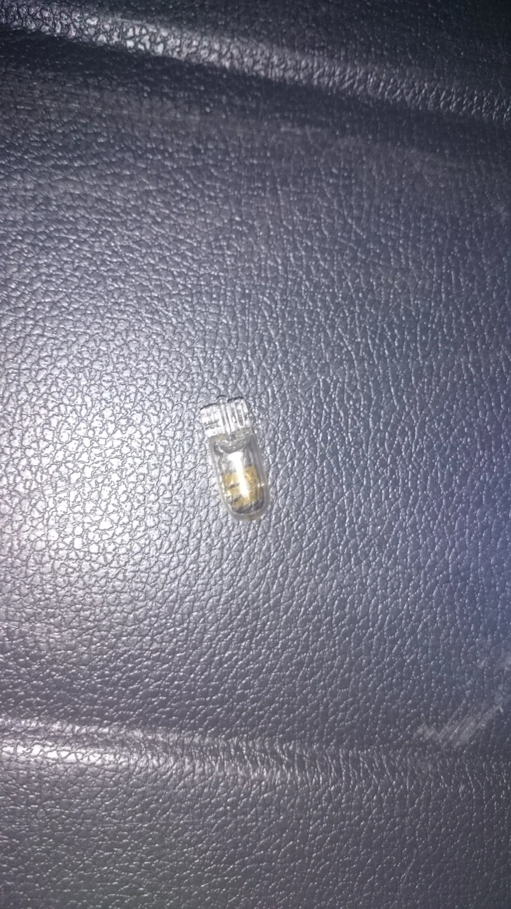

Im using these for the clio - http://www.ebay.co.uk/itm/2-x-1156-...662?pt=LH_DefaultDomain_3&hash=item2c96c5fc86
McGherkin
Macca fan boiiiii
Yeah, that'd do.

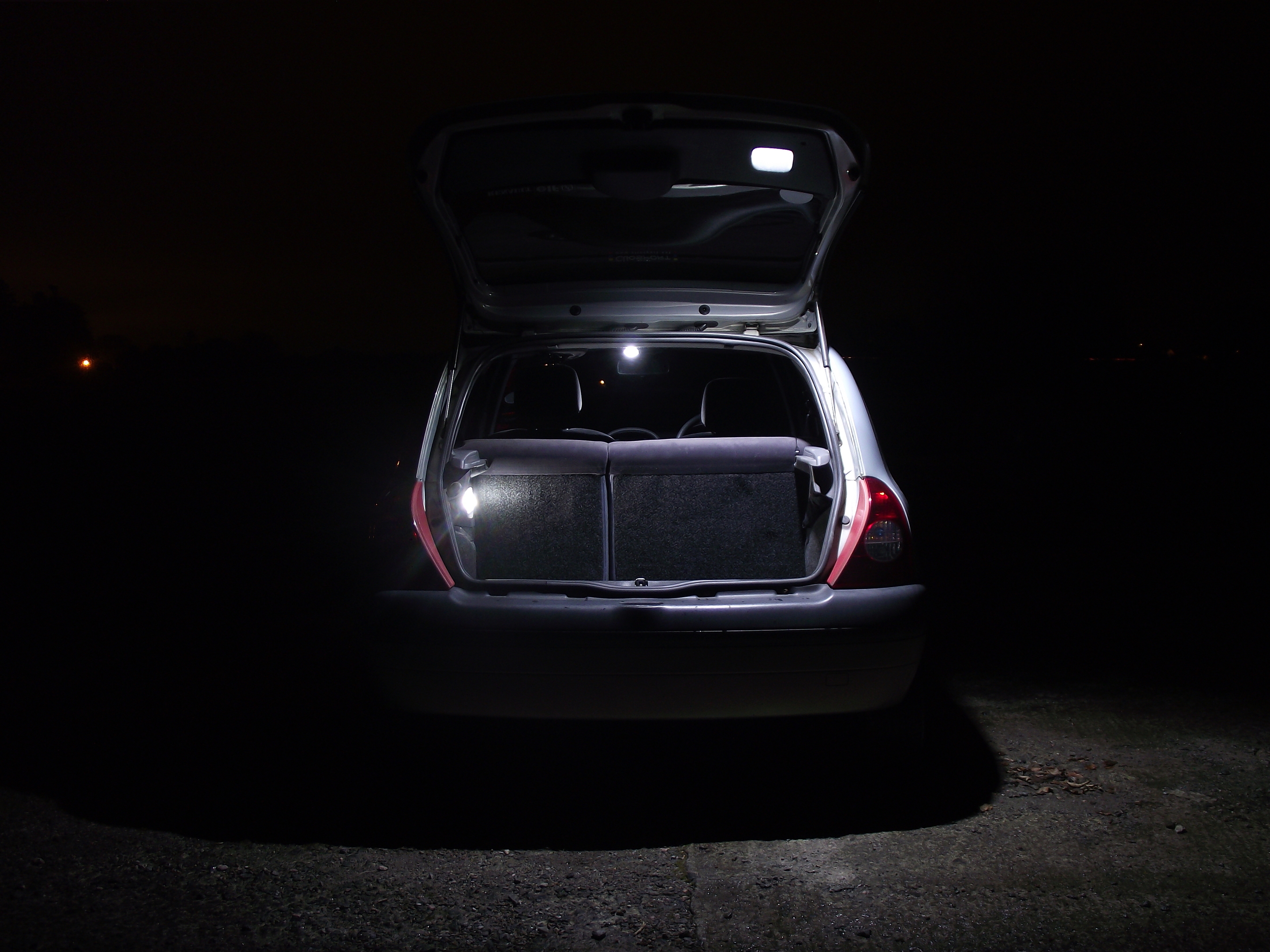

Of course, you could go totally overboard and add a handle light. The standard light is piss poor so this is a huge improvement.
  '20 Zoe, '09 V70
sweet cheers
As well, just to let you know that's the same bulb used in the Clio interior courtesy light, both sides. :up: I swapped my boot and interior lights for LEDs as well.
Ruined within a week mind, my sunroof developed a catastrophic leak on the wettest week of the year...:angry:
McGherkin
Macca fan boiiiii
It's an SMD panel glued in place, and power's tapped off the boot light. Basically bootlid trim off, drill a hole in the bottom of the handle for the wire, run the wires up the side of the boot lid and through the top rubber connections, then down to the left C-pillar and into the boot light. Glue SMD panel into the bottom of the handle (it sits nicely in there, not where you would hit it with your hand), and job's a goodun.
