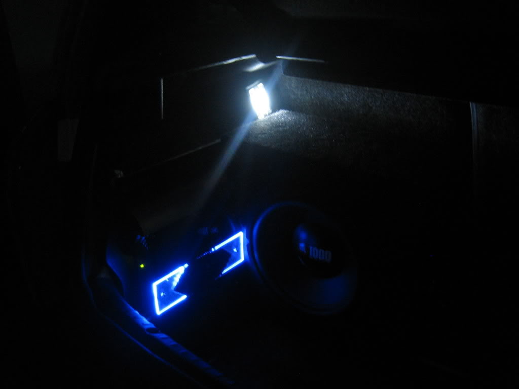

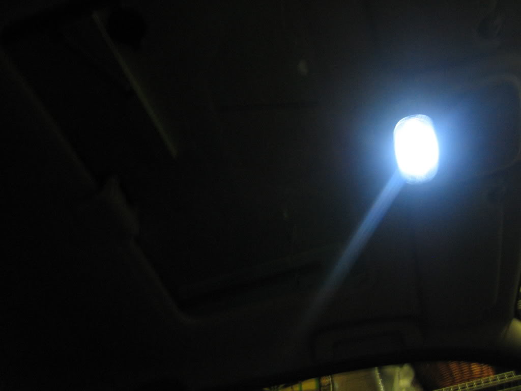

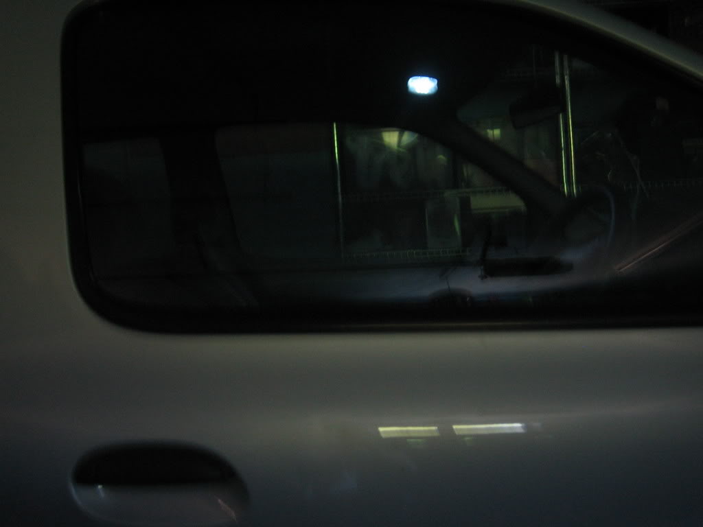

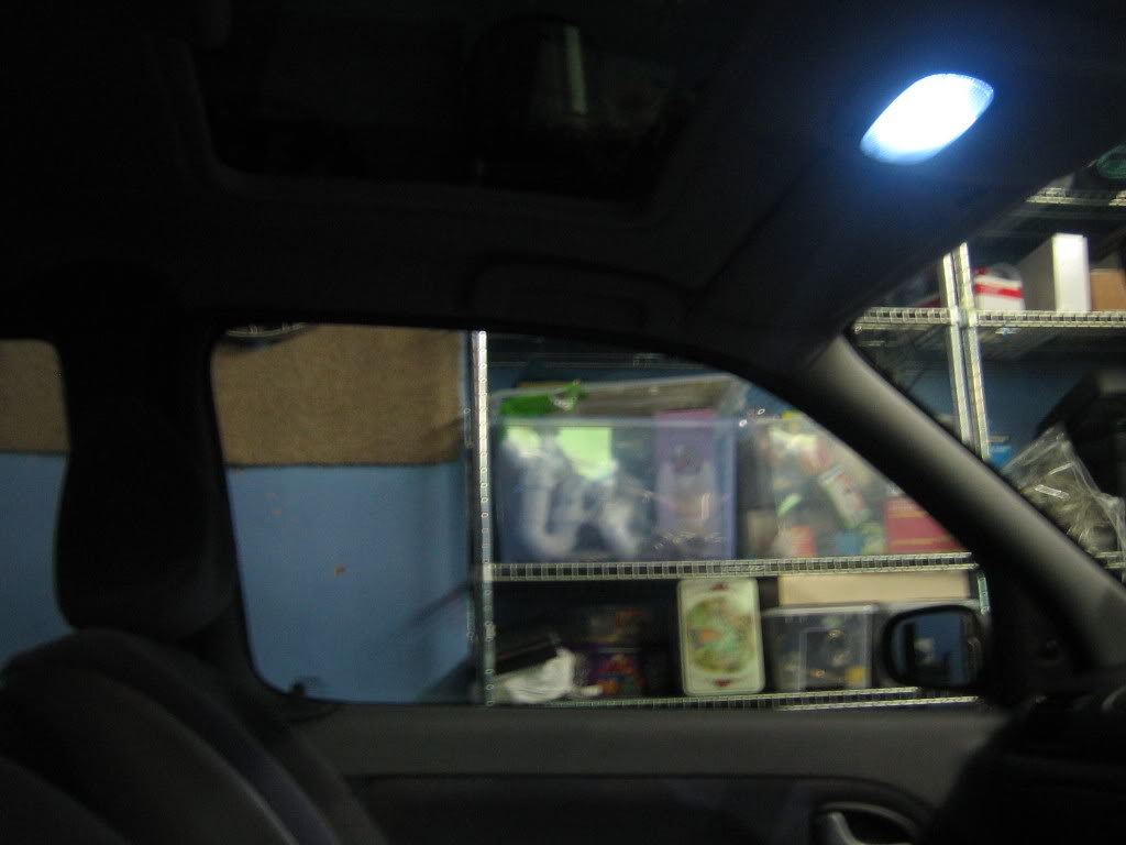

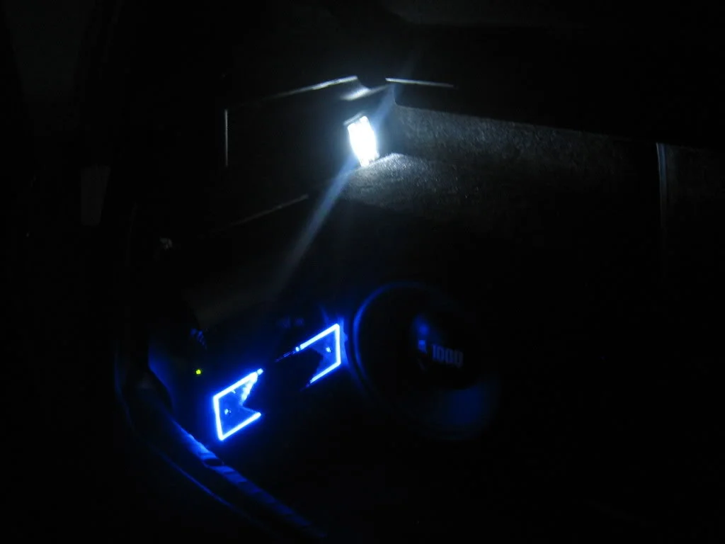

ill take pics now
Its dark near you?
Kind of in my garage!
Not really great pics but you get the idea. they are much brighter and fill the whole cabin with a bright white light when it is really dark but the camera doesnt really pick this up
