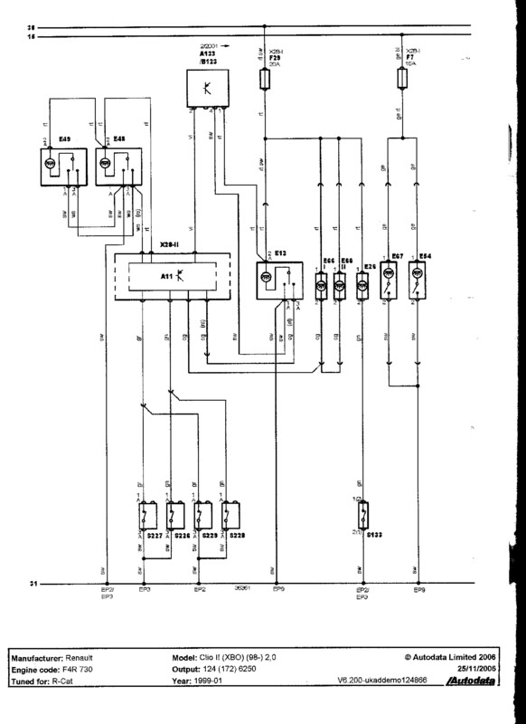

Cheers Brian, it was a 1n4001 50v 1A diode rectifier. The session has timed out now though. Looking at that wiring diagram, E12 is the light correct and the U/S module is A123/B123? And the linked cable is the source of the trickle back?
