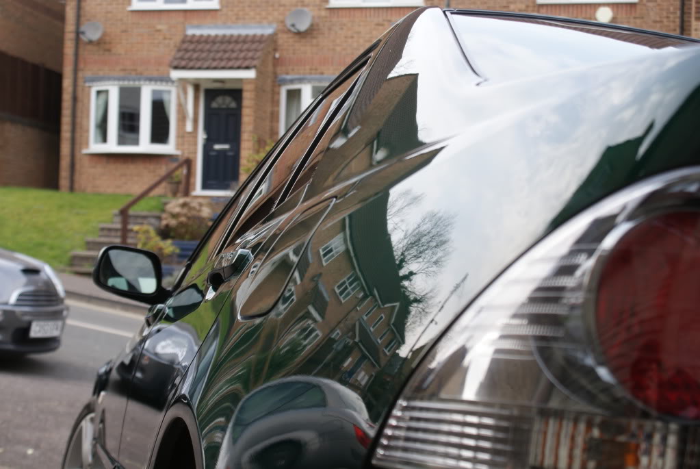

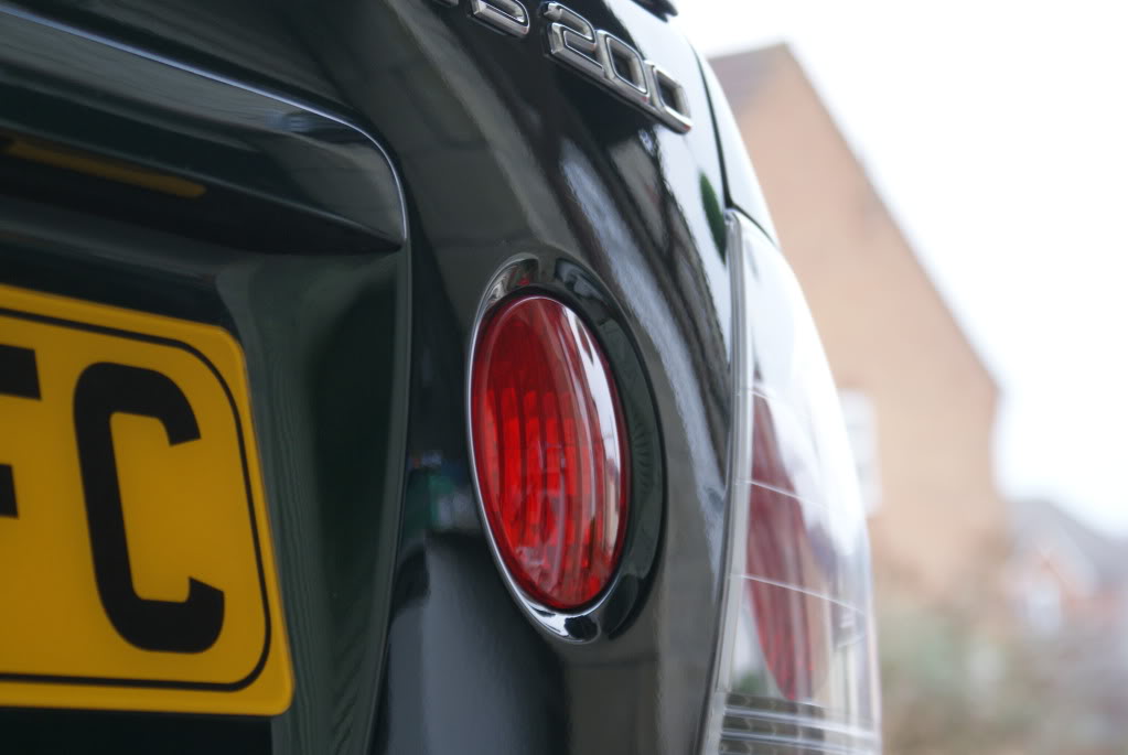

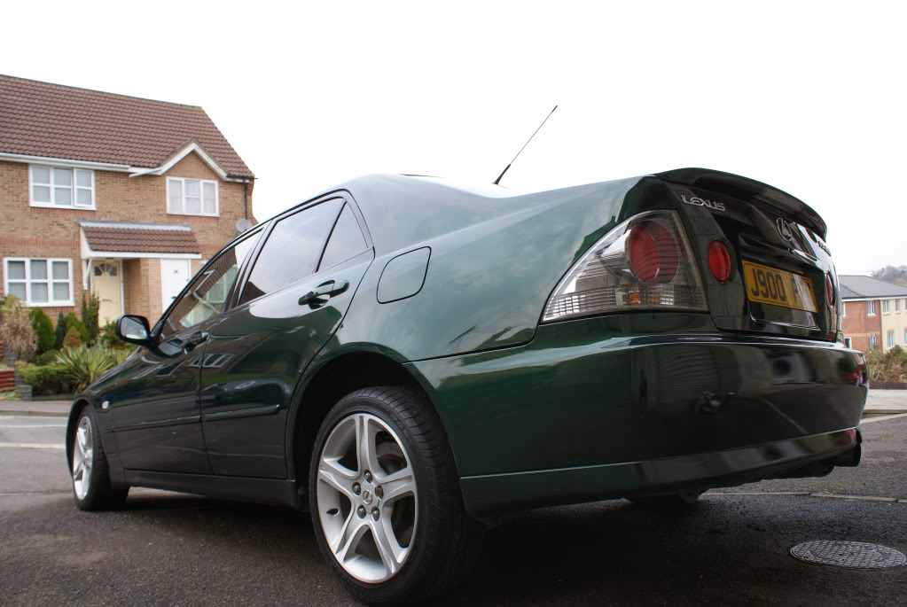

A friend of mine popped round the other day while i was doing GTI6Steve's Clio, he loved the difference in shine to the paintwork etc and so had been begging me to have his Lexus for the day.
Last weekend he dropped it off for me early in the morning and to be honest it wasn't in as bad a state as he described, after the snow foam and good wash it was looking good already.
Anyway set about getting to work ....

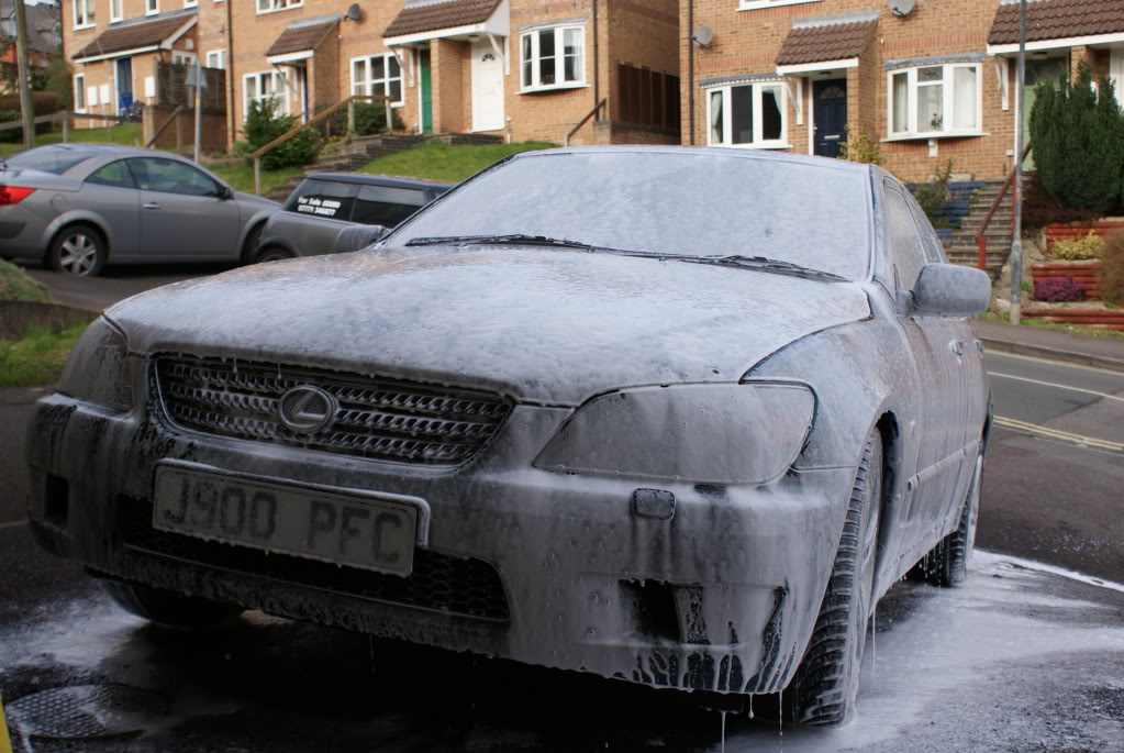

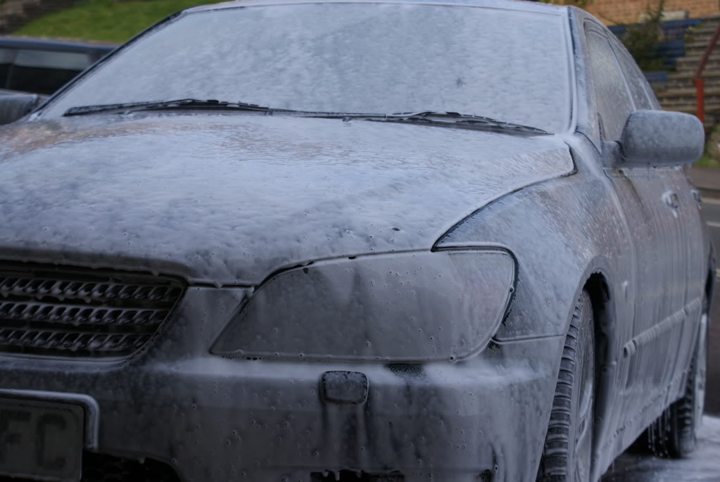

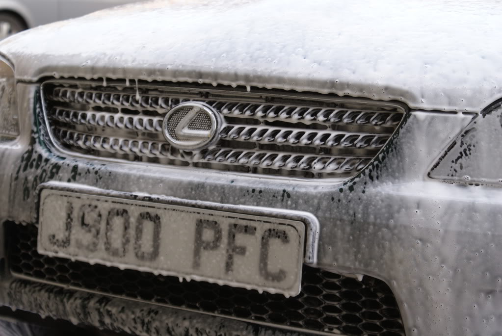

Pressure washed
Snow foam applied and left to dwell while i agitated dirt around the badges etc
Pressure washed off

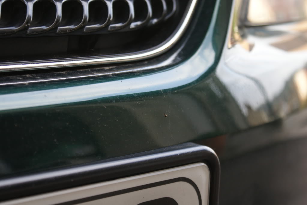

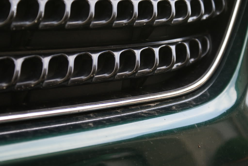

Visible Tar spots removed using AG Tar & Glue remover (Not the greatest stuff but aquired from this friend).
Washed using two bucket method with Megs Shampoo plus & sheepskin mitt
Rinsed down
Cleaned door shuts

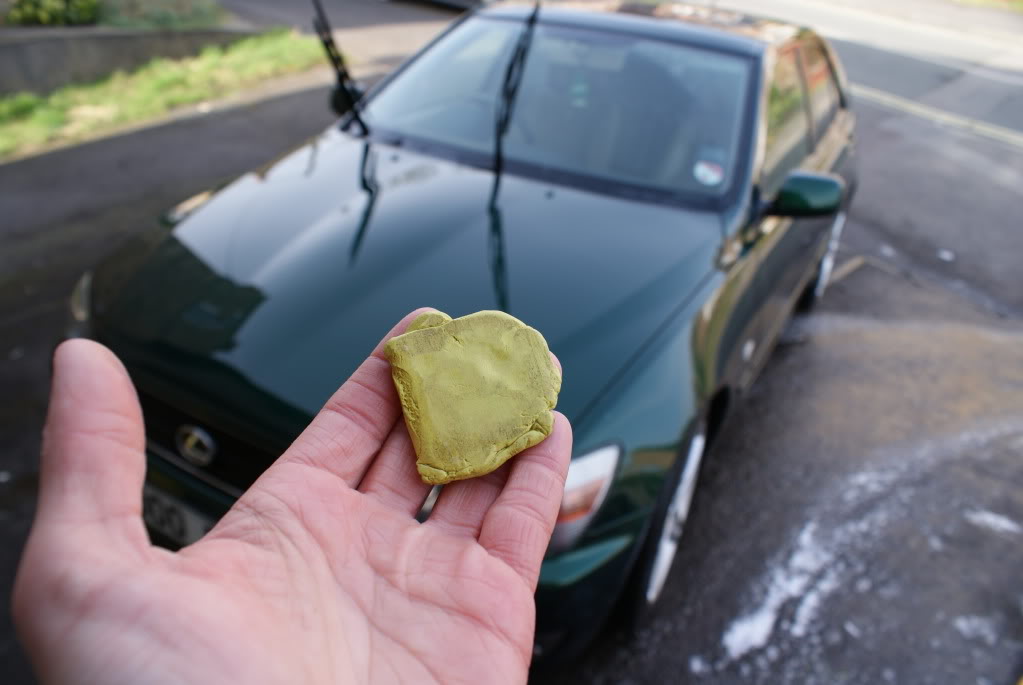

Clayed using Elite mild Grade Clay bar and lubricated using DJ Born Slippy - rinsed down after each panel
Re-Washed
Rinsed using open hose to sheet
Dried using the i4detailing uber blue drying towel
Normally at this point i would make a start on the interior while the exterior fully dries but he said not to bother as his interior was pretty much in mint condition.
Interior Glass cleaned/Polished with AG Glass Cleaner (Love the smell of this stuff).

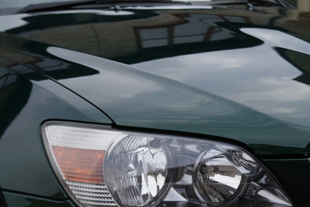

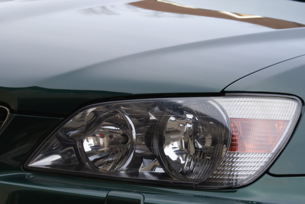

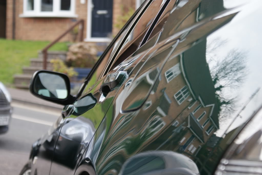

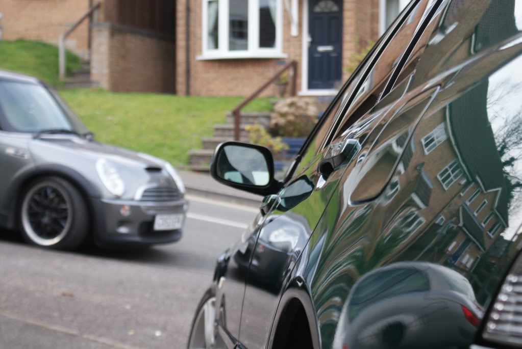

Dodo Jucie LP applied by Das-6 using Menzerna Finishing 135mm & spot pads.
Harly Wax applied
Exterior Glass cleaned using 3M Glass Cleaner
Plastics & Rubber treated with AG Vinyl & Rubber Care - running out of this so am looking to try something new
Exhaust clean/polished with Autosol after i removed all the crap on it with the use if some wire wool

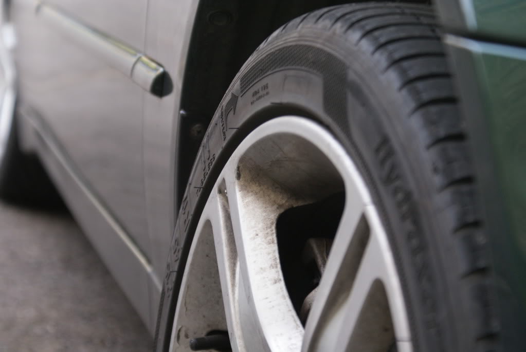

Tyres treated with Chemical Guys Tyre Gel - have tried a couple of others but always come back to this stuff
When he came to pick it up he said immediately that "its a different colour" lol
(Just to point out to any hawks that notice, his wheels are being refurbed soon so didn't go mad on these);).

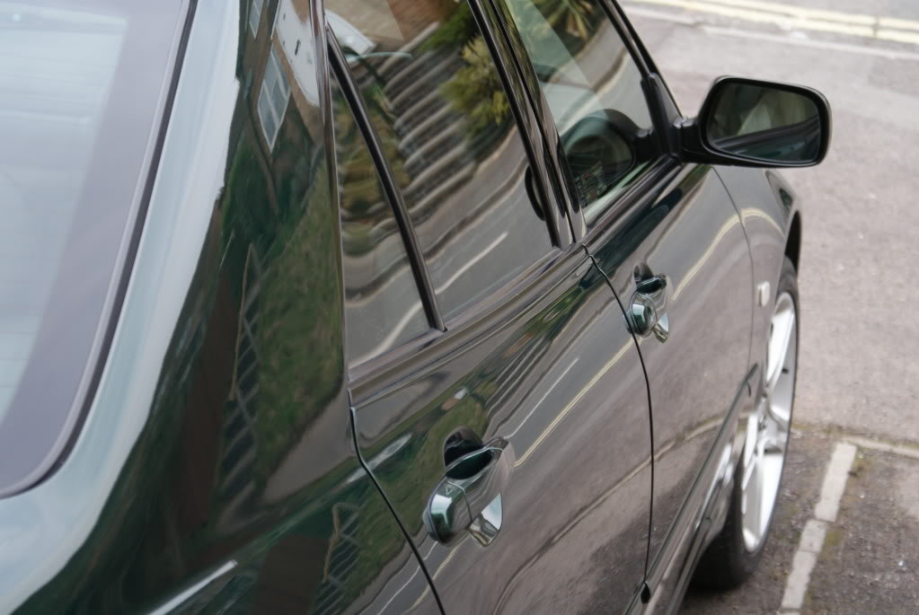

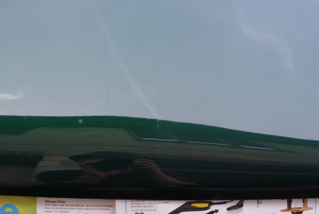

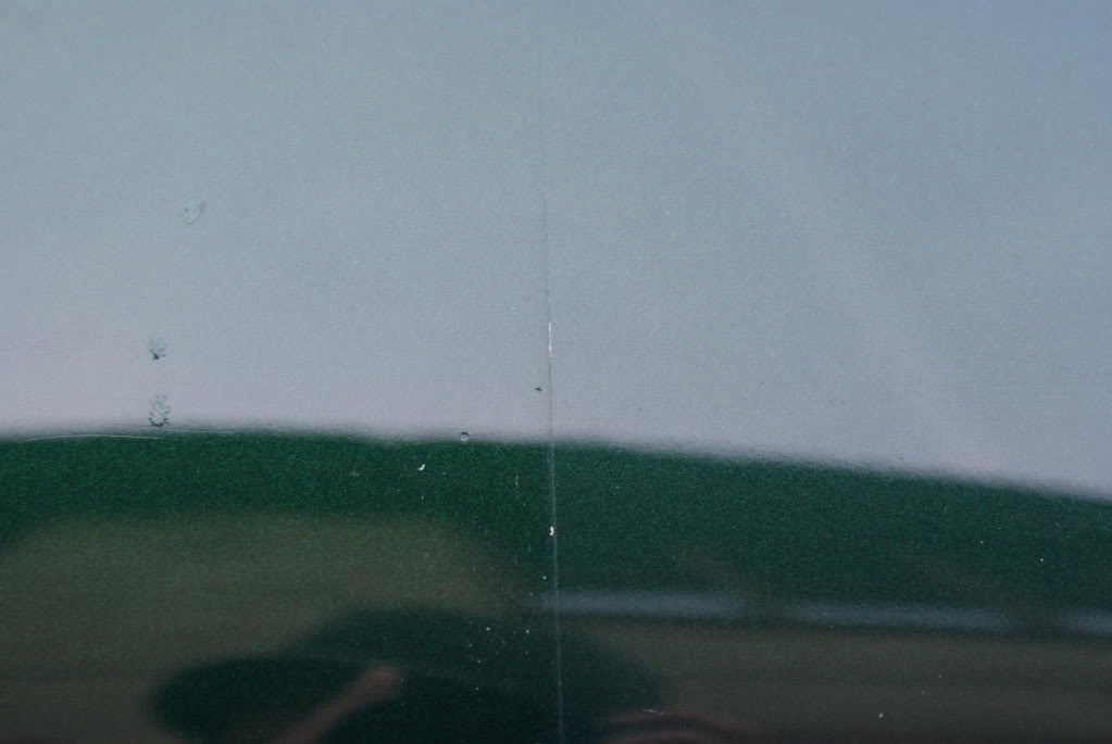

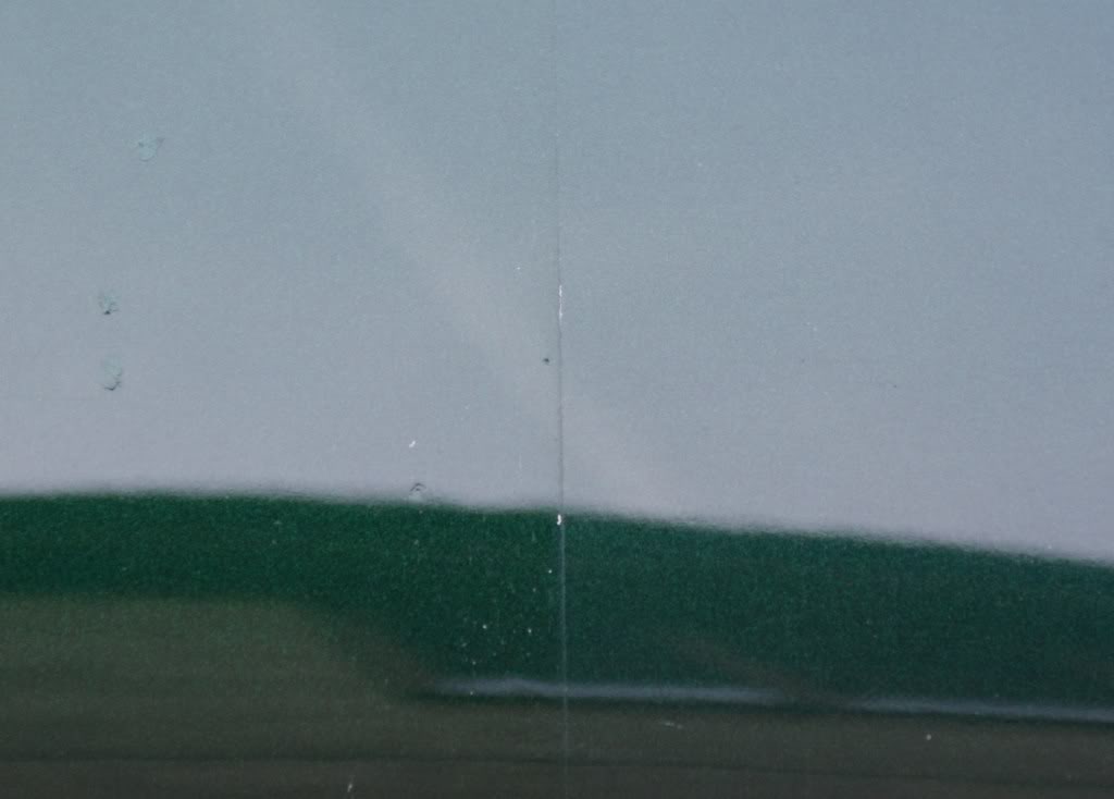

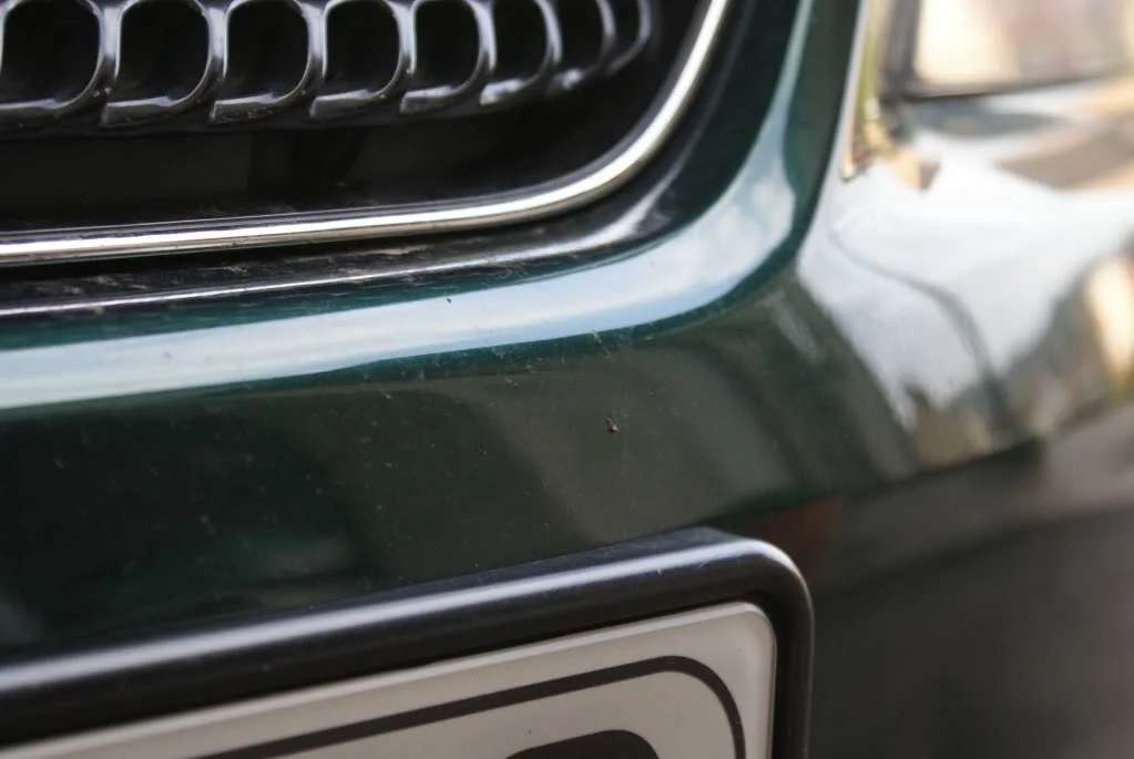

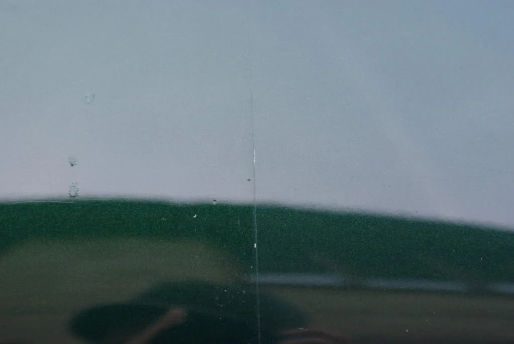

^ no not really, few spots with some nasty scratches that required a bit of attention but not alot more than that. Amazed how well LP works on minor swirling.

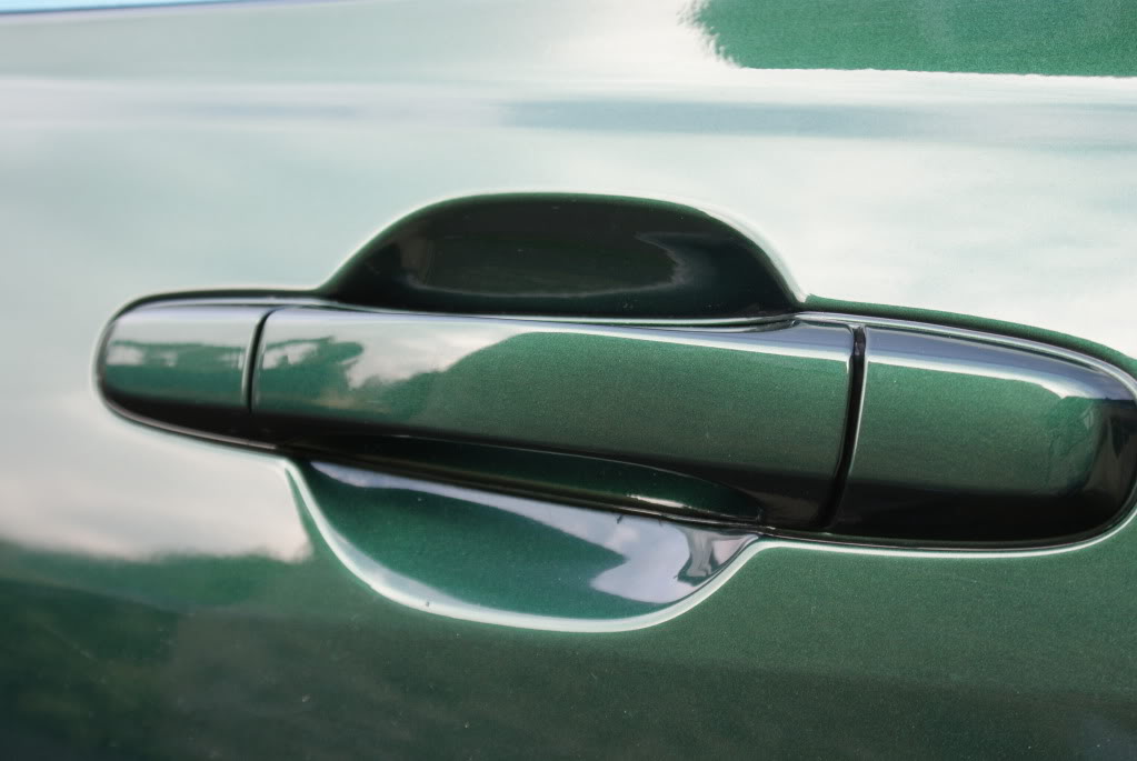

The difference in the door handle amazed me after just one pass

Quick question...When I'm claying I find my clay bar goes slightly crumbly after prolonged use (almost like it's hard to keep any warmth in it, if that makes sense?!). Is this just a trait of Meguiars smooth clay? Or am I doing something fundamentally wrong? (Sorry for the car cleaning newbie question!)
When using clay, put it in some hot water for 5 mins before using it. Softens it up a treat.
Big fan of your work yellowbelly... another fine example :)
Thanks for your kind words, much appreciated.
^ This, i keep a bucket of warm water to hand as i'm claying the car. I put the clay in there each time i've finished a panel and rinse it off, gives it time to warm up again.

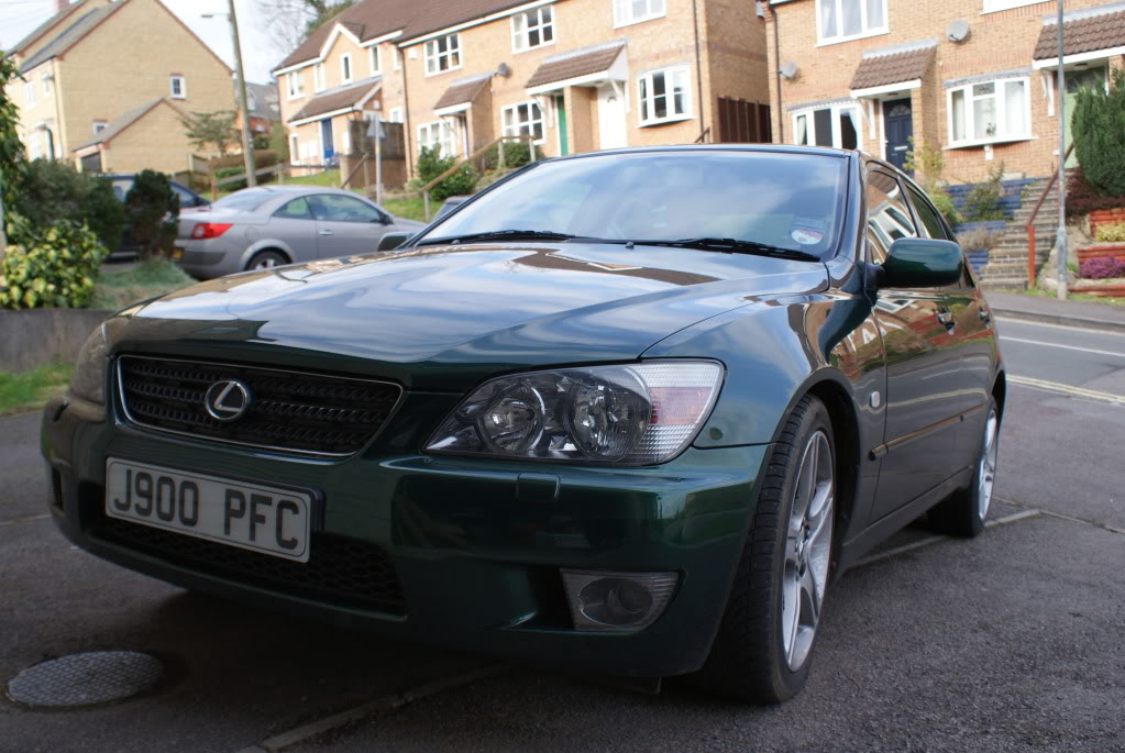

^ 'I want a Green Lexus' - He traded in his and his Mrs' car for it and got a good deal, low mileage in very good condition.
Personally i really like the colour, with the wheels slightly darker it would look better however
