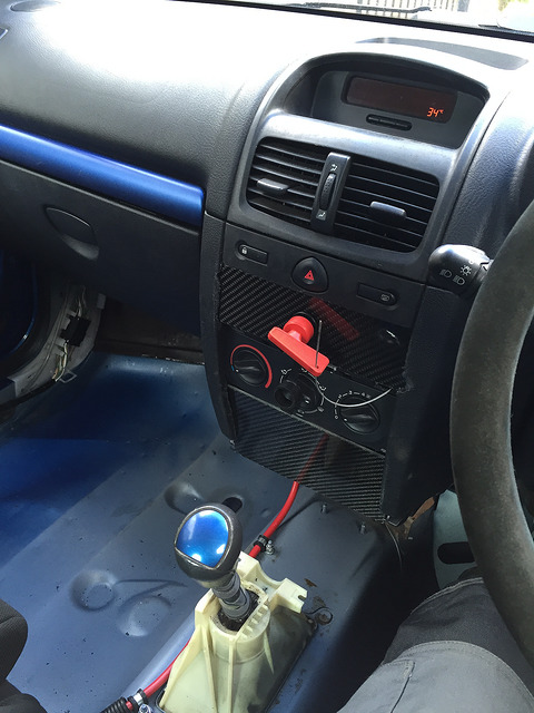

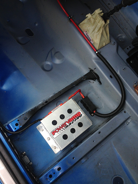

I put mine hear mate. Ive got the battery through a mega fuse then to a kill switch which then runs in to a junction box in the engine bay. The kill switch is also wired to the ignition.
So I take it in all cases that you run the 'new' cables back to the junction box in the engine bay to connect them to the 'old' positive and negative?
I wasn't sure if you would use the original negative or whether you would just run a new 'local' earth?
Hope that makes sense.
The positive cable runs in to the junction box to feed the loom etc. You then just connect the negative of the new battery to the body work somewhere suitable.
