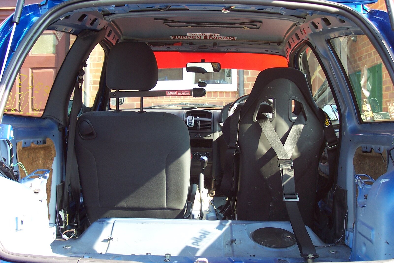

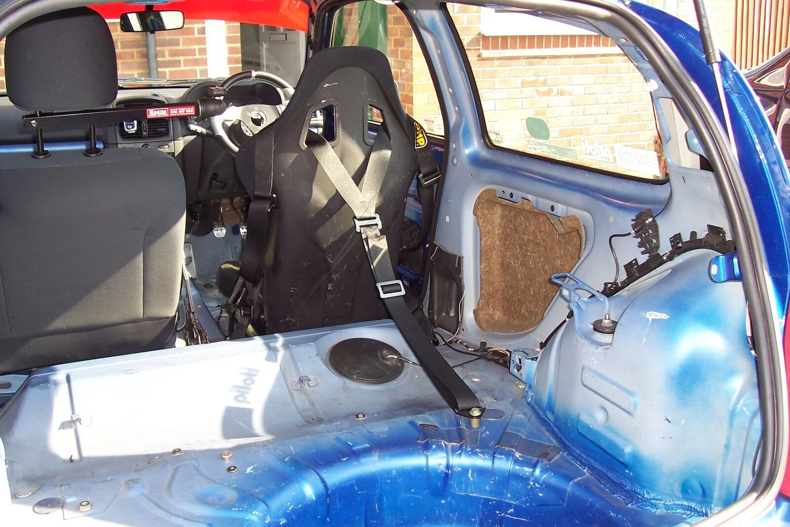

MarkCup
Side airbags in the front seats, don't forget them, the rest of the weight saving is covered above.
Glass, wheels, sound deadening (my cup had zero stuck anywhere), simple rear bench and so on.
I took mine down to the bare metal inside, replaced the driver's seat with a lightweight bucket, removed the rears, headlining, no door cards, no interior trim anywhere, the only original thing that remained inside was the passenger seat and the dashboard. I also removed the carbon canister and power steering.
As is my way, I weighed EVERYTHING I removed and in the case of the drivers seat, the difference between the two.
That lot removed came to 117kgs so in theory my Cup ended up at 904kgs and with no power steering made a consistent 180bhp.
It sat a little high on the standard springs but otherwise, with proper brakes and sticky tyres, was an absolute weapon on track.
