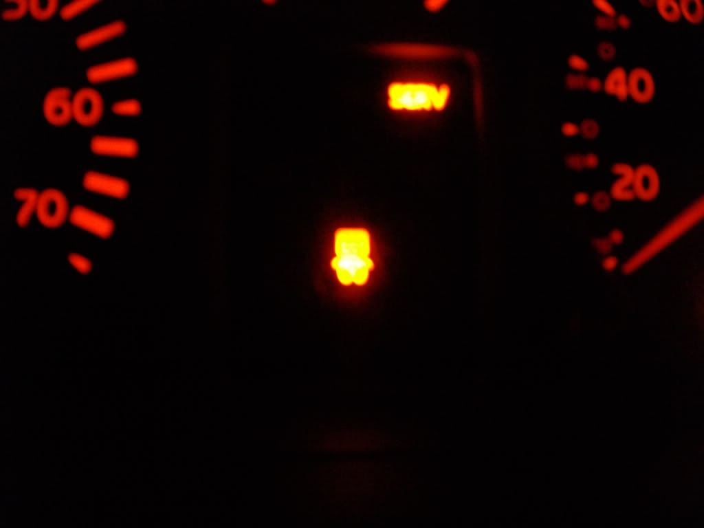

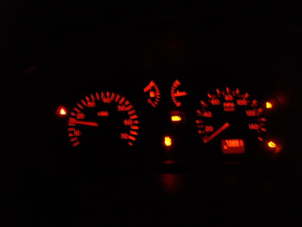

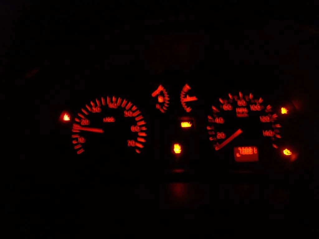

Was driving down a38 when i had to brake for a car in front putt it in to 4th and there was no power there just stuck at 1.5k I have decat but this has been on for about a month or two and no problems. Ive got a though ideas but getting it tested tuesday wa could it be.
It is the coil light in the middle which is wa came on when in limp mode ?

Had it diagnosed--- Its turned out to be throttle pedal isue

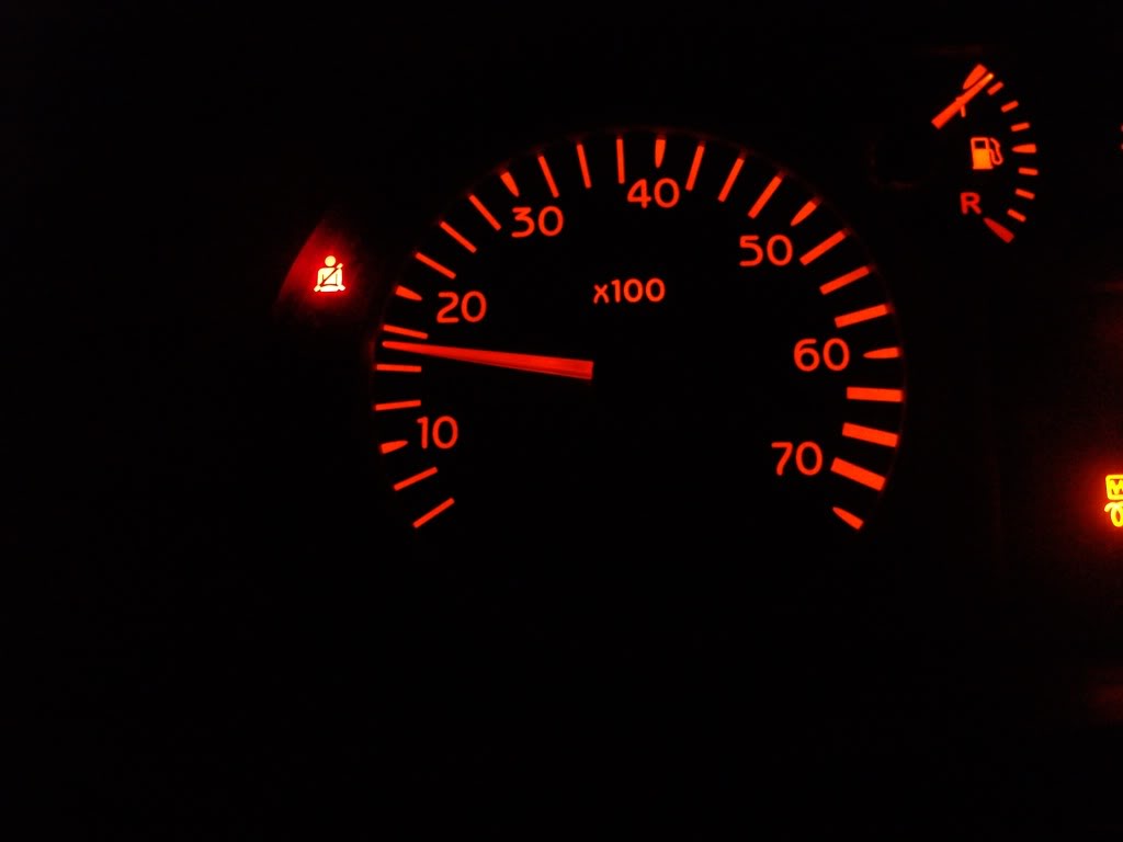

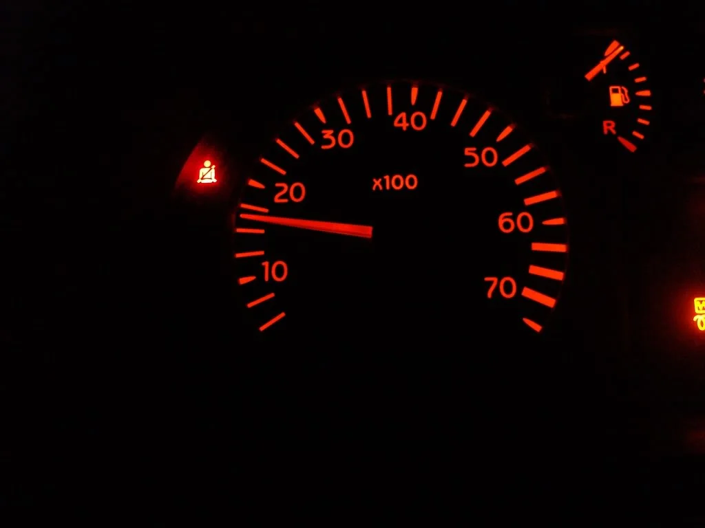

Just had the same occurence!
- Fault in engine management system (coil symbol)
- Air pollution / emission (engine symbol)
Booked in on Monday for soldering in a new ballast/resistor in for the throttlebody.
Got the ECU read-out this morning!
So def. not lambda sensor related.
Car runs fine and doesn't run richer or uses more fuel.
Kept an eye on the mpg usage on various trips.
Tailpipe is also sooted normally!
