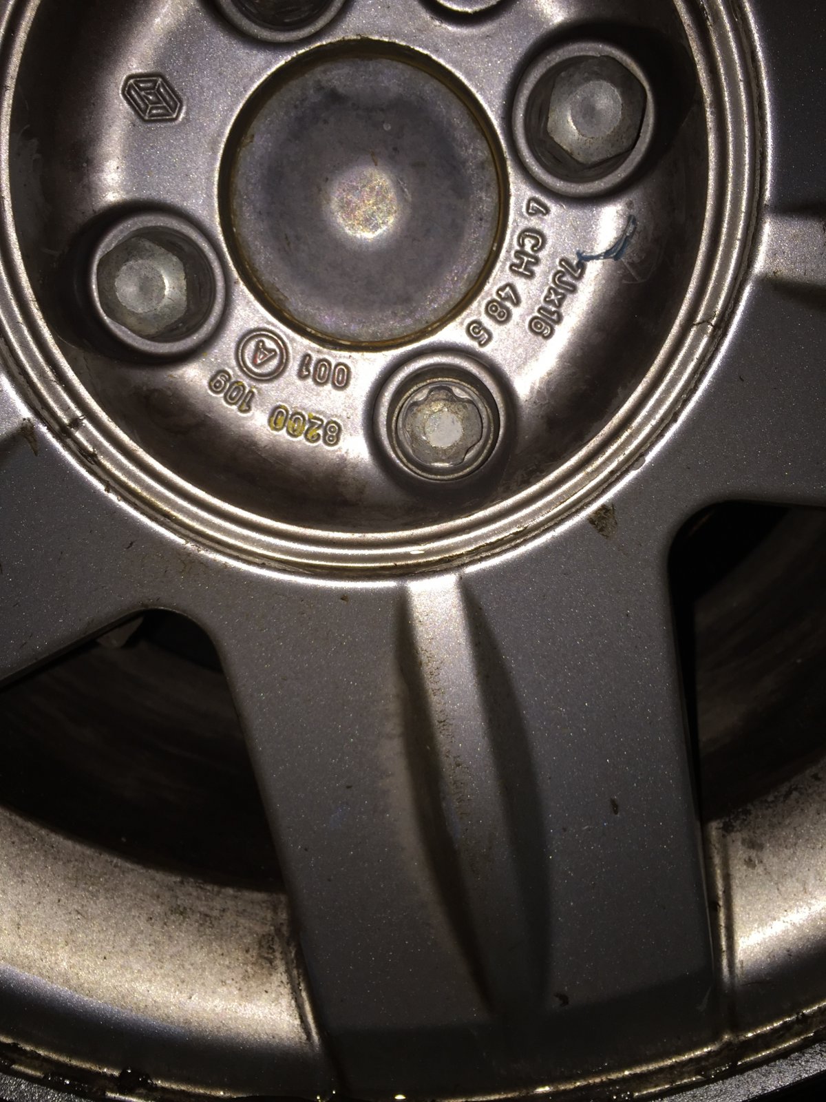

The locking wheel nut key is missing from my car, can somebody in the know tell me if these are the standard bolts and if so where I can get a key?
Thanks
Edit: should have mentioned it's a PH2 172
Drive it to your local scrappy, they should have a box of em, keep trying till your find one that fits. Cost me £1
Been to Renault today. They quoted me £30 to send off for a new one.
Went ahead and the guy came out to photograph my locking nut, turns out it's not genuine.
What's my options now?
Obviously got to try and get these ones off, any recommendations on how?
Also any recommendations on a decent replacement set?
Hammer a normal socket over them if you can. I used a impact driver in conjunction with the aforementioned. Worked a treat. What worked even better was the key I got from the scrappy though. .
