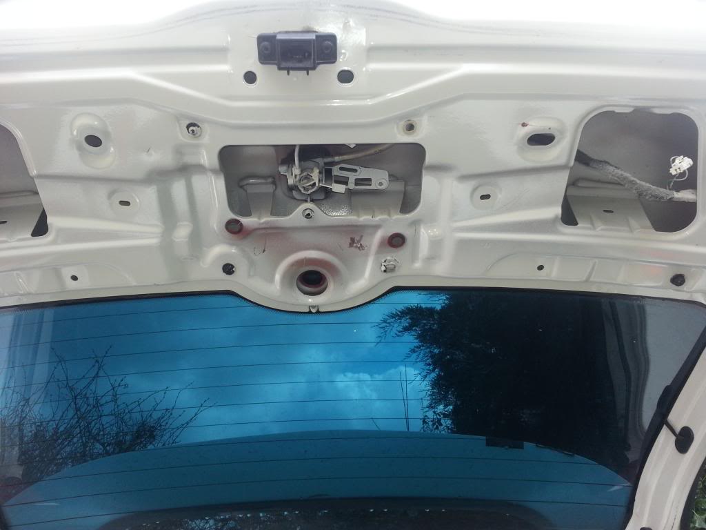

Ok im having some trouble with trying to figure out how to replace a boot lock... well put one on!
Picture 1

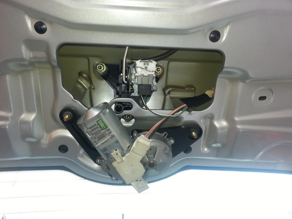

My phs 2 boot everything how it should be...
Picture 2
My brothers phs 2 CAR with a phs1 boot (cat d)
As you can see there is no boot lock....

Can you put a phs 2 boot lock on a ph1? as the fittings look different
The plug hanging out of the phs1 boot what the hell is that for?
Will any lock work and just plug in?

There is no way a ph2 boot lock will fit a ph1 im pretty sure, there are'nt even any fixings for the bolts to go,
No idea what that wire is maybe boot lock? does it lock? i cant remember being a while since last took one off.

Anyway, a ph2 boot lock 10000% fits a ph1 boot, you need to search, someone did a thread/sort of guide.
It's quite a long discussion thread (I know I posted in it) but it shows you exactly how to do it basically.
