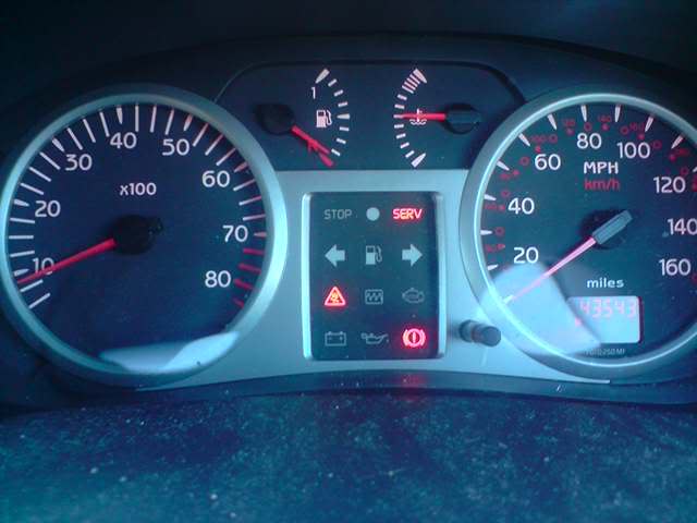

driving on the motorway and this happened
(dusty as hell i know lol)
has been doing this on and off, turn the car off, it goes off but after a while of driving comes back on, tut!
anyone shine any light on what the problems may be, price on how much this is going to cost to sort it.

Brake switch, behind the brake pedal. Mine went, was replaced under warranty. Not a big/hard job, I think you could just try adjusting it (look in the guide's section)
Yep, the cruise is de-activated by touching the brake pedal, if the switch is broken, this happens.
No idea on cost. Have a search in the guide section, try adjusting the switch first, might be fixable that way.
