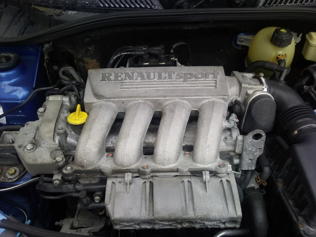

Here is a picture of mine, which bit are you talking about?
If it id the rectangular bit, bottom middle of this pic then I think that is call the fuel rail guard, but I may be wrong on that!!
As far as I know you can take it off but its pretty easy to just tighten it back up.
This thread may help, but if you search the guides for changing the engine oil it will explain it in there as you have to remove it to get to the oil filter.

going on the photo uploaded (thanks _WILL_) I'd say its the fuel rail guard.
does the far-right bolt also hold the engine cover in place? because that'll be he bolt that's missing and explain the problem

There are 3 wholes in the front of the gaurd, but as already said only the left 2 have bolts the right had one is empty, so if that what you are refering to then you shouldn't have a bolt there!
Are you missing one of the bolts that has read on in my picture??
Not the red-marked ones no. there's a bolt-head on the very right of the block, which seems to be holding the guard on?
Like I said, there's a bolt missing from the engine cover, wondered if it was the same one.
No mate, not holding the guard on at all. Just the two bolts in the holes as described above. You might be talking about one of the lower inlet bolts maybe?
