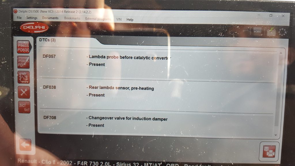

I clean the TDC sensor ( was a mess there ) and I will replace the spark plugs tomorrow. Hope this would solve the problem.
before throwing more money at it, get yourself a fault scanner or take it for a scan... that should point you in the right direction
Thanks for your replay. Well, the spark plugs are the original ones, 100k miles, so a new set was a must now. I will try to get a scanner.
Could you help me? Thanks
So I should replace just the front one? The one before the cat? Oh, my exhaust is decated, I forgot to mention.
Yeh the one closest to the engine.
Or you could try swapping the front and rear ones to see if that improves anything.
The one after the cat just monitors the emissions but doesn't have any effect on fueling so if the front one is faulty but the rear one isn't then this might be a cheap fix
Thanks for your reply. I will try first a swap to see if it will make the engine run as it should. Do I need another fault scanner to erase the errors after I will swap or replace the lambda? I ask this because I don't own a scanner, for now.
Thats what I need, thanks you a lot. La 3rd fault was because I install the KTR induction kit and remove the valve.
