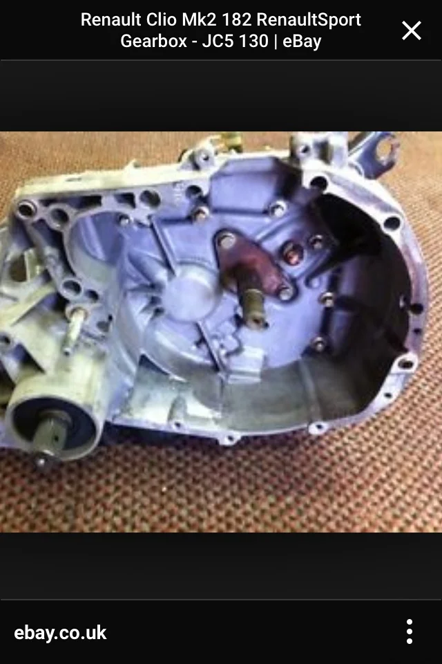

Ok I'm a little confused. I'm struggling to find where the input bearing should be on the gearbox.
I've attached a pic and can't see how or where I would have to get my hand in to get the bearing out. So do I need to open the box to get at it?
If any one could tell me where the input bearing is on this pic that would be great.
The shaft you see sticking out in the middle is the input shaft. That metal plate around it which is held by two bolts retains the oil seal and probably the bearing.

Pretty sure the input shaft bearing can't be replaced without taking the box apart. What you're seeing in that picture is just the release bearing guide tube.

I just had a look at the box in the garage. The metal plate and tube is easy to remove and the oil seal is behind. The oil seal can certainly be chainged without diamantling the box, but I think it is highly unlikey you could do the bearing as well.

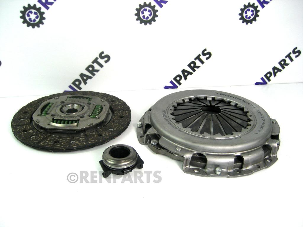

It's not your input shaft bearing, it's your clutch release bearing that's knackered.
It slides over that input shaft and attaches to your clutch fork.
The small part in that picture.
  172
That's what I had initially thought and I hope your right as this is a cheaper option! However the noise goes away when I press down on the clutch pedal. My understanding is that if the release bearing was bad I'd hear the noise when I press the pedal, where as I hear the noise when the pedal is up.

I disagree, the clutch release bearing isn't actually doing much with the clutch engaged where as the input shaft bearing is rotating. When the clutch is pressed the input shaft stops turning, so does the noise.
Usually the release bearing will make a noise when you press the clutch and it is under load. When they get really bad the fingers on the clutch cover plate will wear through.
It will be worth having a look at it, as the box is going to have to come off either way, but it would be a shame to put the car back together with a new release bearing only to find the noise is still there.
