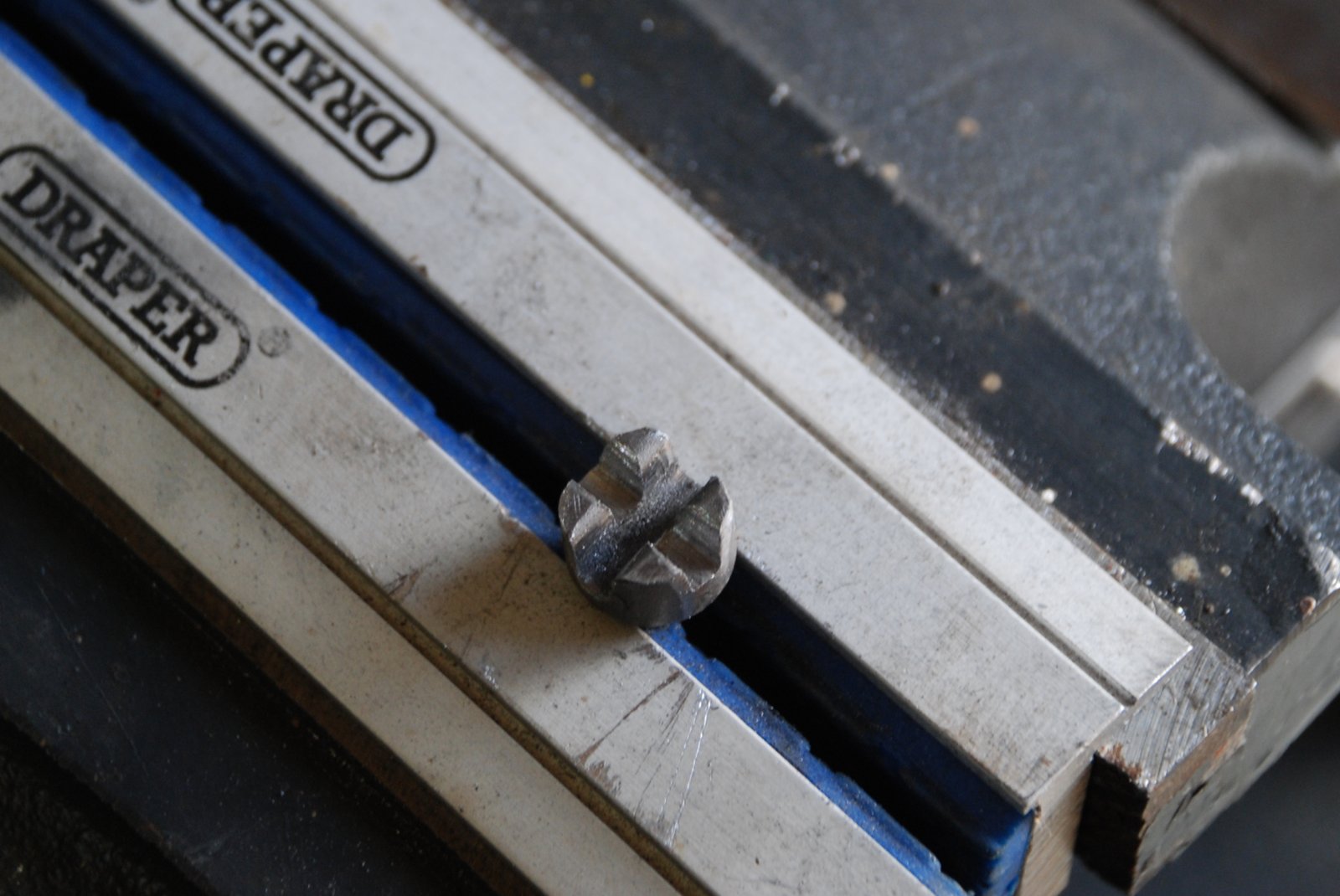

When you say the oil pump mod, do you mean the shim on the oil pressure relief valve?
Yes, although I did it this way. Is that what you mean?
NorthloopCup
Yes I noticed you do that. When the time comes for a rebuild I may pop it up to you for that.
No worries mate. We do lots of different stuff to other people, but it works and it’s proven itself over and over again. I actually had to remove the shims on my oil pump as the pressure was too high! Lol! 118psi cold! ?
