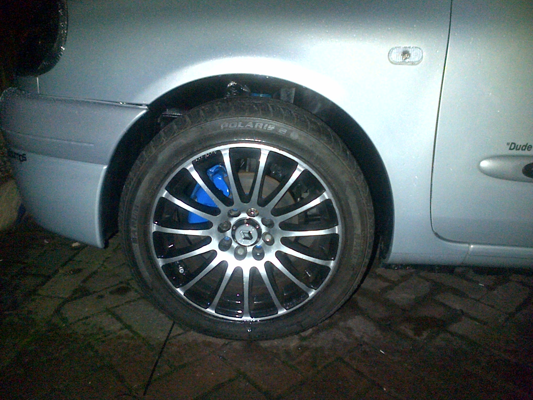

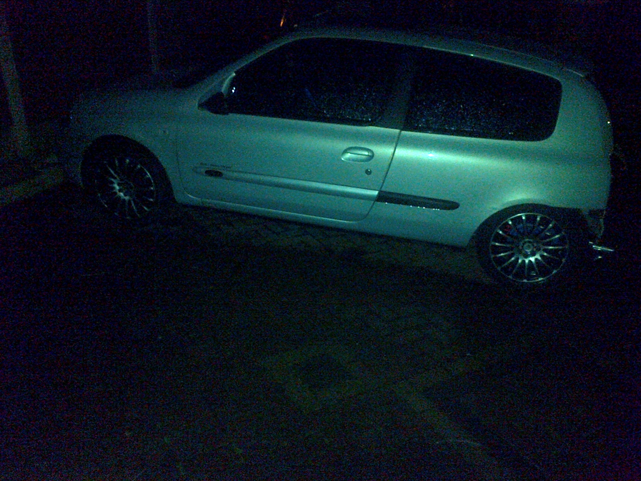

Yes thnaks that's what I meant to putn basically I fitted a full 60mm lowering spring set to my mk2 ph1 1.2 and they are sat propperly and fitted correctly however the front is higher than the back by about 4/5 cm,
The box had a leaflet from larkspped saying "warning original bump stops must be reduces by 22mm minimum" and so I cut the bumpStops 22mm (a bumpstop is a rubber thing in the middle of your shock absorber between the springs to stop the shocks from bottoming out , hence why when the cars lowered they need cuttimg so it don't bottom out every bump it hits) I just wondered why its higher at the front and my theory was maybe I have not cut the bump stops enough and it is sitting on the bumpstops rather than the spring possibly , I exadurated with saying it looks like a plane taking off it is simply half way down tyre at back and the front the arch is a good 5cm above tyre , thanks again ( sorry for spelling I'm on my gf's blackberry :/

Do note the car is faCing up hill a little so it lower.a a tiny bit mone on flat and the bacl bumper is off to spray the bumper strip

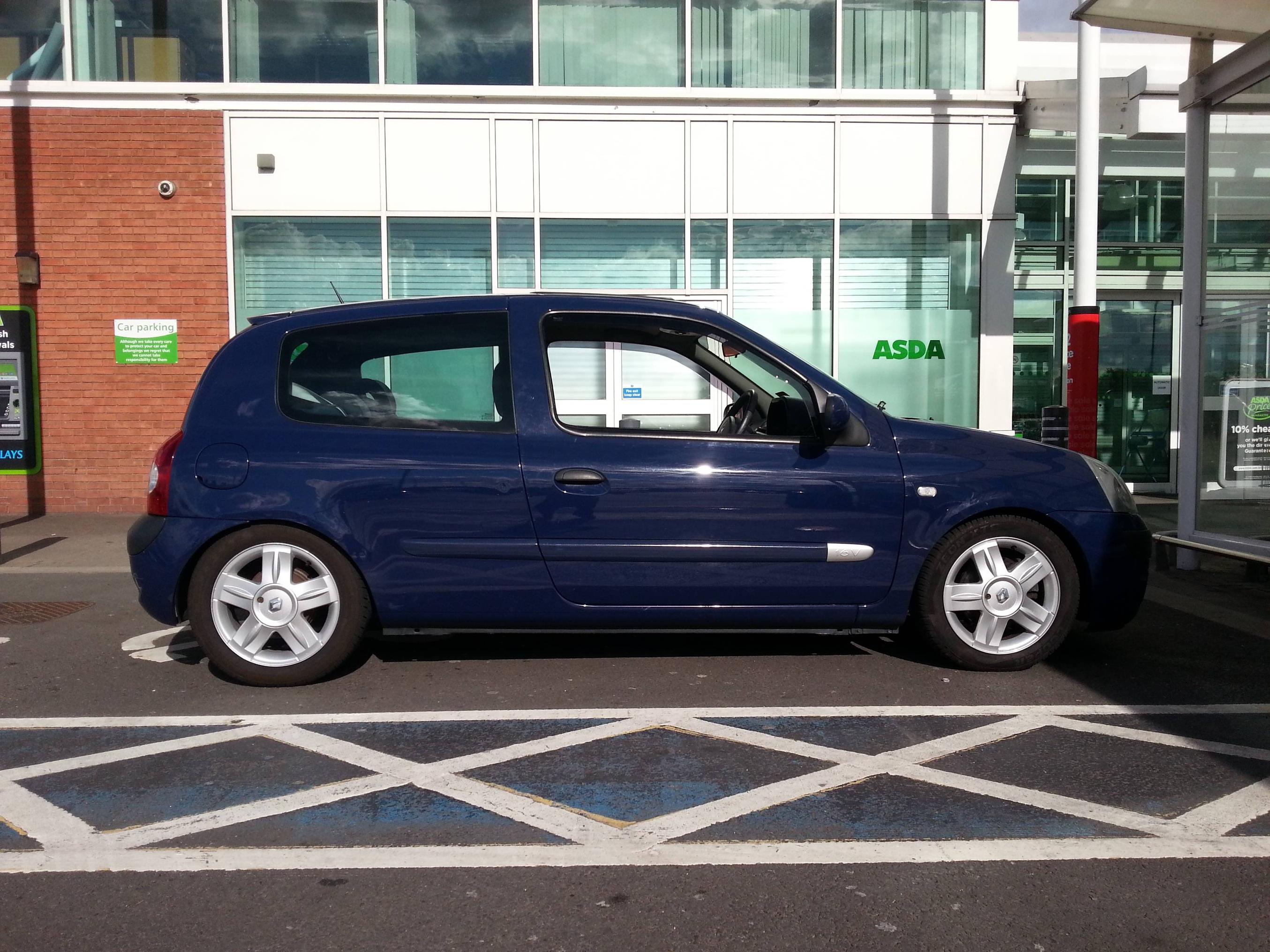

I'll dig out some pics of my old old car on 60mm...

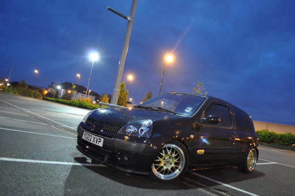

Not even kidding before I took my 1.2 off the road it was perfectly driveable and the front was about 120mm down and rear was at least 90mm.....
Still had about 2cm left to go on the front coilovers (if that)
This pic was about 100mm front 90mm back

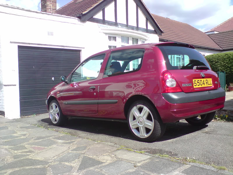

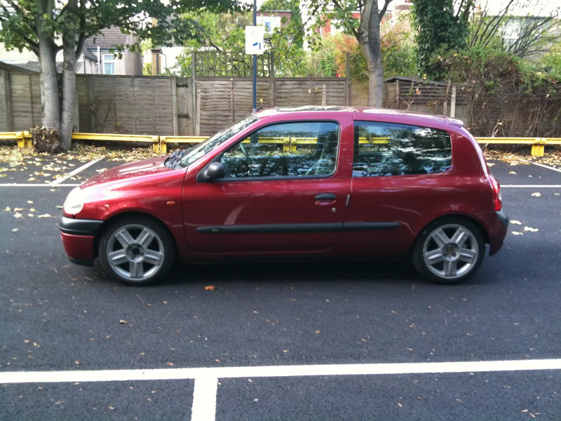

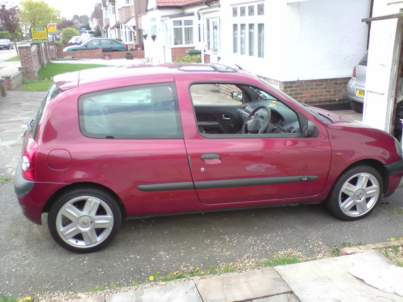

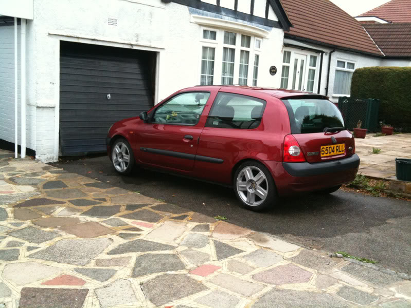

Right:
Standard for a mk2 ph1:
60mm down:
Or a more direct:
Before
After
Excuse the quality, this was way back when.
have you measured beneath the subframe before and after? that doesn't look like a 60 mm drop on the front tbh.
GAZ said that their coilover kit which I have could go 60 or more mm lower but in real life if I tried to go 60 mm lower the car would be standing on the bump stops on the front leaving no shock travel at all. Maybe some of you guys are measuring the drop in other ways, I'm always taking measures under the subframe
