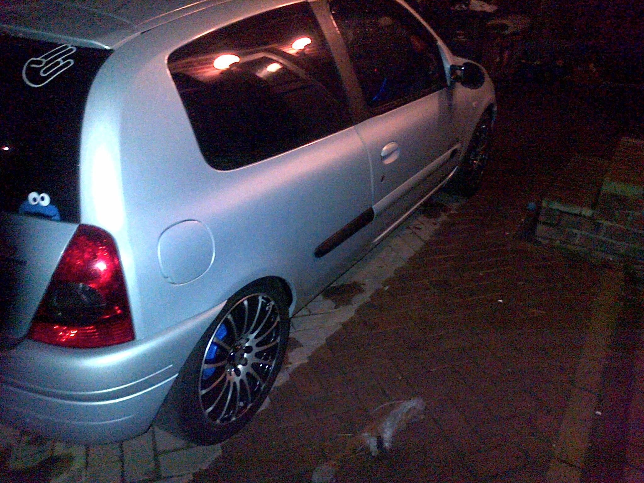

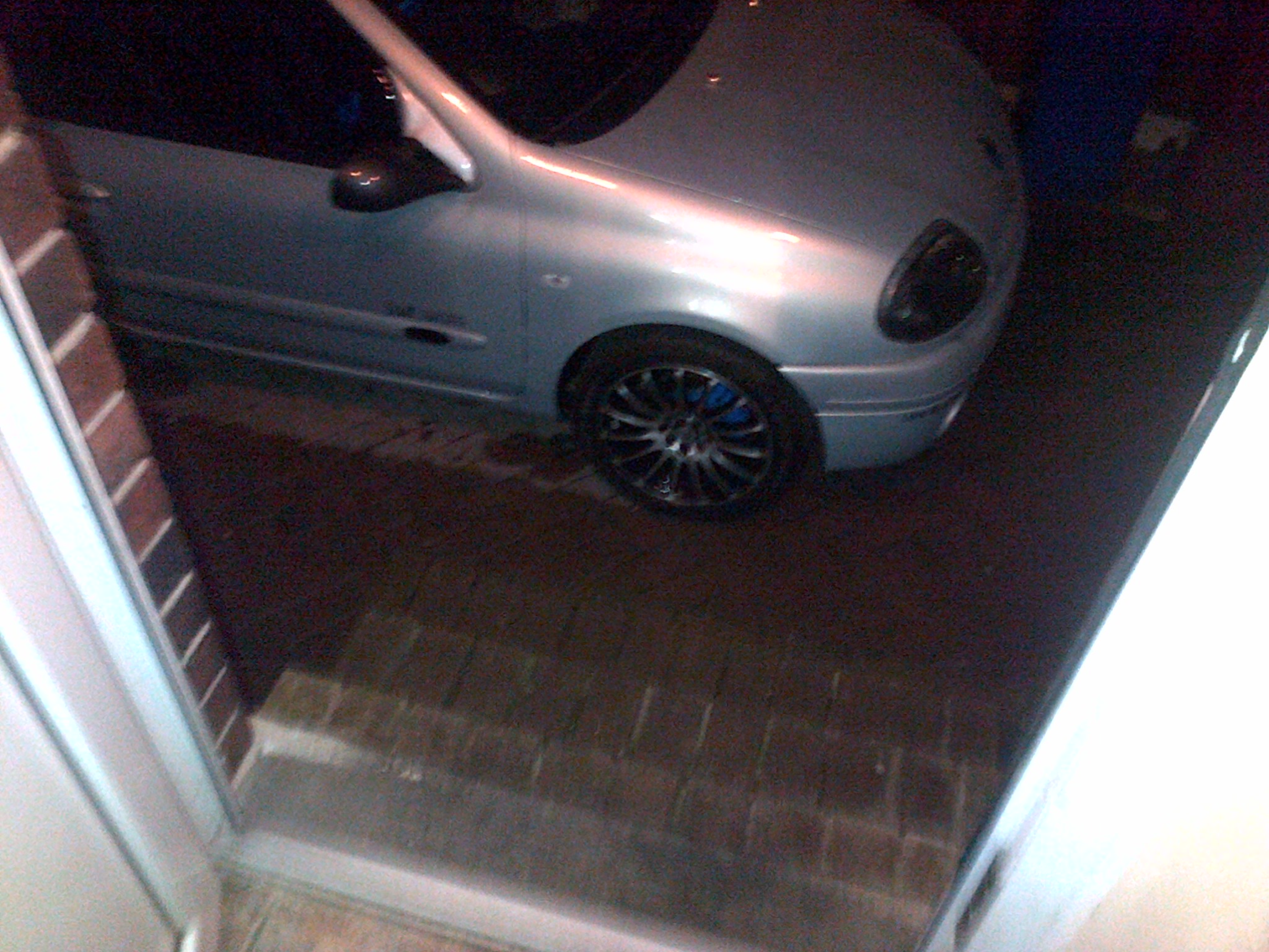

you rears look ok. looks like the wrong front springs have been supplied or have been fitted wrong.

i ALWAYS! remember thing late at night aha not good pics at all but couple of very quick ones as its freezing, it has lowered but still way off at the minute it has only done about 7 mile though since they were fitted and larkspeed says they take around 50-100 mile to bed in and settle down.
Rear springs almost definitely more than 60mm!

Yep still got a lot of negative rake. Looks like it's dragging it's arse. Definitely something up with those springs man. And yours is a sport Lauren, so they're lower than a non sport as standard, so would be even more than 60mm to get to the same height, no?
they did say "extra low" springs and it hasnt even moved at all much just around the block twice when it takes 100 mile to settle down they said
