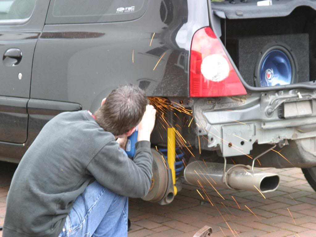

you can drop it 100mm on 17's
Surely that looks abit mank though? And hit's everything? Some pictures of examples with wheel size and how much it's lowered being stated would be nice ;)
a bit mank????
LMAO @ Fred. Hmm, don't know that I fancy going to that extreme, although it does look awesome. 60mm don't look too bad an 16s. Think that's what I may go for :)
