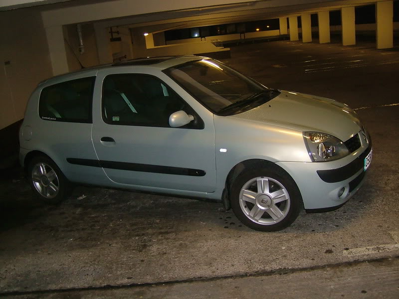

Lowering help?
that my car i was just wondering if the back is on a torsion bar or springs? and would it be easlier to lower it myself or take it somewhere to be lowered?
