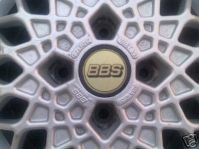

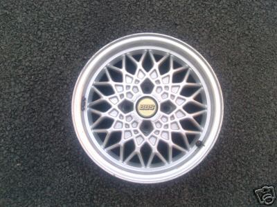

Just by looking at the picture, will these alloys fit? Im looking at buying them from a guy near me, he hasnt any details of them for me at i aint been to see them properly...but please let me know what you think.

duno about the wheels, most BBS that fit VWs fit clios i think though.
