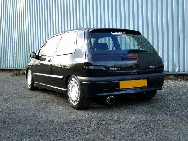

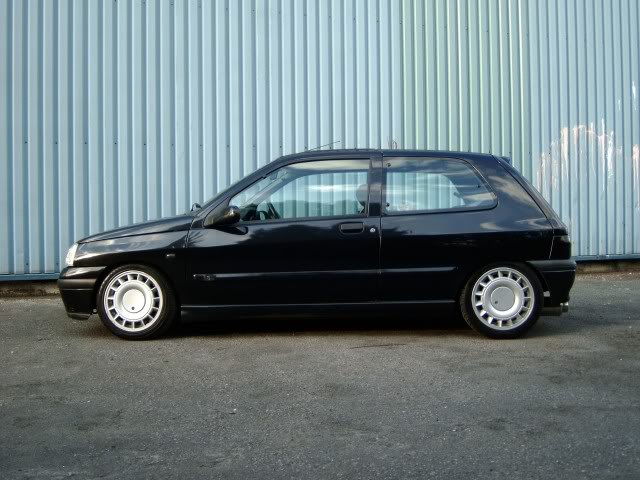

This mine at the moment.
Lowered on coilovers (roughly 70mm at the front, 65mm at the rear)
kool how much were they adn where did u get them from what exhaust have u got on there coz it looks good and does it sound nice and loud
is it the quiter model exhasust you got or louder one and what does it sound like, bet it sounds better without the baffles dont it
yeah, i have the 'quiet' version lol
It was louder than my mate's Magnex exhaust on his old valver (with a decat!)
The quiet ones have a silencer between the cat and the backbox.
What wheels you running? I found that when I put 15's on a non valver/williams they rubbed like a b***ard with the torsion bar lowered! Had to get the lip ground off the rear arches and heightened slightly! Valver inner arches are wider than the standard clio's. Just something to keep in mind.
My 15s are 6'5" wide with 195 /45 tyres
You must have the wrong offset mate.
15s with low profiles and the right offset is no problem.
Maybe some rubbing on the plastic mud guards, depends on the drop.
The correct offset for the Mk1 is ET36 (Renault std) you should stay as close to that as you can when buying aftermarket wheels.
I'm guessing you have ET 30 wheels or similar.

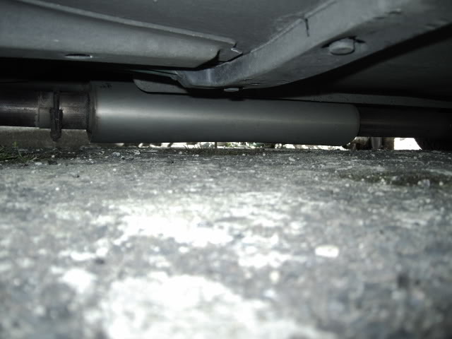

Too low!
Broke an exhaust bracket going up the drive when i came back from having my coilovers setup lol
Can you see the dent in silencer? :o
Mine's roughly as low as yours (Remedi), I can't really go over middle of the road bumps as the start of the exhaust starts to scrape so have to go over them at snails pace which annoys the hell out of the people behind.
I have 15"s on mine (1.4 Rt with no archwork what-so-ever) and they don't rub at all apart from hitting big bumps at speed

Fook me thats low!!! I bet even the ants scream for help when you pass over them! :cool:
i had a piece off metal welded on mine to hold it up alot more, the scraping sound is heroundous.

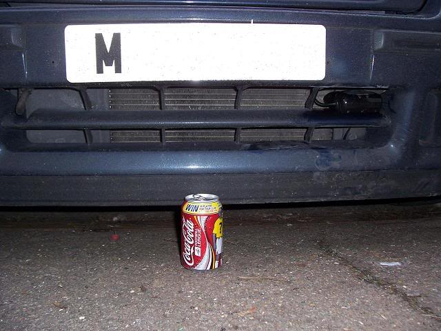

tis a wee bit low!! Im gona raise mine 10mm cos of the bluddy speed bump issue! nealry lost my whole system going into a car park last month!:mad:
Whats the little black box thing to the right of ur radiator in the bumper??
