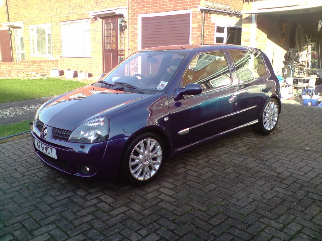

likinig the mk3 alloys on the mk2, they suot the car alot better than they do the car they were intended for.
