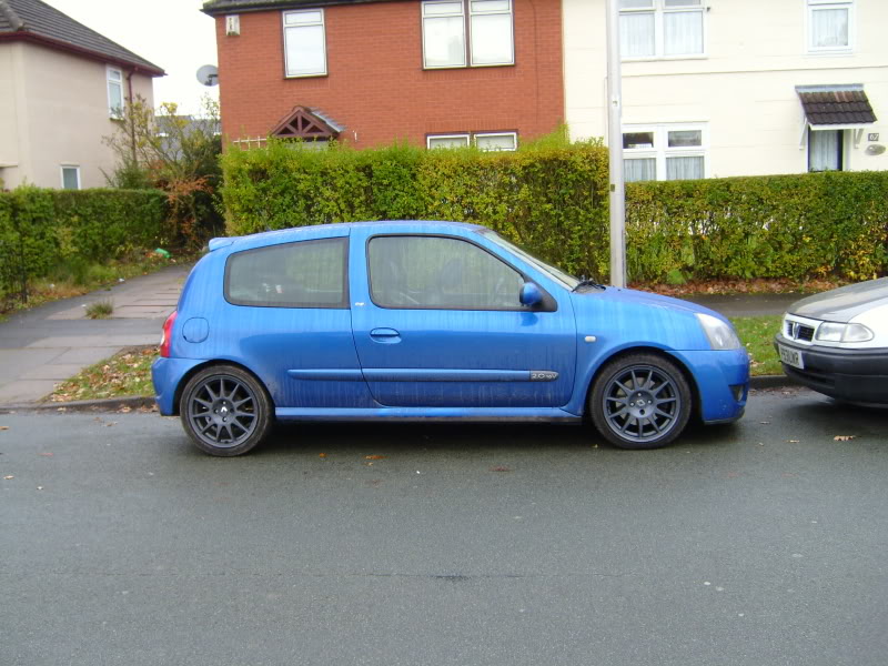

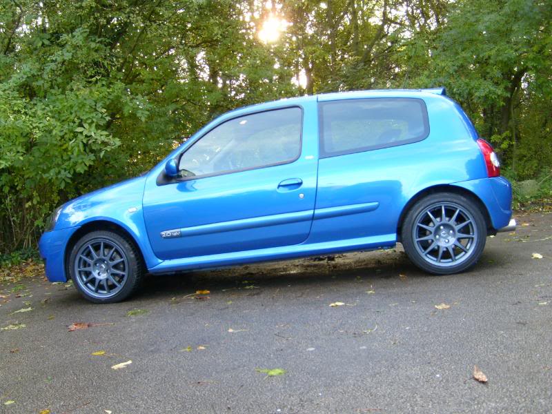

Apex, arn't as bad as people say. I had mine fitted 2 days ago, not settled yet but it looks much better and the ride feels no diffrent than my std cup springs did!
Obviously they are stiffer on fast country roads but not really harsh. Isn't your car used as a toy? you wont need comfort then anyway;)
Std
Apex 40mm

Not true in my experience, and plenty of others on here. The ride is shocking, just too stiff for the dampers.
