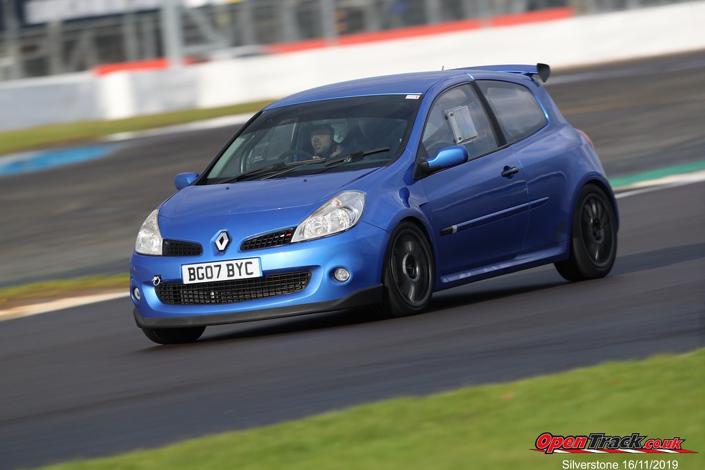

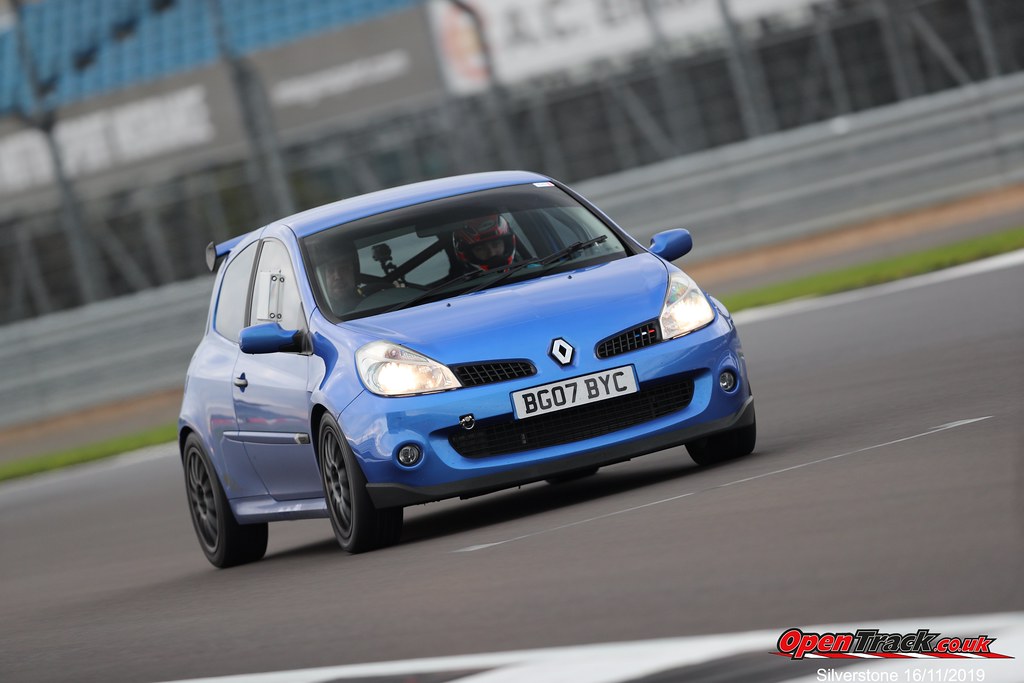

You can see here that it does dive under braking a tad:
EN9I3613 by Opentrack Track Days, on Flickr
Level:
EN9I4004 by Opentrack Track Days, on Flickr
having something which is comfy on the road is always going to be a compromise for something which is going to handle well on track.
have you had a mess with the damper settings yet?
