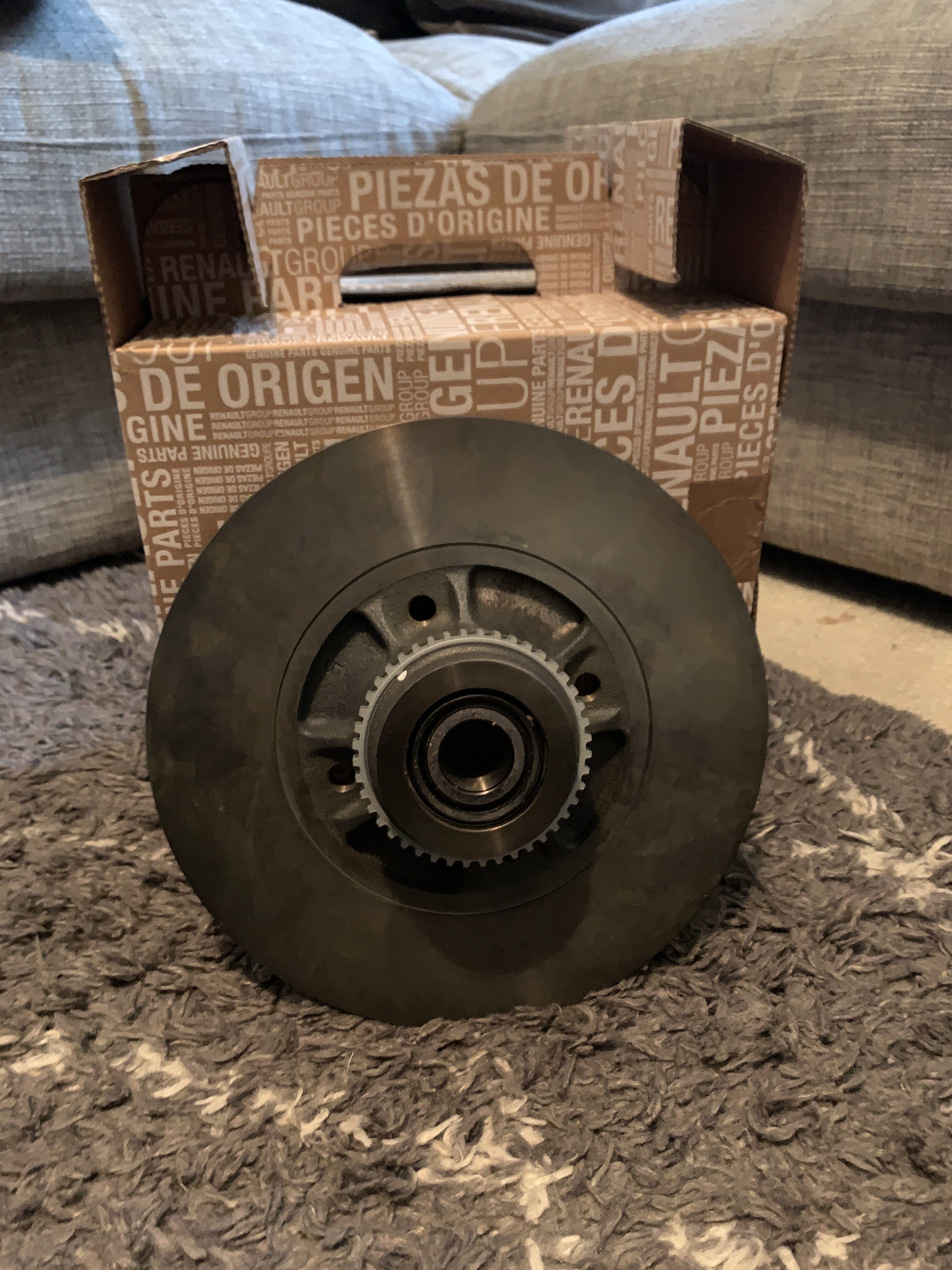

Been a couple of weeks mooching round in this and it’s actually better than I expected in many ways!
What sounded like a loose bearing (rear) appears to be exactly that. I’m guessing it’s just easier and likely to be better value to buy discs with a hub already in place so I’ve got some internetting to do.
Should anybody have one lying around and are selling do let me know though :)
Nice to see your enjoying the car! If you join the clio facebook groups you will find one there or just put a wanted post up
Thanks mate! Unfortunately I’m no longer on Facebook, pretty sure the missus is on there mind, will get her to have a butchers (y)

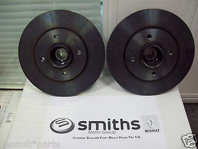

The hardest part is getting the ABS ring on. Buy a new one as you'll likely snap the old one getting it off, then put the new one in the oven for a bit and tap on with a hammer and block of wood
Just buy new? Pair is like 100 now days surely
Posted for just over a ton. A done deal
Cheers chief, had in fact been watching these on eBay, they’re now on their way. Appreciate the link!
Make sure to check the spacers are still there and fit them correctly before fitting new discs. Otherwise you'll soon ruin the new bearings! They sometimes get stuck on the old discs when you remove them.
Ah ok good to know - thank you.
Although I mightn’t be doing it myself as I don’t think my 24mm socket will quite stretch to the required size 🤣

I’m as impressed with the packaging as I am with the rapid delivery! Many thanks to Renaultparts if you’re on here. Should get these on tomorrow.
