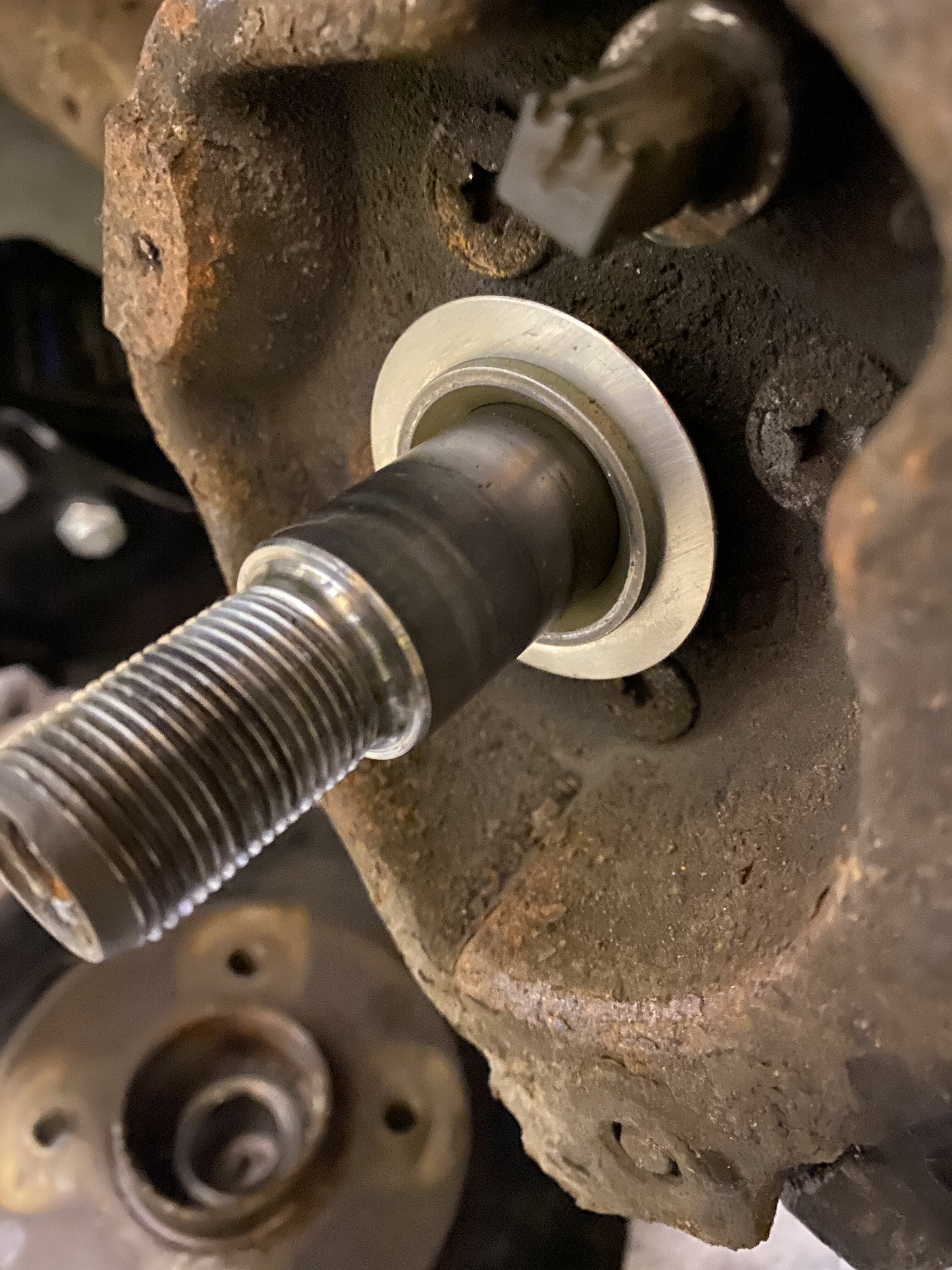

Ordered some new discs and pads today, thought I’d make a start stripping them down.
Removed the discs to find the spacer fitted which was nice to see but has it been fitted the wrong way round?
Pic of how I found it.
I’ve taken the spacer off and spun it around, definitely fitted the wrong way.
I've been a victim of my own clumsiness in the past with this. Mine barely lasted three months before it started droning and needed replacing.
It's that common an issue - I'd recommend that this be made a sticky? @Sunglasses_Ron

Some photos of them and info, I get these made up and have 100+ in stock
These are still catching people out, I'm spreading the word to every owner who enquires about brakes
Check yours look like the photos, and fitted the right way round and hub nuts done to 175NM
I've seen all sorts of budges when they're missing, form spigot rings, normal bolt washers and even plastic packaging that some rear discs come in the box with!
