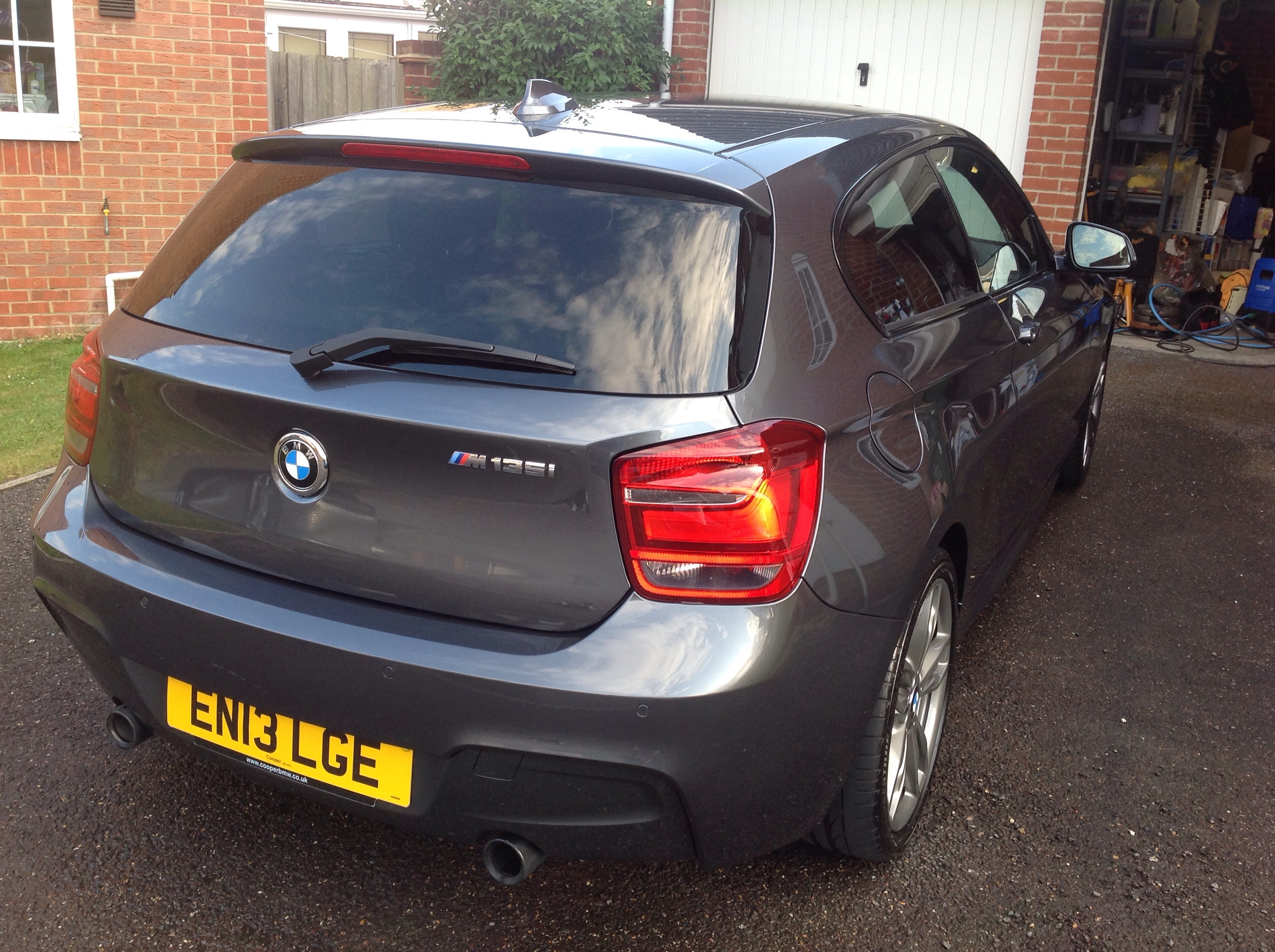

A BMW M135i turned up today. Christ I need one of these in my life.

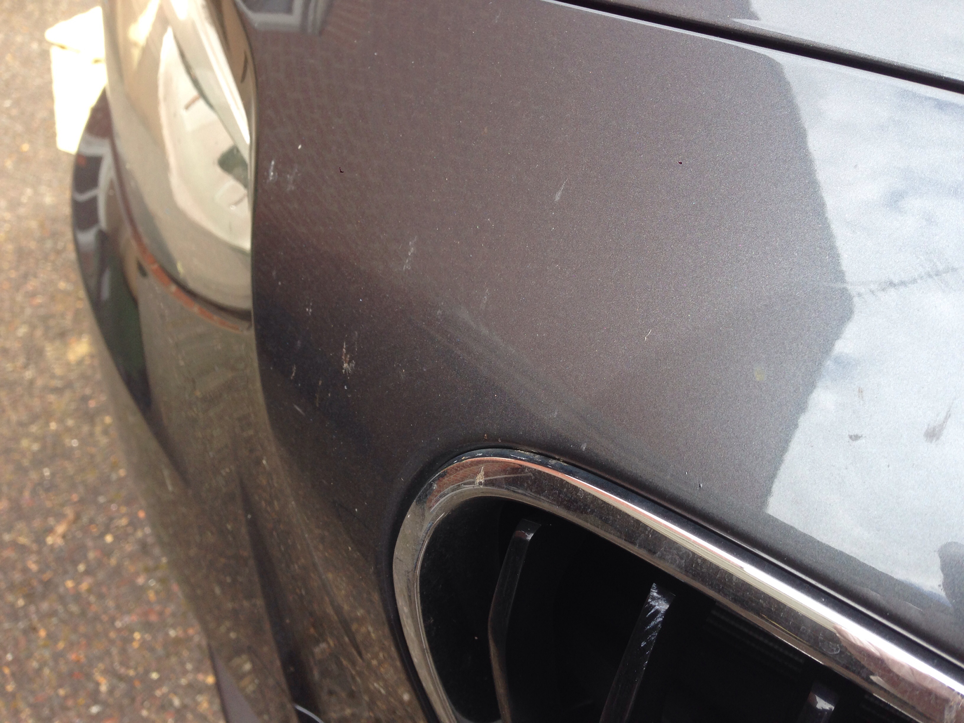

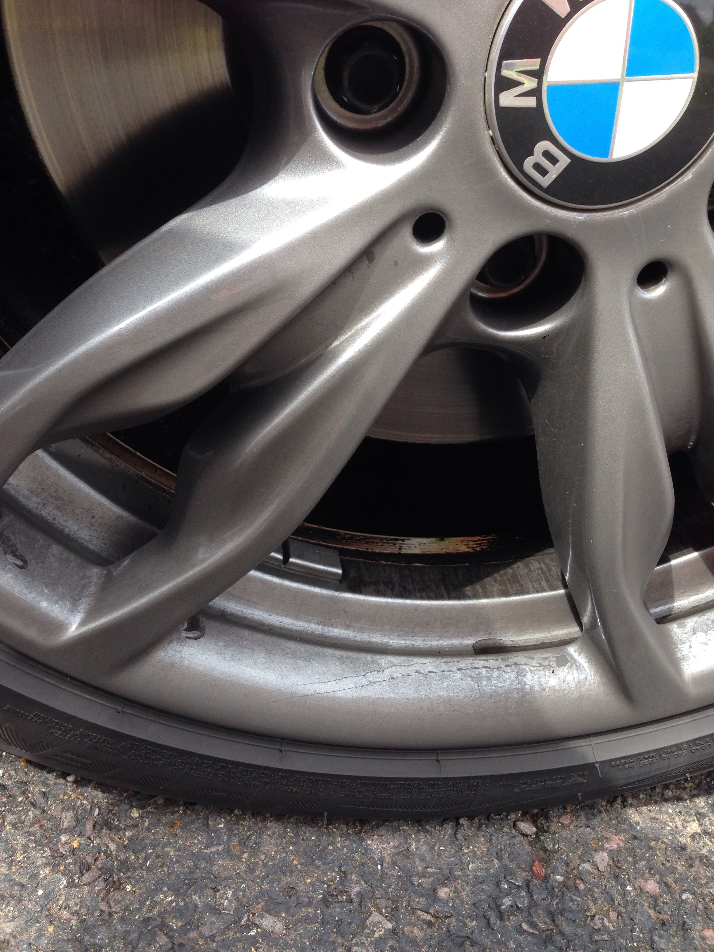

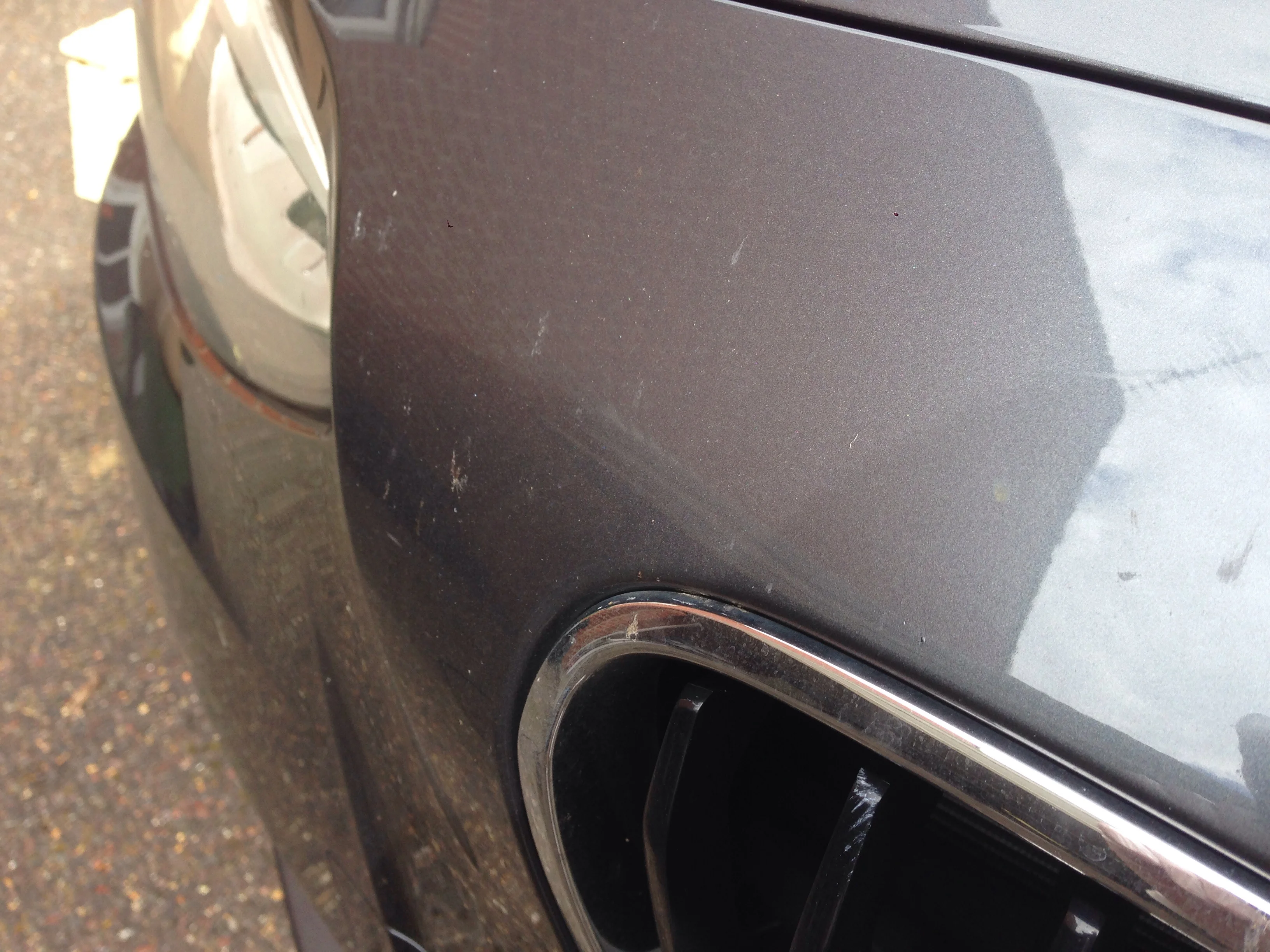

After pointing out a few defects I dropped Dan to the station and returned home to get cracking.

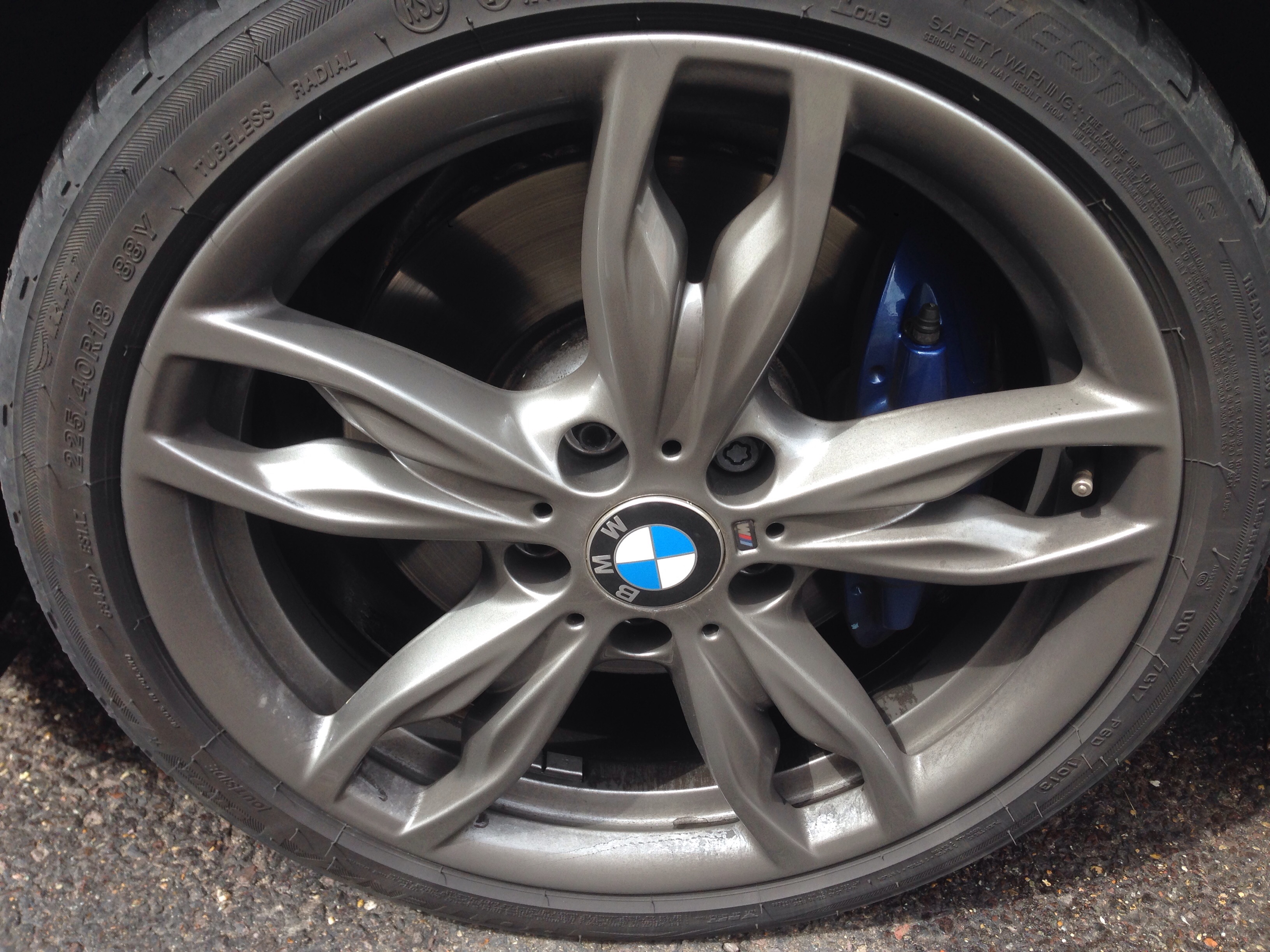

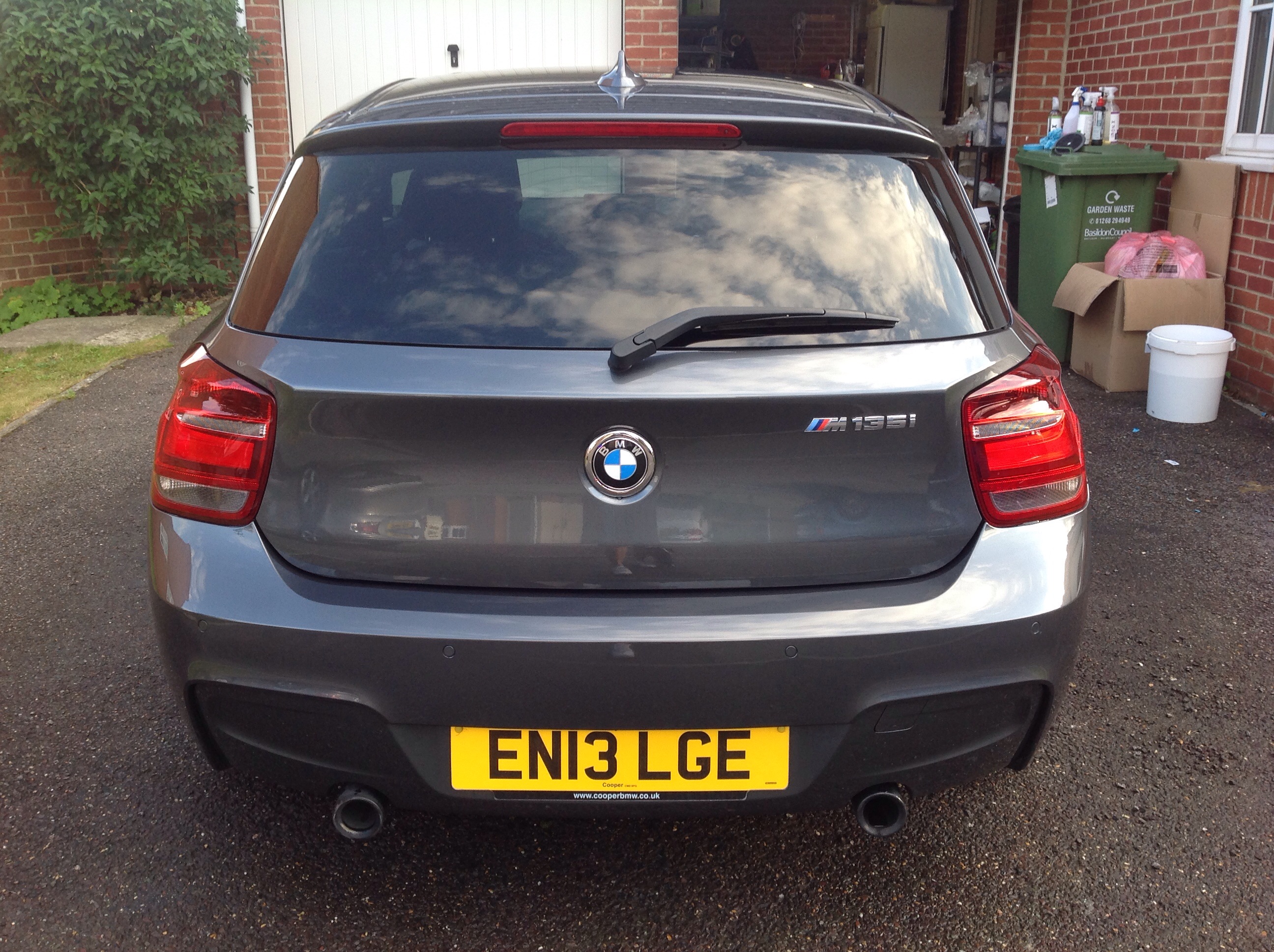

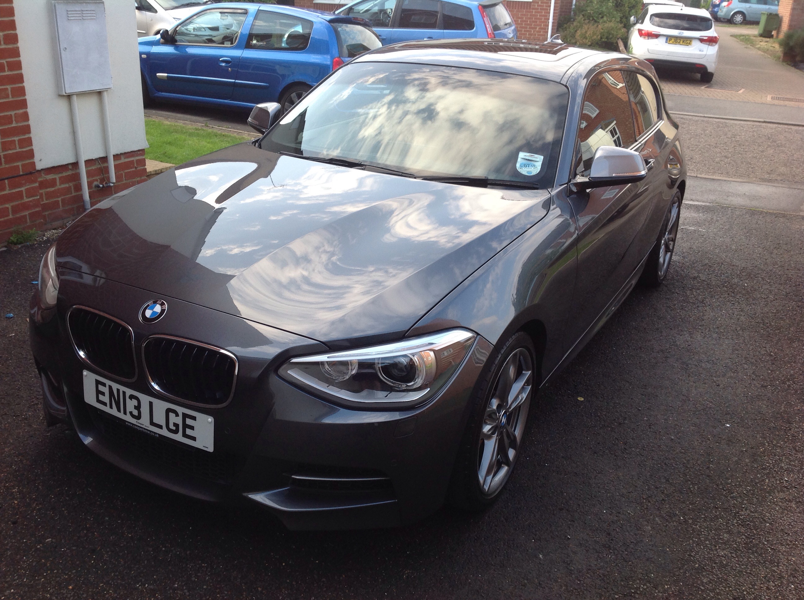

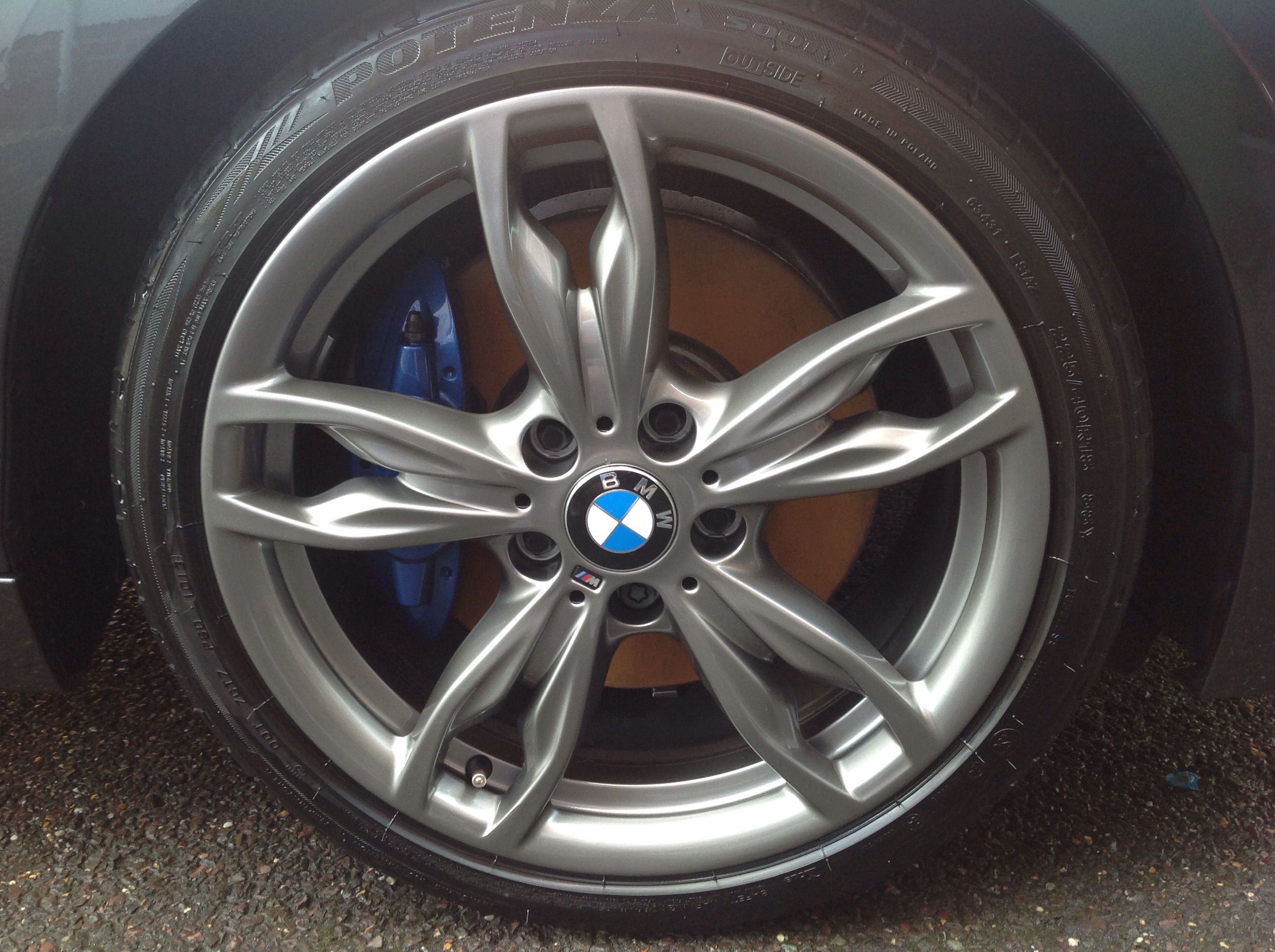

Did the wheels first (iron x and brushes and blasted with the jet wash before washing) and then onto the rest of the car with the usual process of Snow foam, 2 bucket wash, ironX/Tar X and a second wash.

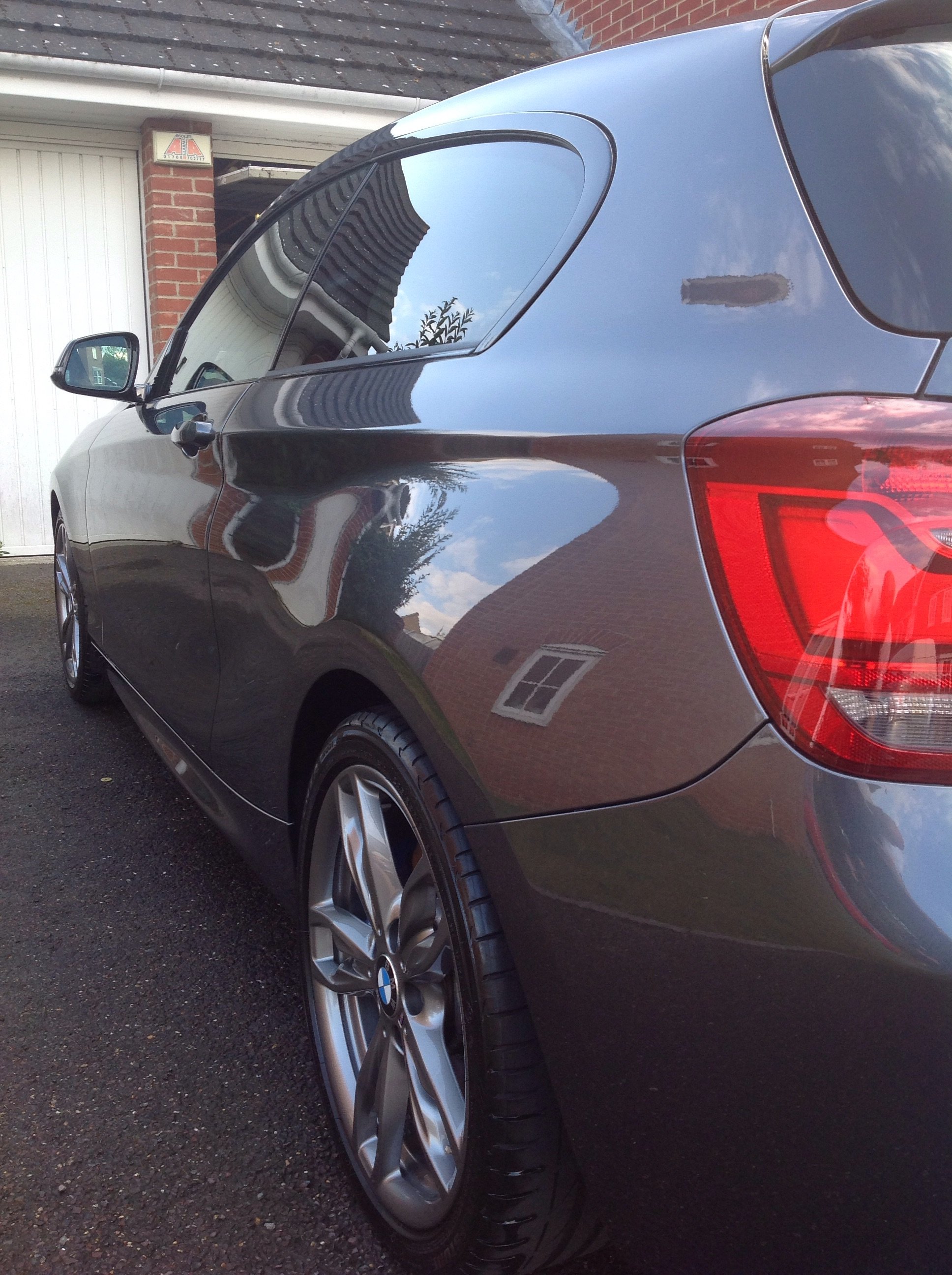

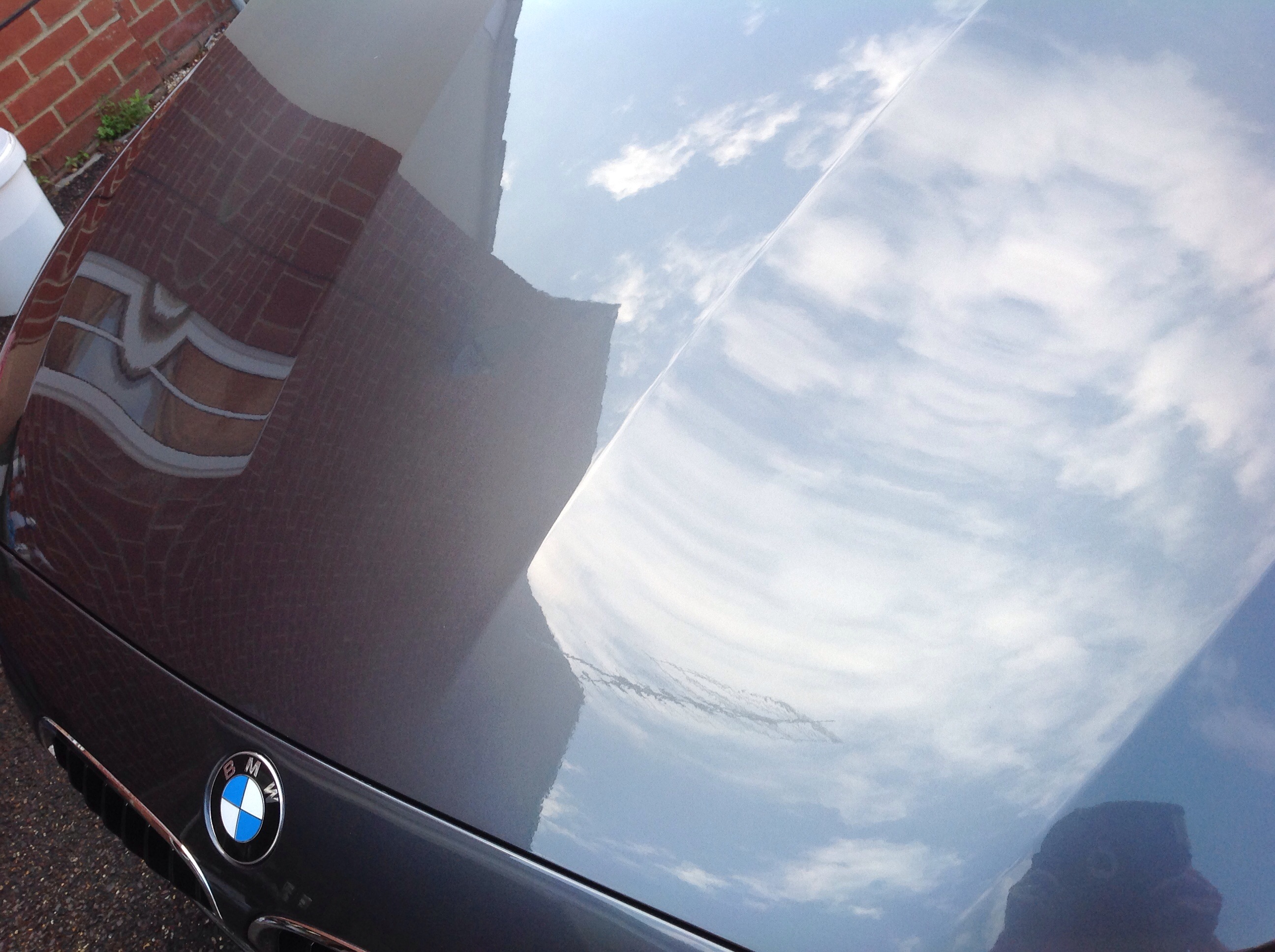

I then tried out a medium 3M polishing pad with some 2200 menzerna Polish. This gave me the results I was looking.

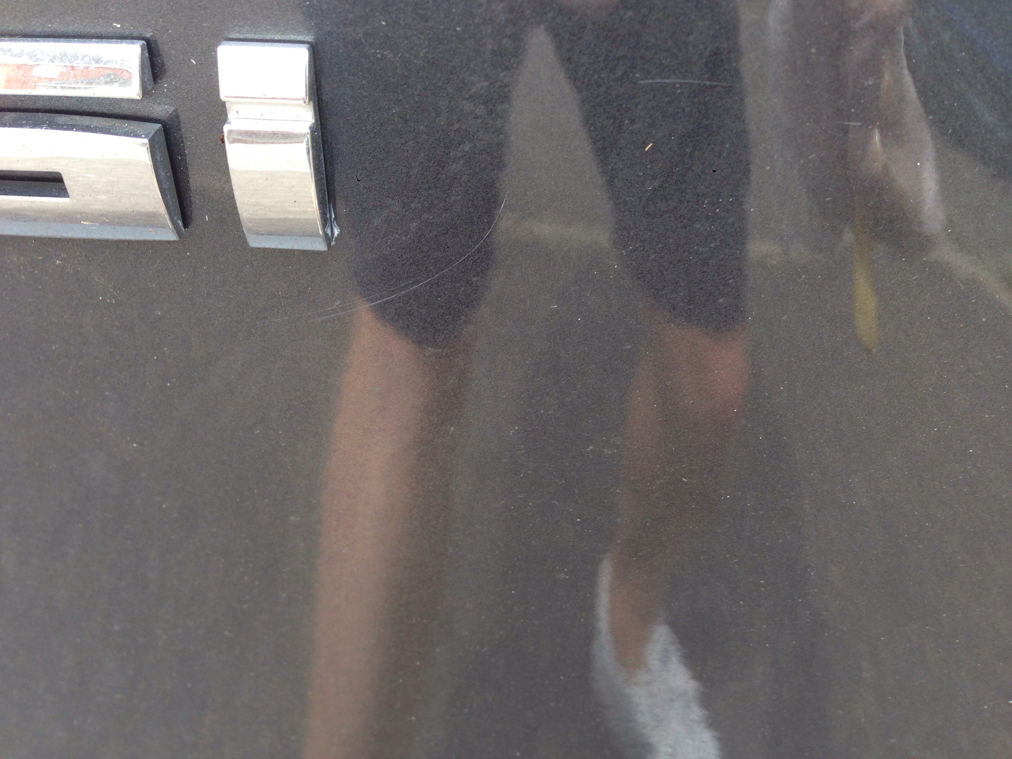

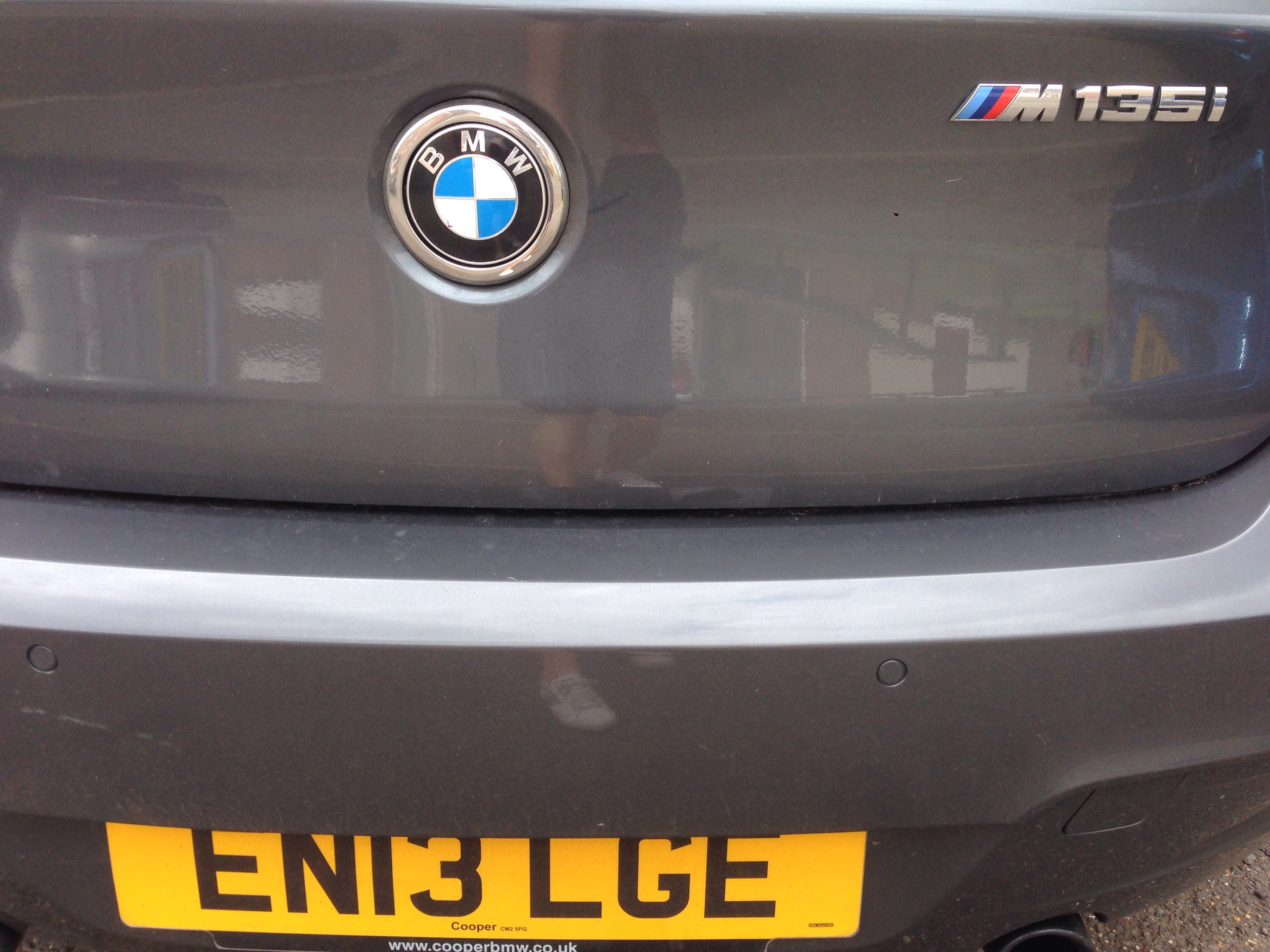

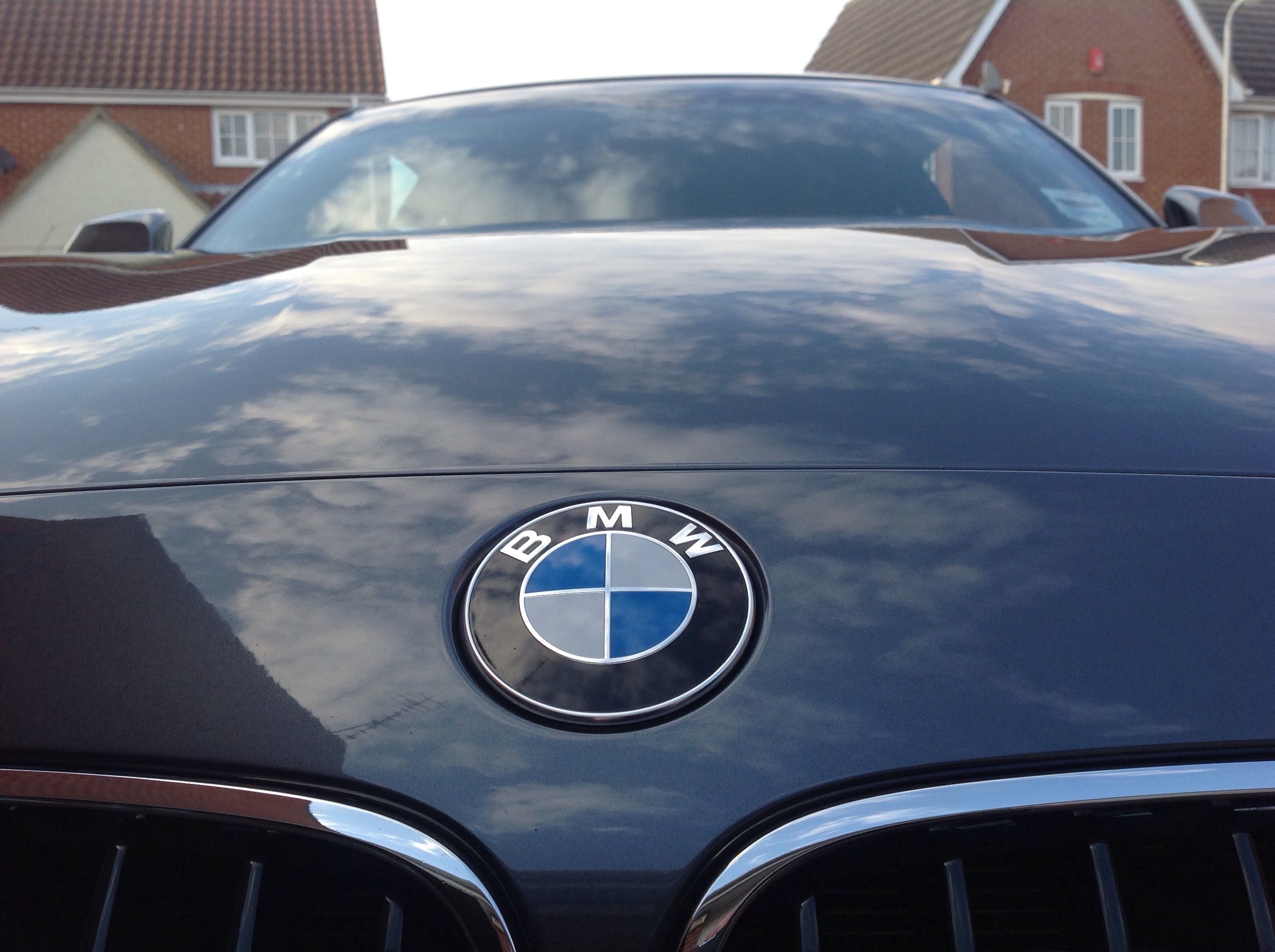

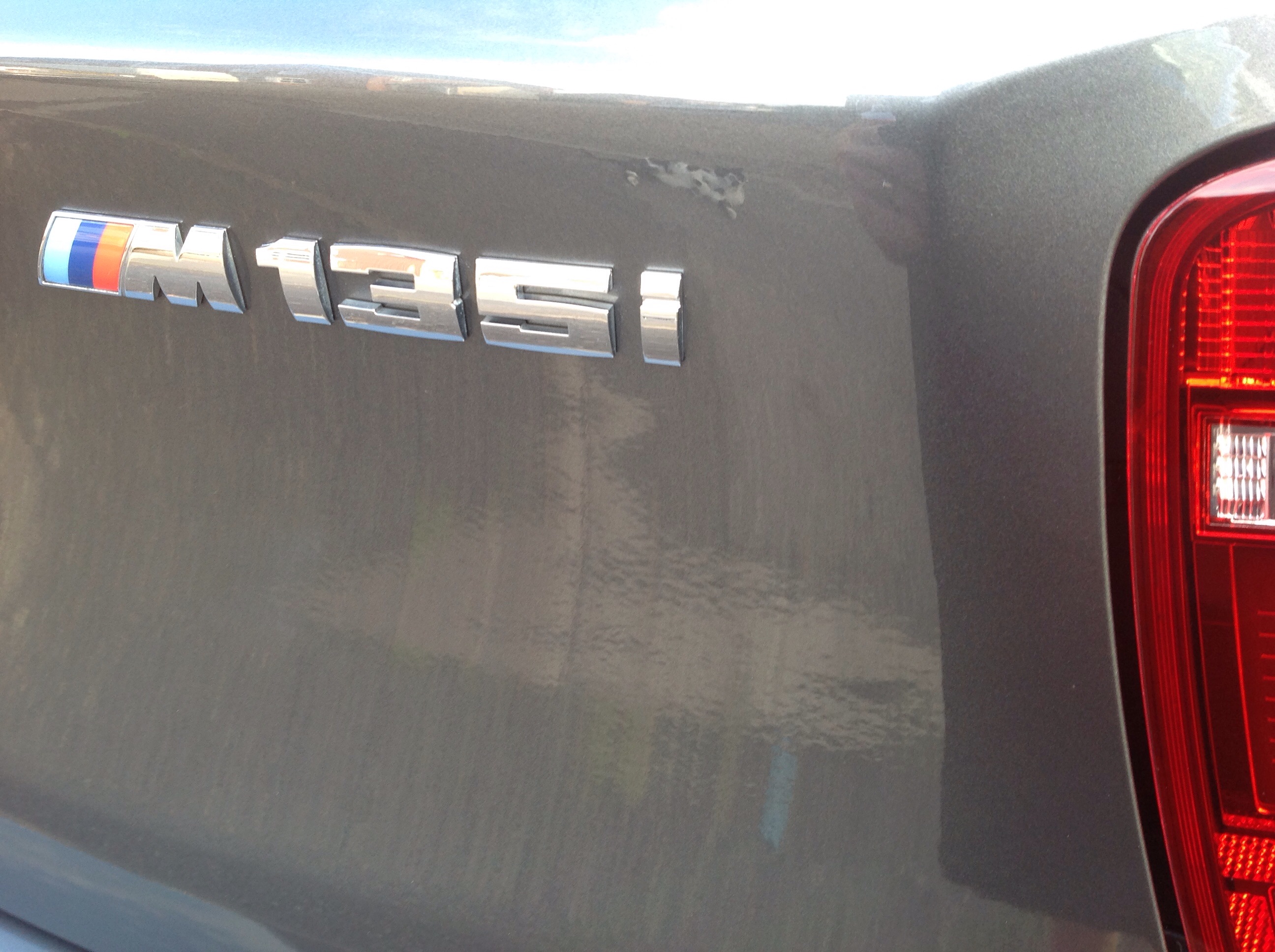

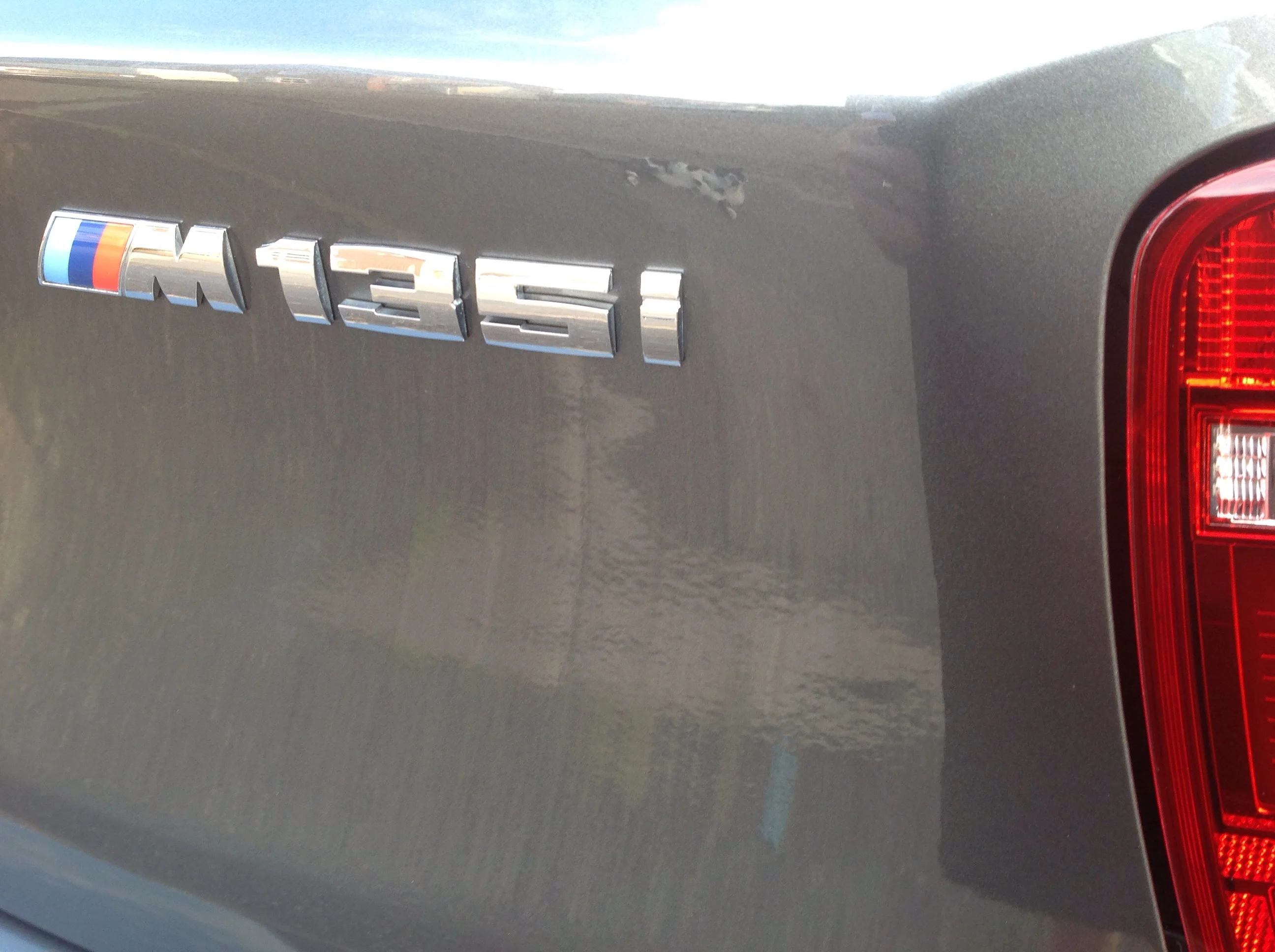

There was a couple of light scratches on the boot lid (see pics) which were not coming out with the 2200 Menzerna so I put a compounding spot pad on and used the 400FG Menzerna. I followed this up with a medium polishing spot pad and the 2200 Menserna as a second stage polish.
Once again I was really pleased with the results and more importantly Dan was over the moon with it.

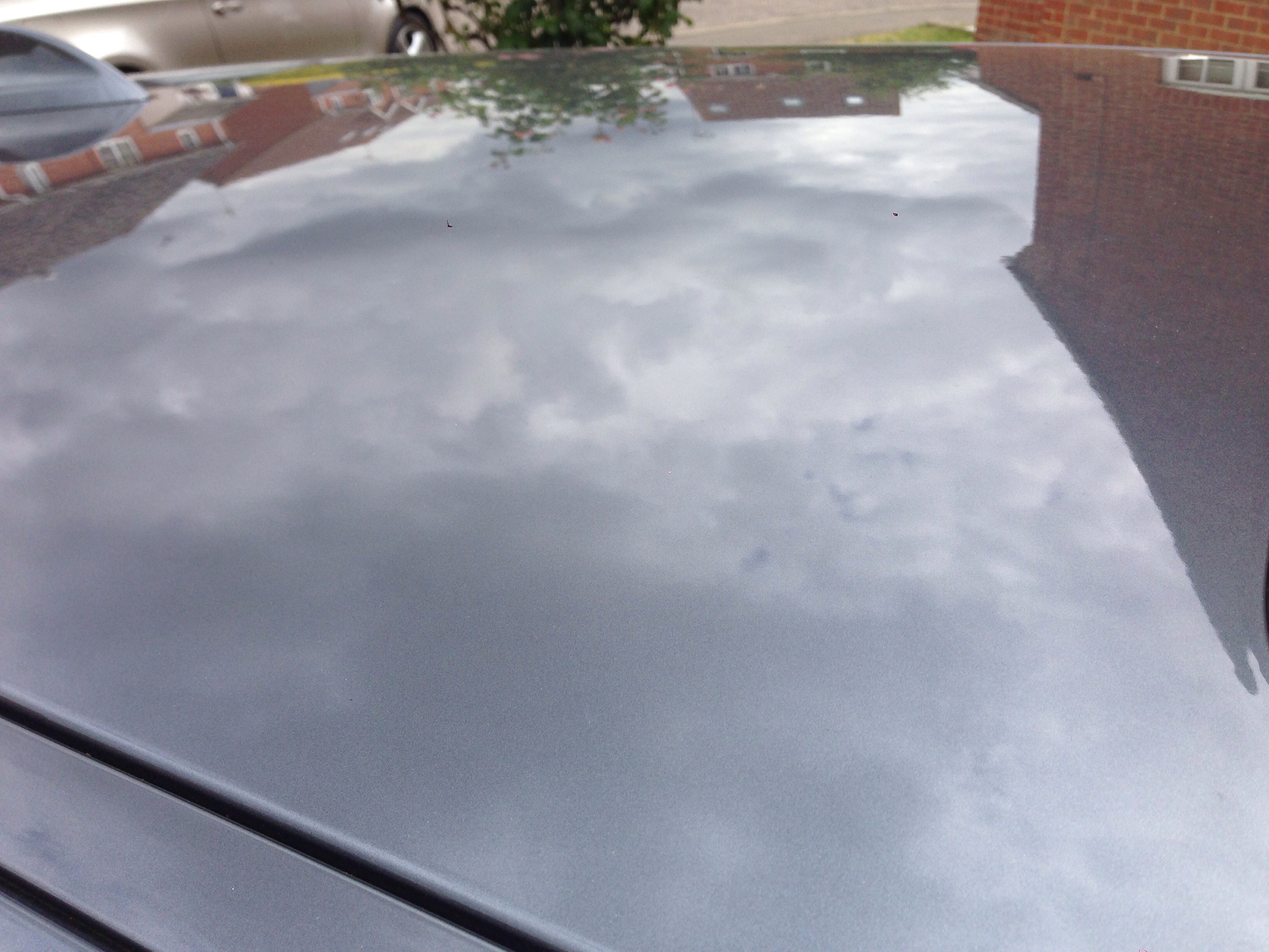

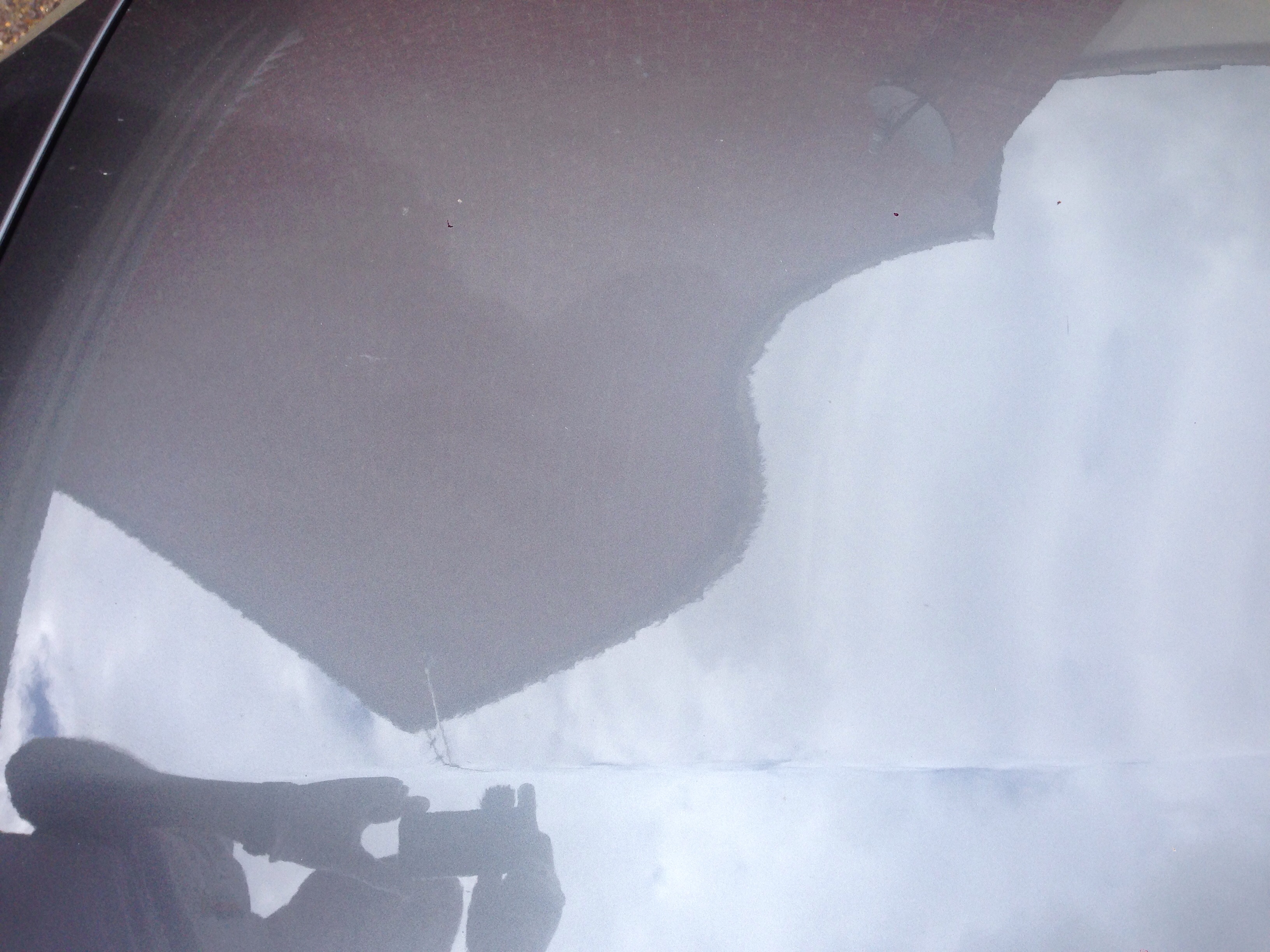

Some before pics
