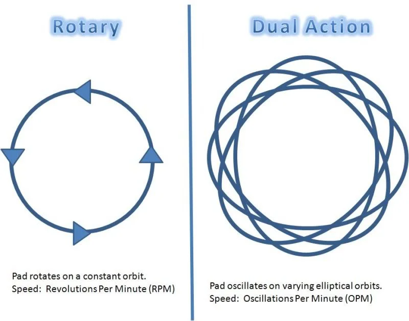

Youll probably get better results with a DA too, its a lot safer and easier to use and control where as a rotary likes to do what it wants, rotary is also heavier. Rotary takes some getting used to and its pretty easy to warp pannels from heat and take the edges off paint. Where as you can pretty much jump in and do what you want with DA (maybe a little more care with the DAS6 pro).

Okay so to answer your question Toms_clio, I THINK, the key difference between the DAS6 and the DAS6 Pro is more torque. Which means itll bite more and have more power. Basically, on the G220 and I assume the DAS6 too, when you push down hard on the machine it will stop spinning, but continue oscillating to prevent damage to the paintwork. I assume the DAS6pro will continue spinning even under heavy pressure but im not sure. I have the G220 and it definately needs more torque, which is why I said i would have got the DAS6 pro in hindsight. The g220 is unreliable, but Meguairs are brilliant at replacing them with no fuss.
With a rotary it just spins, and if you press down hard, well, youll have a big tasty mark on your paintwork.

Don't start out with a Rotary, i see people trying to finish with a rotary and if your skills arent what they should be for rotary finishing, it will look worse than a D/A
