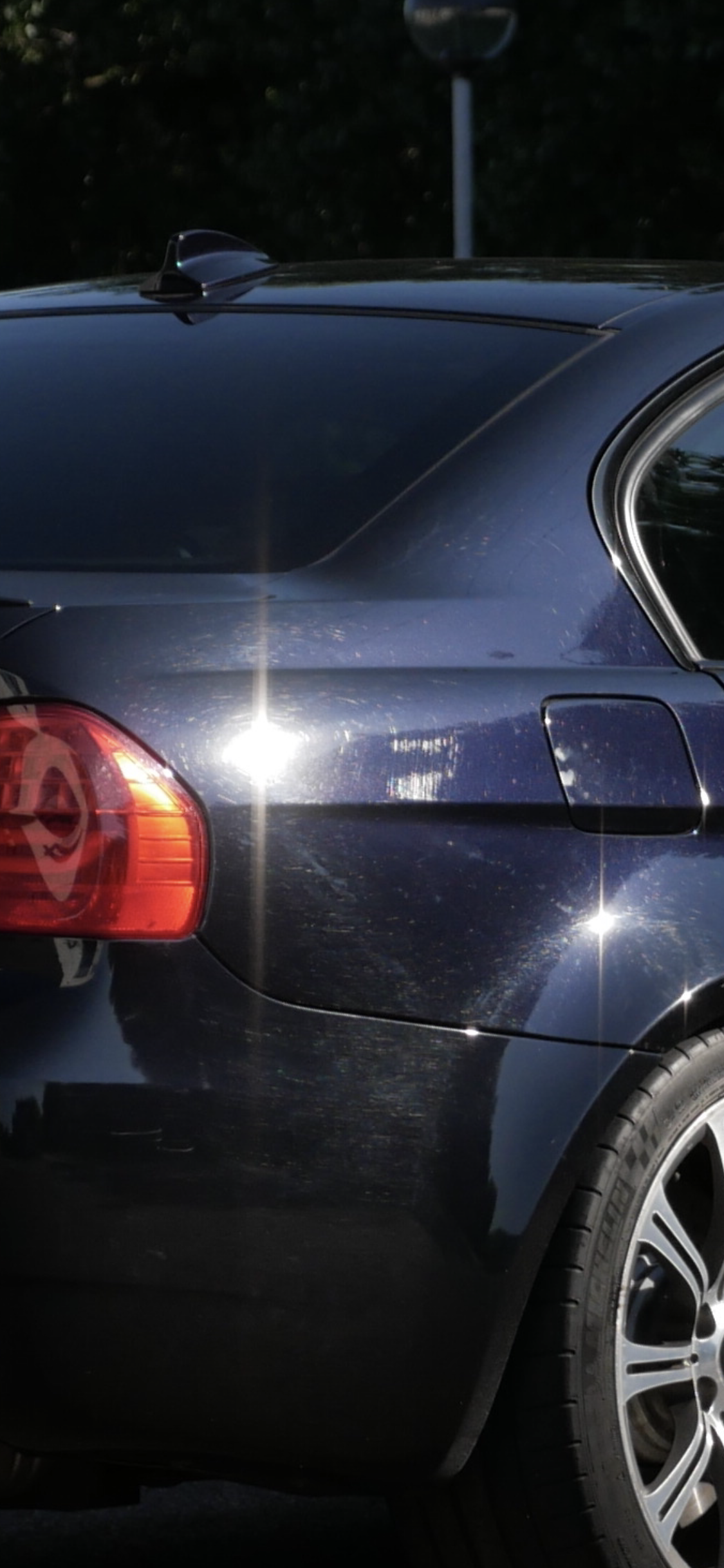

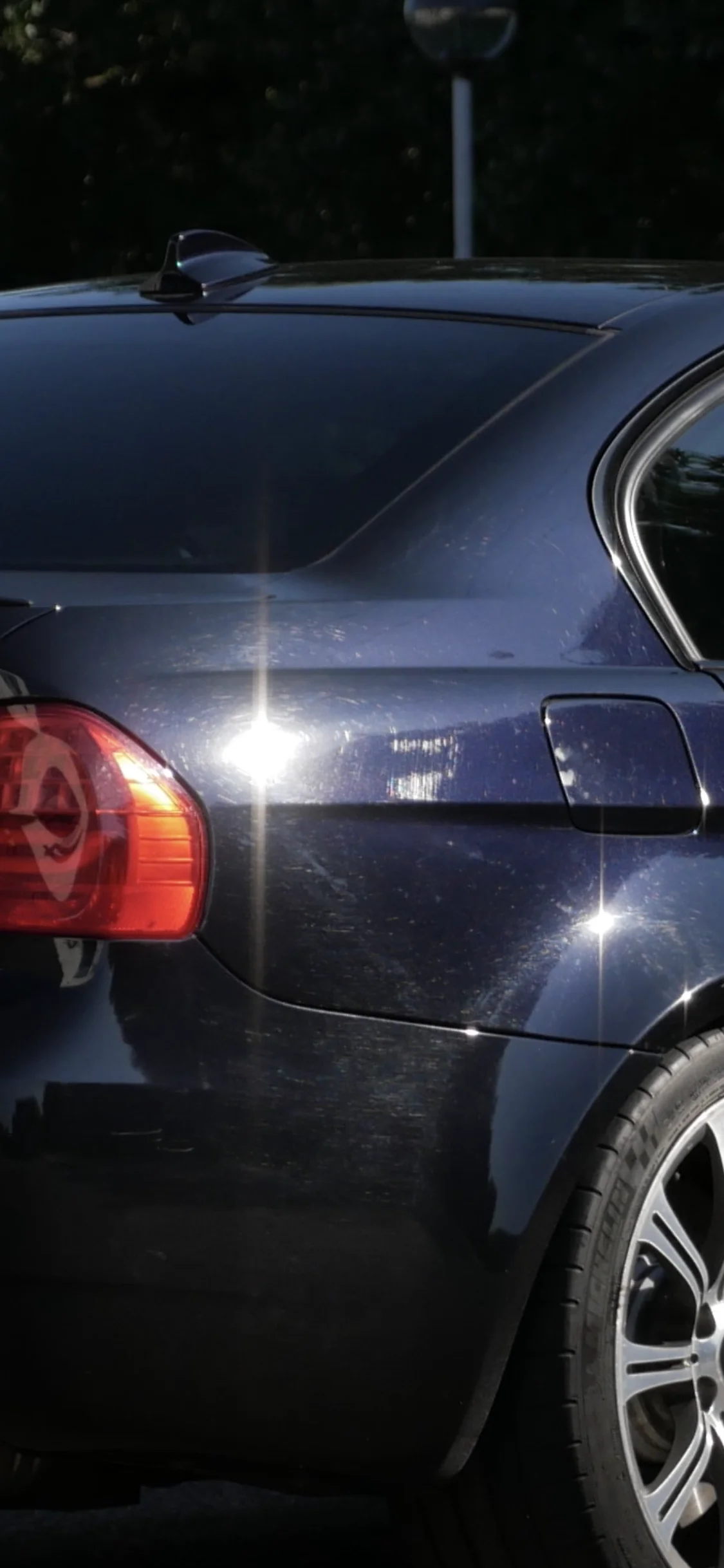

To give you an idea of what I was working with:
It’s a job to sort this year. I can only imagine the previous owners detailing kit comprised of acid, a brick, and SRP.

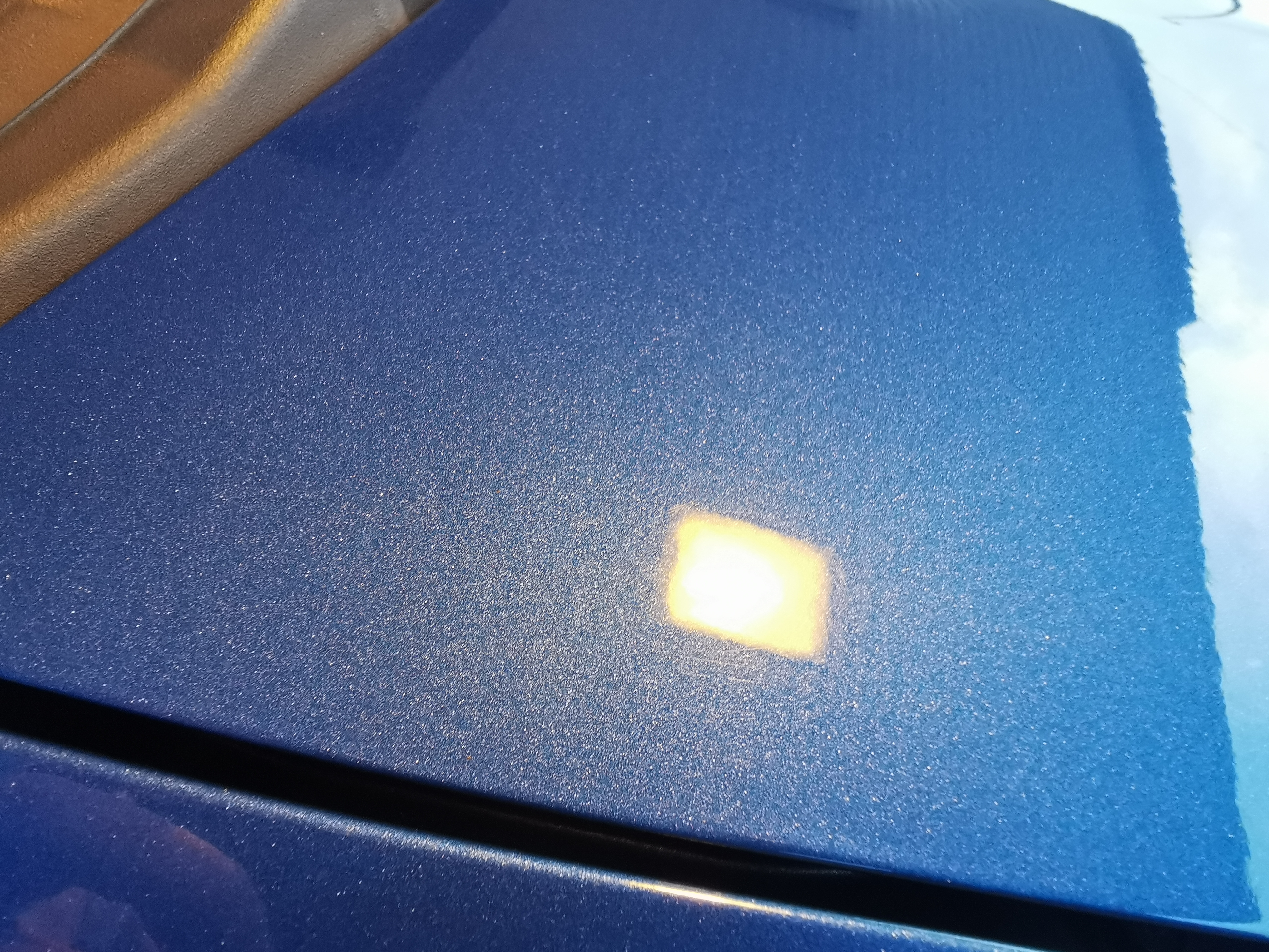

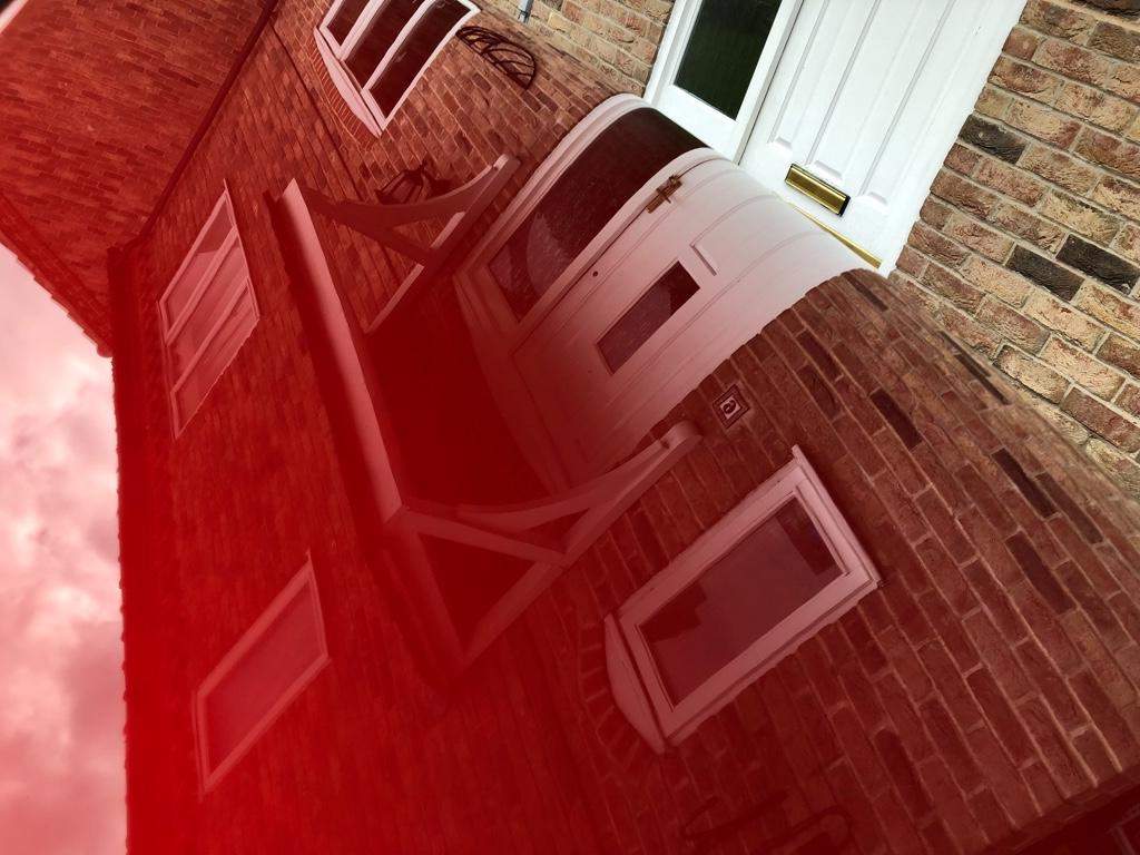

I love a bit of wet sanding, it's not that bad and the results are amazing. You can see the orange peel and lack of detail on the stitching on the bag strap in comparison to once it's been sanded and polished back. This was only a quick job to get an idea of what the paint was like on the daily and using different types of sanding processes, by hand is the best.

Just remember if your wet sanding, not to get tramlines when holding the paper to the panel. Plenty of lube too, keep the paper wet. I prefer a trigger spray bottle to a bucket of water. Less mess and easily manageable. If you hear a scratching noise, ditch the paper and start a fresh one.
Perhaps use 2000 on the bodywork. Last thing you'll want to do is break through the lacquer. And if you do go lower than that, I'd advise to go through the grades back up. Will mean less cutting that way too.
But I think wet flatting is a bit hardcore for a beginner. If you do decide to do it, perhaps start with the lower half of the doors.
