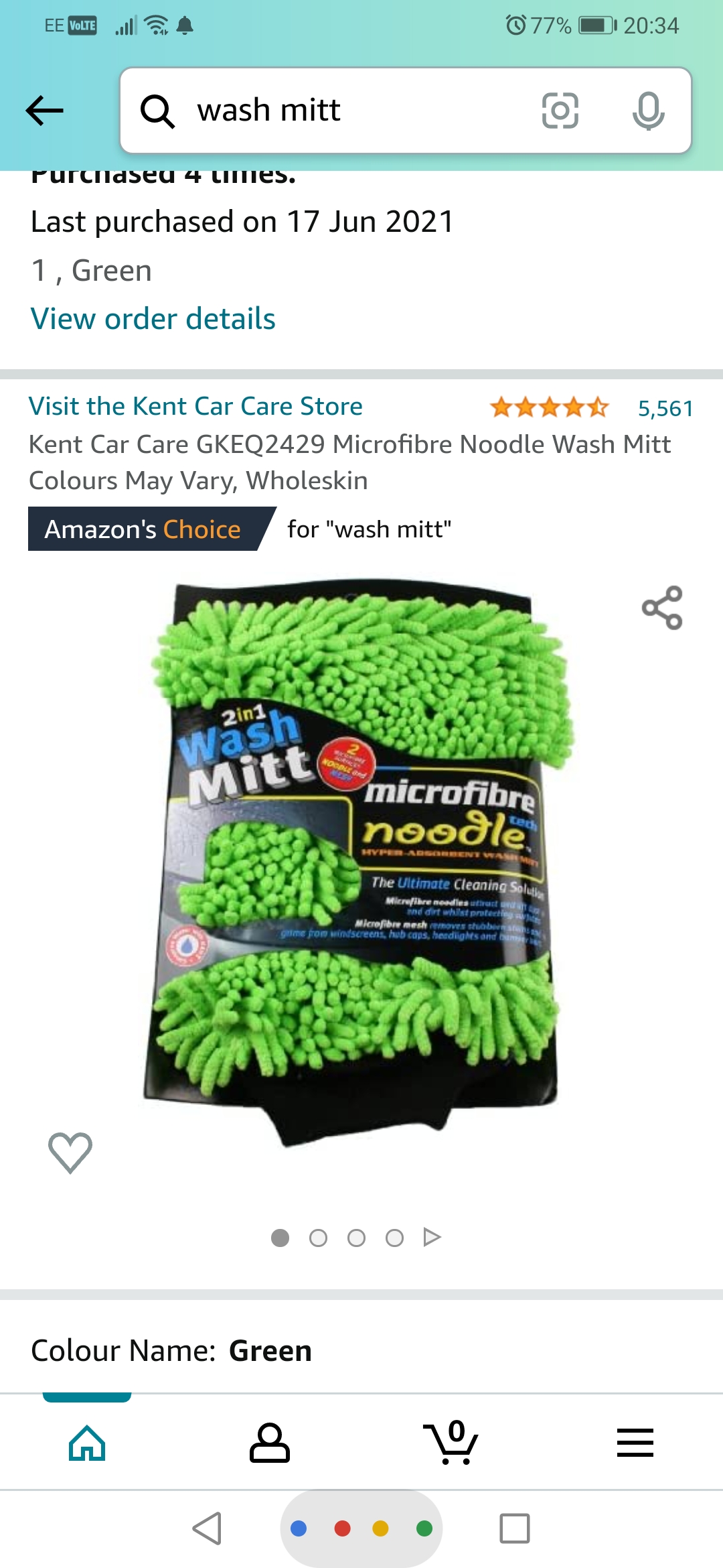

Wash mitt i have used and find great, cheap too.
Shampoo. Imo most the pH stuff is the same. I rate car chem 1900. It's good value when on offer and really economical.
