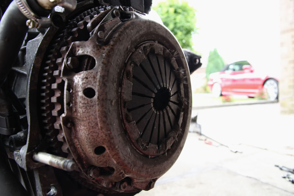

Another possible cause or result was some bent forks:

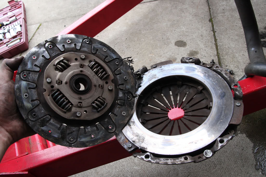

Due to the amount material shaking arround the bell housing I was lucky to make it home at all. On intitial inspection the plate looked ok:

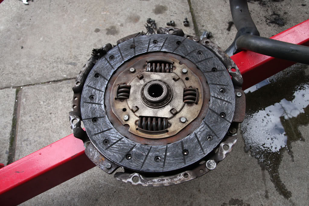

But flip it over and I have no friction material at all, it was all spread around the bellhousing or left in loose chunks.
I was expecting a scored fly wheel, but it was smooth and true so I must have been right on the cusp or causing damage.

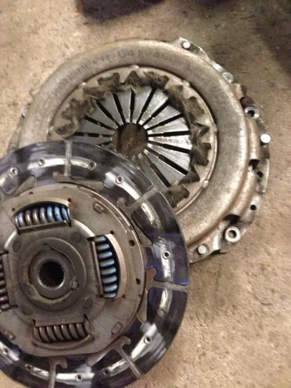

All three clutches failed on the pressure plate too by the looks of it.
