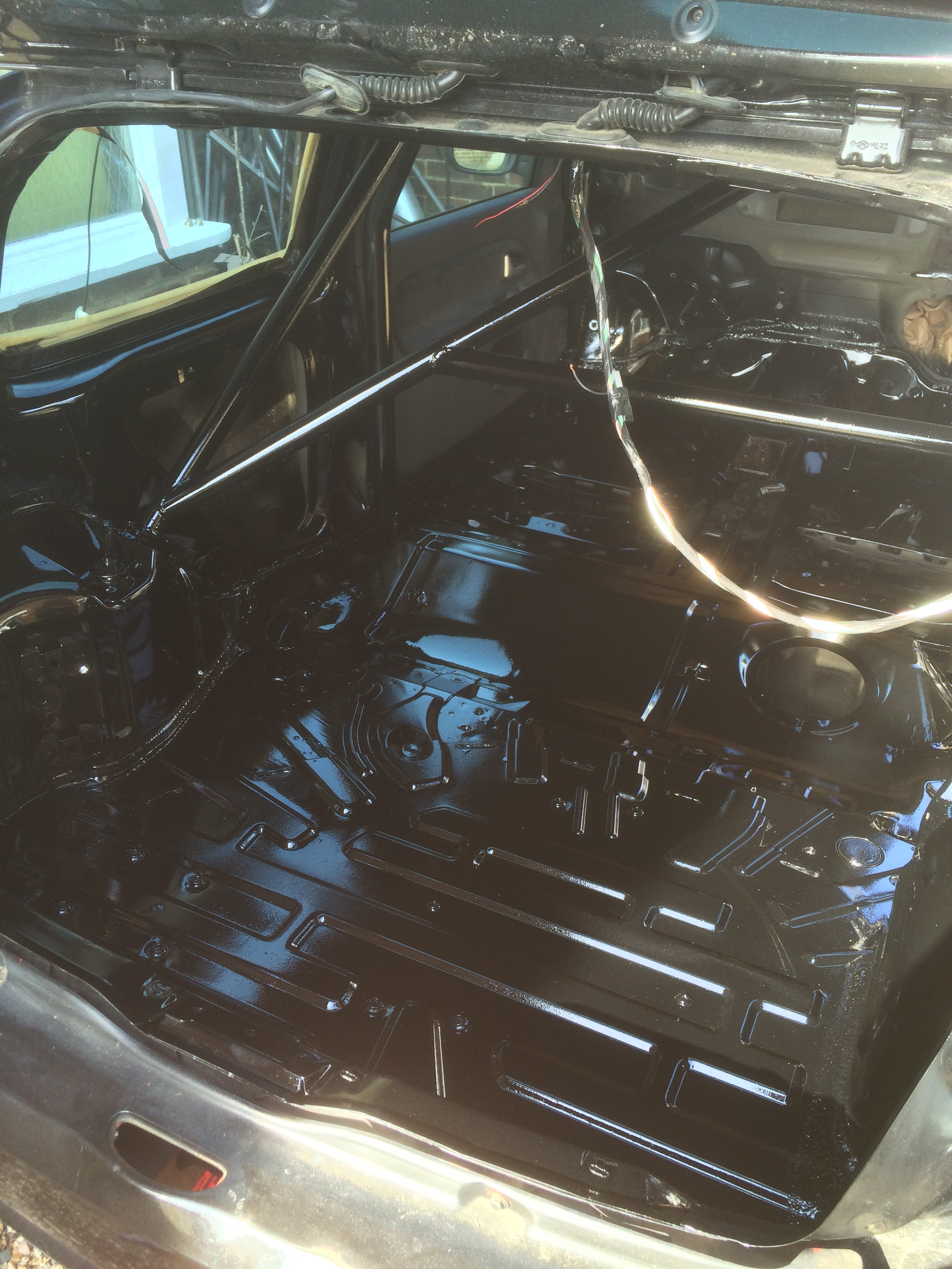

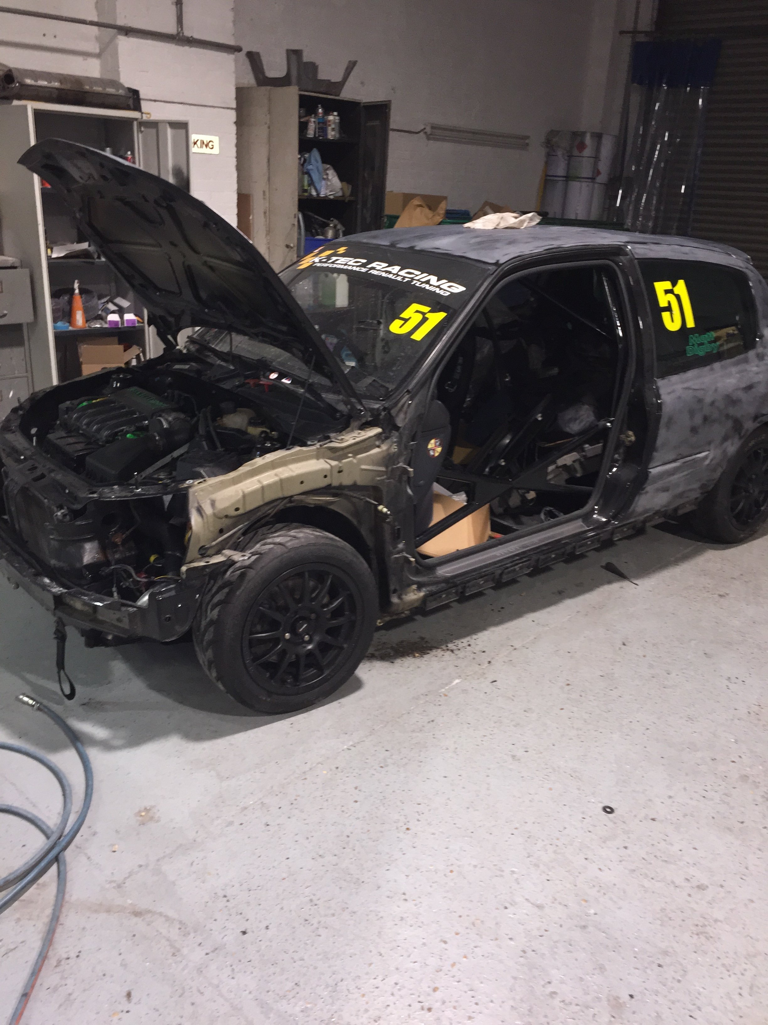

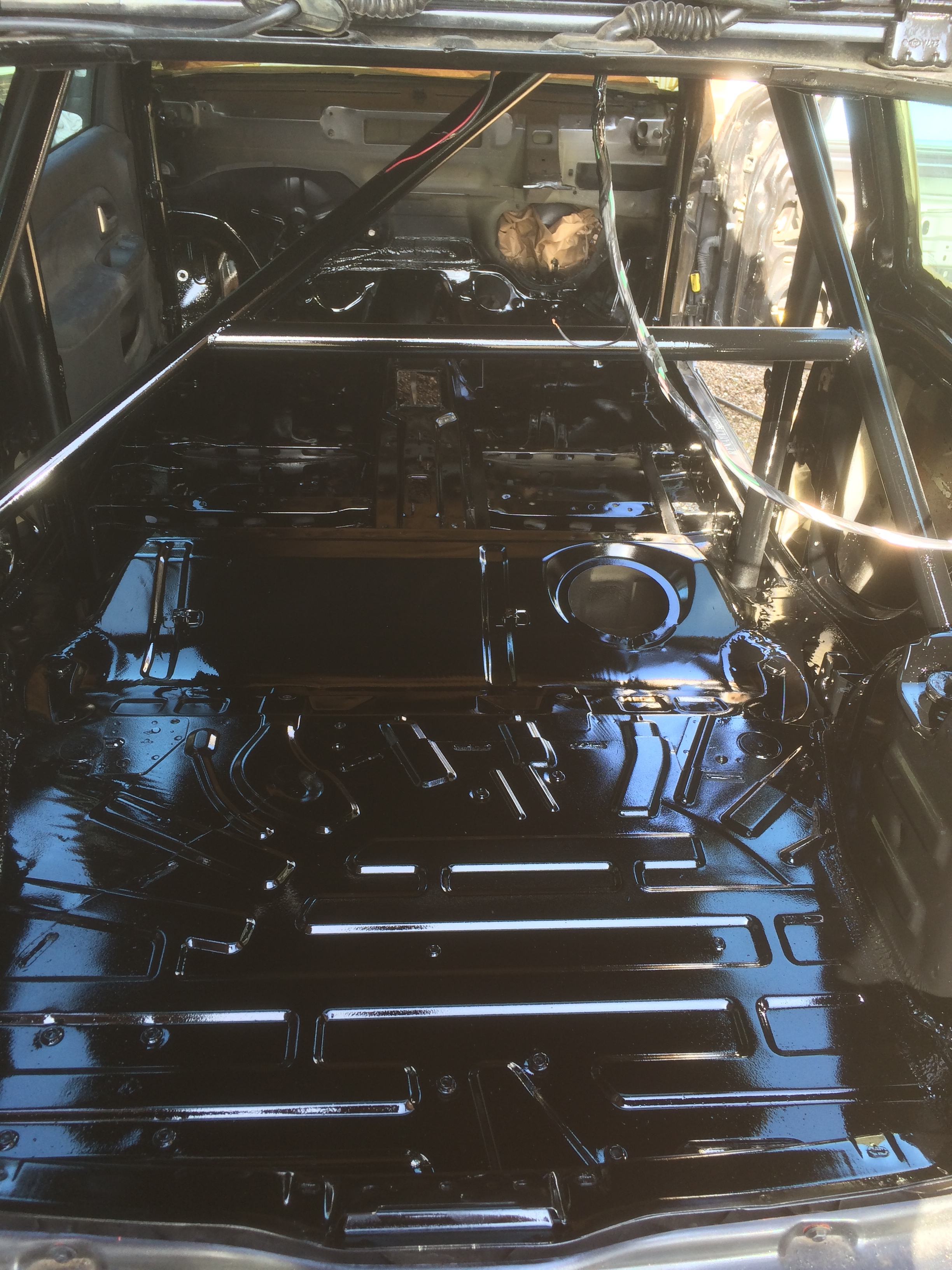

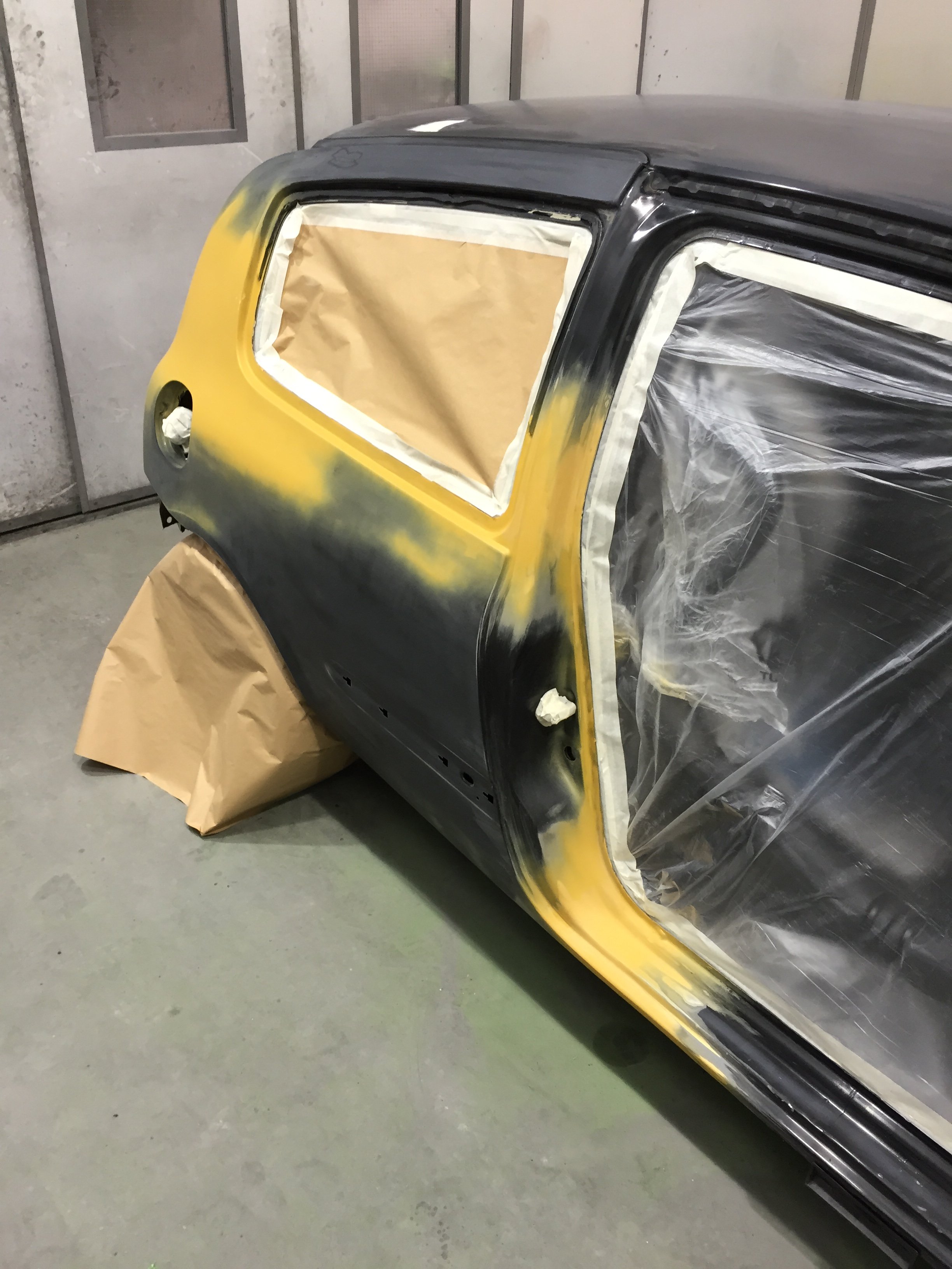

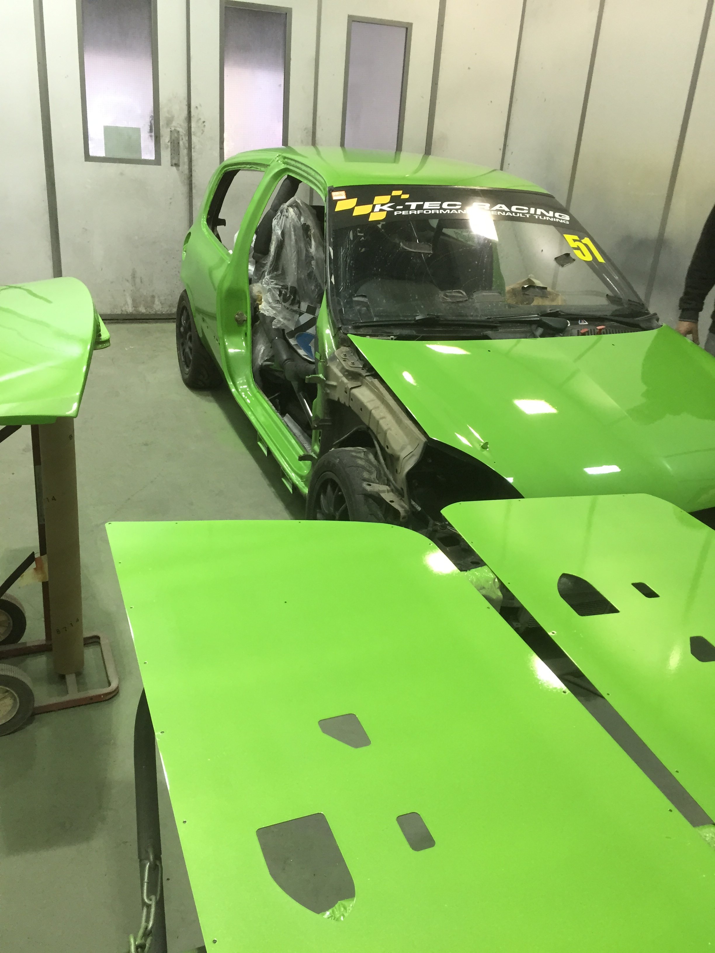

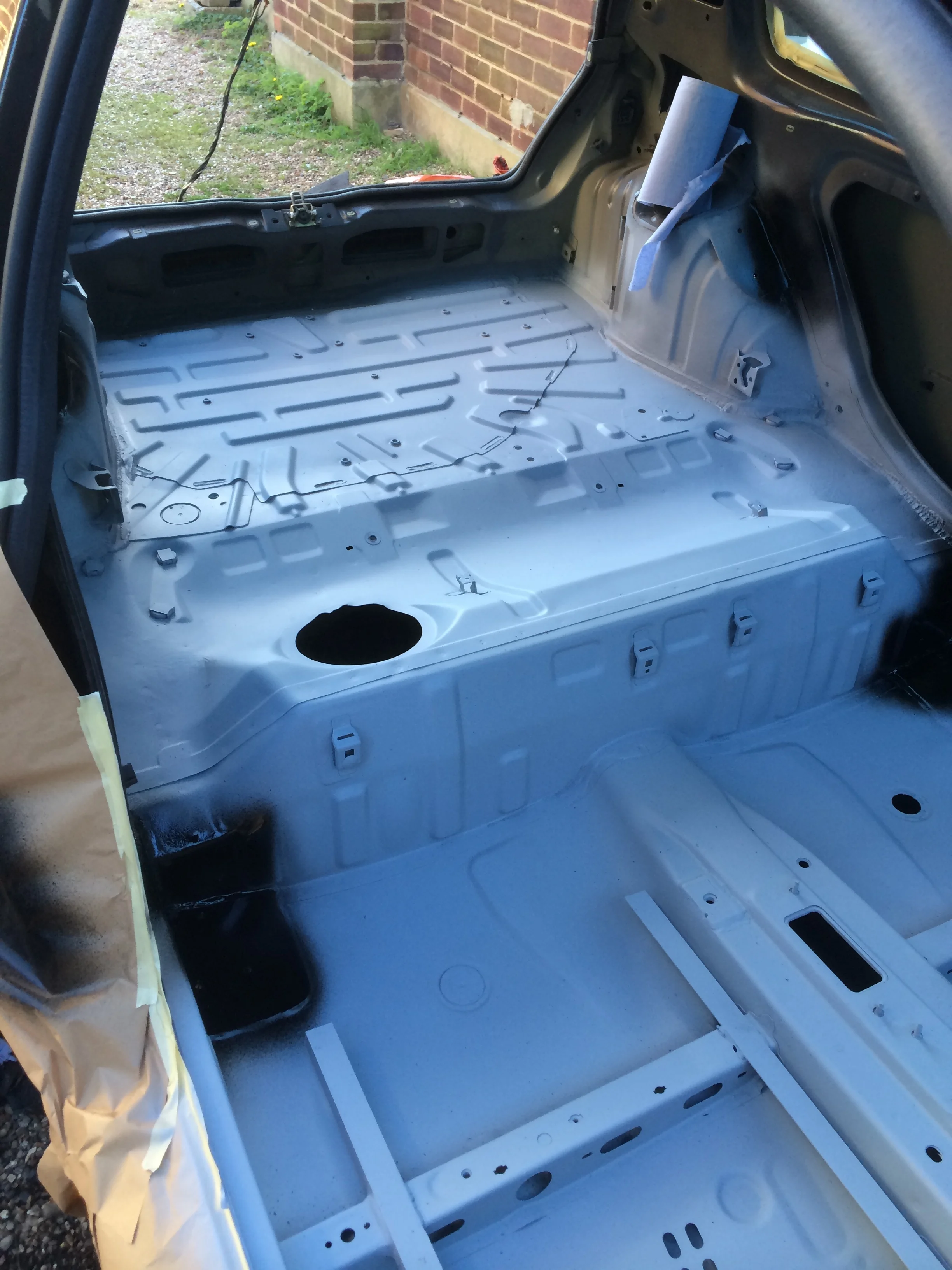

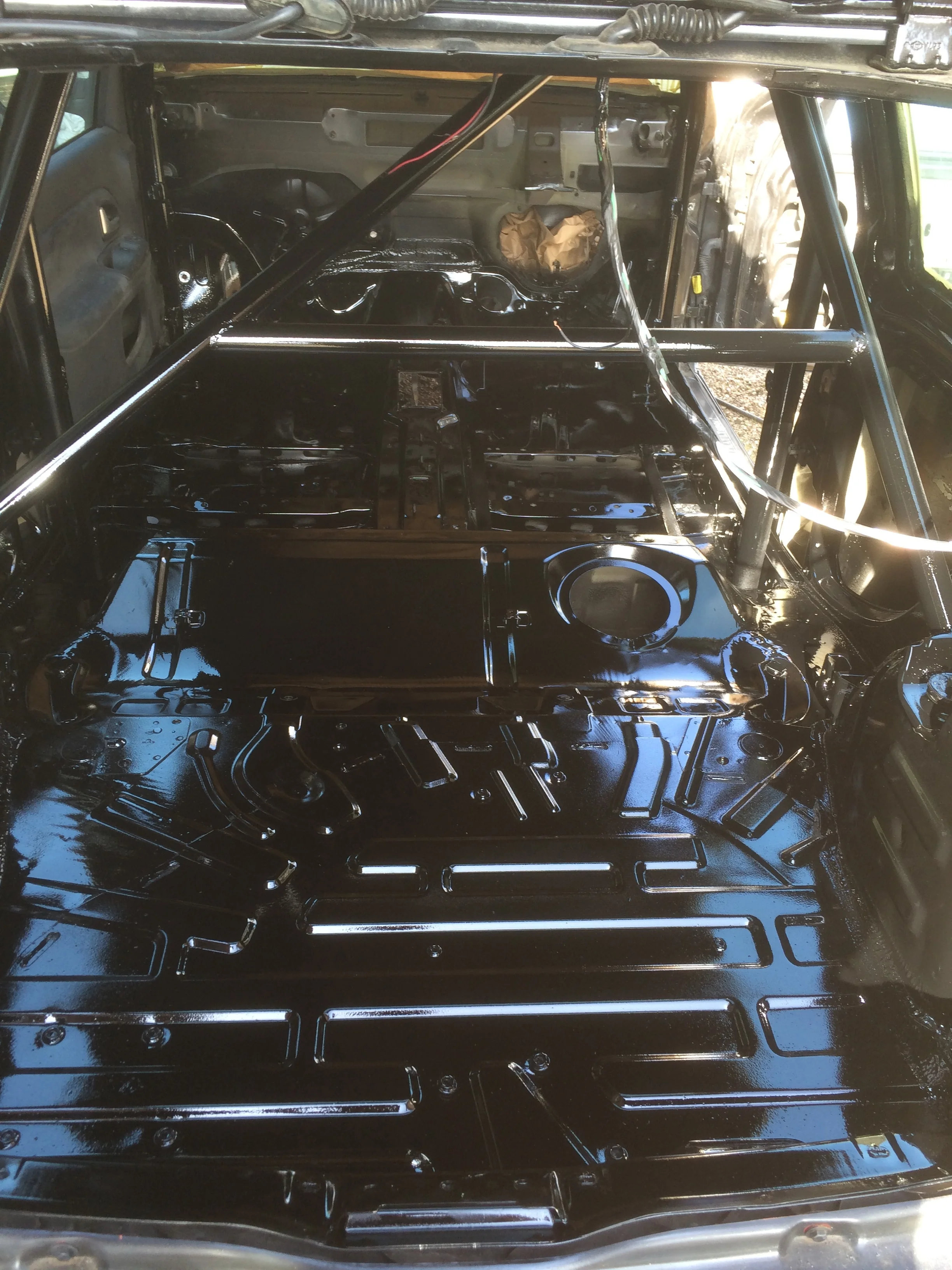

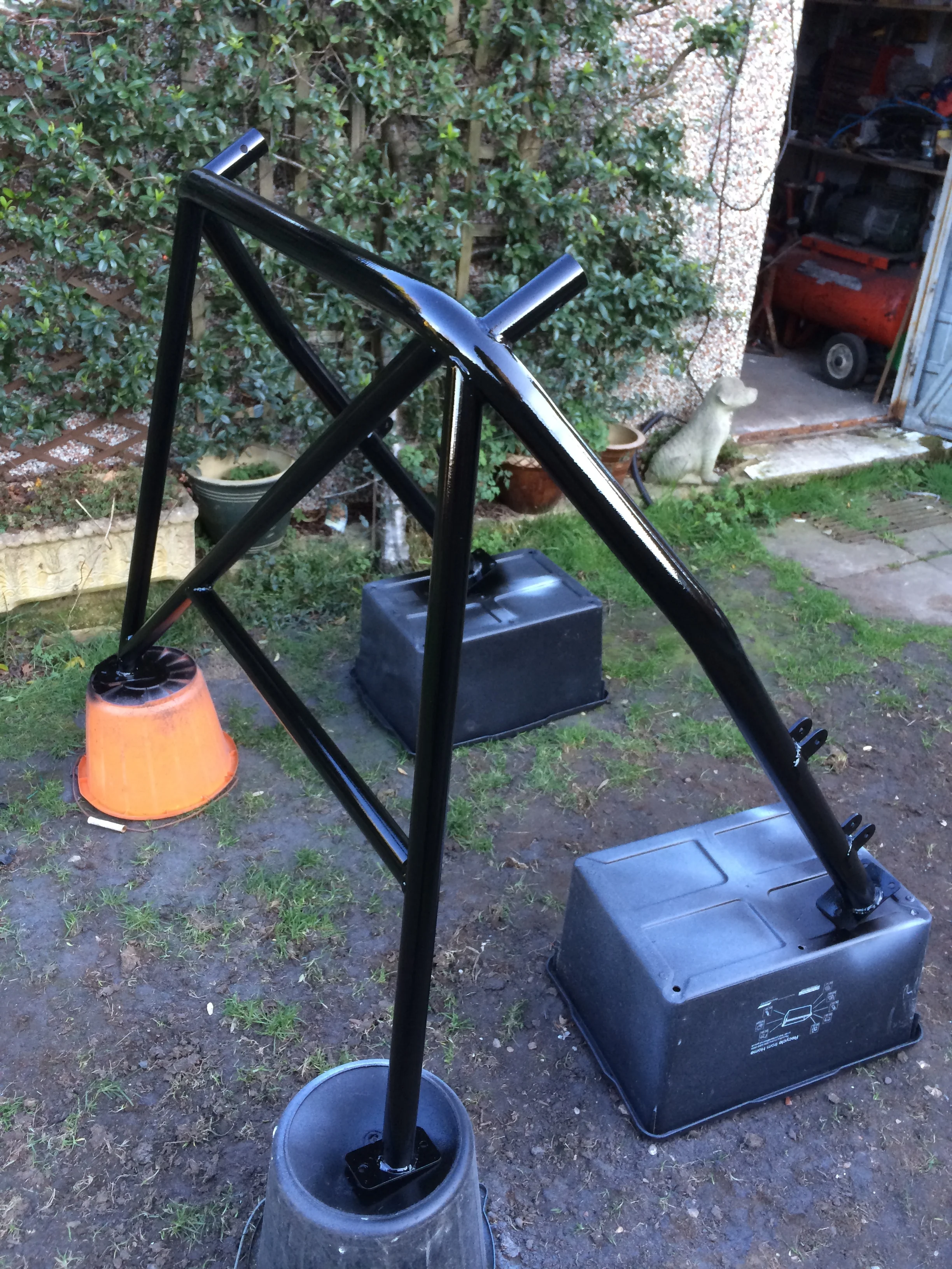

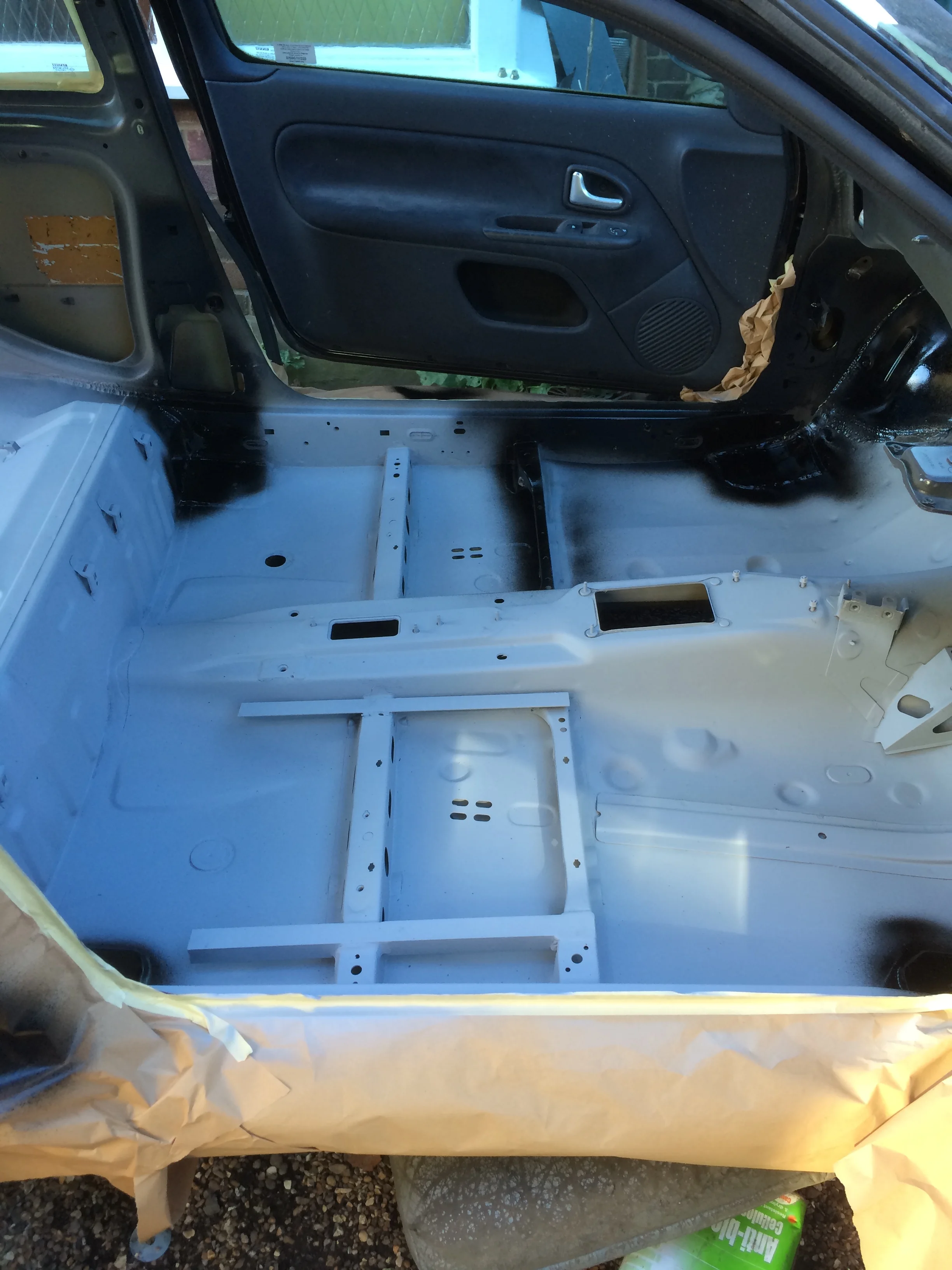

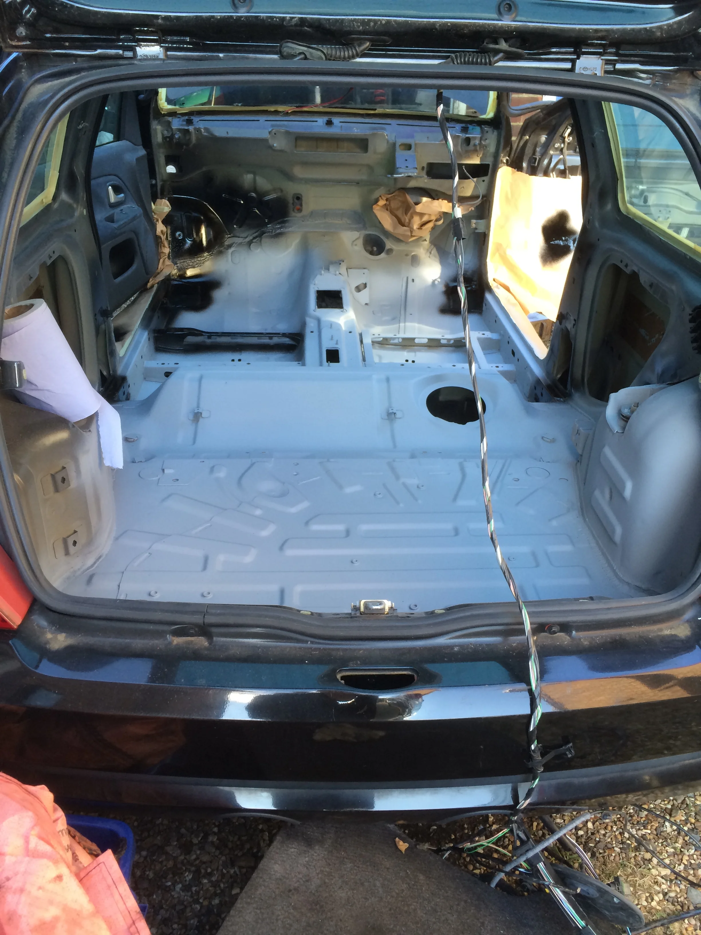

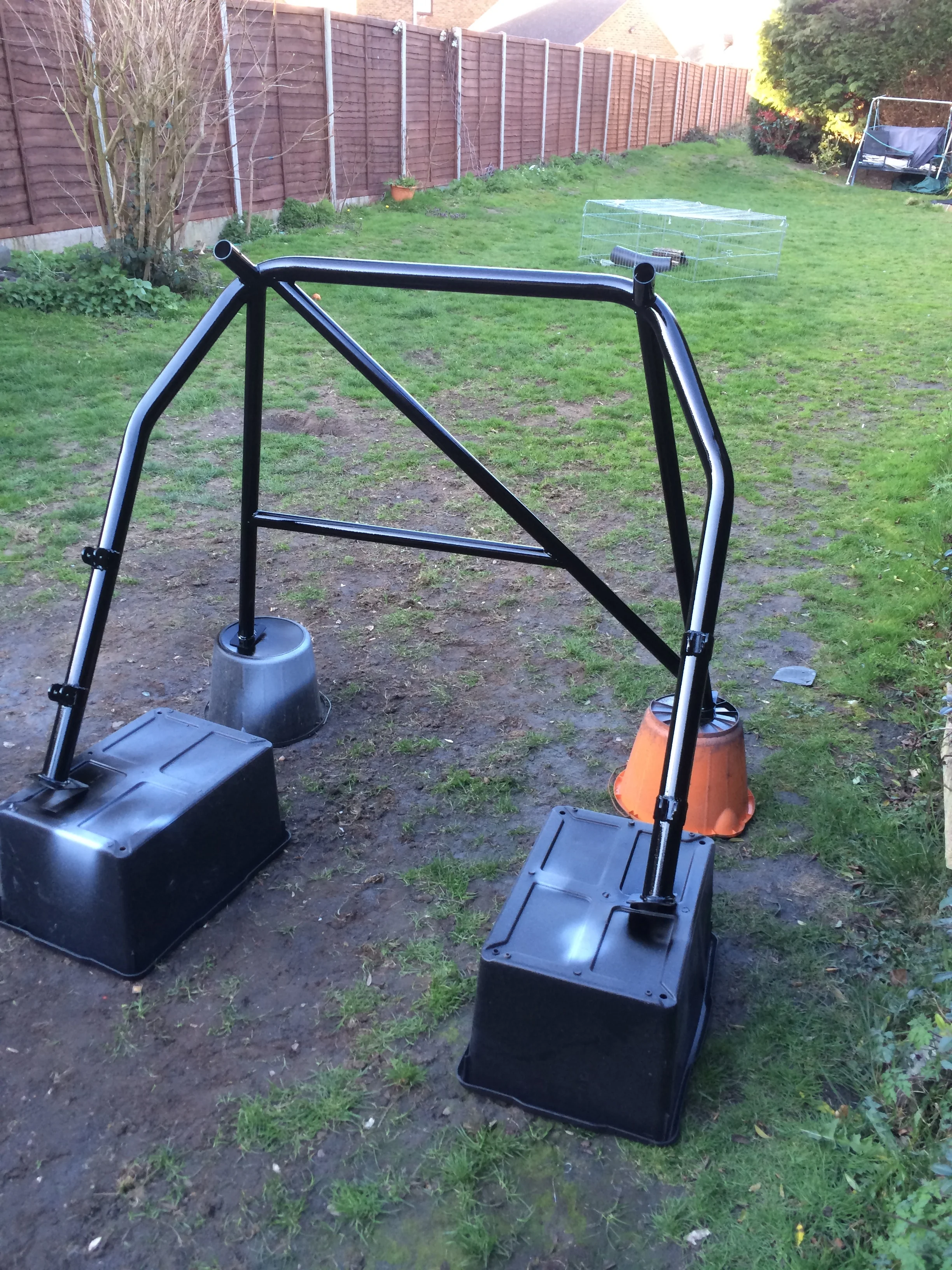

so first of, i brought a 182 with a blown engine , stripped it , welded in foot plates for the roll cage and welded in some right angle for the drivers seat which lowered it at the same time.

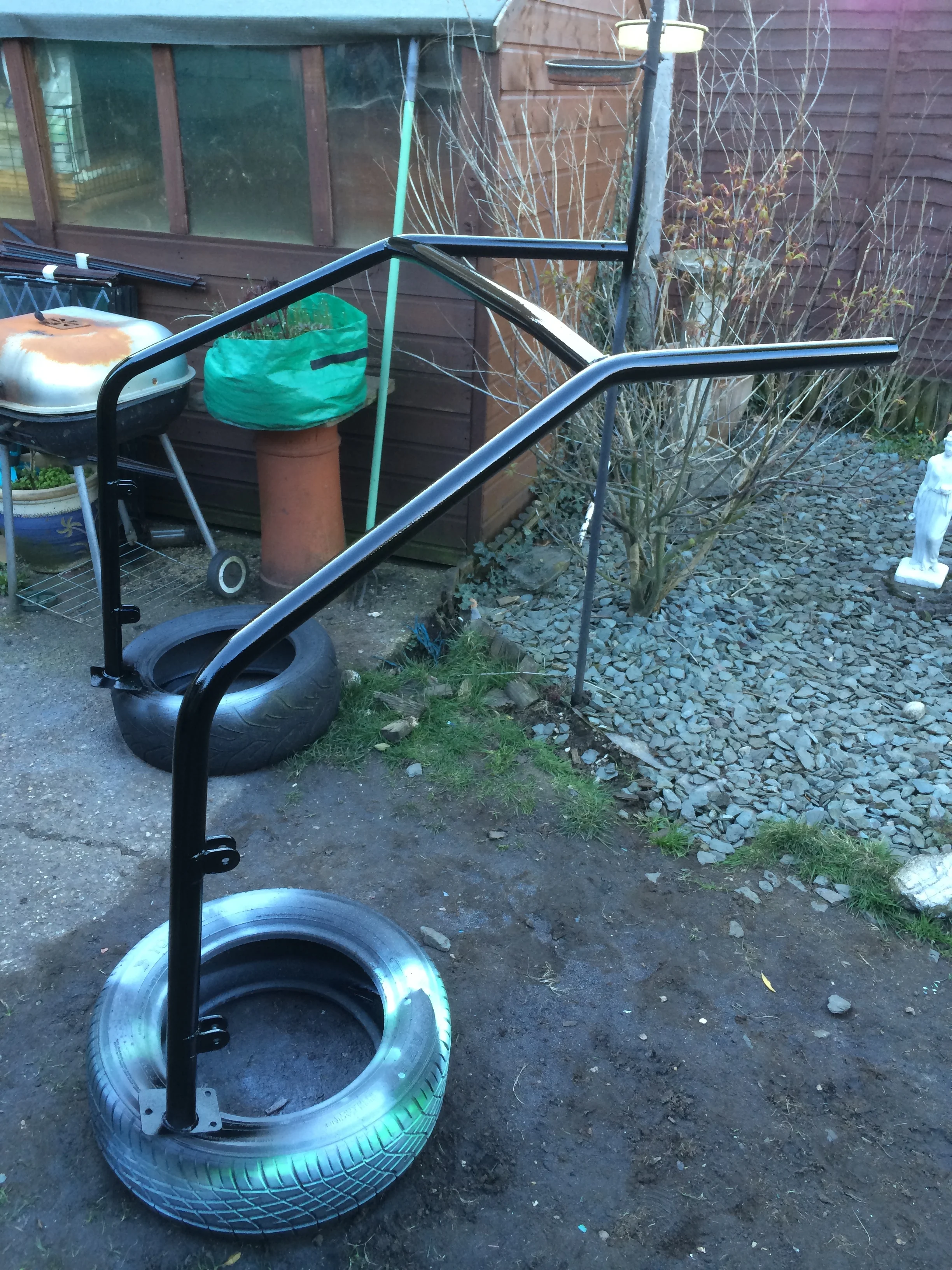

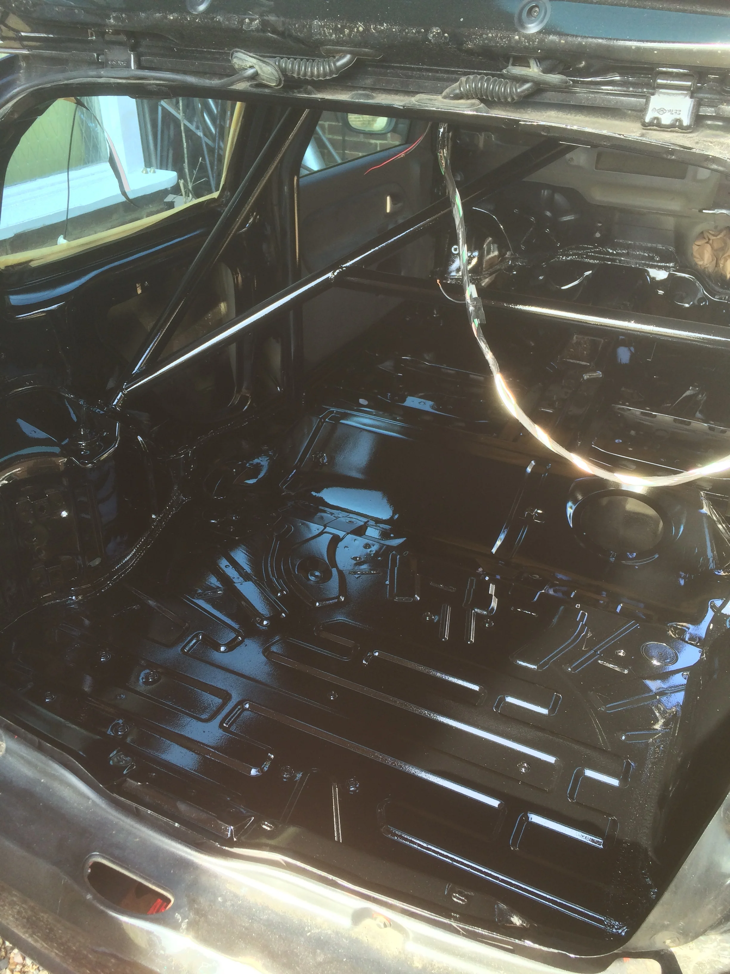

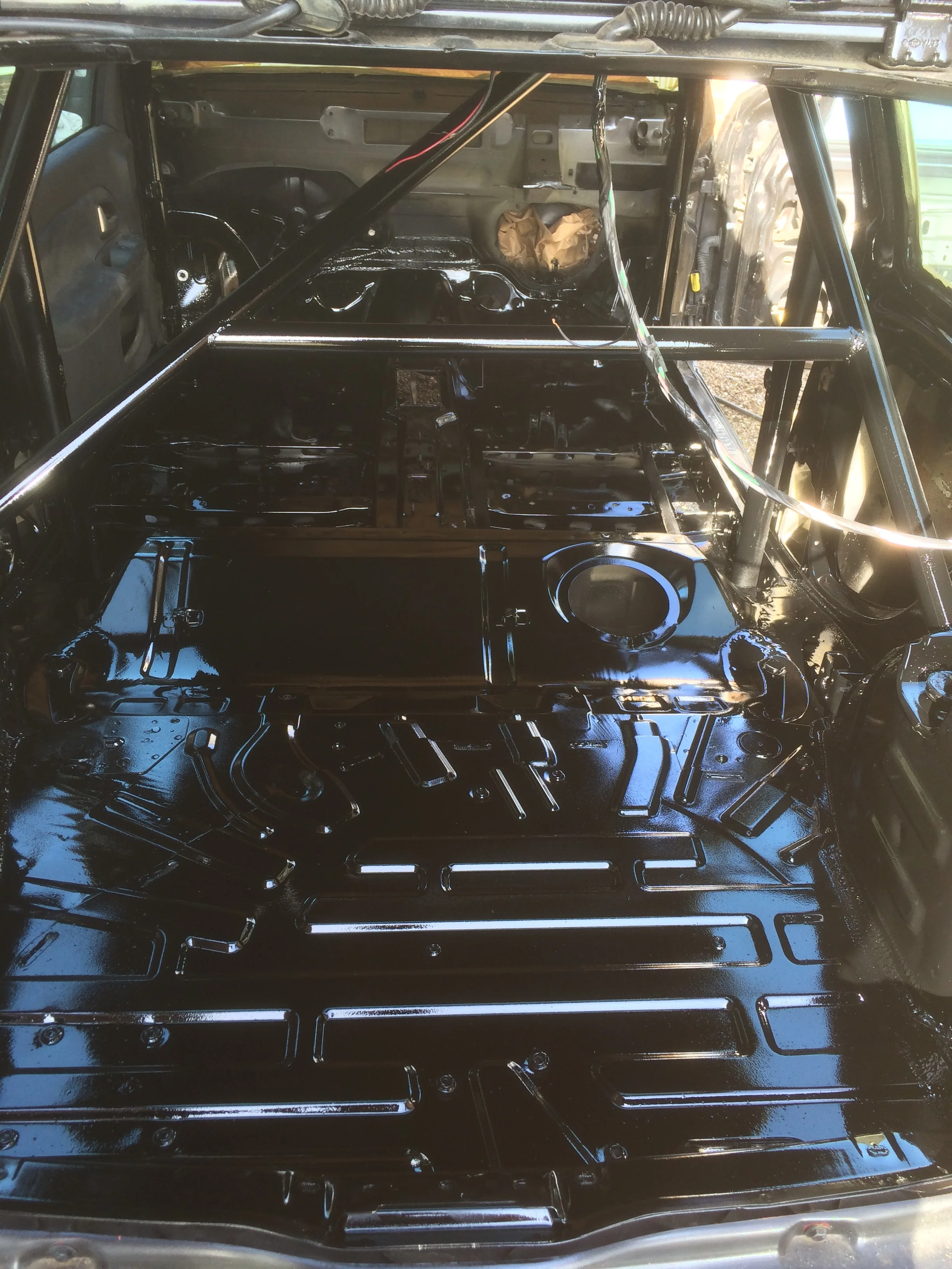

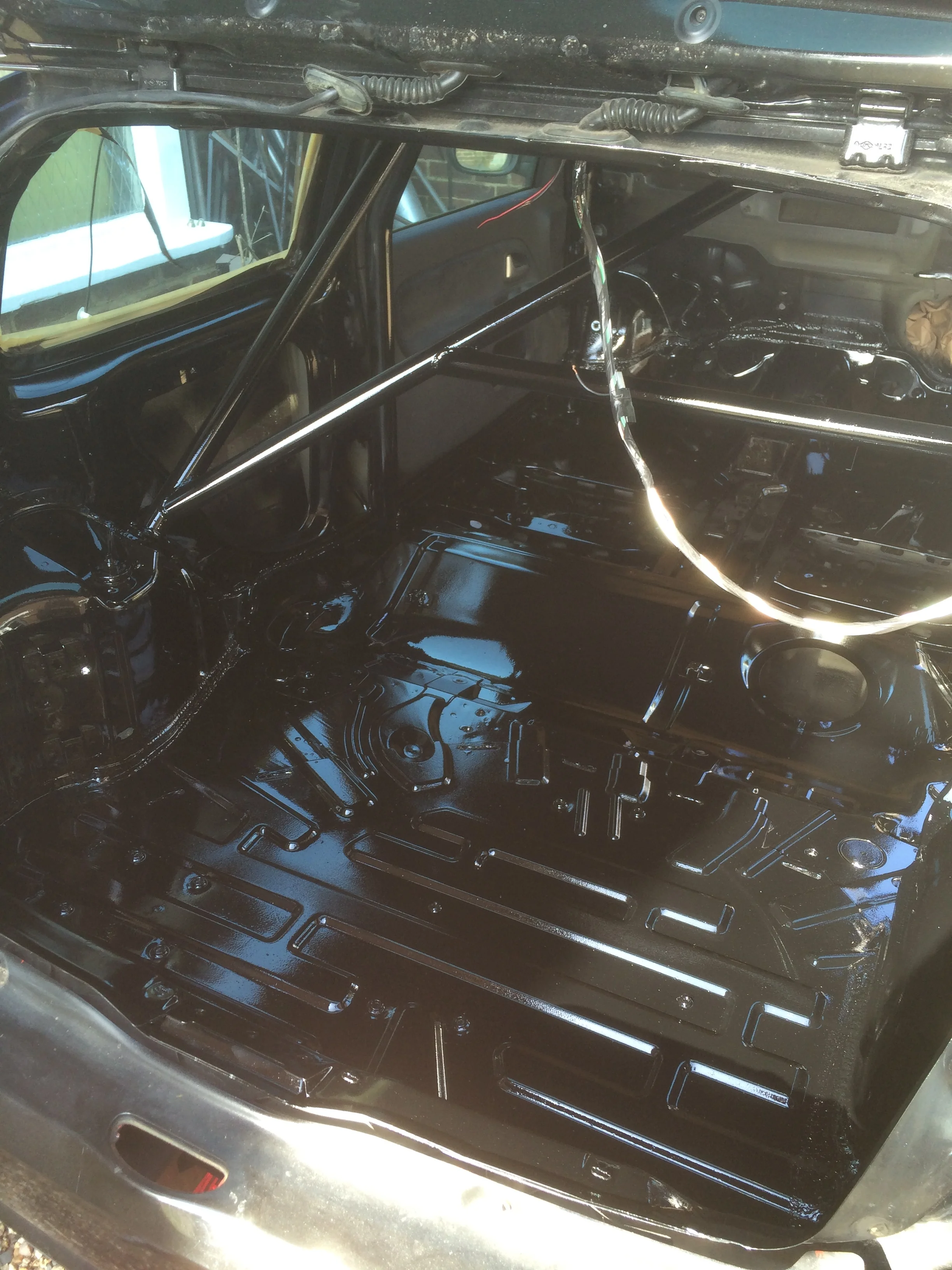

whilst waiting for the primer to dry off i painted the 6 point roll cage , i added a harness bar and ditched the single door bar for a double door bar that could be removed.
after painting the cage and inside the car, here are the results

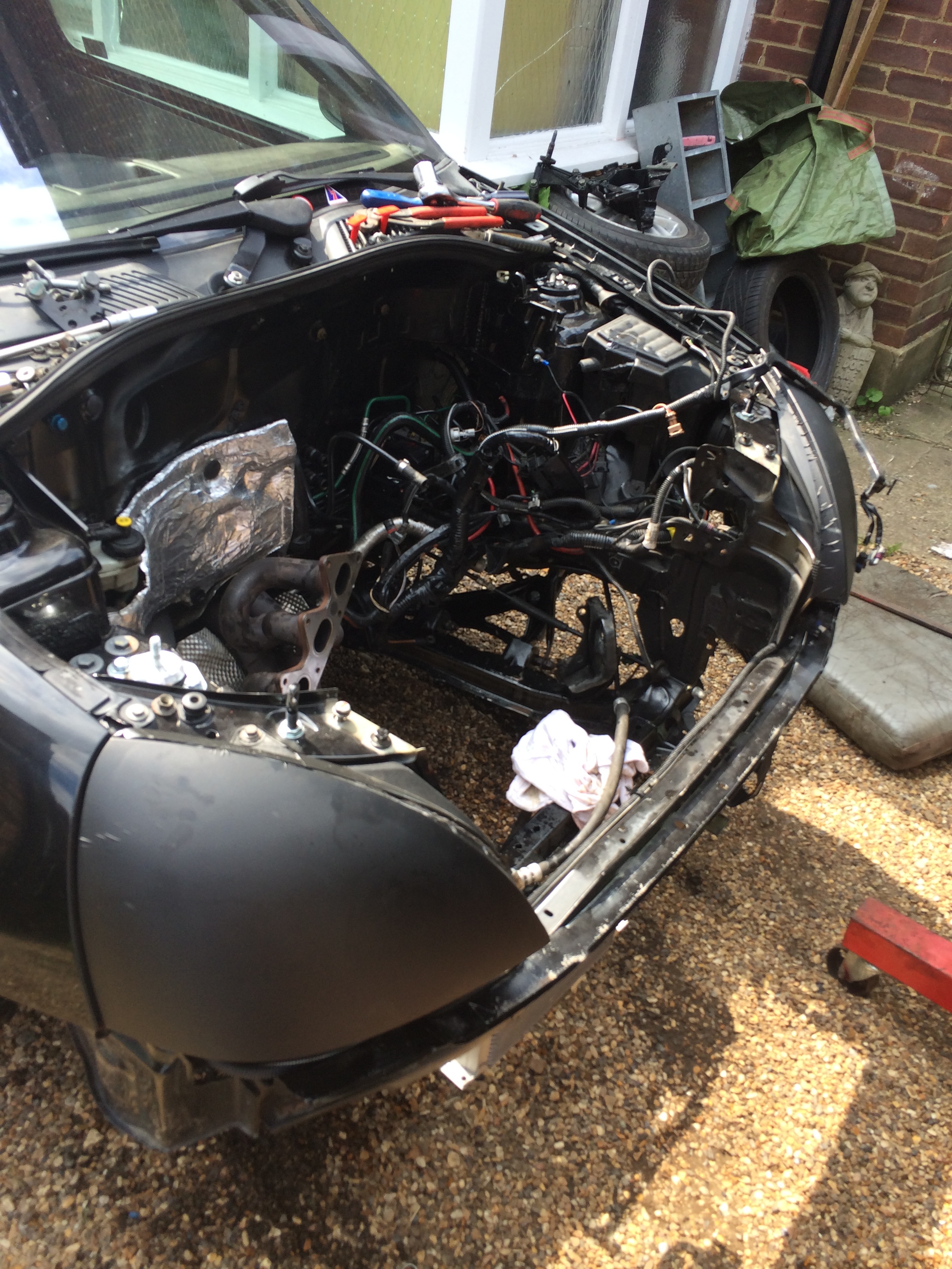

next thing to tackle was the engine.

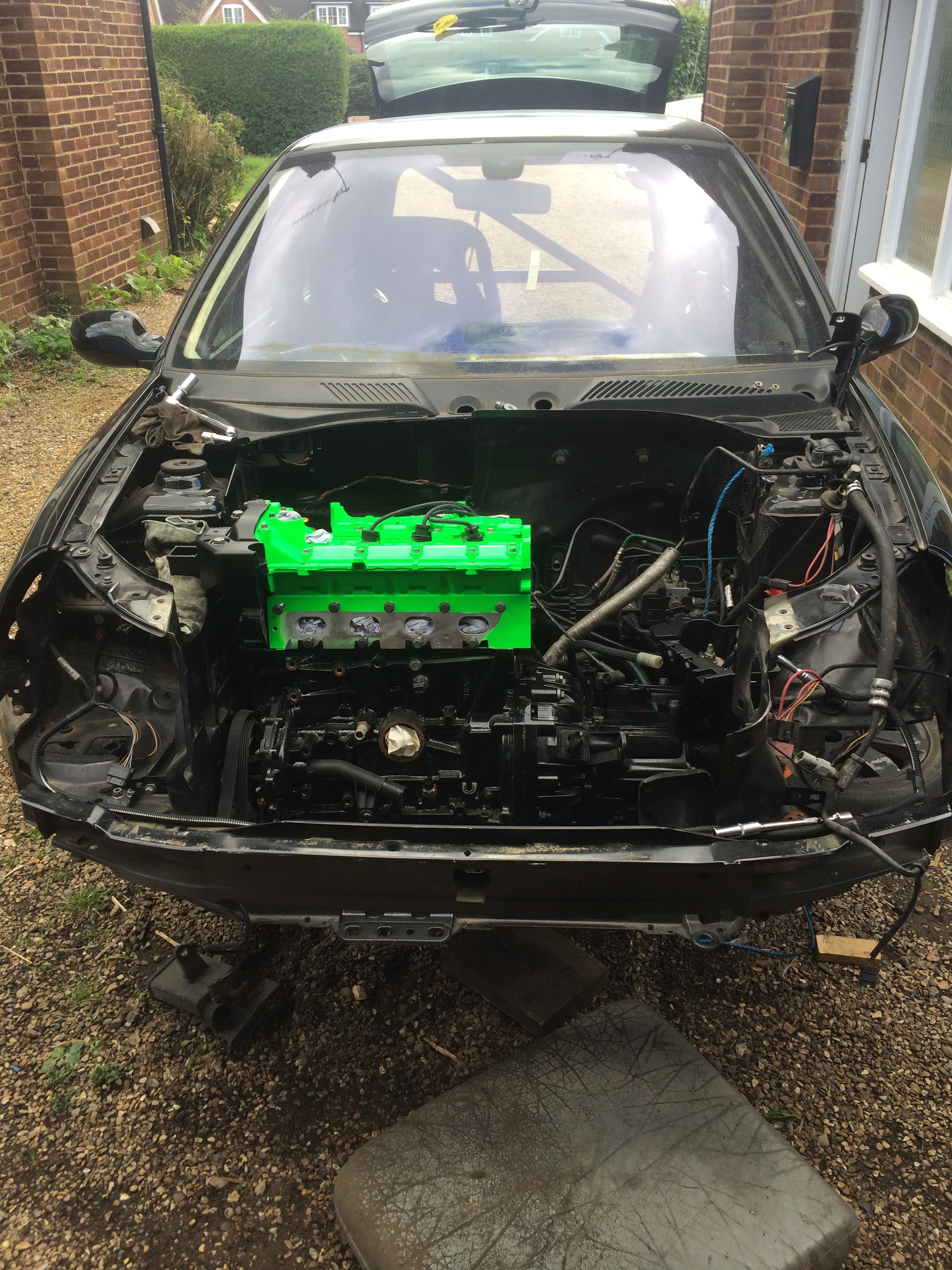

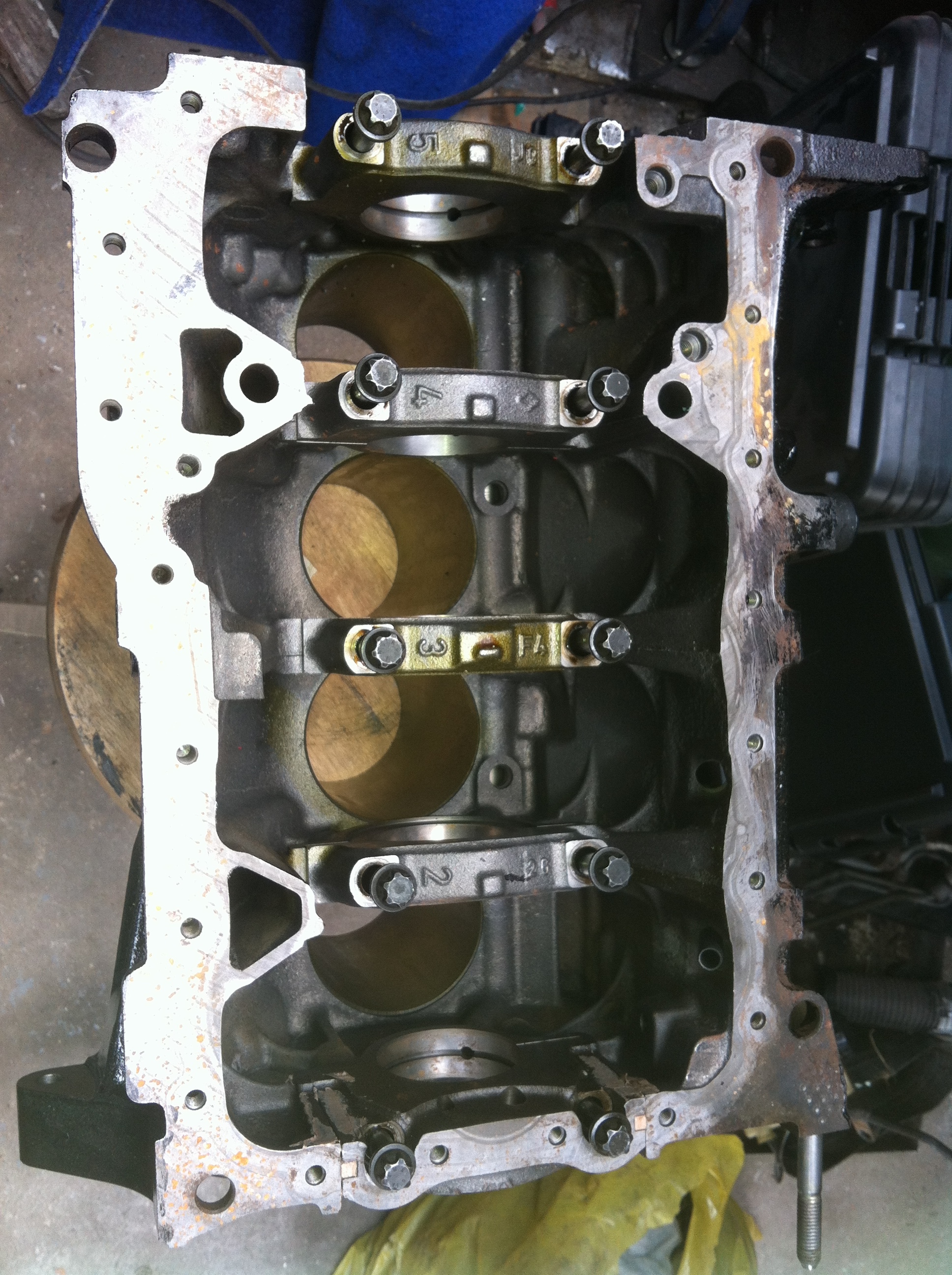

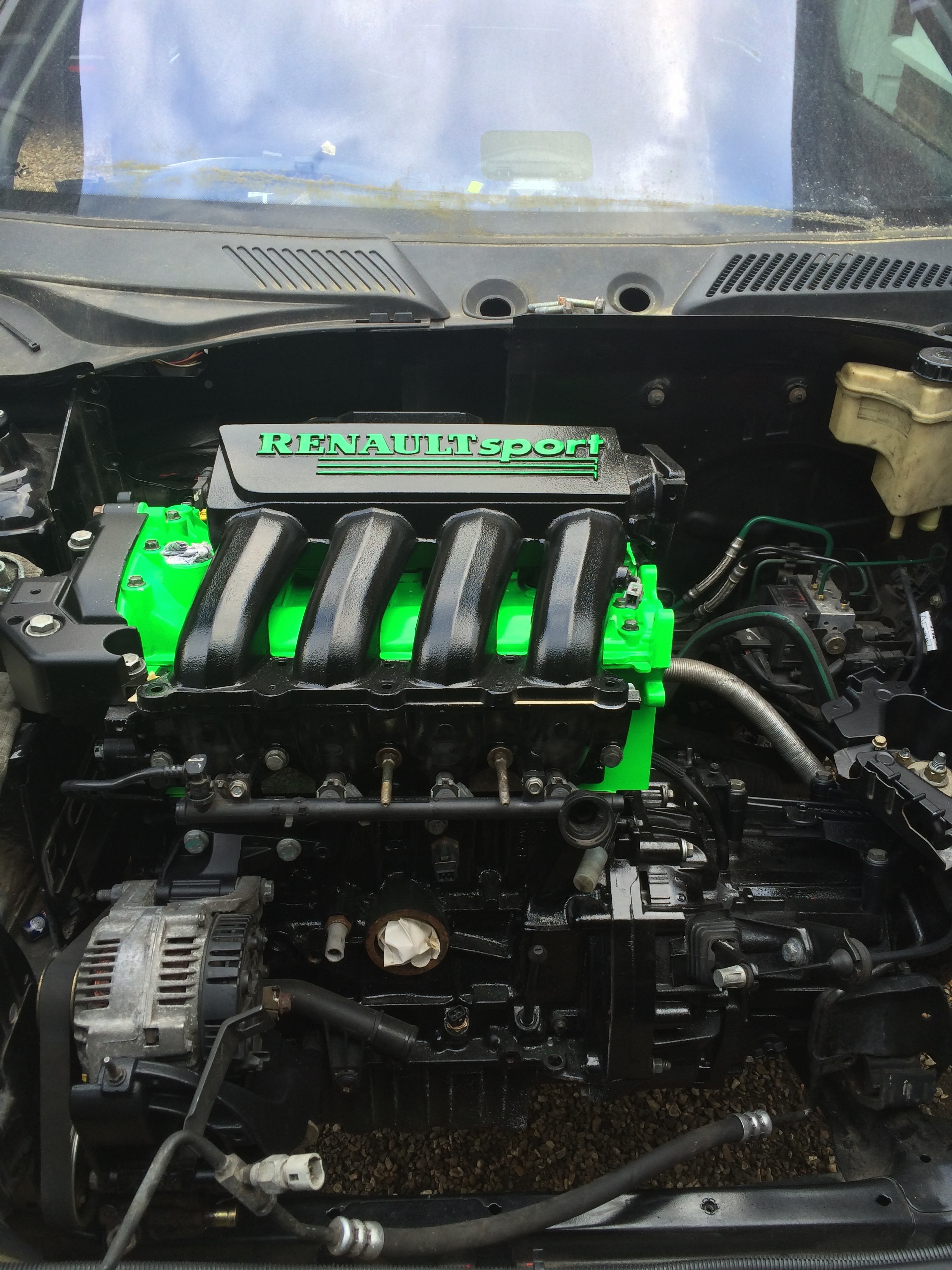

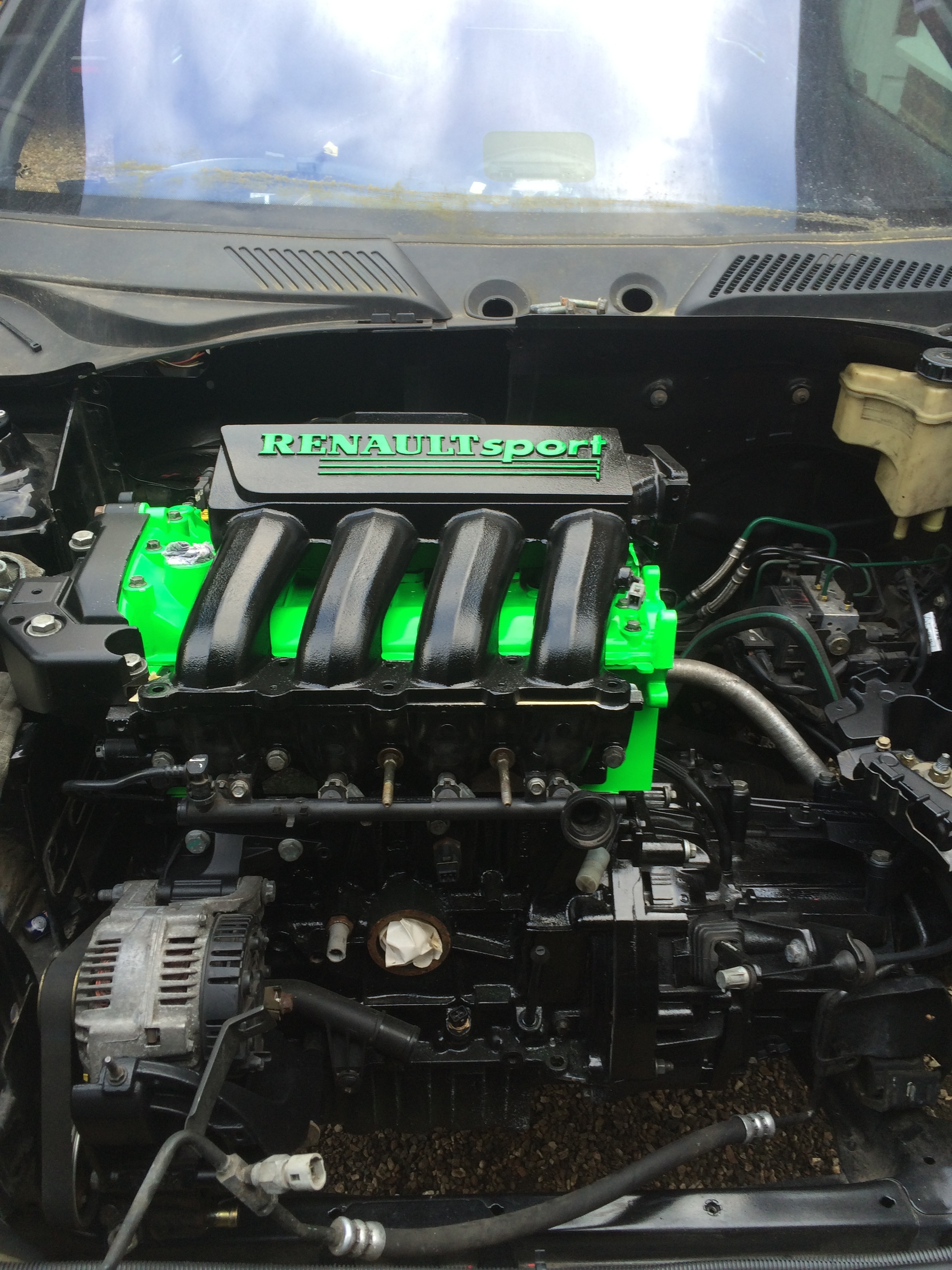

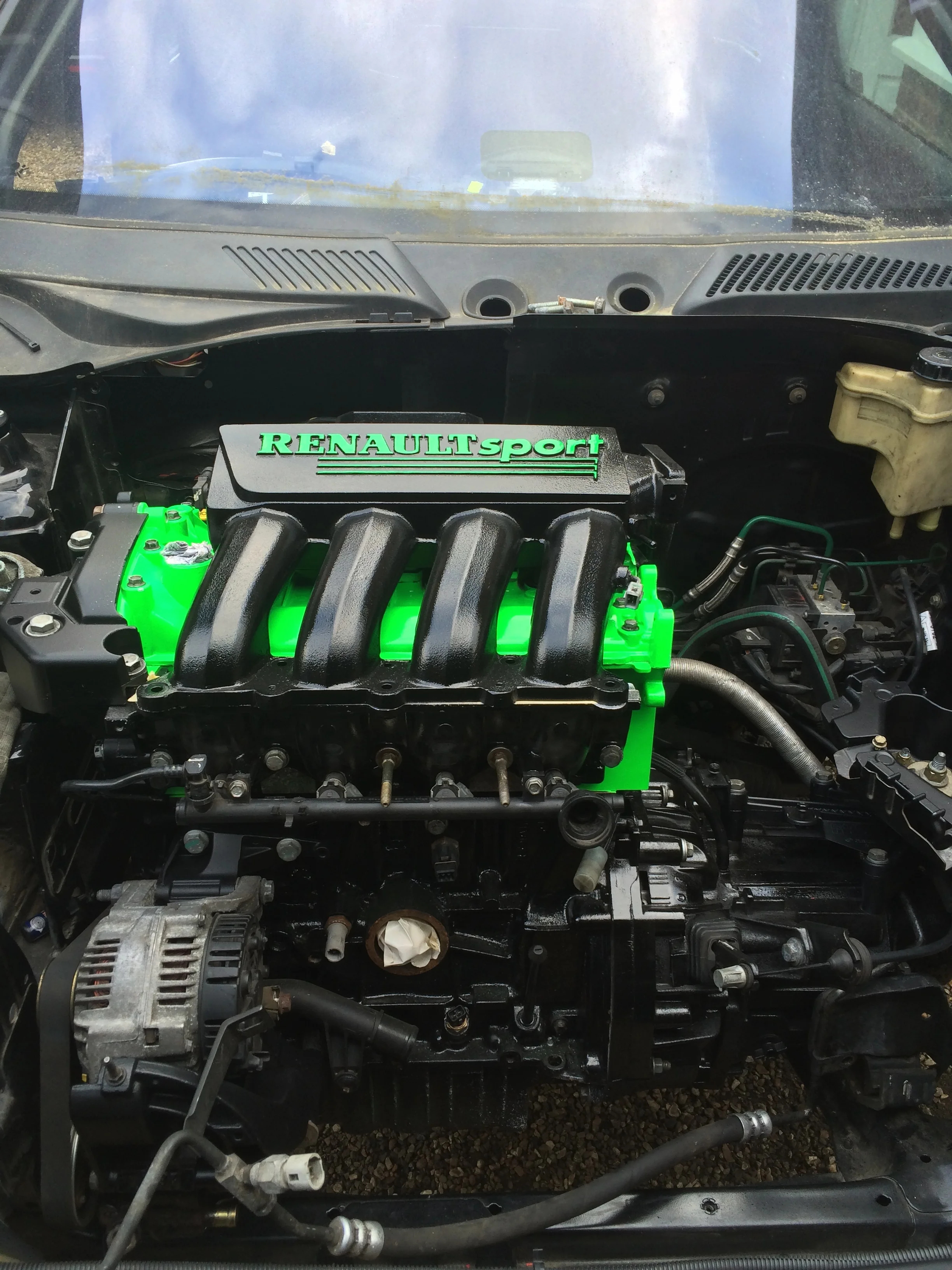

the engine has a complete rebuild which consisted of
new piston rings, main and big end bearings, new oil bore squirters, block honed, new dephaser pulley,all seals replaced,cam belt kit , head bolts and head gasket, a fresh coat of paint and then installed
all installed
engine oil cooler was also installed

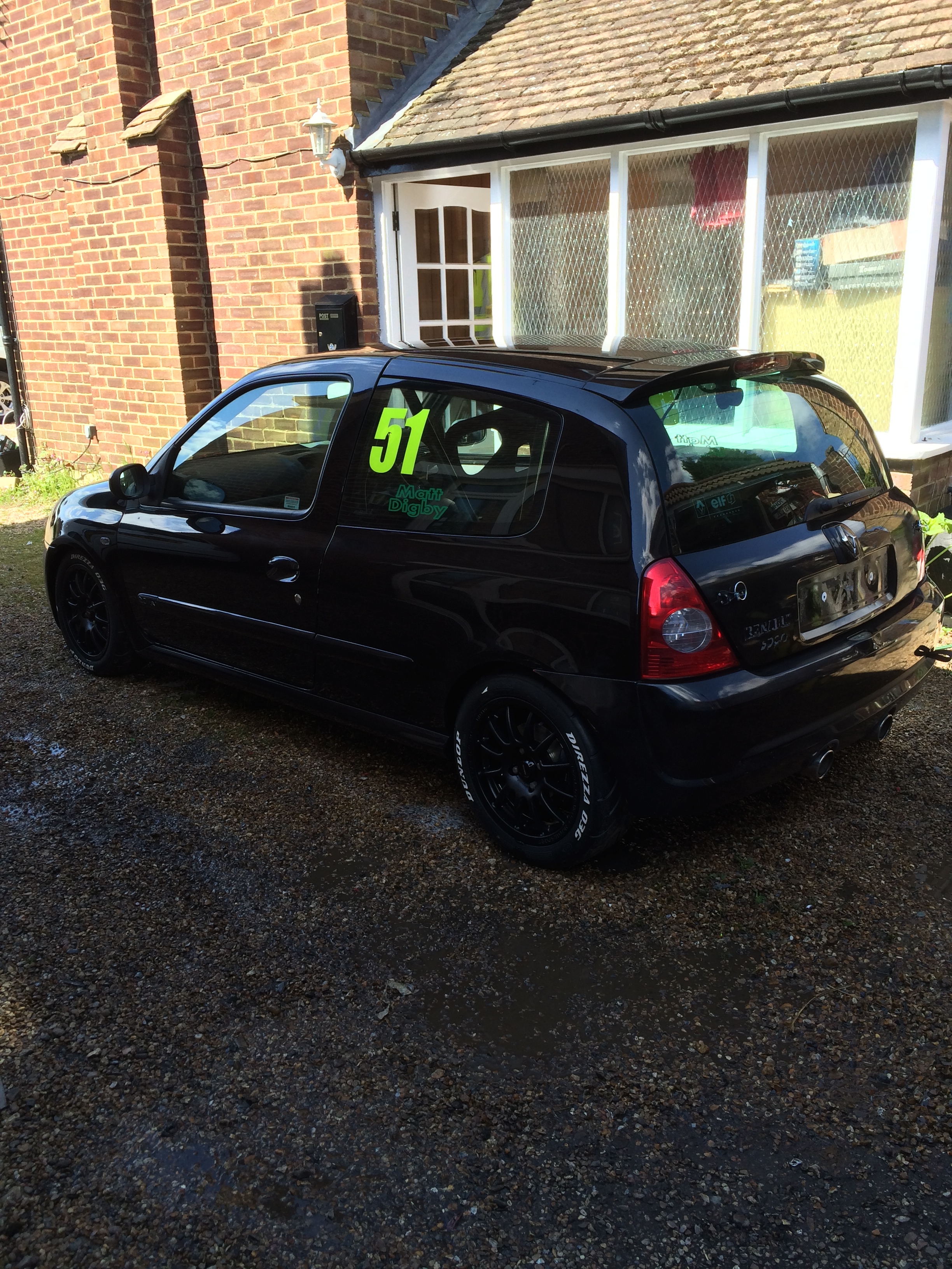

then i found a seat going cheap locally so i snapped that up, which my cat made it his bed.

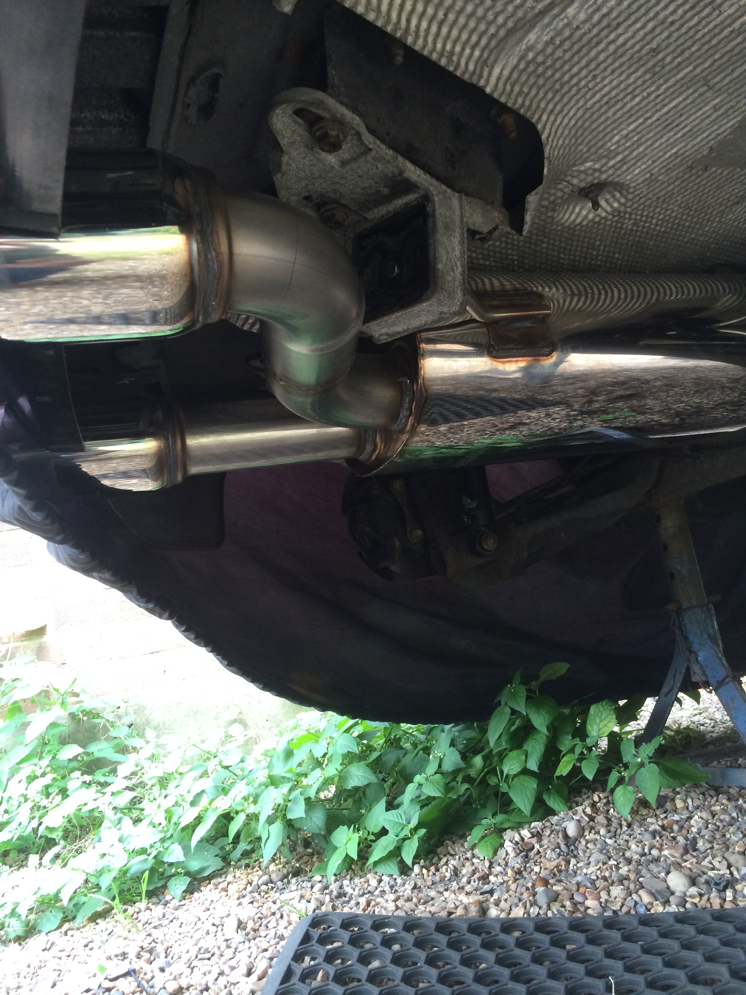

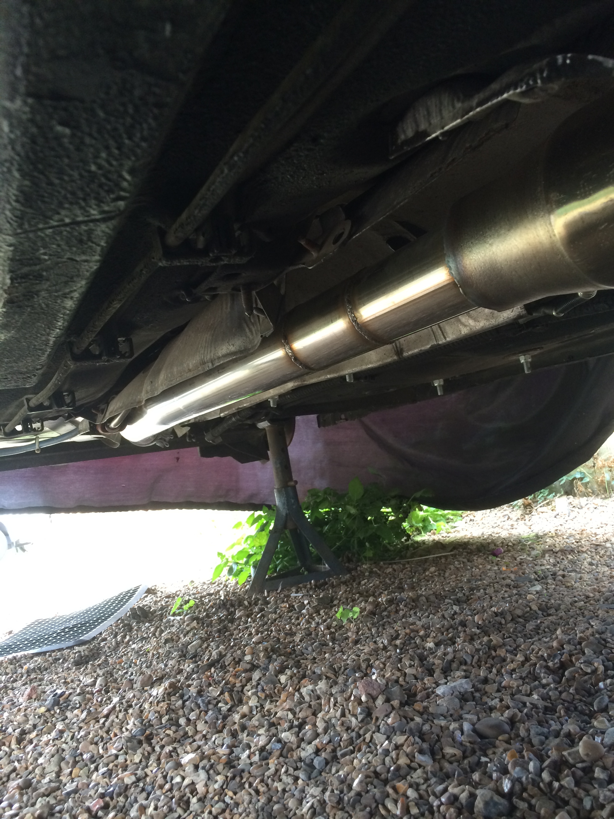

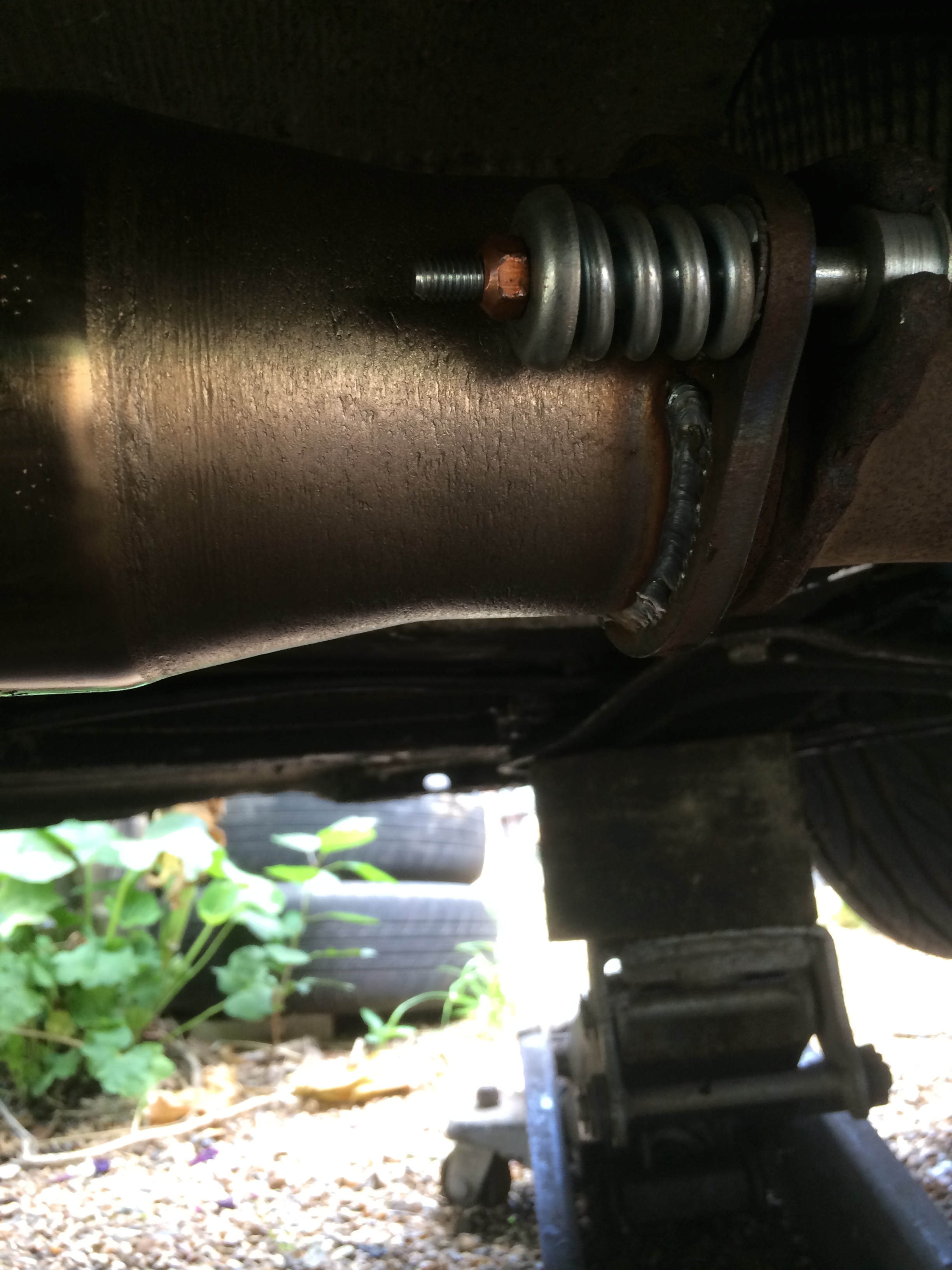

so i thought that the first thing to sort out would be the exhaust, so i ordered a new scorpion exhaust with no middle box and i would get rid of the standard cat and put a 100 cell motorsport cat in. Well after Scorpion screwed up my order i ended up fabricating the front half of the exhaust and just used the back box.
