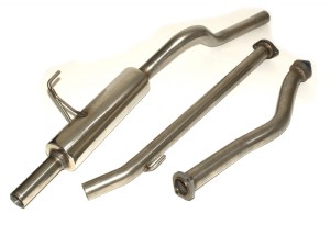

Oreca's system and the KTR ones use 2.5" tubing, was thinking along the lines of something like this
Only difference will be that the backbox will be riveted so they can be drilled out and it re-packed
