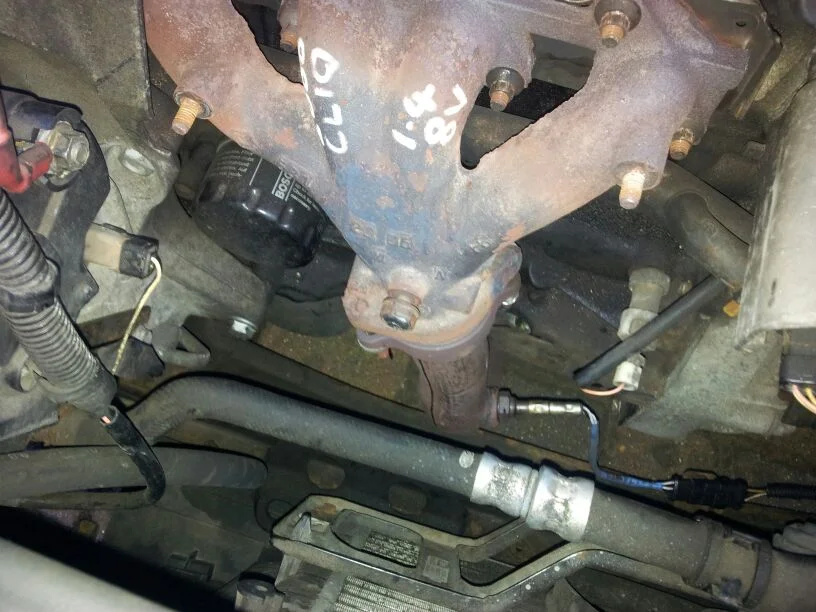

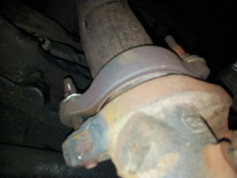

The joint where the manifold meets the downpipe is blowing badly. I replaced the manifold last week due to it being cracked. However it just wont fit tight/snug enough. It was near enough quiet after I sorted the manifold. Now it sounds like ive got a decat 2.0.
Should this have a spring bracket/clamp like on the sports?

im guessing it should have the springs but how was it when u removed the last manifold, is it ment to have those fire rings or whatever there called?
I removed it and put it together the same as it is now. Although it was blowing then too. Not quite as bad though.
