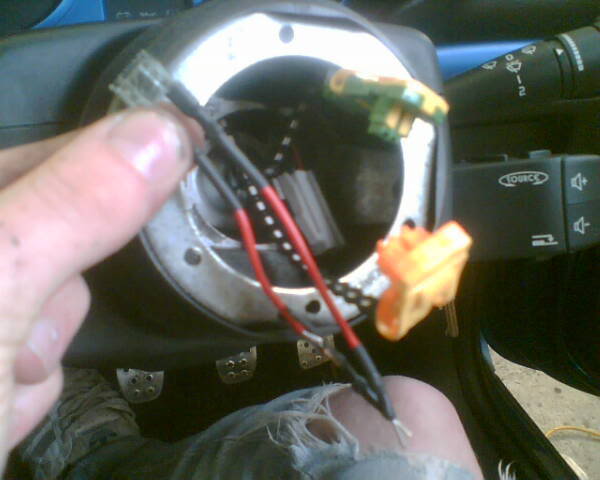

They sit in the boss. The airbag wires are connected to the airbag ring. This spins with the boss, so nothing crosses over.
Like this
Resistors go in the x2 airbag connectors (ignore the fused resistor in hand lol)
Horn connector is pushed down into the boss there. I'd simply get some spade connectors, connect to your horn, then connect to the horn connector (cut off and keep in safe place if need be)

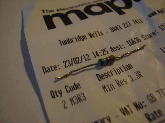

So do you need 3.3kohm or 3.3ohm?
I've got two 3.3kohm ones from a mate and they don't seem to have worked. It's a bit of a pain getting them to sit properly so they make contact, but I've been trying for a while and got nowhere.
  Clio 172
Done steering wheel this morning and uses 3.3ohm resistors. Airbag light has gone off but still got SERV, traction control and ABS lights on. Any ideas?
