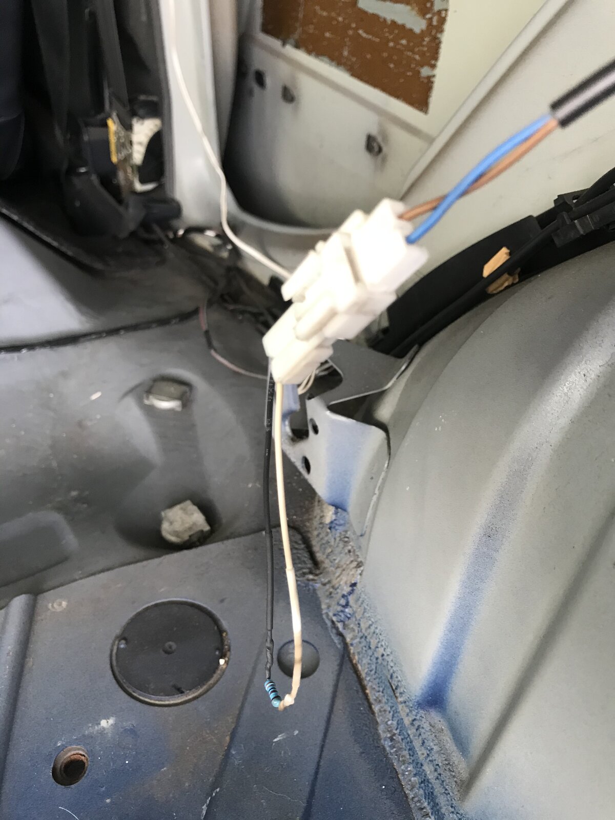

So I've popped some 3.3 resistors into the rear seat belt connectors as since taking the back seats and belts out of my 2002 172 PH2 the service light, and airbag have been on.
Am I correct in thinking that the resistor straddle the plug creating a circuit because the service light and airbag light haven't gone out. Or do I need them turning off with a diagnostics?

So I tried this after work and the lights are still on. Any advice please as I’d like to get the car down for an MOT soon.

mossyv6
  Trophy,V6,5GT,AG200
I don’t think the rear seat belts had any wiring to do with the airbag light?
I think it must be something else.

You can have the lights turned off with clip or RSTuner but resistors complete the circuit and should work too. You must have an issue elsewhere

My 197 has. I removed the rear seats/seatbelts, leaving light on dash. Being very delicate, it was difficult to get good fit, so I used the ends of safety pins into the resistors to help with good contact, taped up, and no problems since.

Yes i know 197/200’s have but didn’t know 172/182’s did (as per the latest question).
