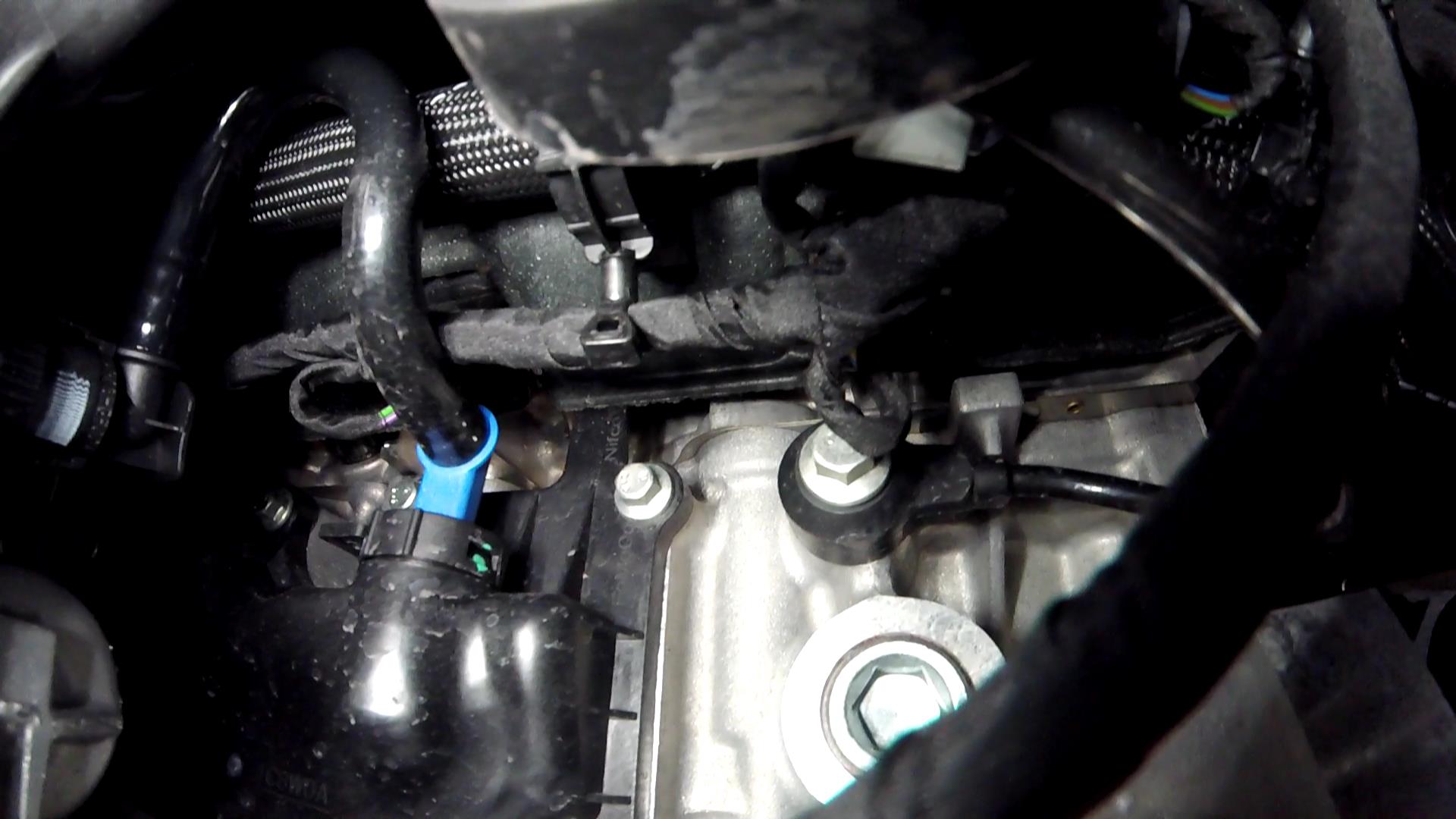

The recent information suggests with quite clear evidence that looks to confirm that it really was as simple a f*** up as the wrong parts being labelled/sent/fitted with end result being a gasket specifically designed for the Mustang 2.3 fitted, in error, to the RS 2.3. The difference in the way the engine coolant flows around the RS block meant that fitting the Mustang gasket provided dead ends, hotspots, warpage, and a whole load of financial pain for a gasket supplier somewhere.
Glad it’s going well for you Mark. I’m not too sure on the wrong gasket theory. It doesn’t really fit with Ford allegedly bringing out a fix/recall early next year. To me it seems as if they still aren't really sure what the problem is/was. A wrong gasket fitted would have been picked up straight away on the tear down back at Fords.
Ford’s may of course just recall all engines built between a certain period for new gaskets just to be sure. Suppose we just have to wait and see.

It will have taken them a while to determine what was causing it, a while to understand how and why it happened, and a good while to get the party at fault to accept that they have to fund this entire mess, then a further while to be happy that they're genuinely doing the right thing commercially to come out with something like this, and a while to ensure they have adequate stocks and resources to handle it when they finally release some information to owners. It kind of all sits comfortably with me.
As far as what I got goes, I think there's many more out there with the wrong gasket fitted and an engine which could fail...but probably hasn't yet gone through enough heat cycles to make the warping casue coolant loss into the cylinders.
I think;
If they inspect, find the wrong gasket's fitted, and there's no evidence of leakage, they'll replace the gasket.
If they inspect, find the wrong gasket's fitted, and there is evidence of leakage, new engine time.
The bummer is for those that have the right gasket fitted but have to go through the pain of having their engines pointlessly stripped just to check. Of course that's if they do...Ford may well have been able to narrow the faulty supply chain down to specific batches of engines so the 'recall' could well be quite specific and targeted.

Ford will announce a Field Service Action (FSA) at the end of this coming week.
The FSA is to check and replace the Cylinder Head gasket on all Focus RS cars produced between August 3, 2015 and July 6, 2017.
Dealers are to pressure test the cooling system and replace the cylinder head gasket.
Based on test results, some vehicles may require a new cylinder head assembly.
This service must be performed on all affected vehicles at no charge to the vehicle owner.

I'd take the new gasket, Whats to say the replacement engine doesnt have the same issues?
From what I can see here it looks like I have the latest gasket on my replacement November built engine. That suggests and supports the internet rumours that August onwards engines are all good...
