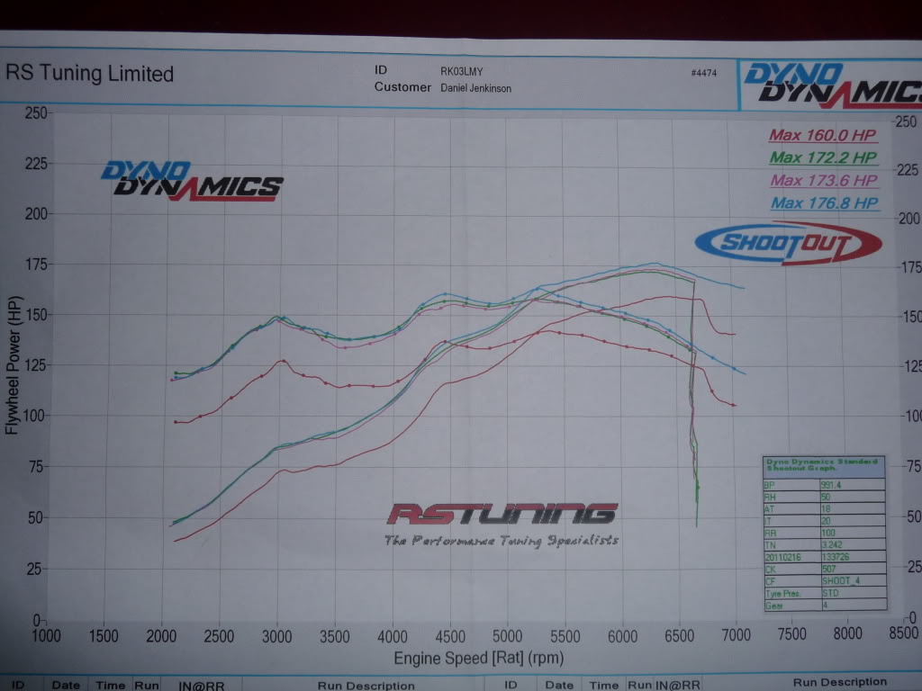

As an idea, heres a RR printout from RsTuning
Red- initial run
Green- timing corrected
Pink- inlets fitted
Blue- mapped
If you look closely at it, I think I gained at the top end slightly but lost slightly in the middle until it was mapped so a live map will probably bring that little bit more out but not much
