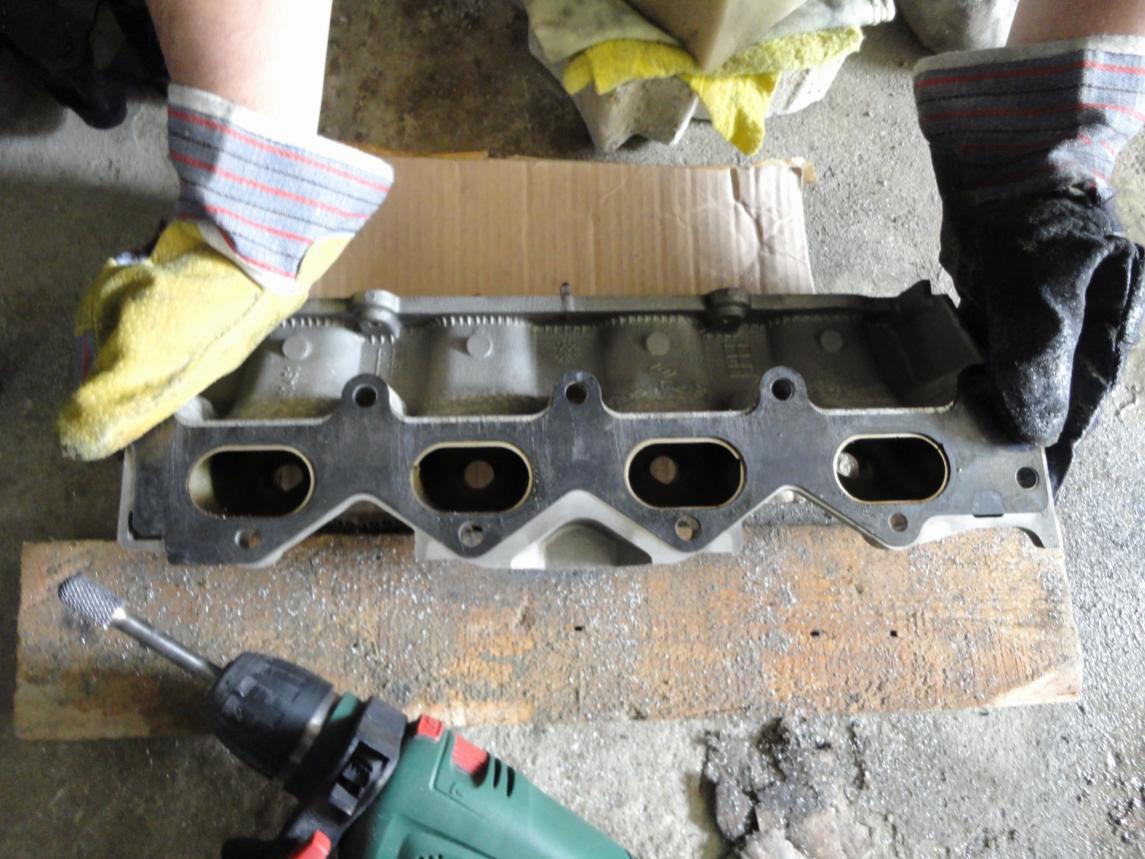

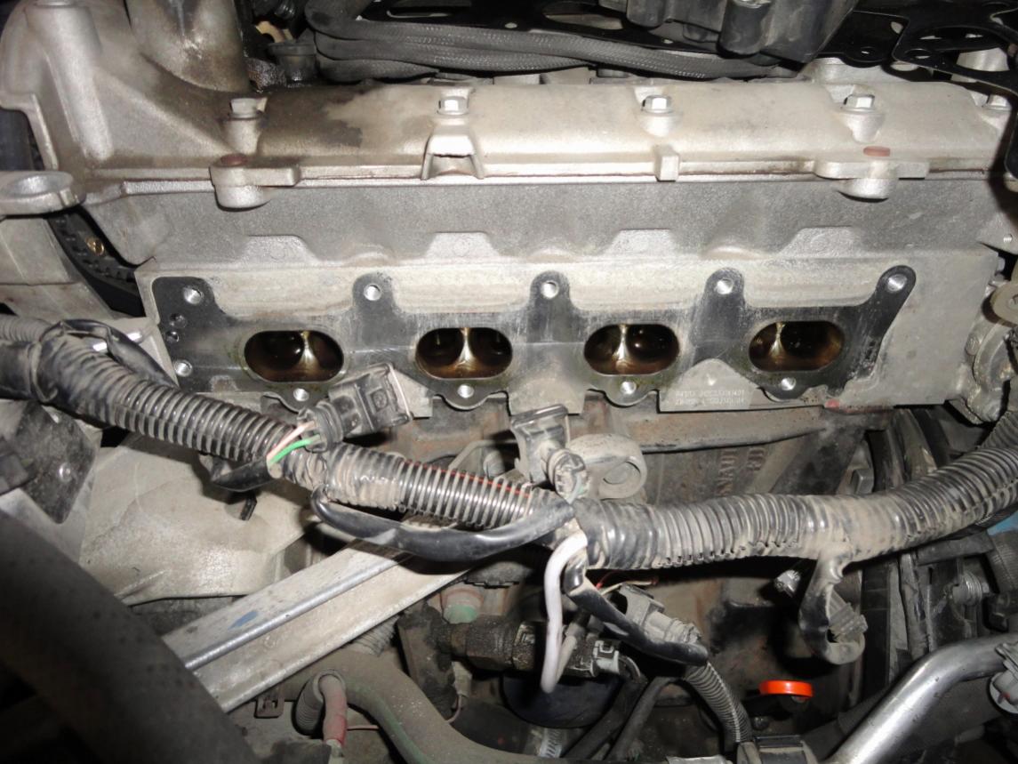

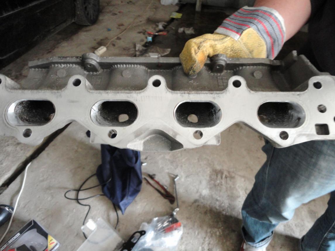

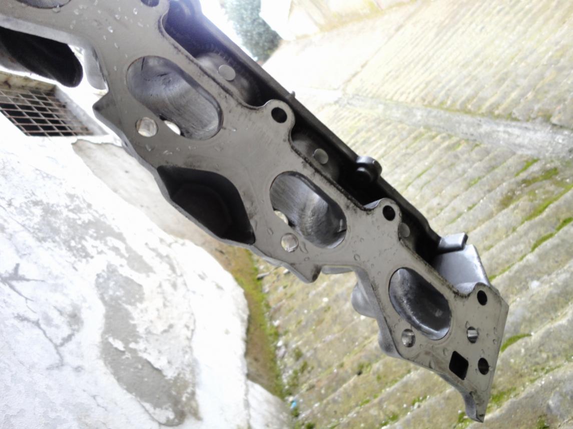

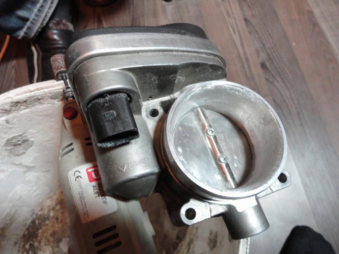

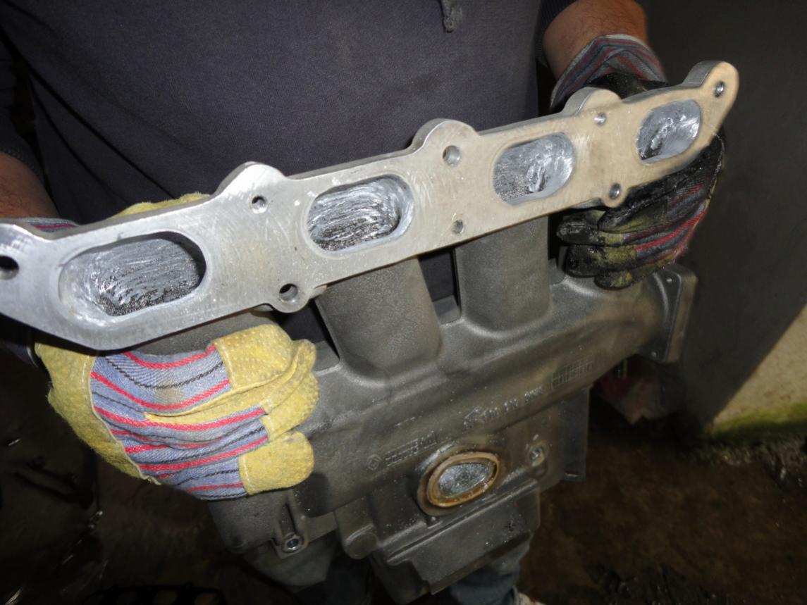

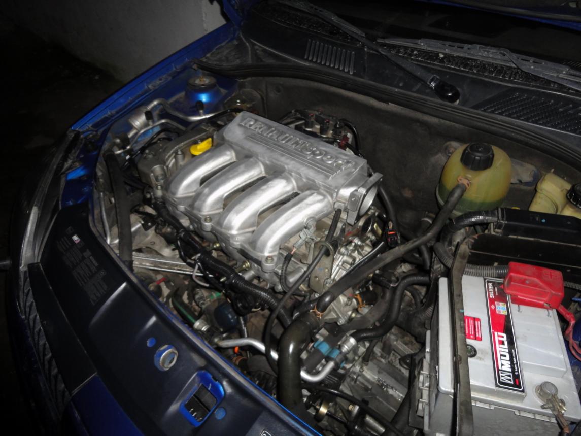

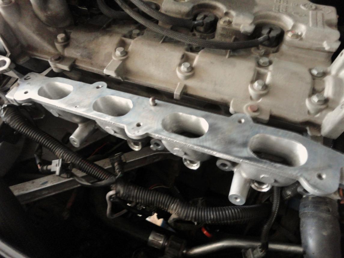

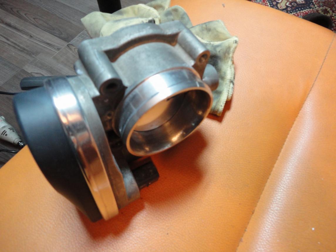

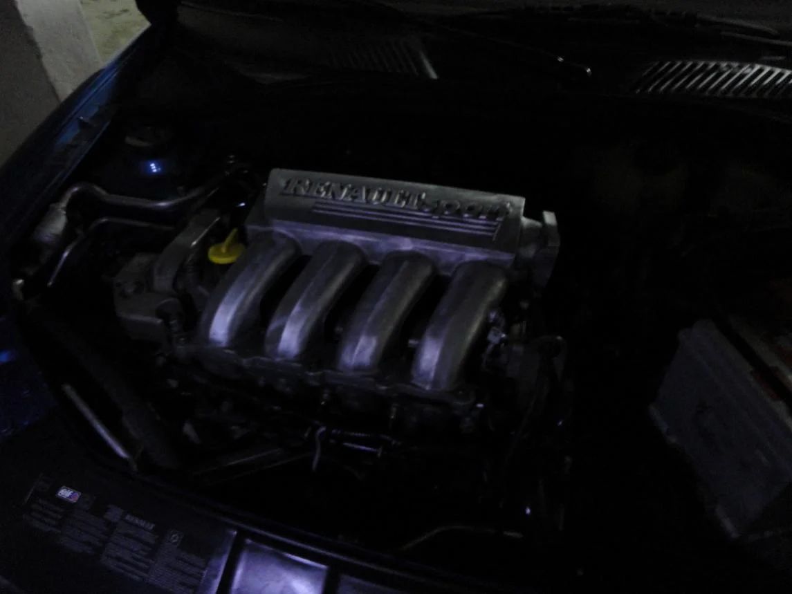

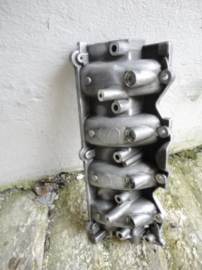

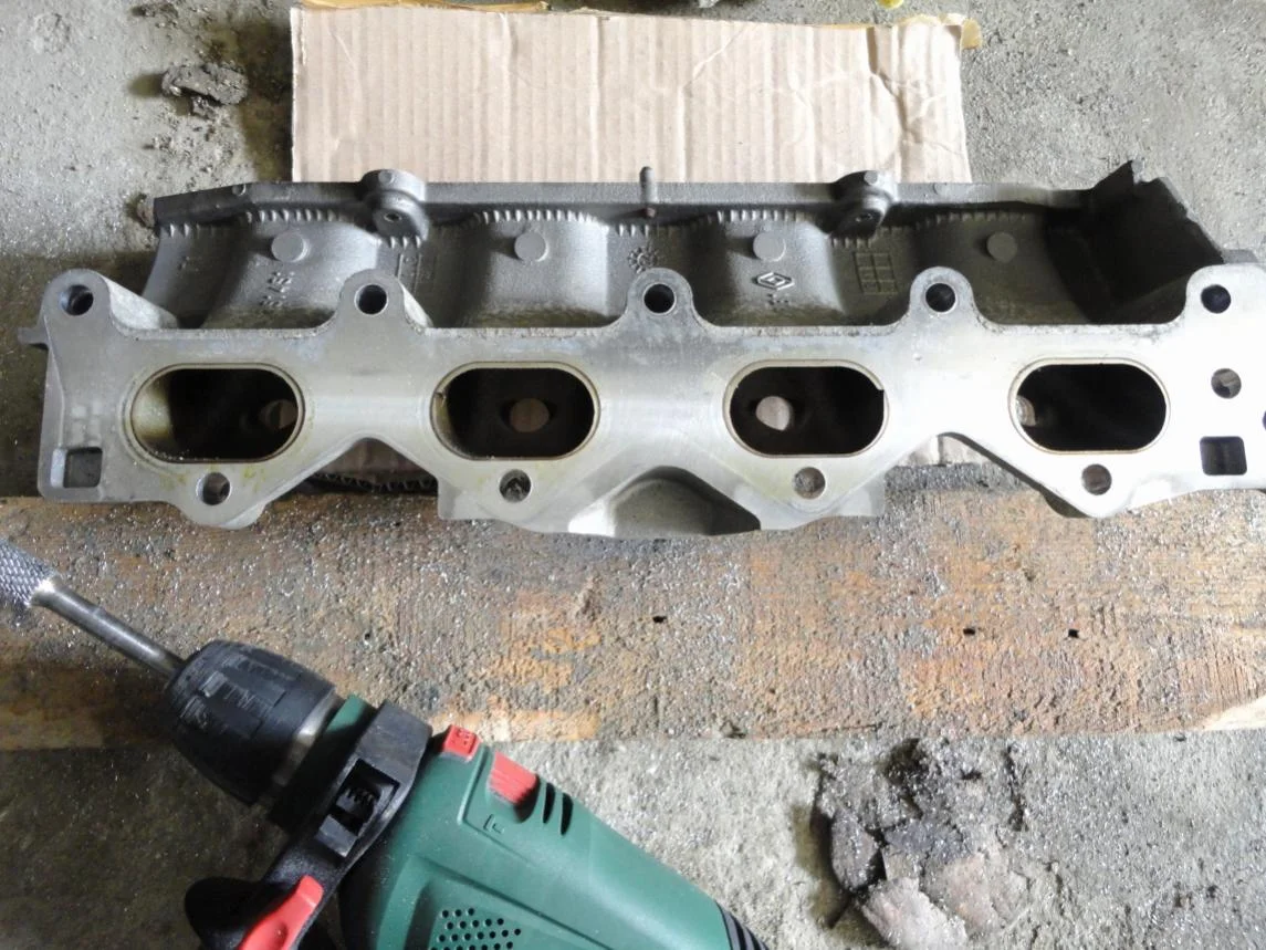

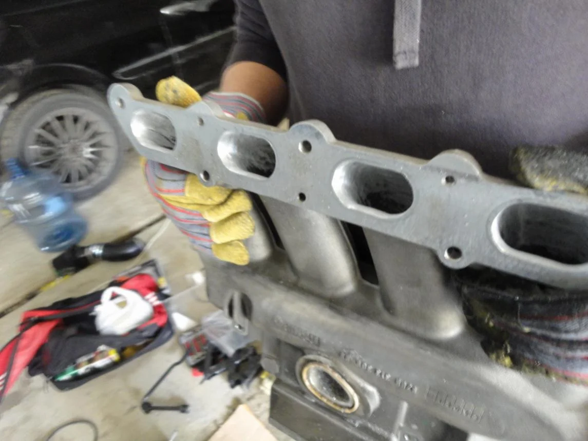

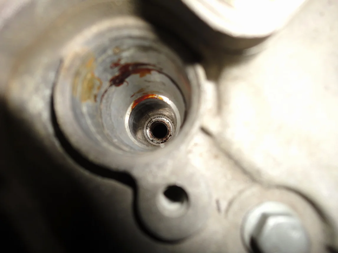

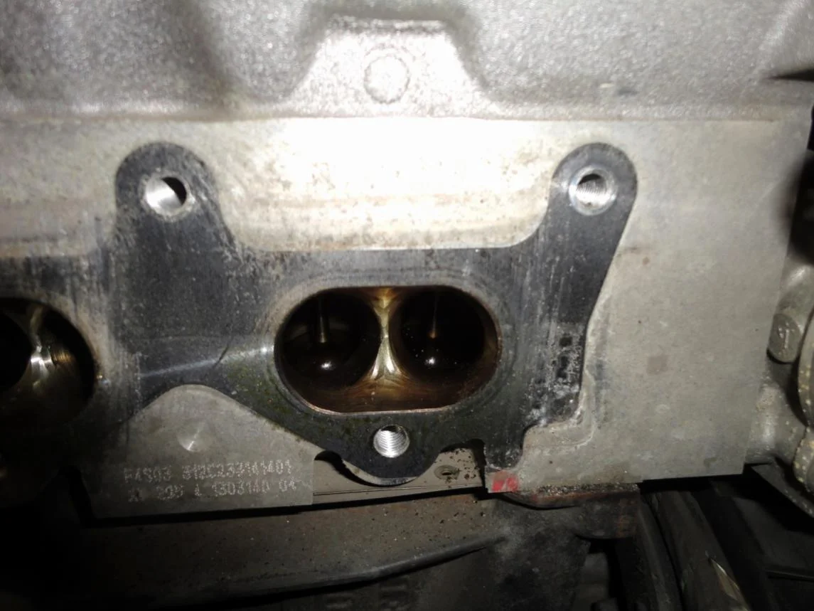

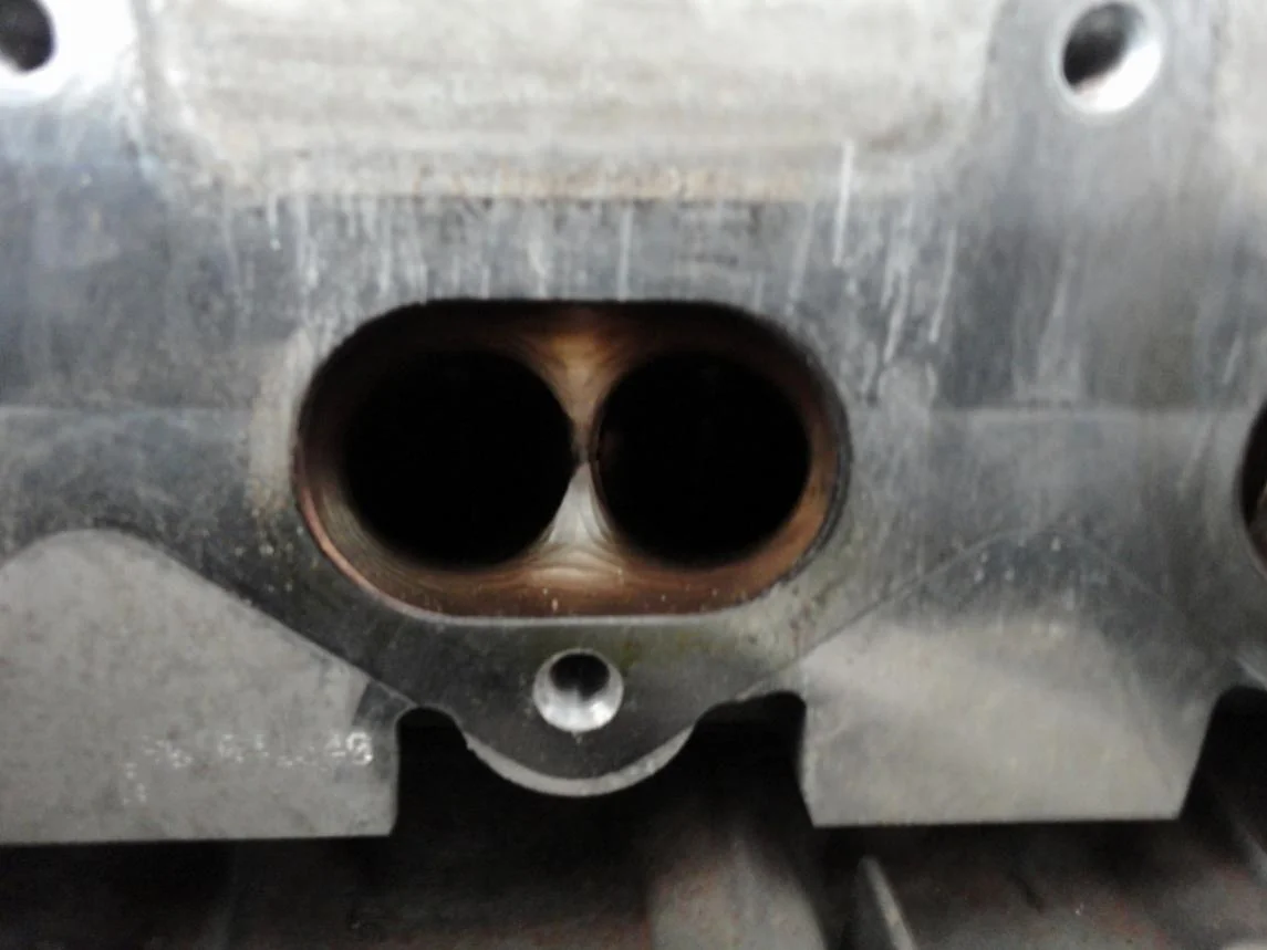

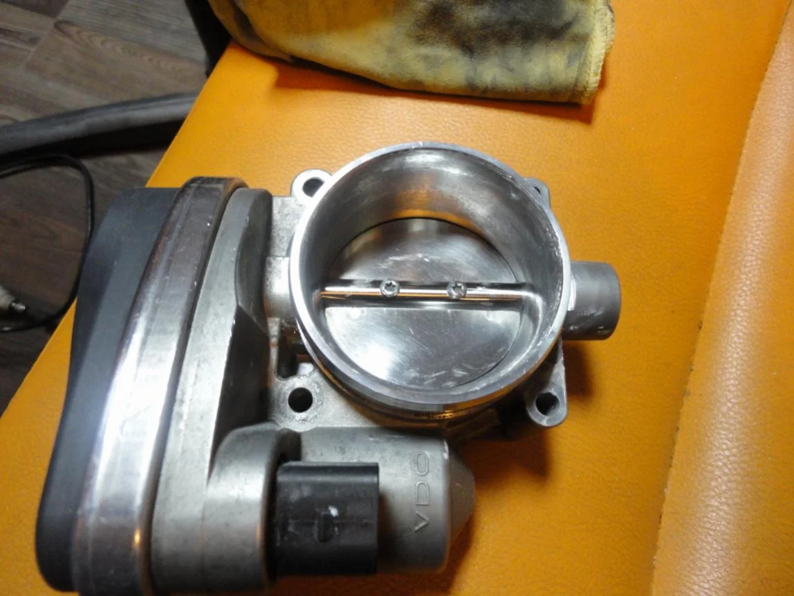

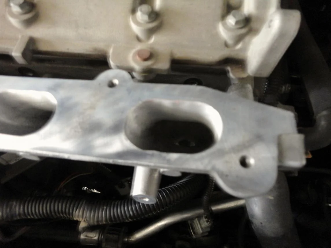

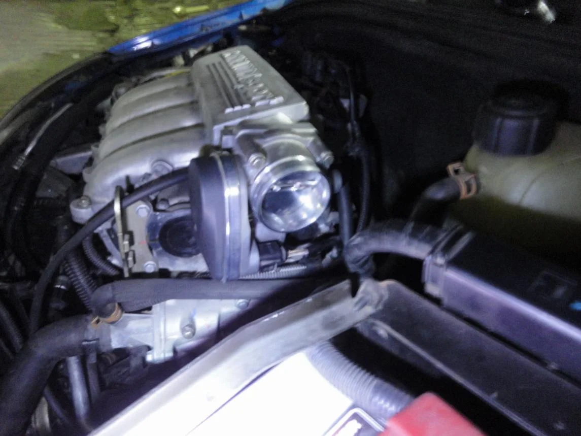

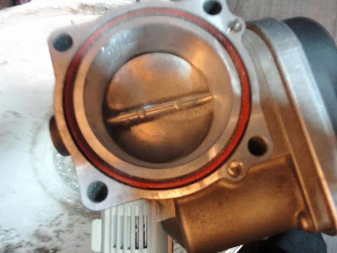

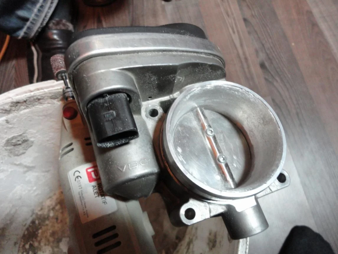

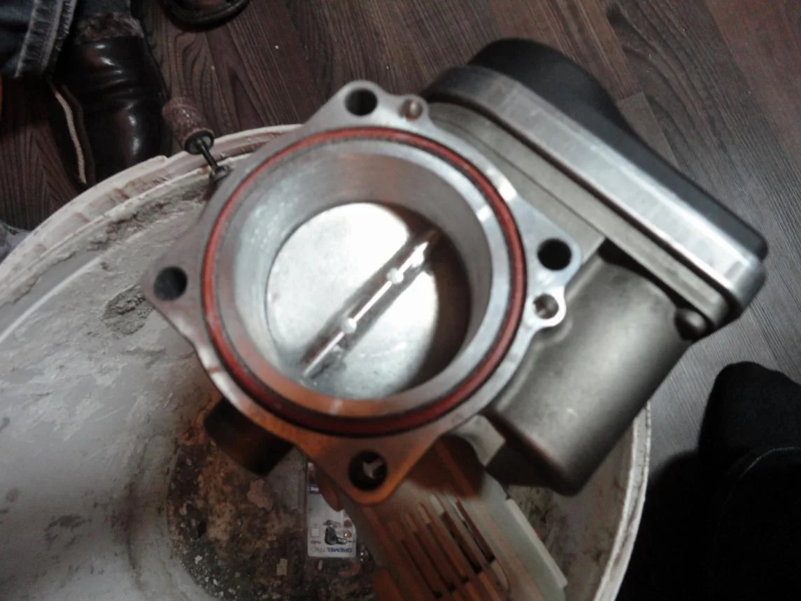

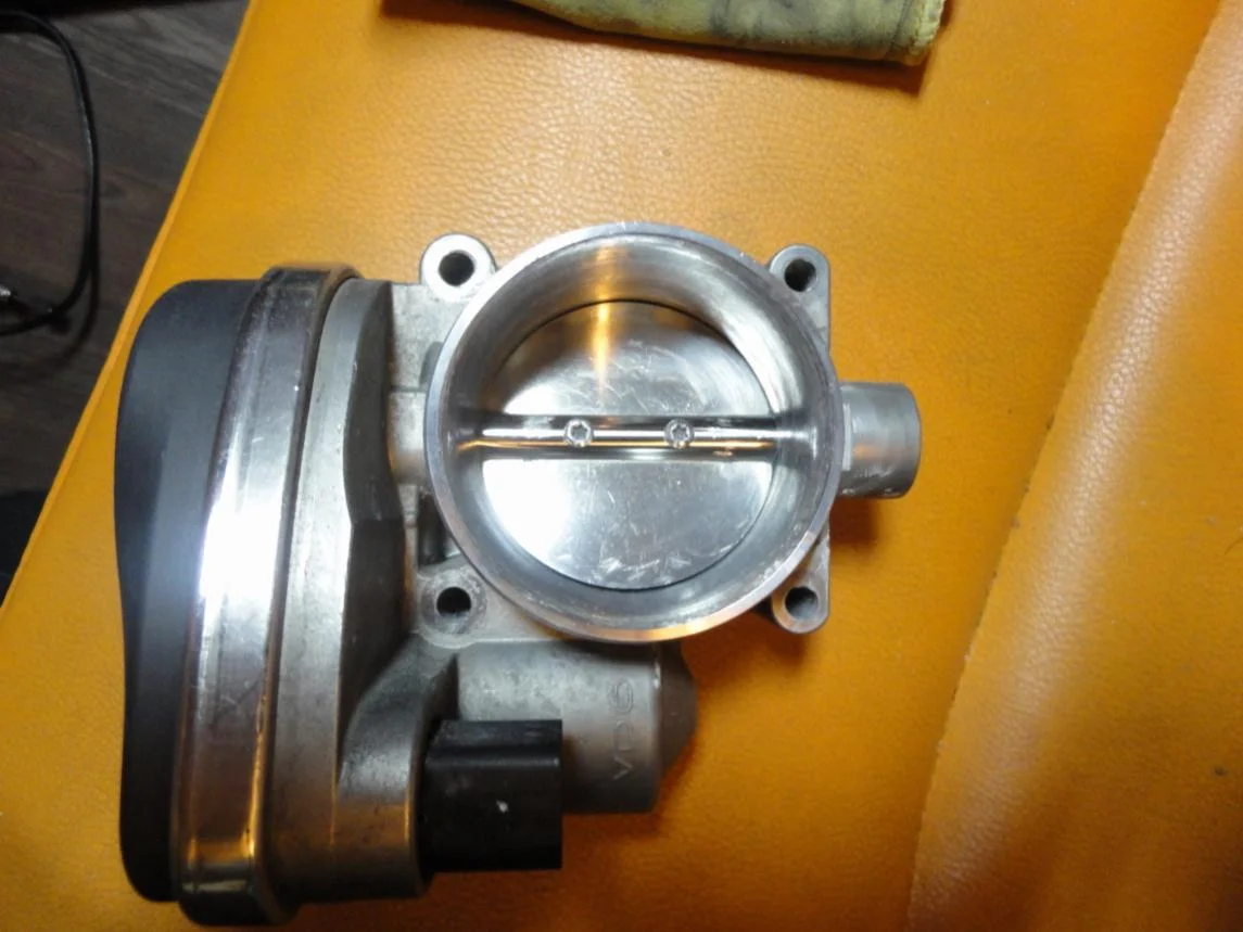

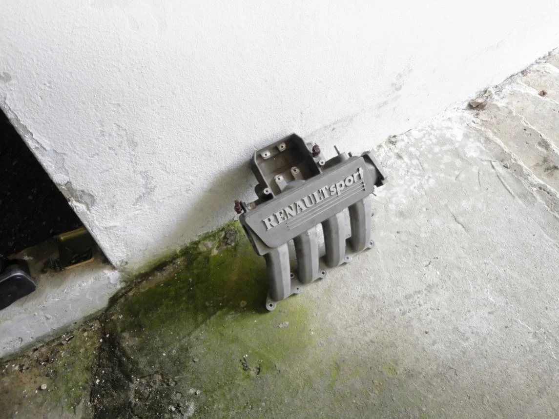

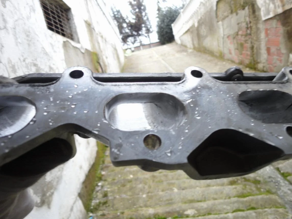

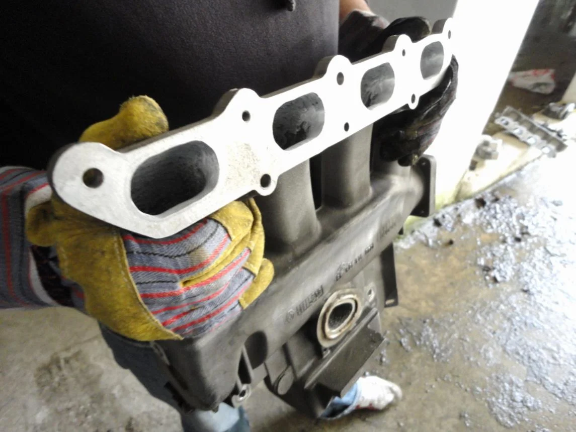

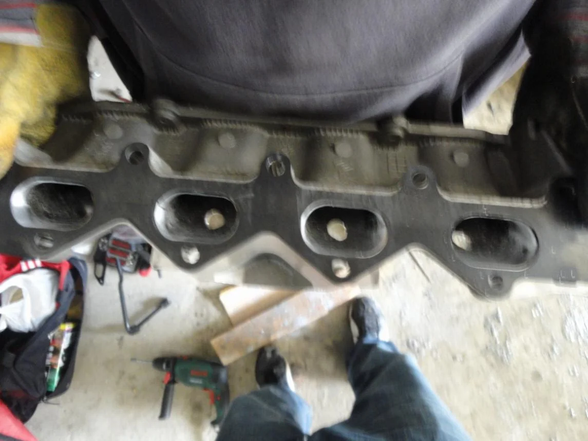

yesterday we make this mod to my friends 182

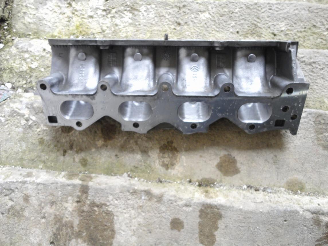

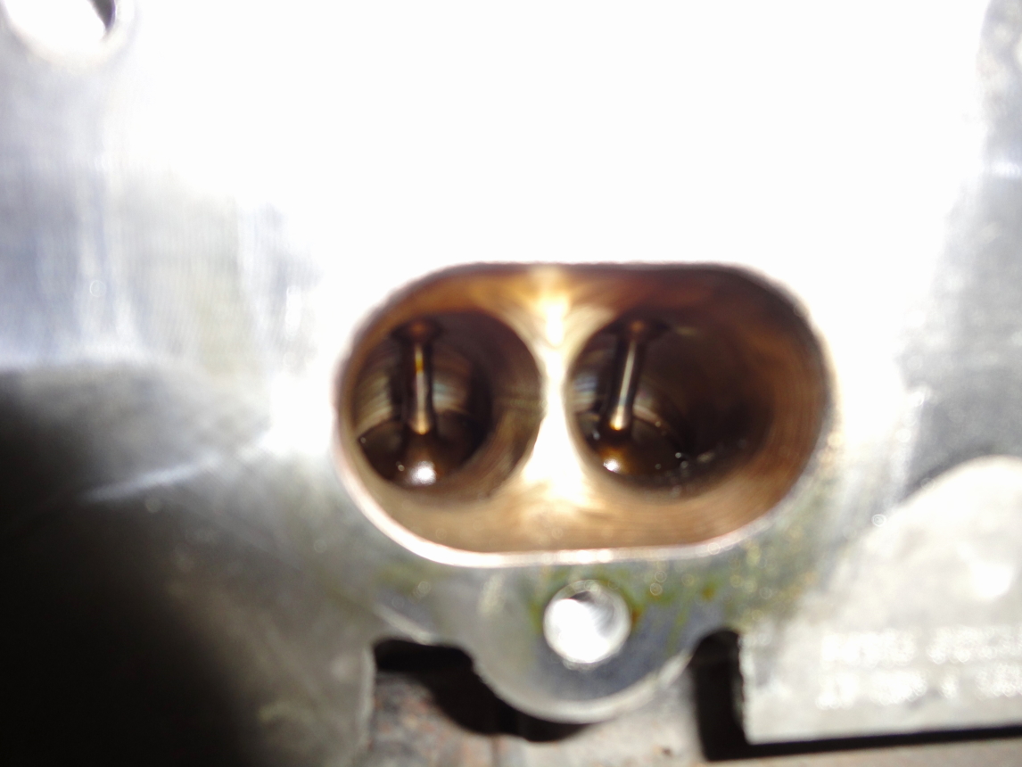

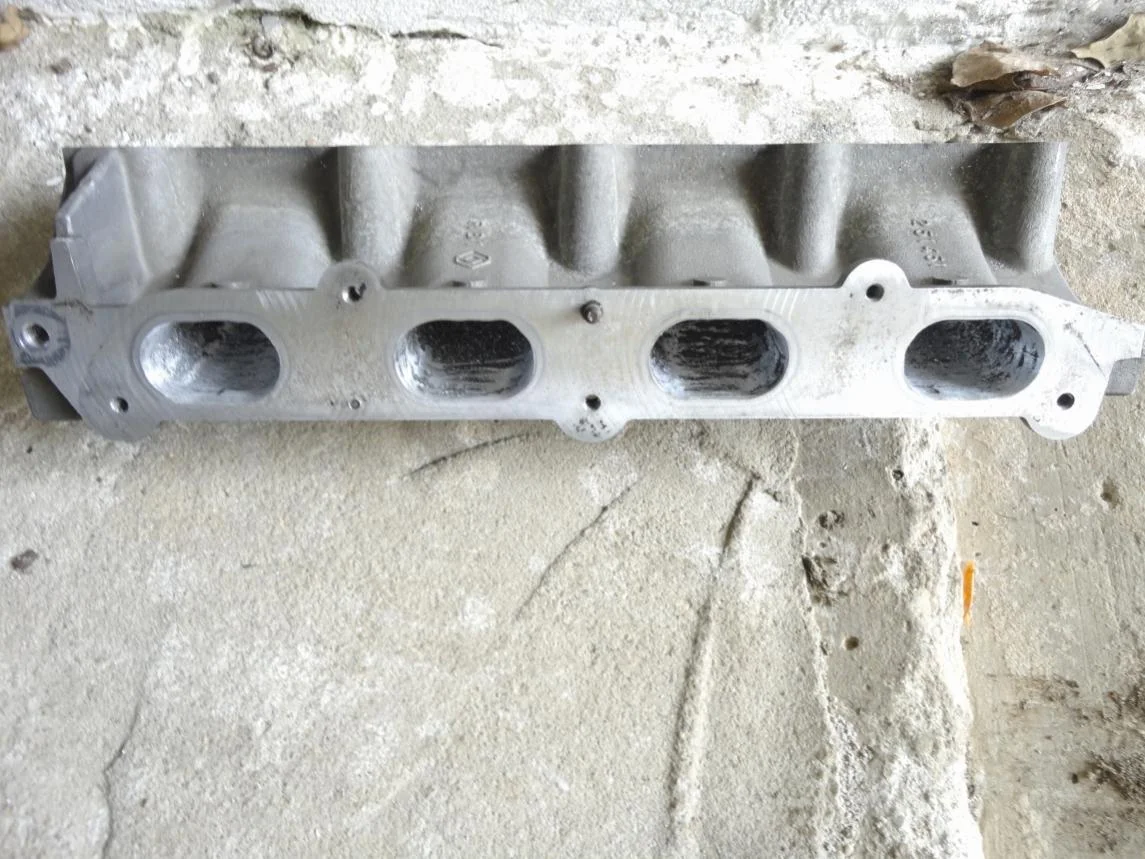

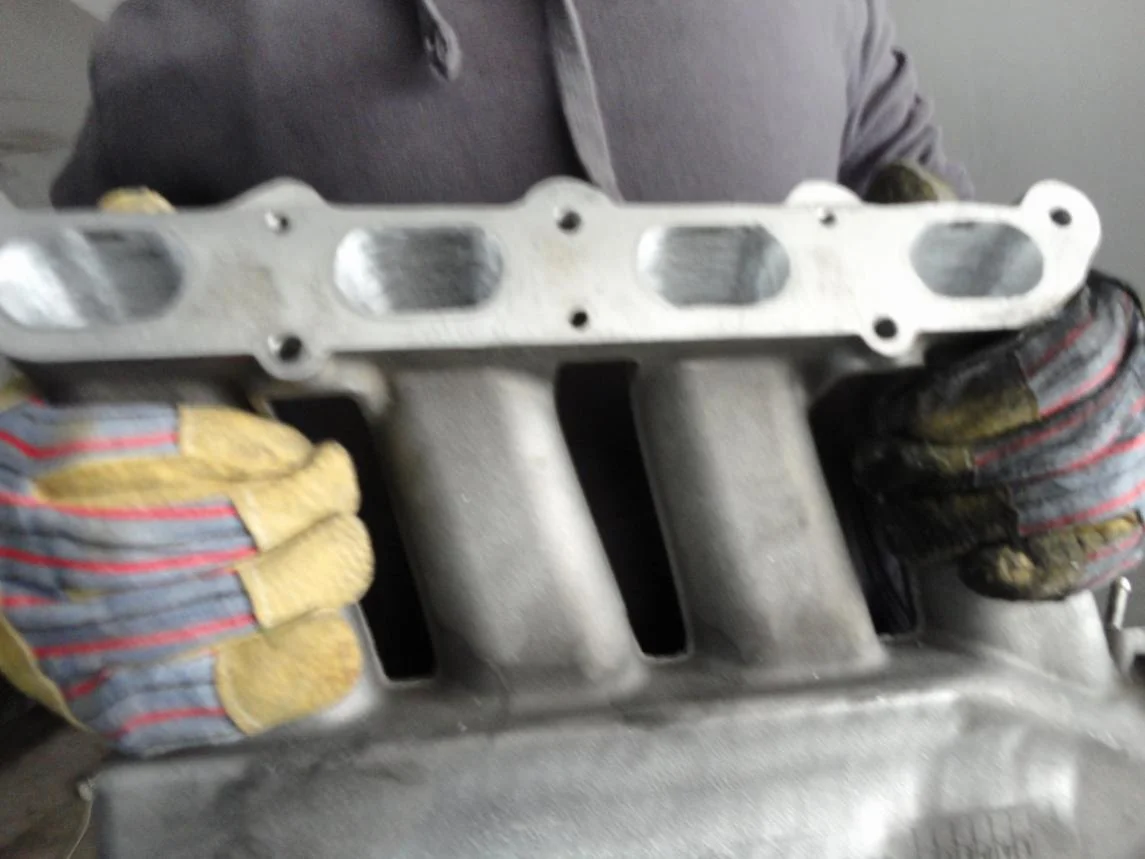

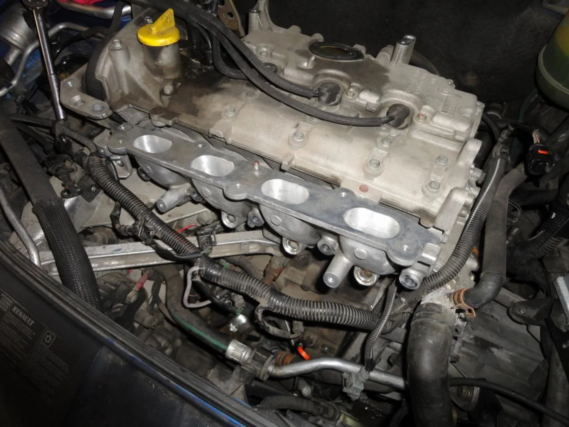

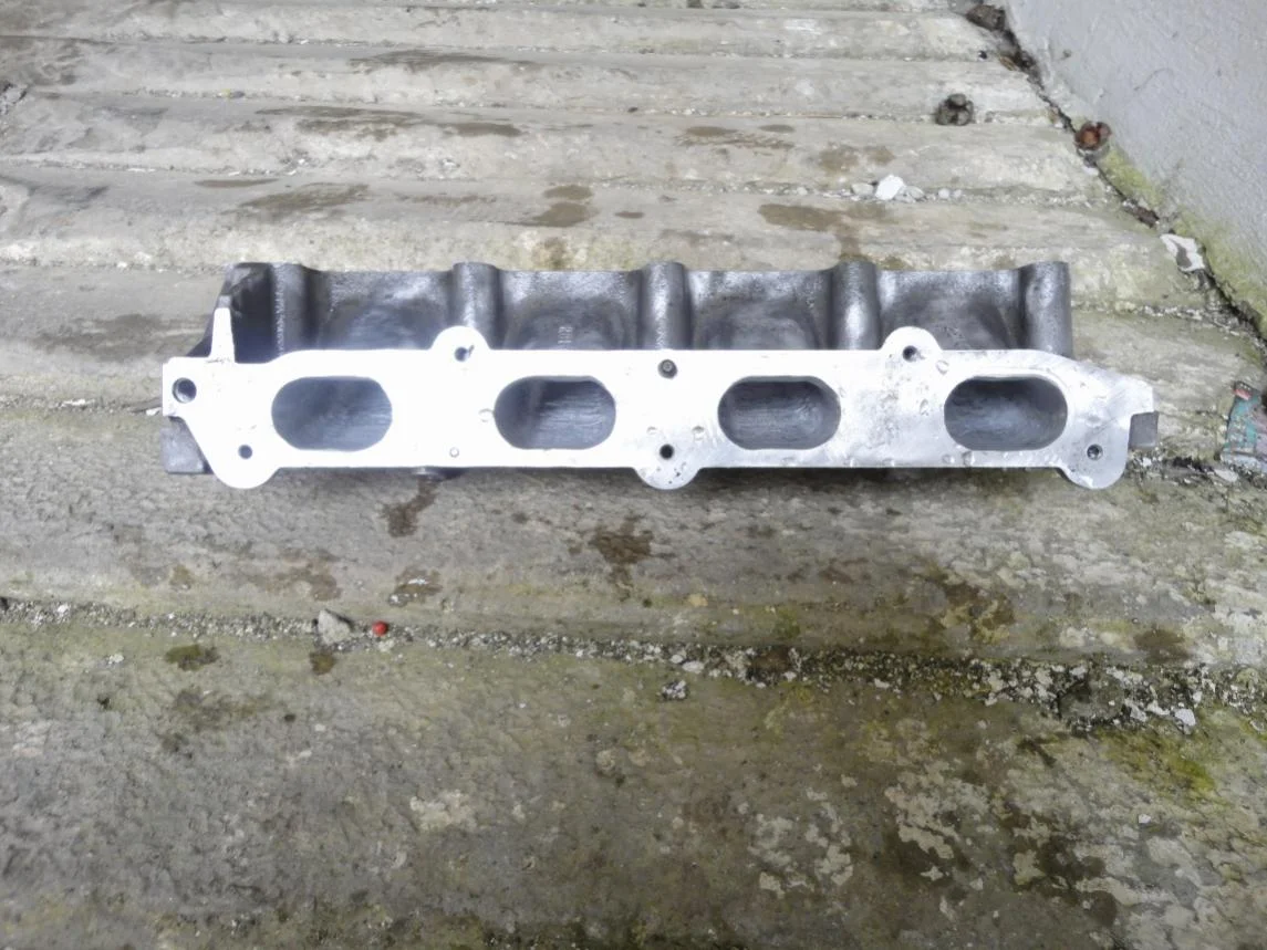

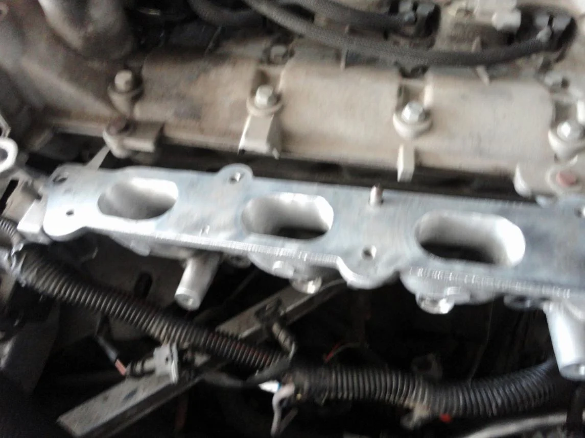

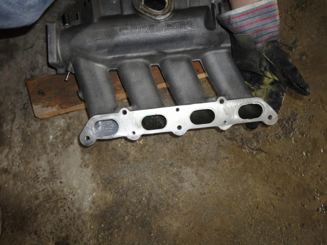

all entries matched with gaskets

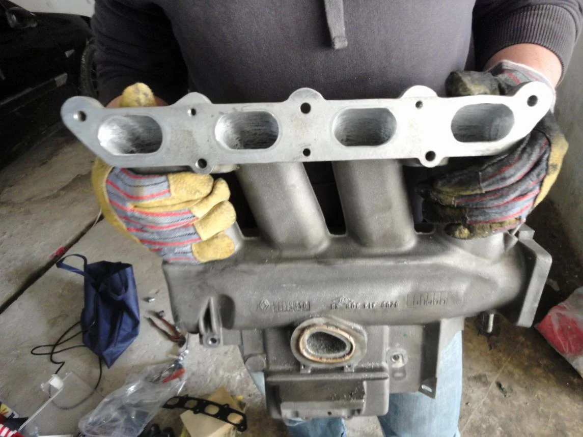

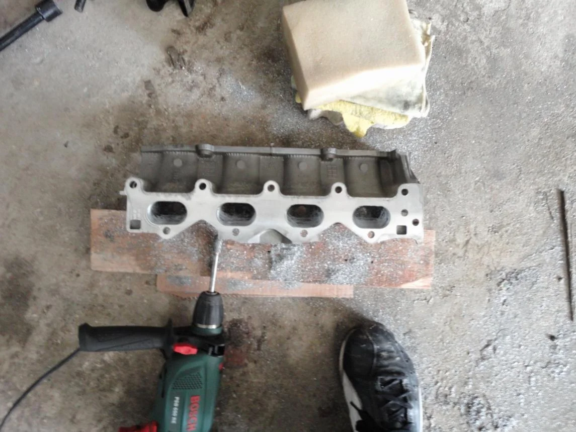

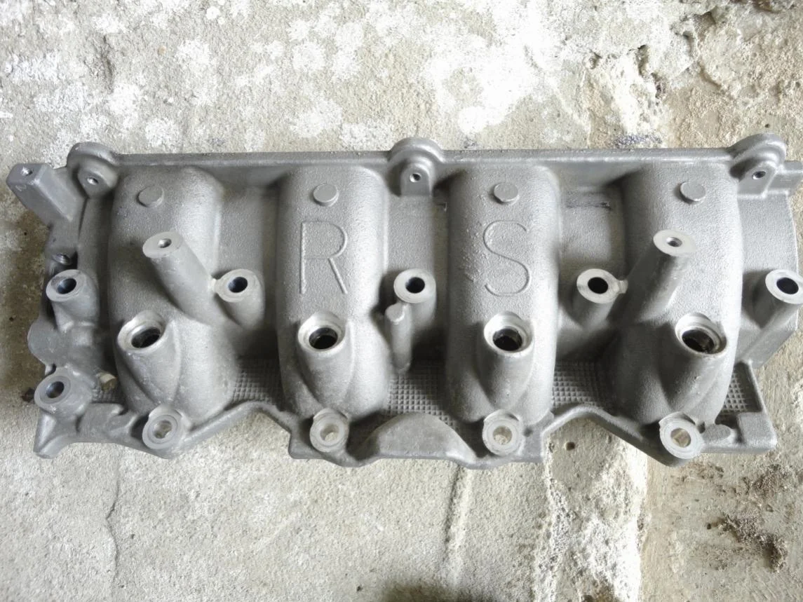

the lower inlet has matched and polished totaly not only the entries but also inside of it

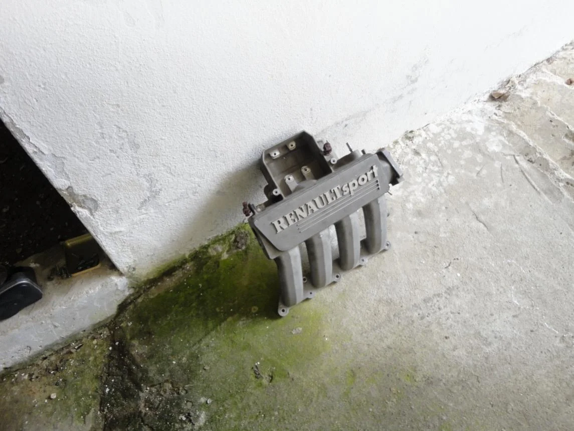

upper one we made it approx 10-12 cm inside

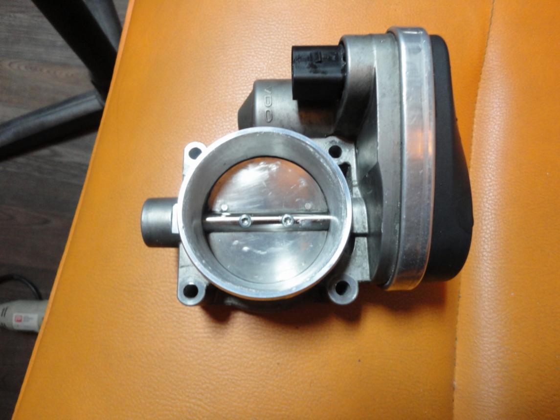

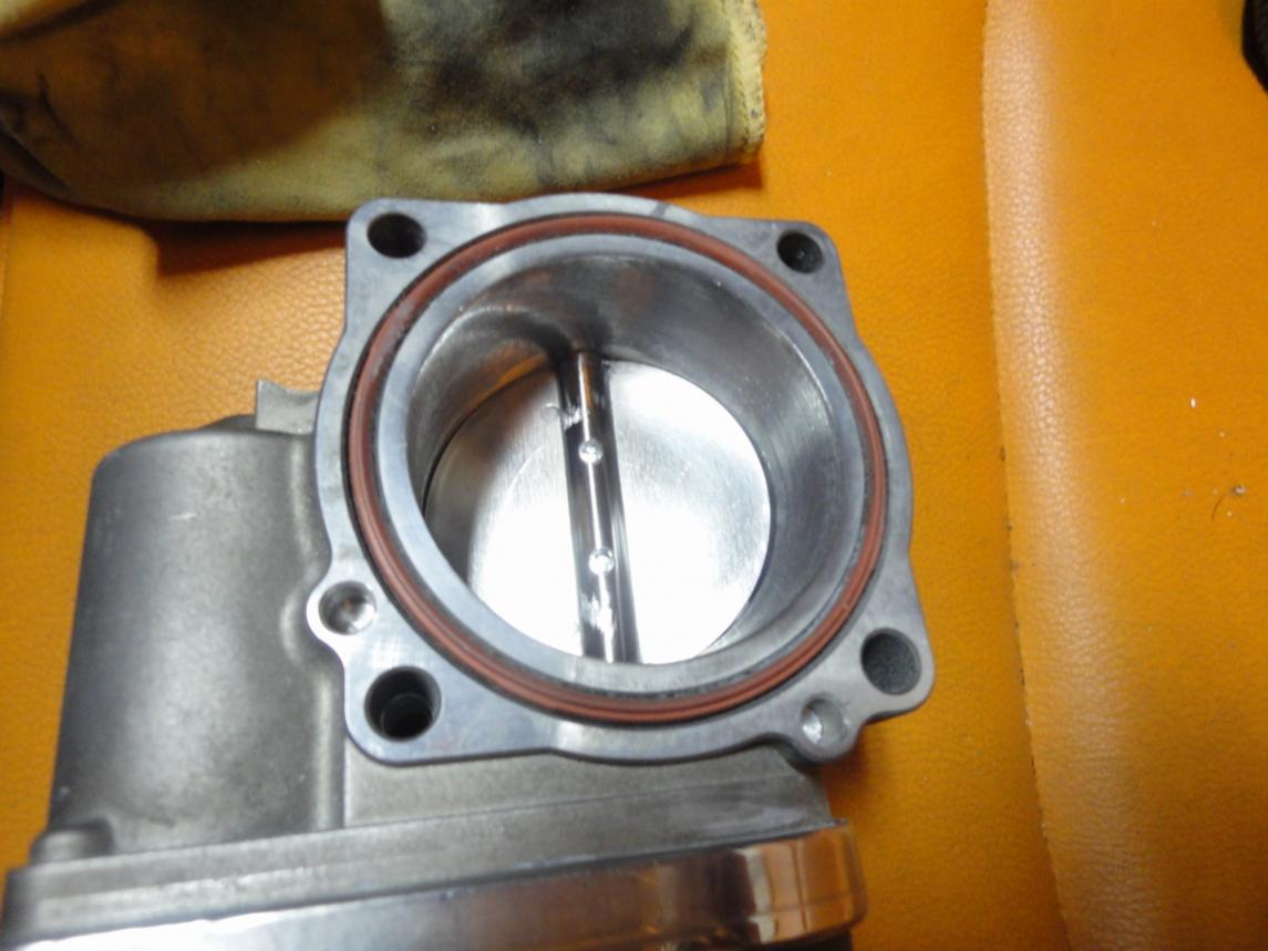

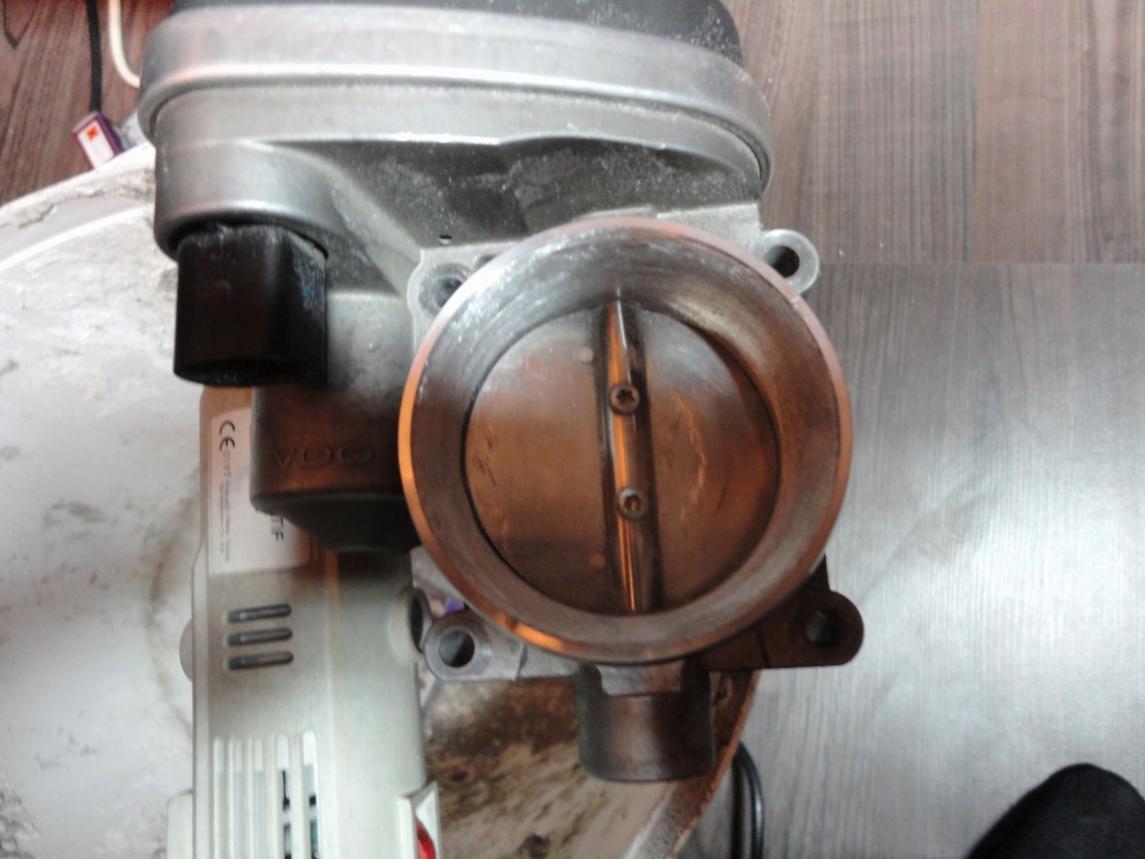

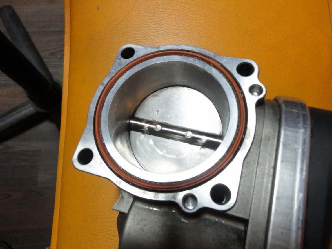

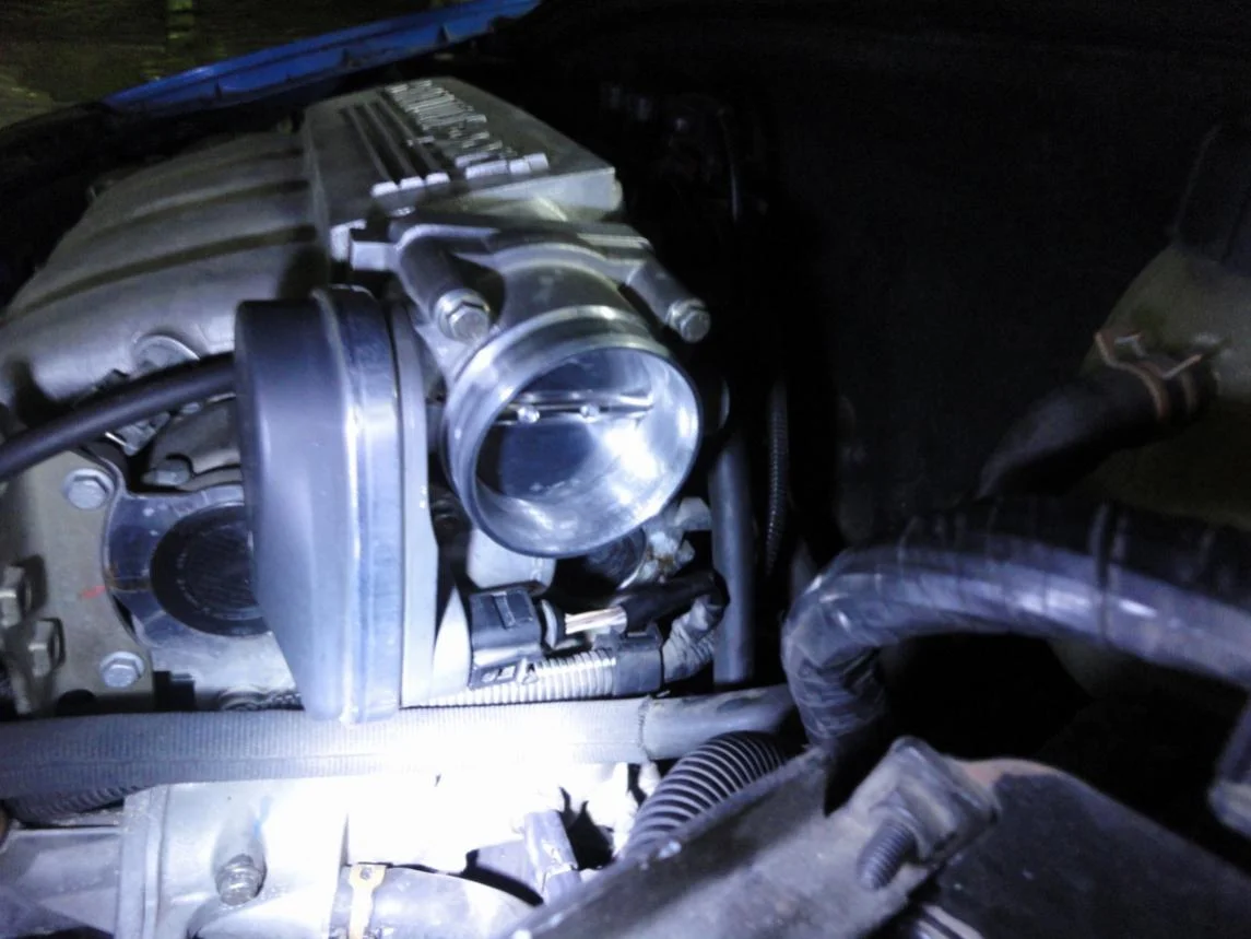

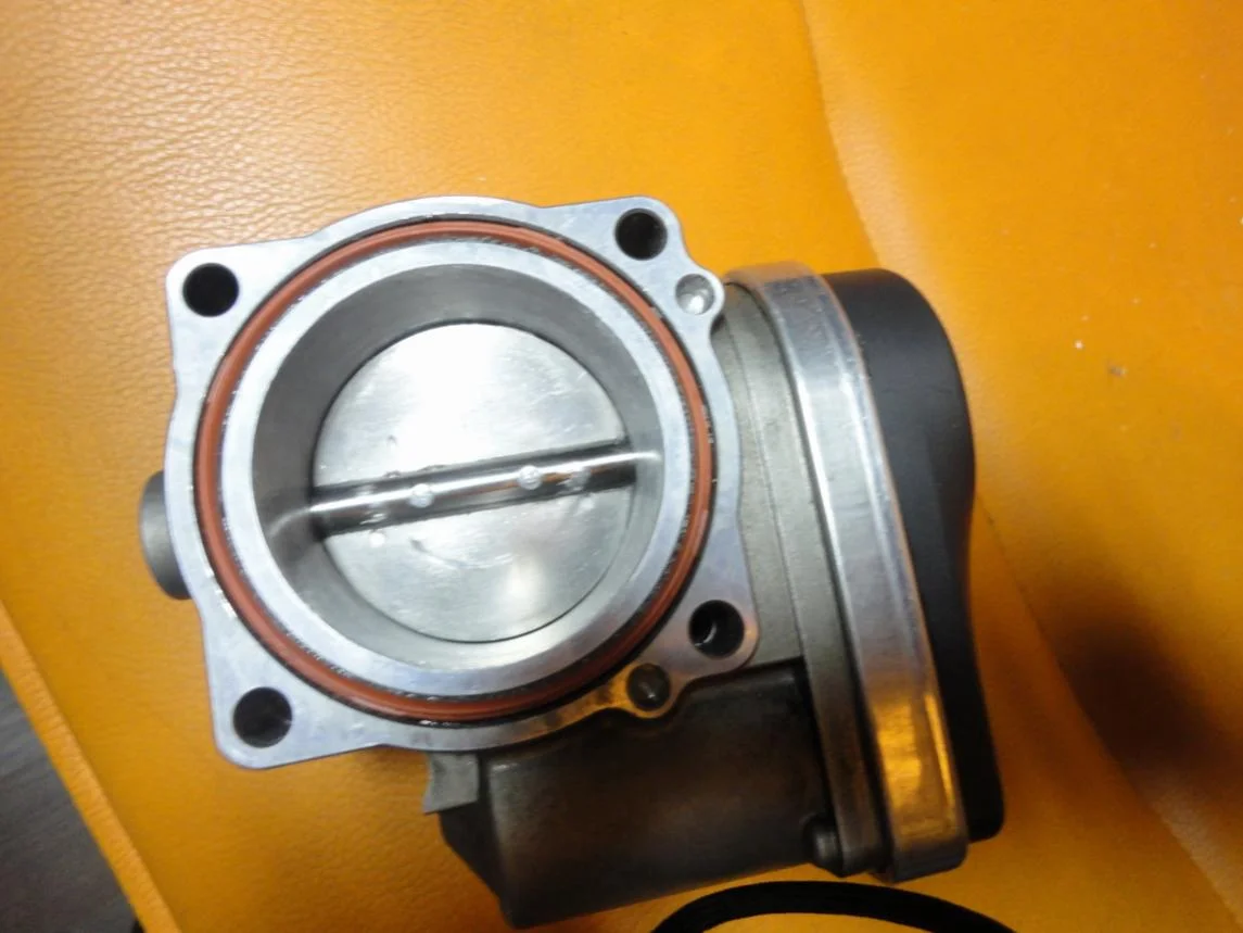

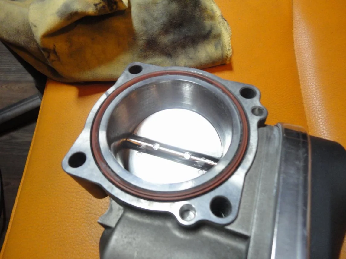

tb is also ported and polished

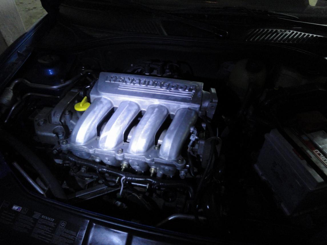

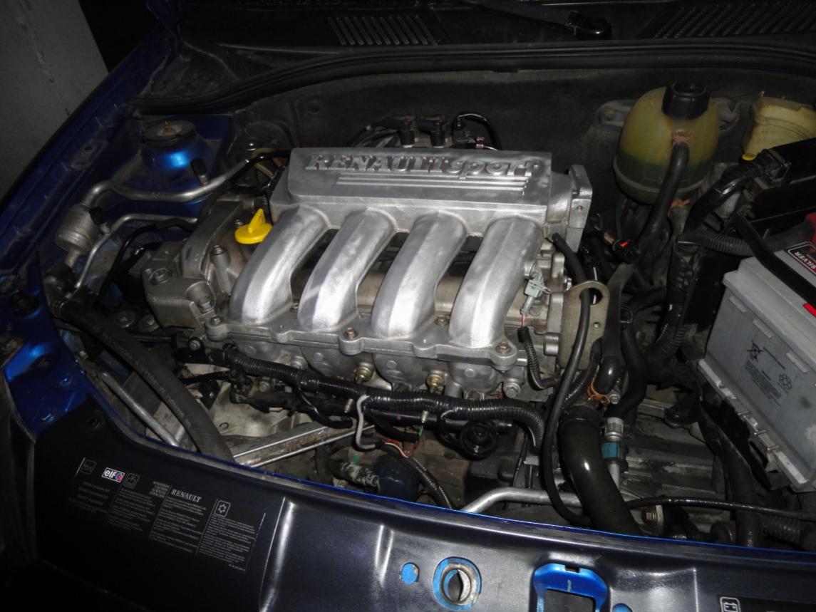

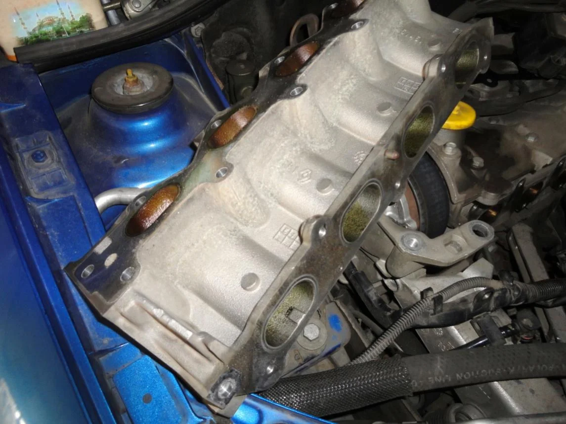

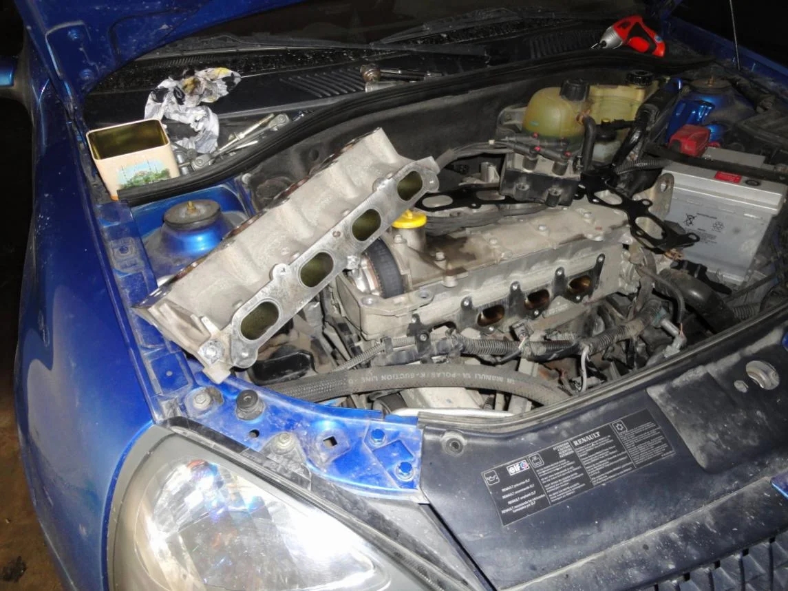

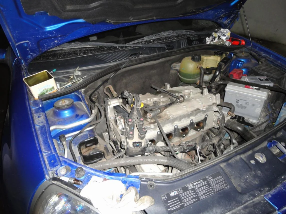

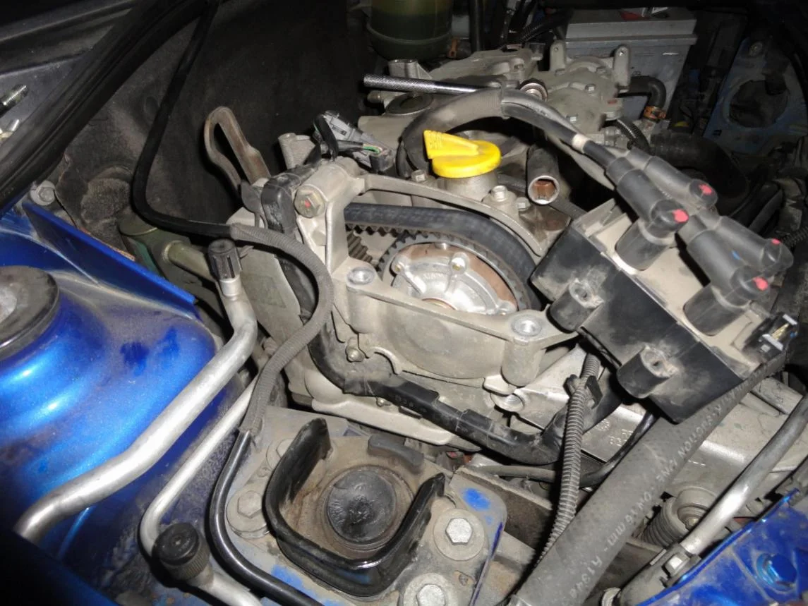

taking of the parts are esay but refiting the lower inlet took a little time
without gasket it slides very easily but with gasket ist hard to slide it in so we oiled alittle it
as we see after this the mpg increased and the throttle response is better
the idle is a little high in this car but its also decreased about 100 rpm to 875-900 rpm
