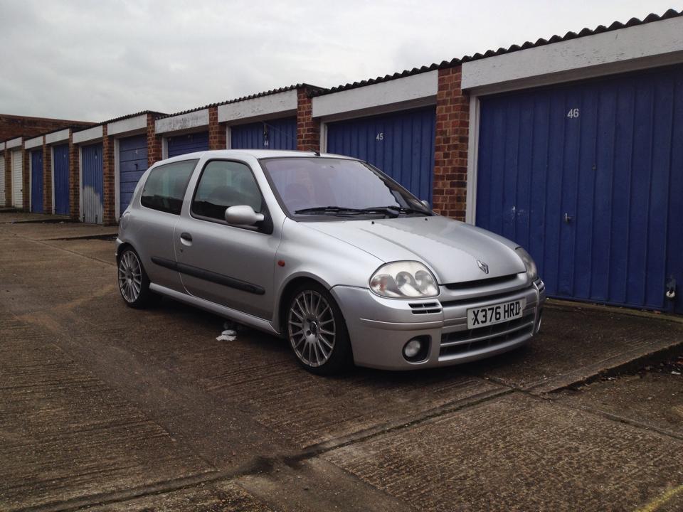

Nice car mate, im growing to like ph1s more, are you going to put some standard wheels on?
Thanks man! I'm not 100% yet, i sometimes really like these wheels and some times i'm not sure on them. Only had it a few days so i'm still deciding lol

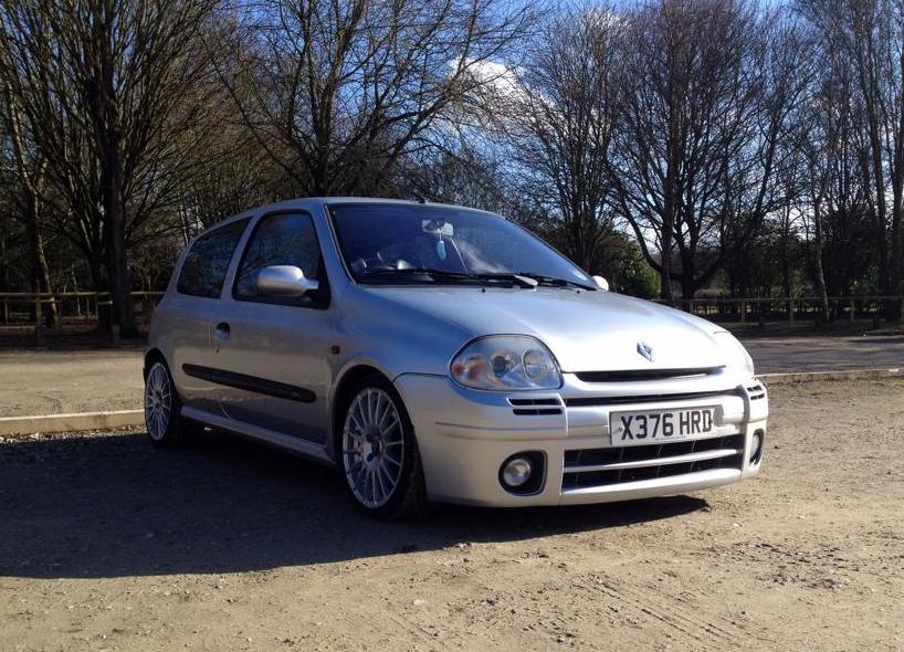

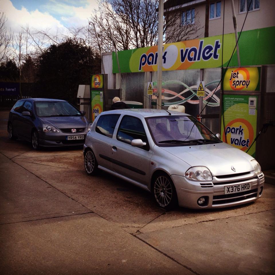

So the weather was alright today, and i had the day off, so thought i'd give the Clio a quick clean, only a quick jetwash at the petrol station then a few little bits at home, but i must say, looks SO much better!
The gf tagged along in her EP3 TypeR
Had a good looker over the body of the car, as i never seem to notice a lot of marks and stuff when i buy it, but its honestly very clean, very few scratches and marks on it. Needs a new rear bumper as its somehow bowed out a bit? And the front bumper needs remounting. But its all good!
Also thought this was quite ironic for my jetwash ticket...
Also fitted a new washer jet pump today, as my washers were more like a dribble than a jet!

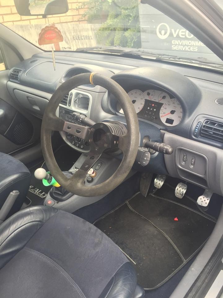

Looks really nice that, I really, really wish I'd bought a phase 1 now, just don't like the dash.
Jekyll
Honestly mate, you get used to the dash. It was the only thing I didn't like but I love the old skool look and feel to it. It also doesn't feel as cheap as the the ph2 dash.
I even got rid of my Sony Bluetooth mp3 CD player for the original retro tape deck with Michael Jackson's Bad album on cassette for cool points! :blush:

I wasn't sure of the dash when i looked at it, but i actually do prefer it to my mates ph2. And YESSS, all about the retro tape deck ;)

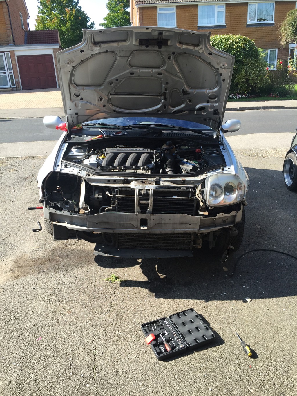

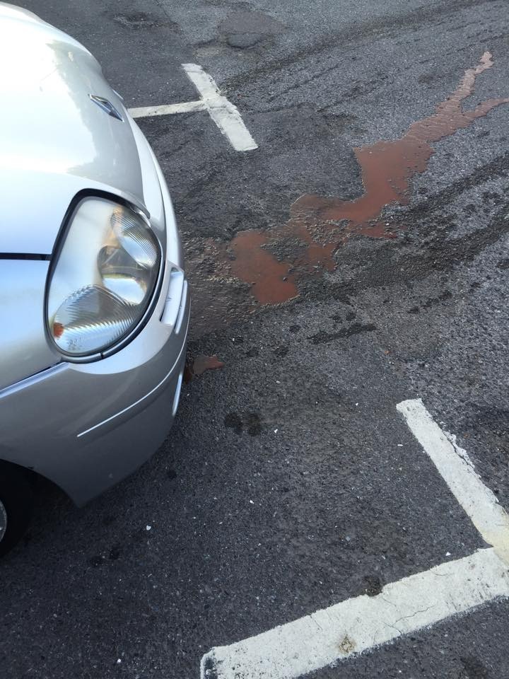

Radiator didn't fancy holding water anymore. So stripped the front end down that night, ready to pick up a new one in the morning. On to the next issue...Ordered the radiator the night before from ECP, picked it up, no issues, got it back, had a big threaded hole in it didn't it. Guessing the ph2 has a different temp sender and that euros only stock one rad for all clio sports. So much to the partners disgust, back we went to collect the blanking plug i needed. JOB DONE!

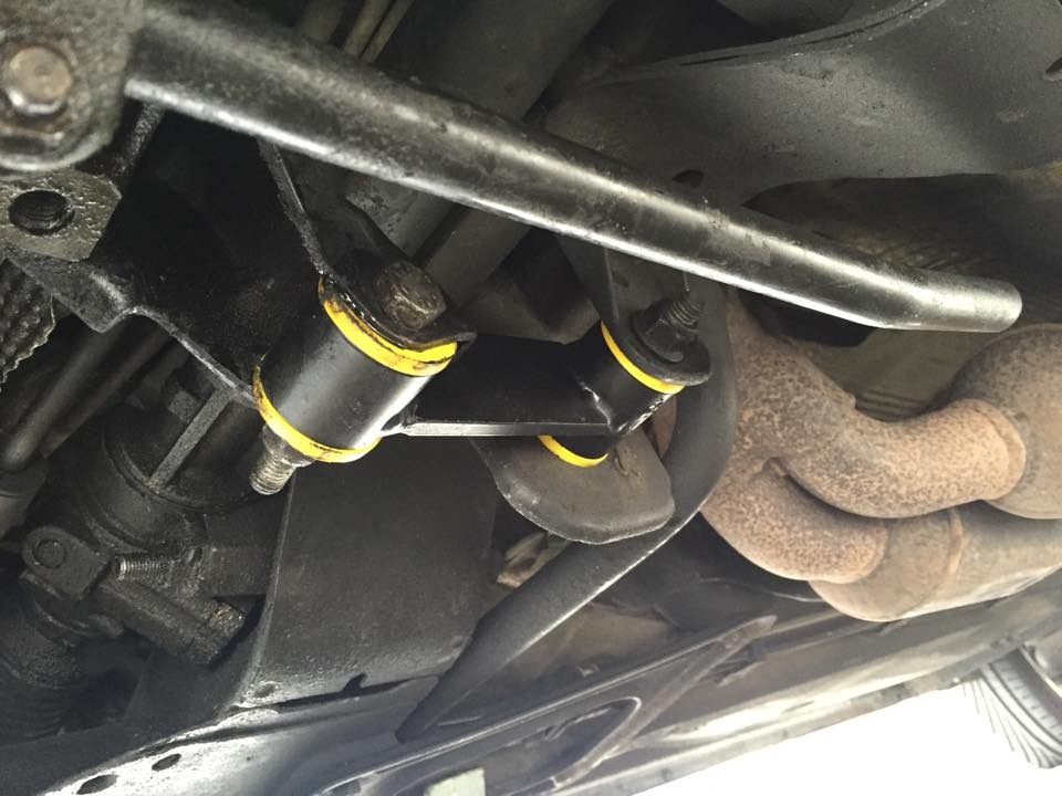

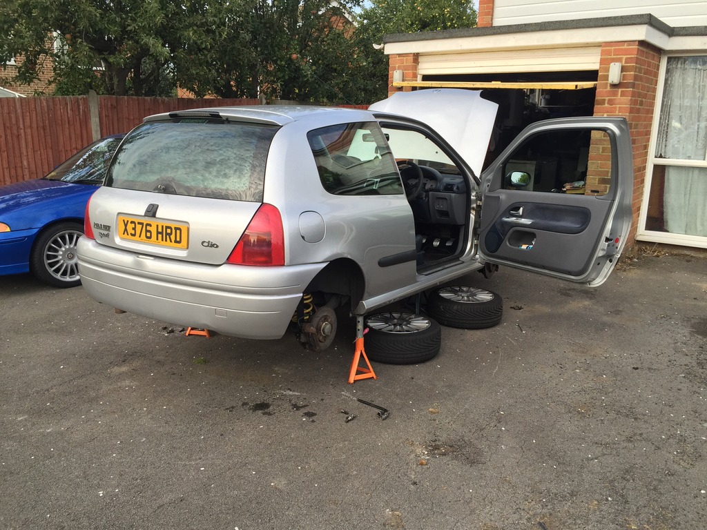

Next on the list was the dog bone mount, been getting a knocking from front end for a month or 2, bushes and ball joints are in good condition, so put it down the the dogbone, and the manifold hitting on bulkhead? Was waiting and waiting for a polybushed mount to come up as it seemed an easier option than buying the bushes, removing the mount, finding someone to press bushes in etcetc. So found this little gem from Evol Engineering on eBay and turns out they are also on here.
Very easy to fit, more compact than the standard mount, very nicely put together and has made a huge difference. Would recommend people get one if you're looking in to a polybushed dog bone!

I had a similar problem with my rad last year deciding not to hold any water....the small plastic blanking plug ont he side was fubar. But this seemed very hard to find at short notice! I did find a Ph1 Exclusive at the local scrappy and that didnt have a rad with a blanking plug on! So I found a Megane with a metal plug and just used that.
Nice tidy example yours is, do like the wheels. Hope the Type R is a constant spec in the rear view mirror :wink:
I just went back to euros and luckily they had a bung that fitted!

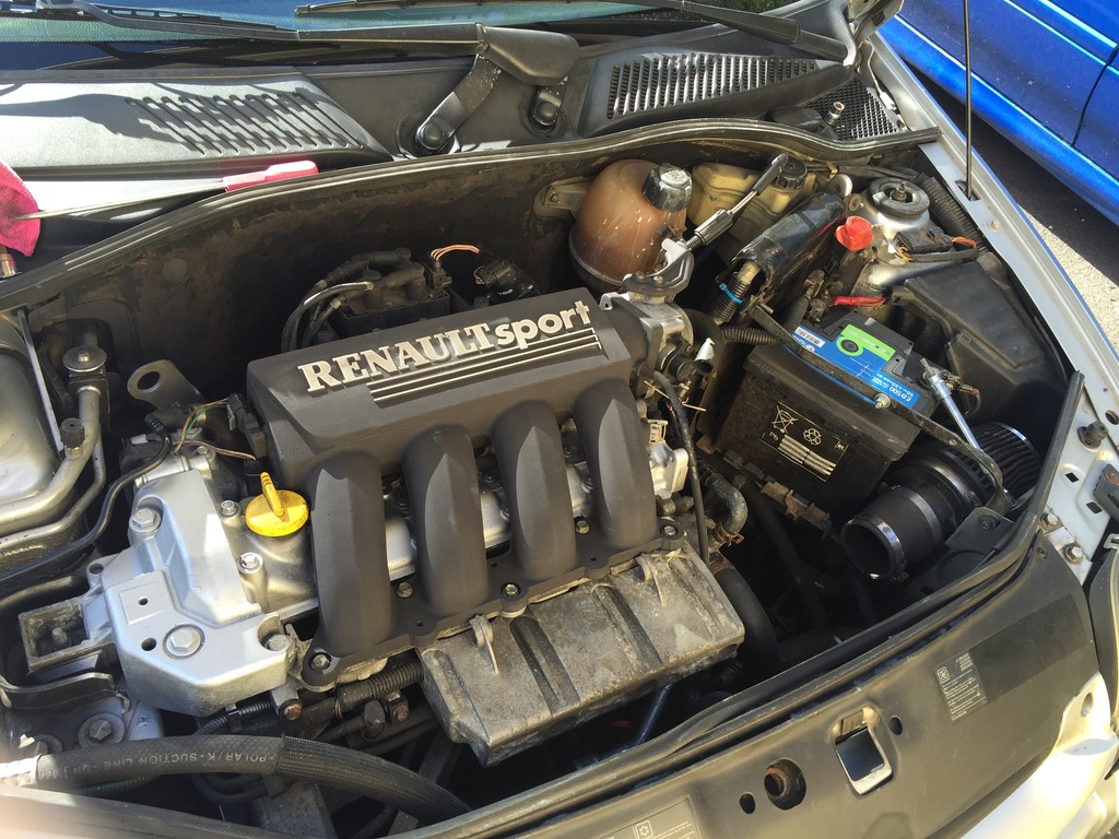

So I finally got round to giving the engine bay a little spruce up! Just kept it simple, but really happy with how it came out, considering it only took about an hour and half haha
