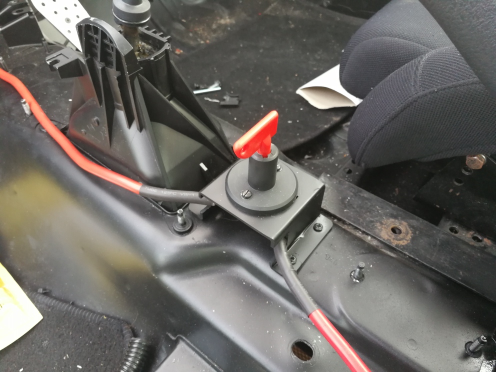

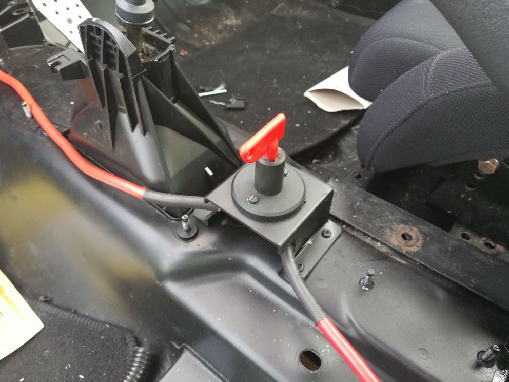

The cable then went from the fuse to the cut-off switch mounting below the handbrake. You can see the notches I had to cut out for the cables.
See the thread sticking up and rubbing the cable near the left of the photo. I`d cut that off otherwise it will eventually rub through and cause a direct short.
That was just put there to keep it out of the way. I have rubber-lined p-clips and bolts ready to secure it nicely, just waiting until I get a rivnut gun to secure the p-clips. Thanks for the concern though.
