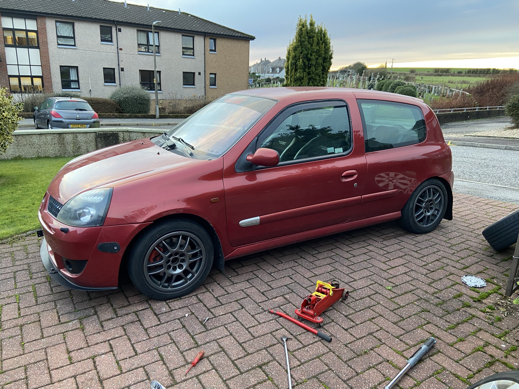

Car  Clio 172

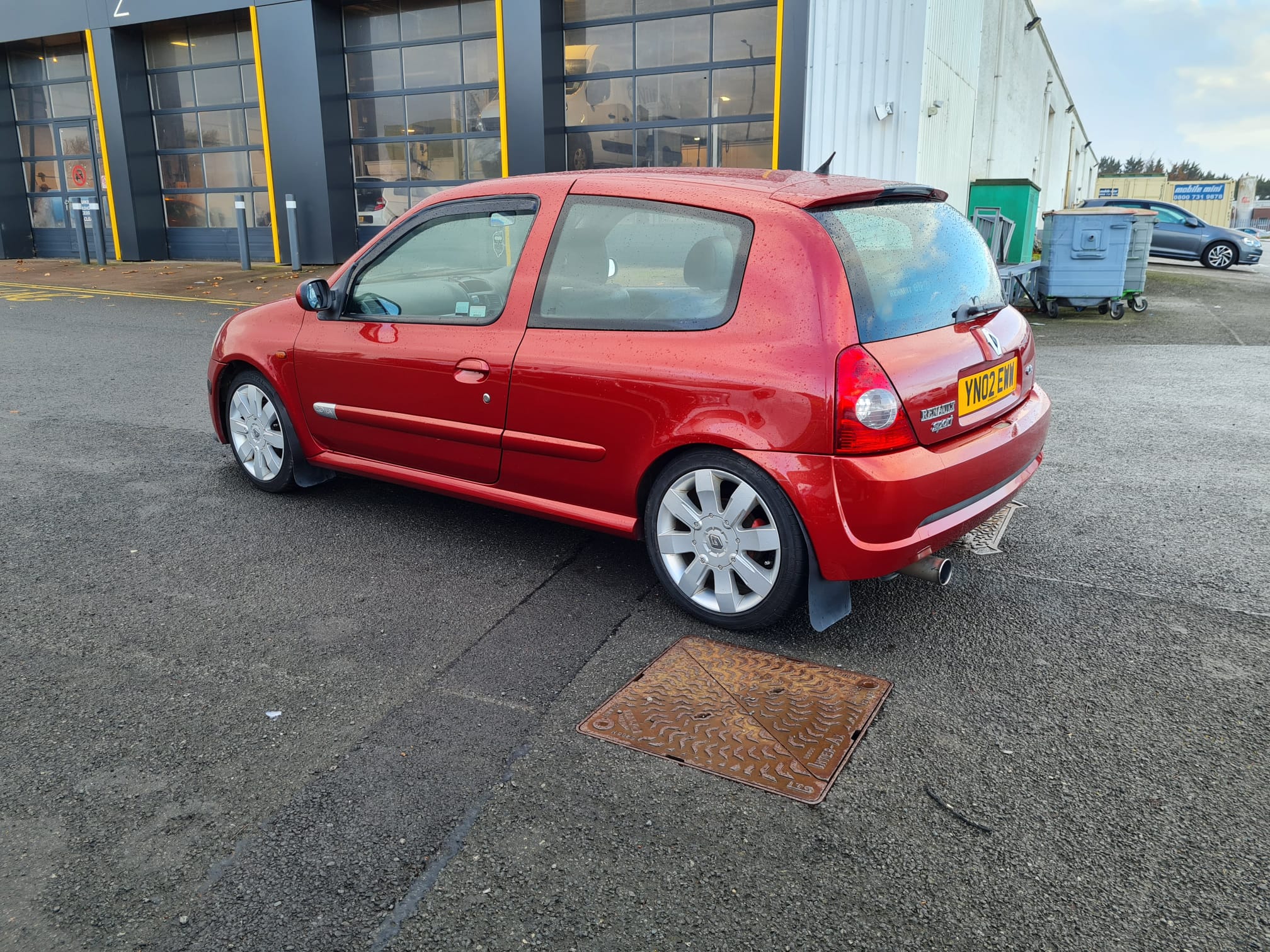

Now I’m a fully paid up member I thought I best introduce myself and the 172 sport YN02EWW!
So popping on Clio sport at 2am last week I spotted the Clio sport festival, dived straight in and booked myself up…… only problem is the Clio is in bits 😂. Now the race is on, will we see Wales? Time will tell.
Back during covid boredom set in and I decided after ten years away it’s time to get doing some tracks days again. The hunt was on for a 197 to replace the hole selling my old one left. So many dogs were about and after a deal for a f1 fell through I gave up for a bit! Watching every Clio in the country for sale, picking one travelling down to England from Scotland to come back empty handed burst me. Till finally a 172 came up for sale in Scotland, 84k on the clock
Off we went with some cash.The owner was spot on, lovely falla. His finance owned the car and he worked for Renault. She bought a new car and he kept it with the intention of doing some track days! Flying off to vagas to get married on the Monday a deal was done and we’re heading home with the Clio! Knockhill was booked.
So here are some of the pictures I was sent before going to look at the the car

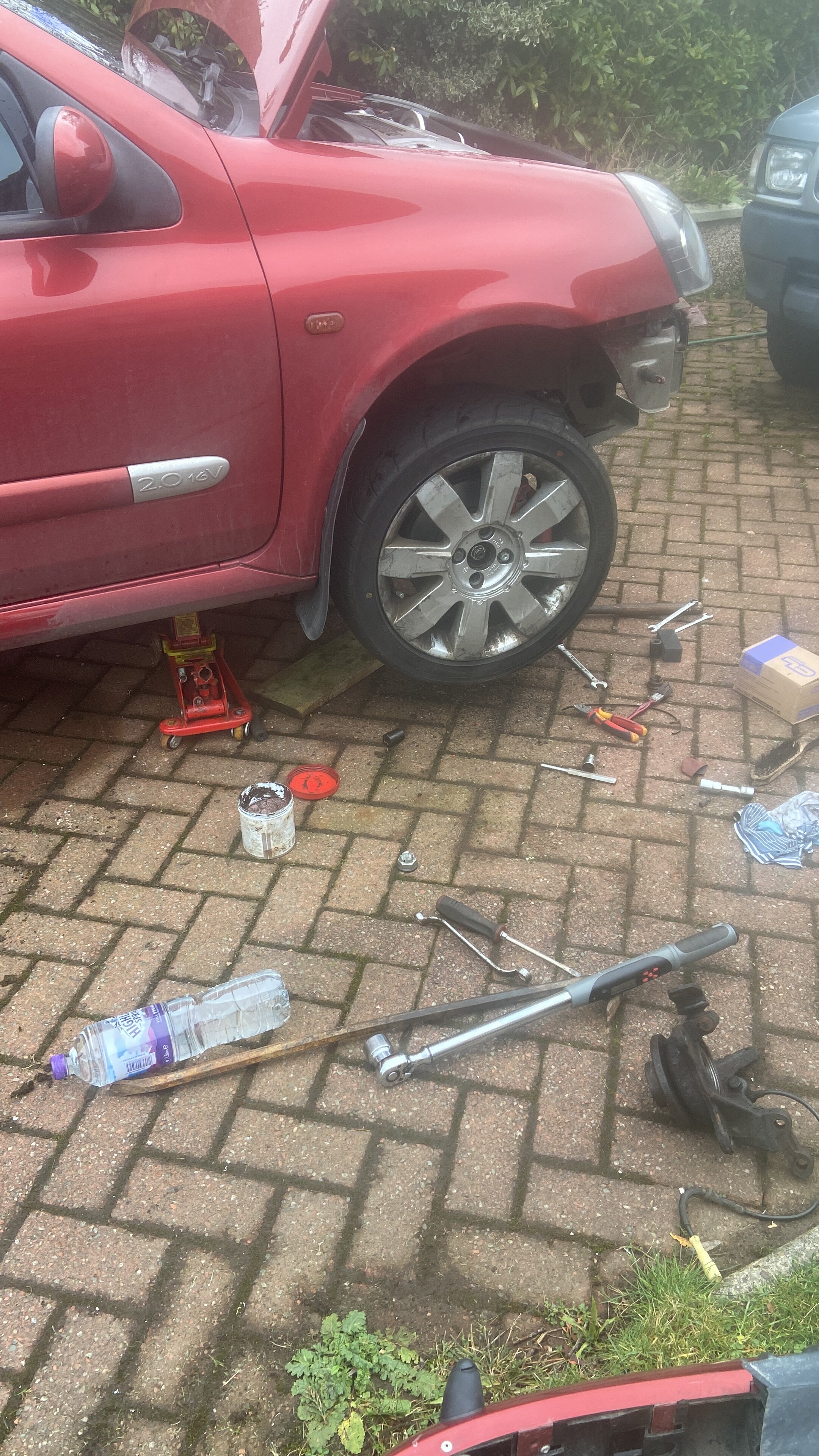

I was sure I could hear the wheel bearings on the way home so 2 Renault front ones were ordered. When I went to fit the drives cv was split and the battery gearbox mount was broken in two, got these from Renomotive. Also decided to fit a full engine mount set from ktec, who sent the wrong parts and after a few heated discussions on the phone resulted in me missing my next track day.

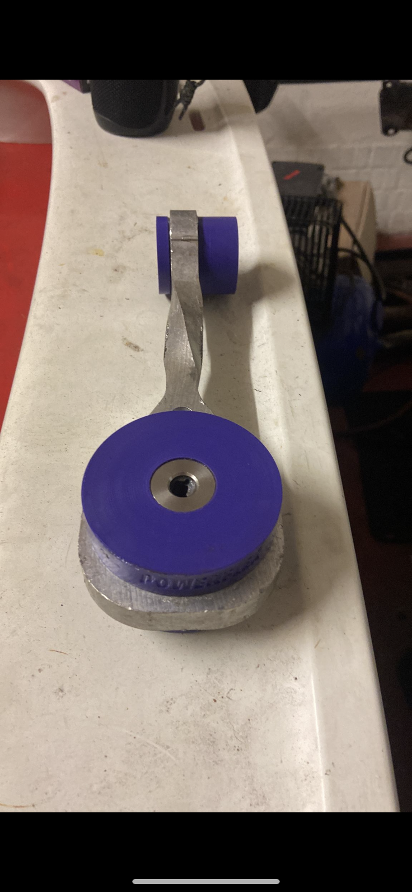

I had read some good and bad press regarding the mounts, but what a difference they made. Is there more vibration? For me a tiny amount. I can live with this, what I couldn’t live with was the fr4 trying to depart the bay when lifting off 😂😂

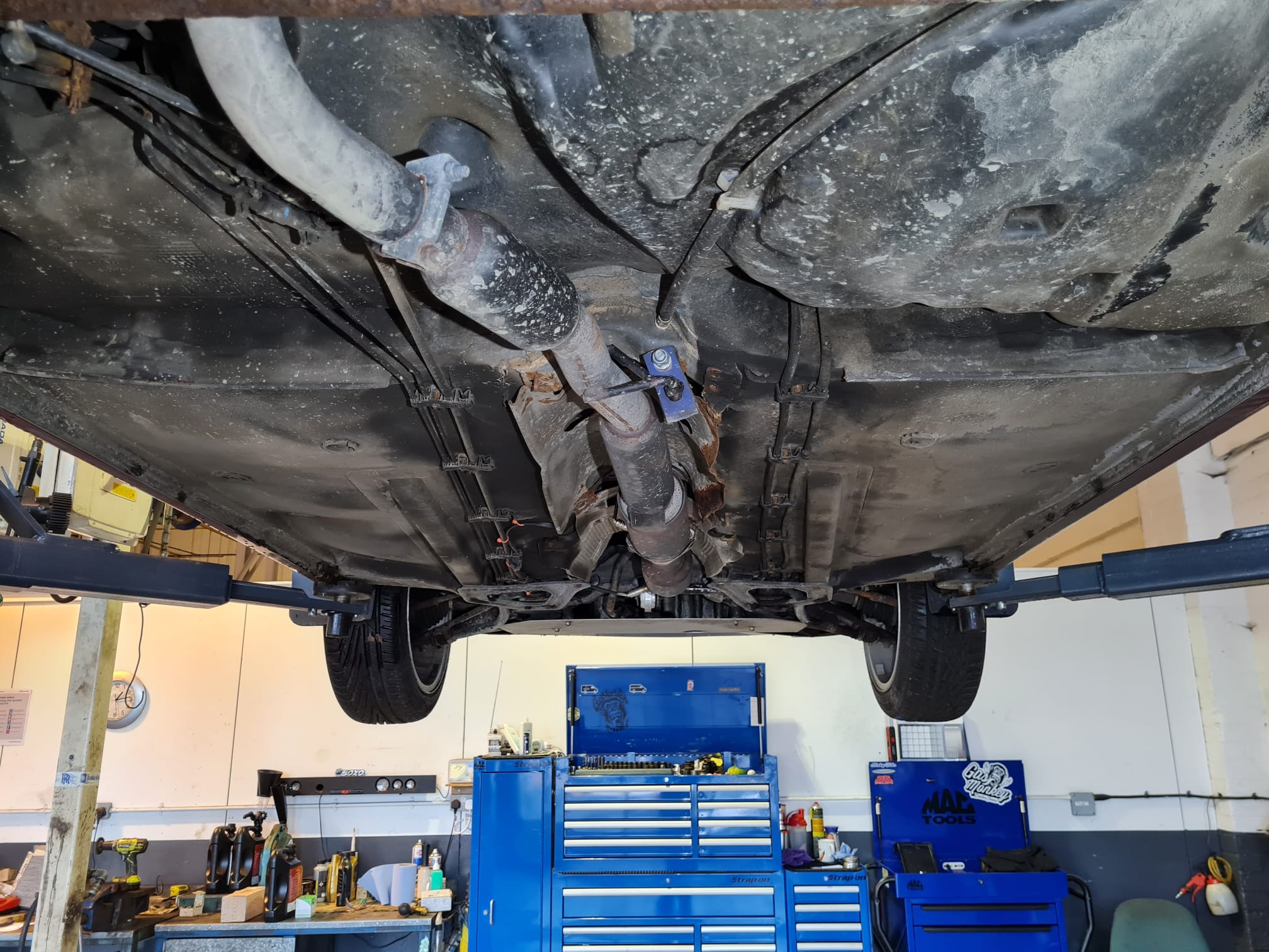

So when the brakes did return, if I barked the car wanted to mount the hard shoulder and the steering wheel would pull the other way (wtf) and the reverse when accelerating 🙄.The car was nursed home, pulled all the front end apart and put back together. All was well. The Clio was on daily duty’s for a while so the pads and discs were removed and onto the 15s she went.

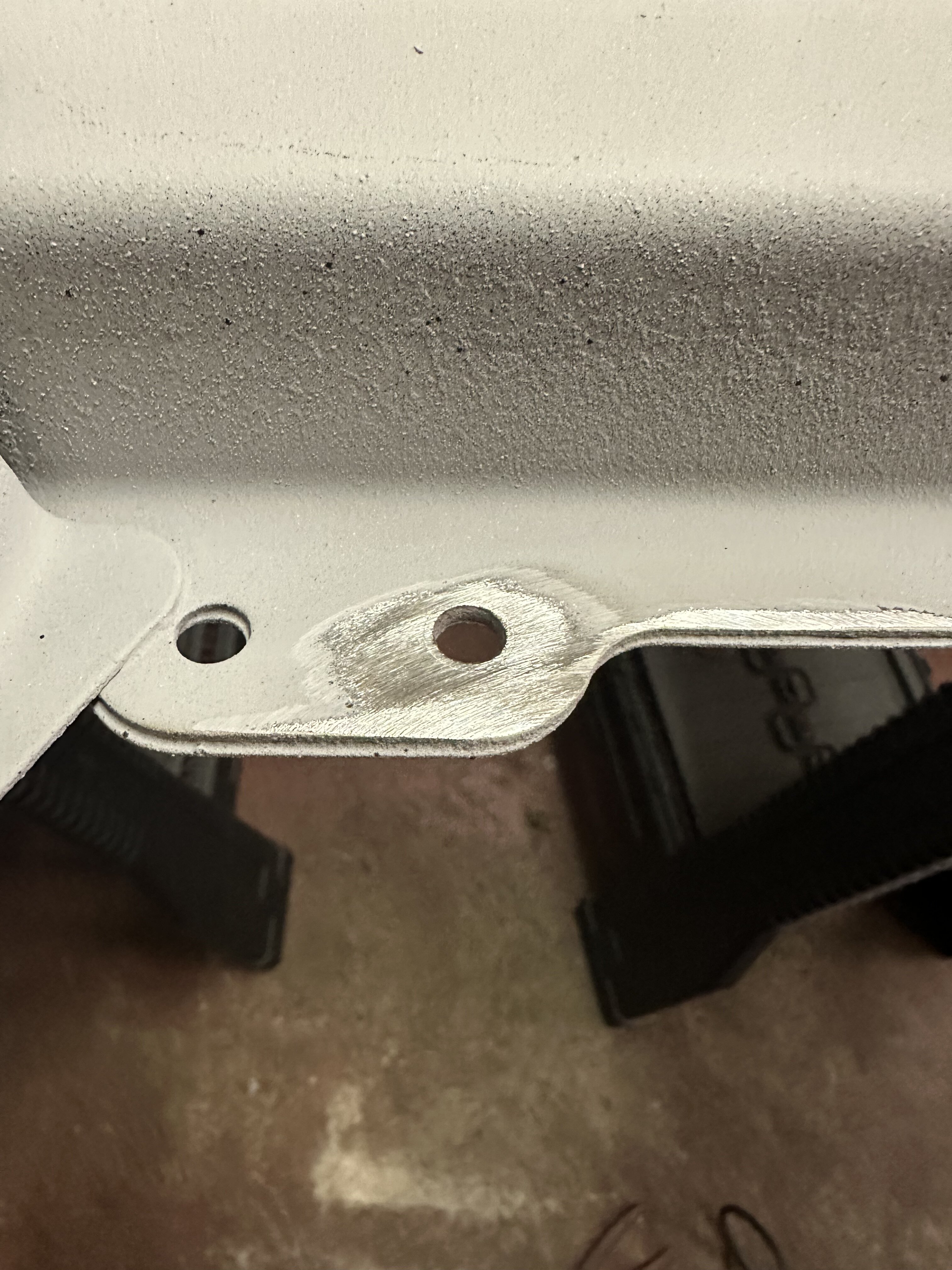

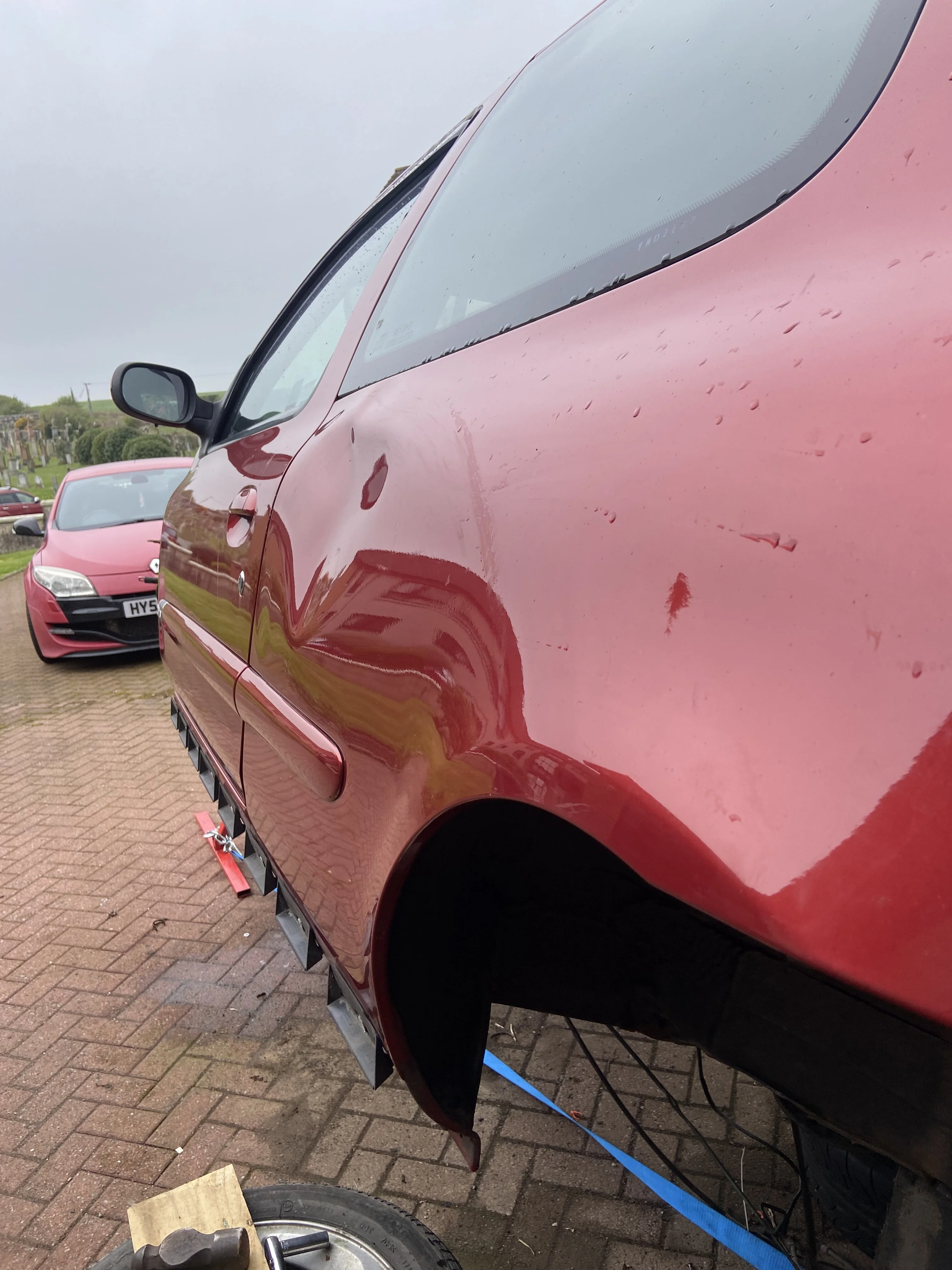

Slowly but surely the steering issues returned, it turned out to be the holes in the bottom arm had elongated, new arms and some bushes ordered. I had always knew the sill at the jacking points needed looked at, most do. I was also scared to look behind the rear 1/4 cards 😂😂. That’s where my mini resto really started. How it started ………

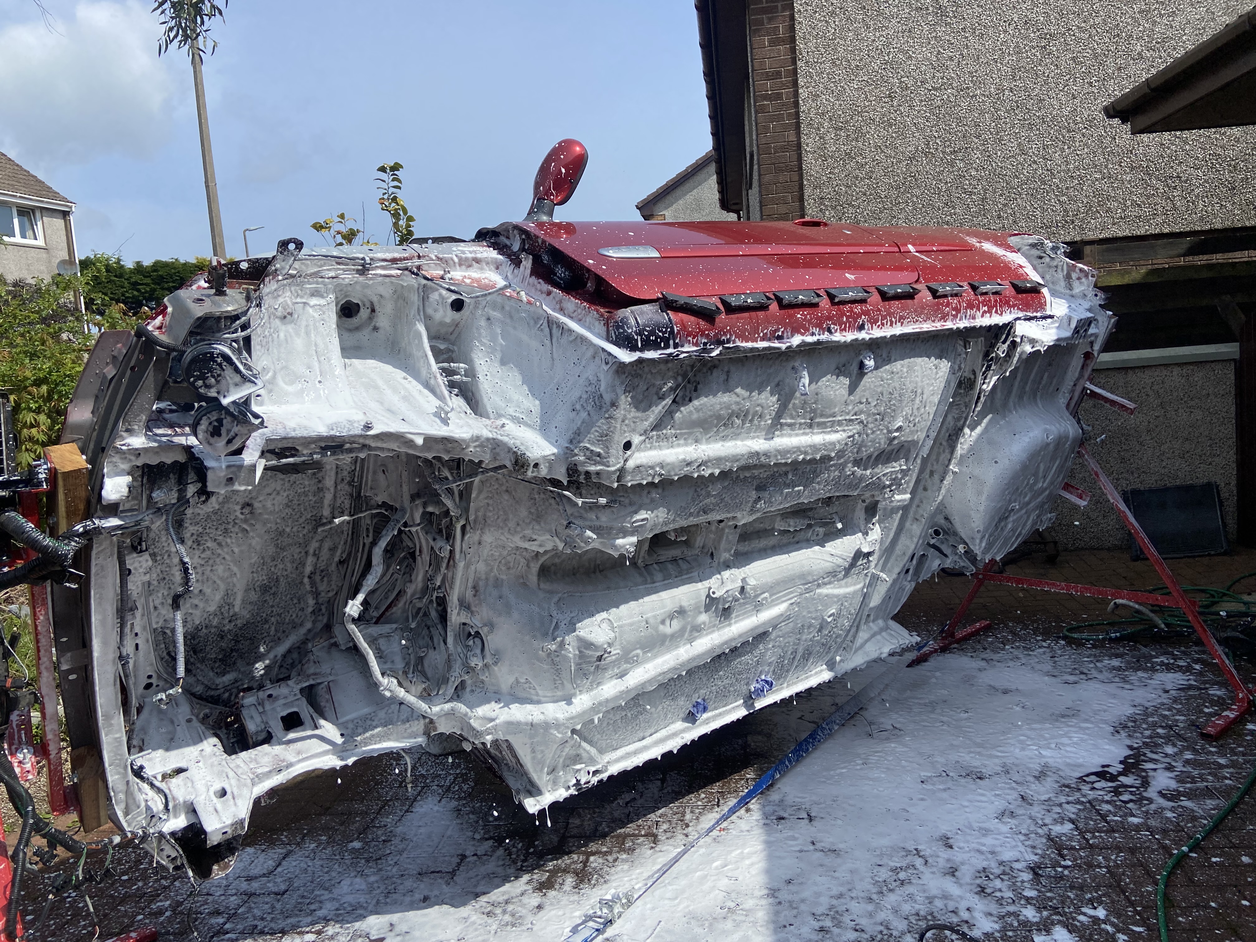

so with the 1/4 panel off everything looked very clean tiny, back seats came out and the car went on axel stands

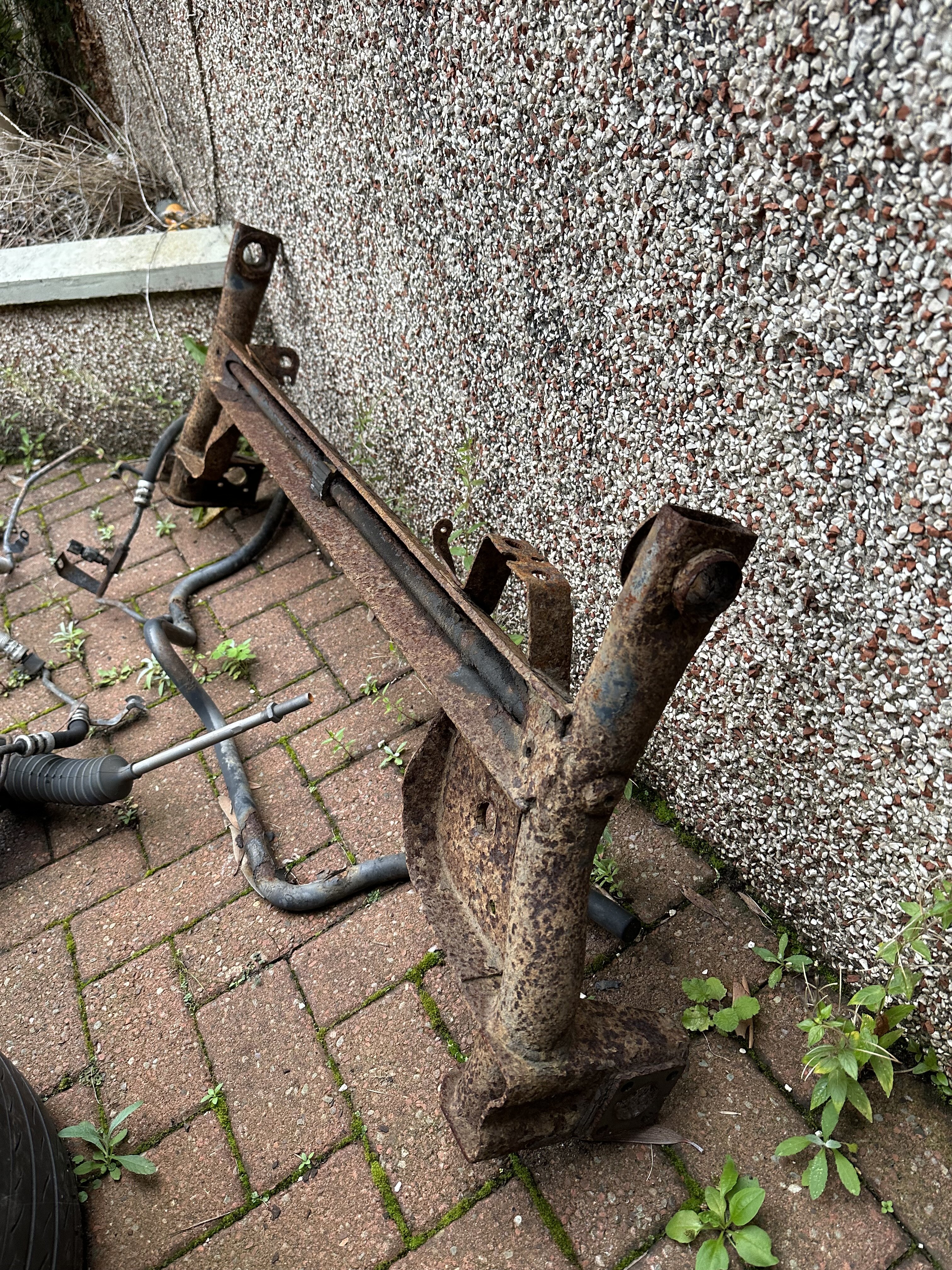

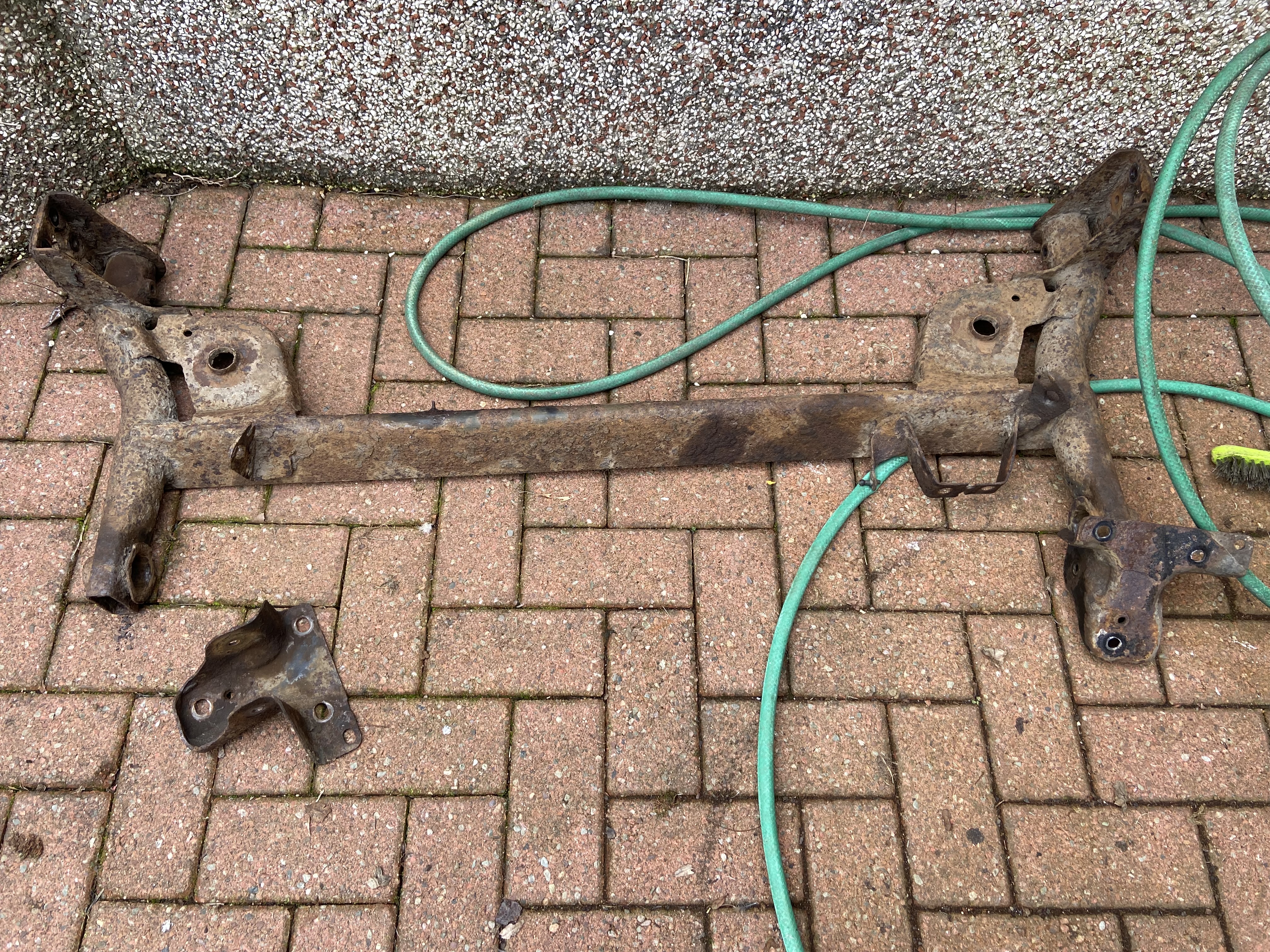

The plan was pop the beam out, refurbish and refit! At the same time treat any rust and give everything a check out.

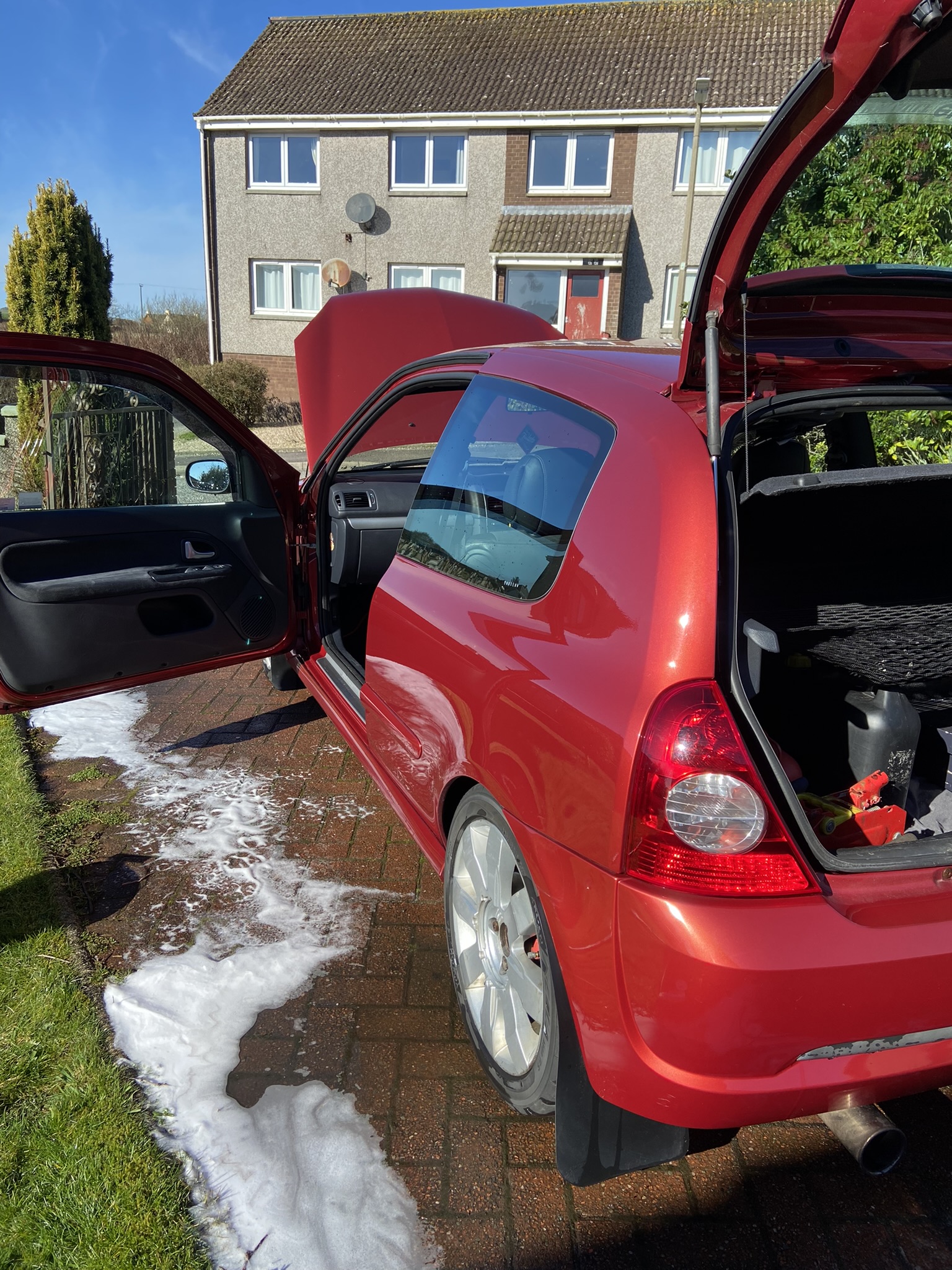

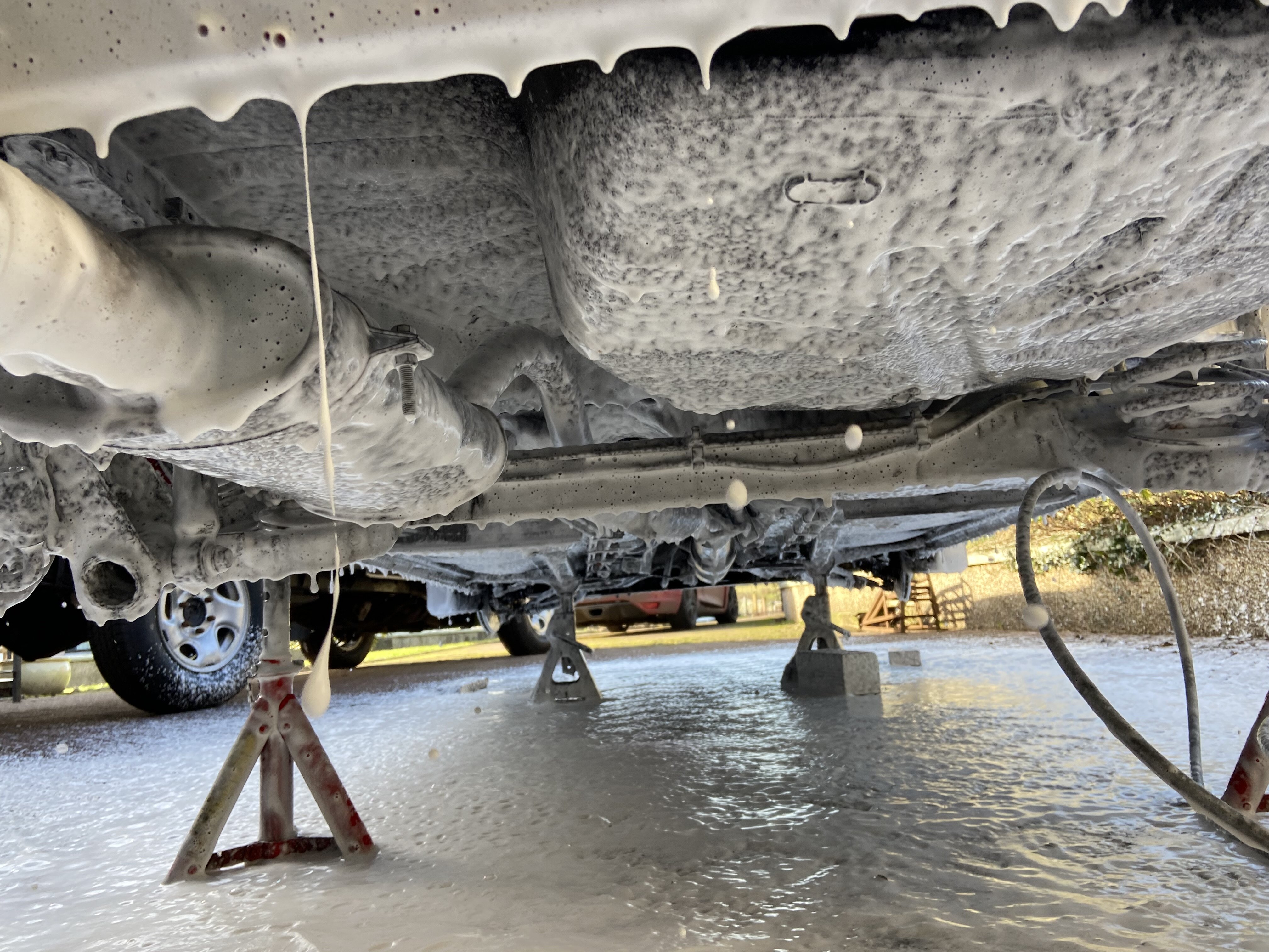

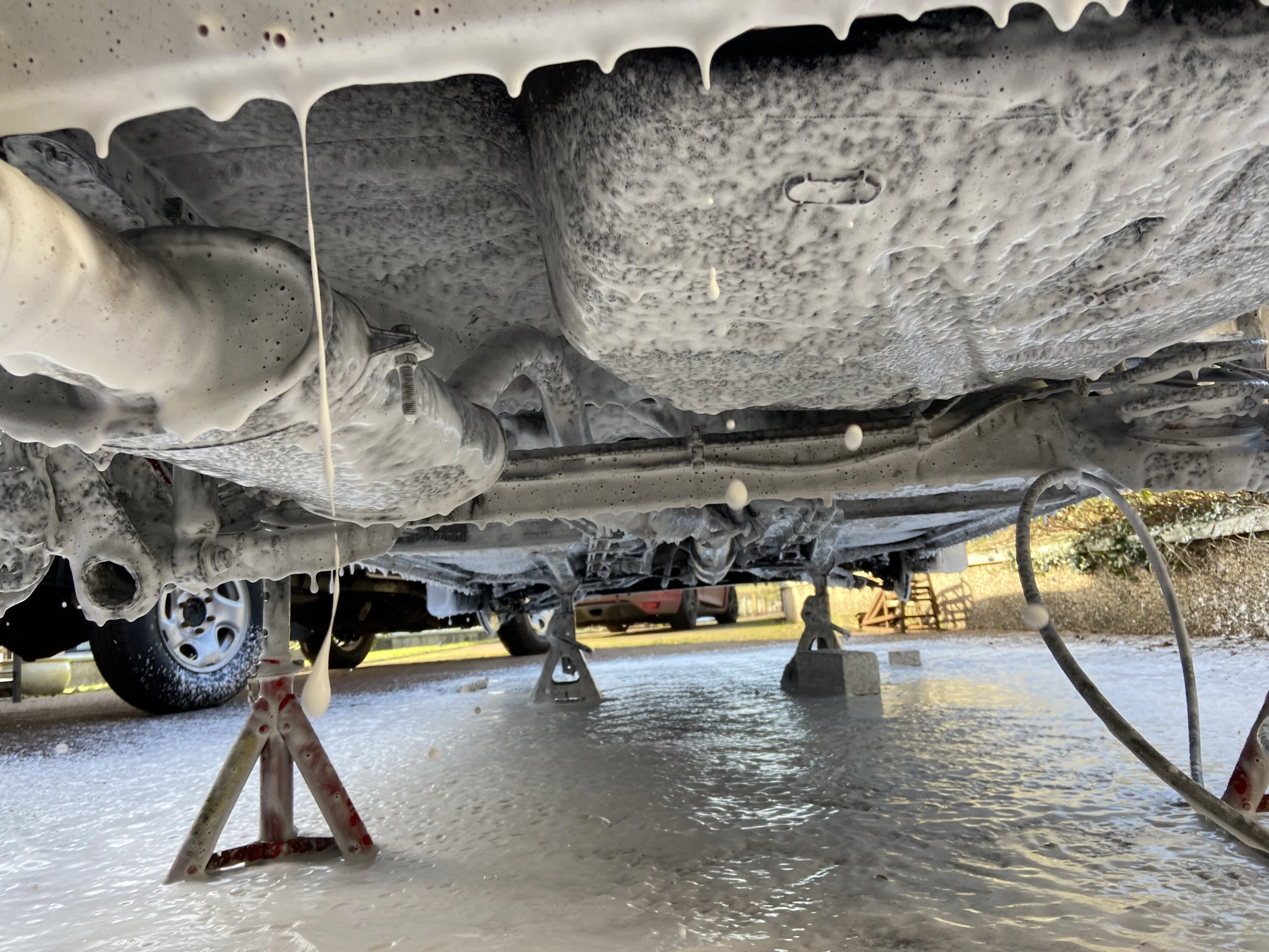

A snow foam to get 20 years of road grim off to see what I was dealing with
Beam out and stripped ready for some much needed love

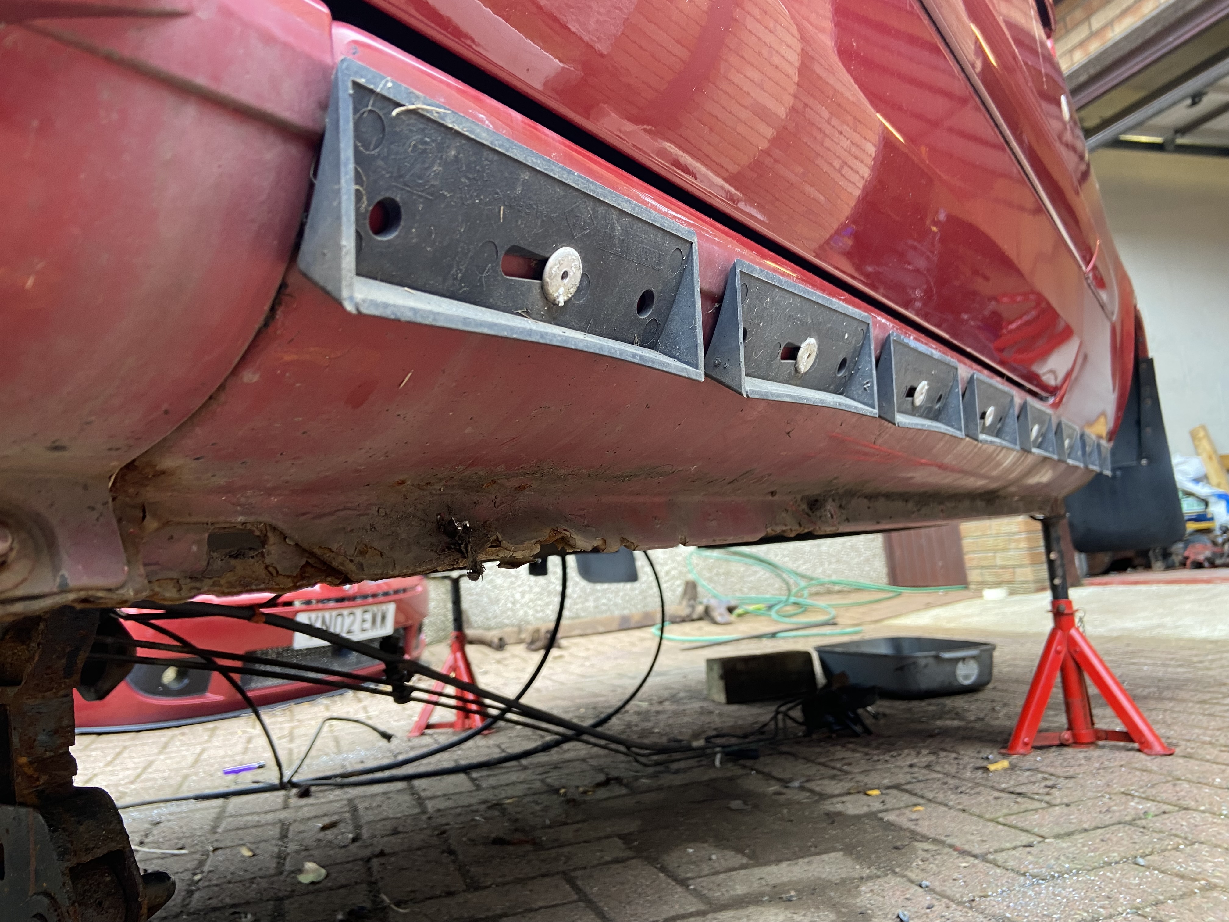

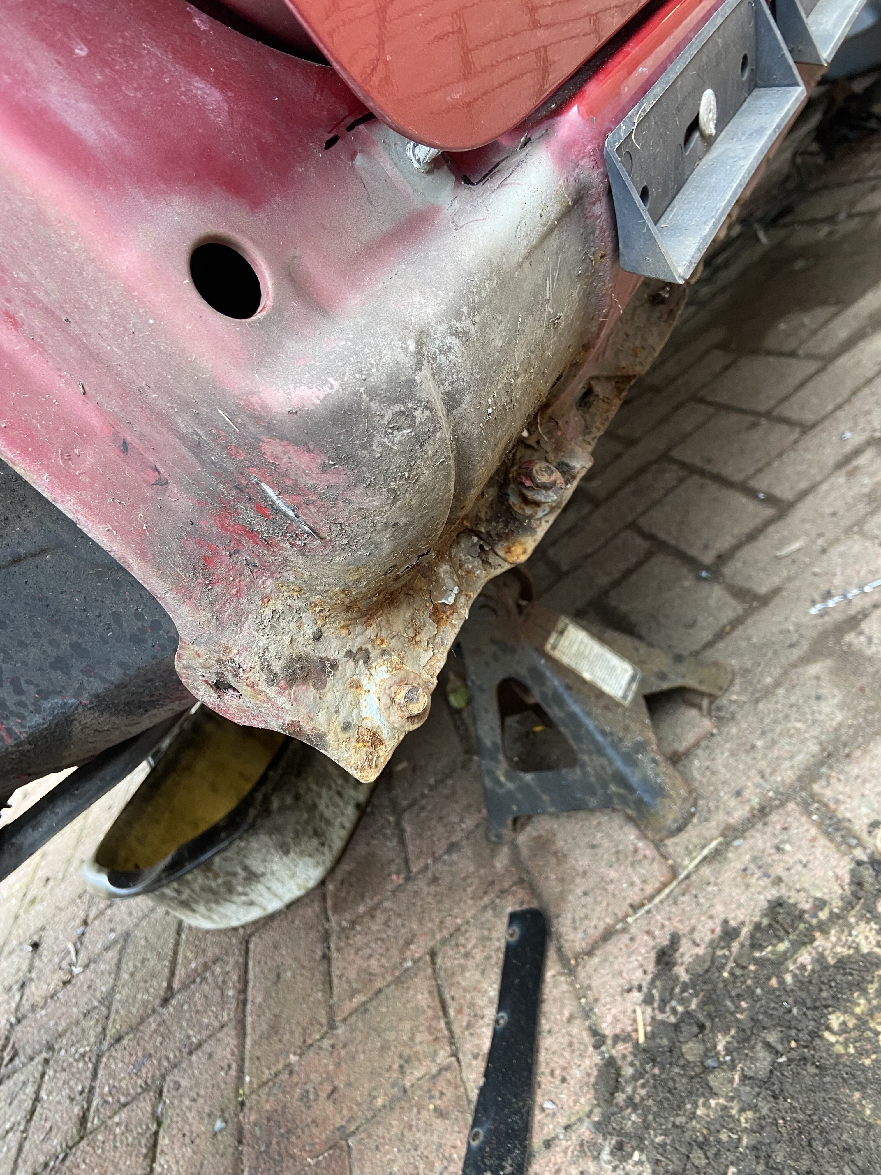

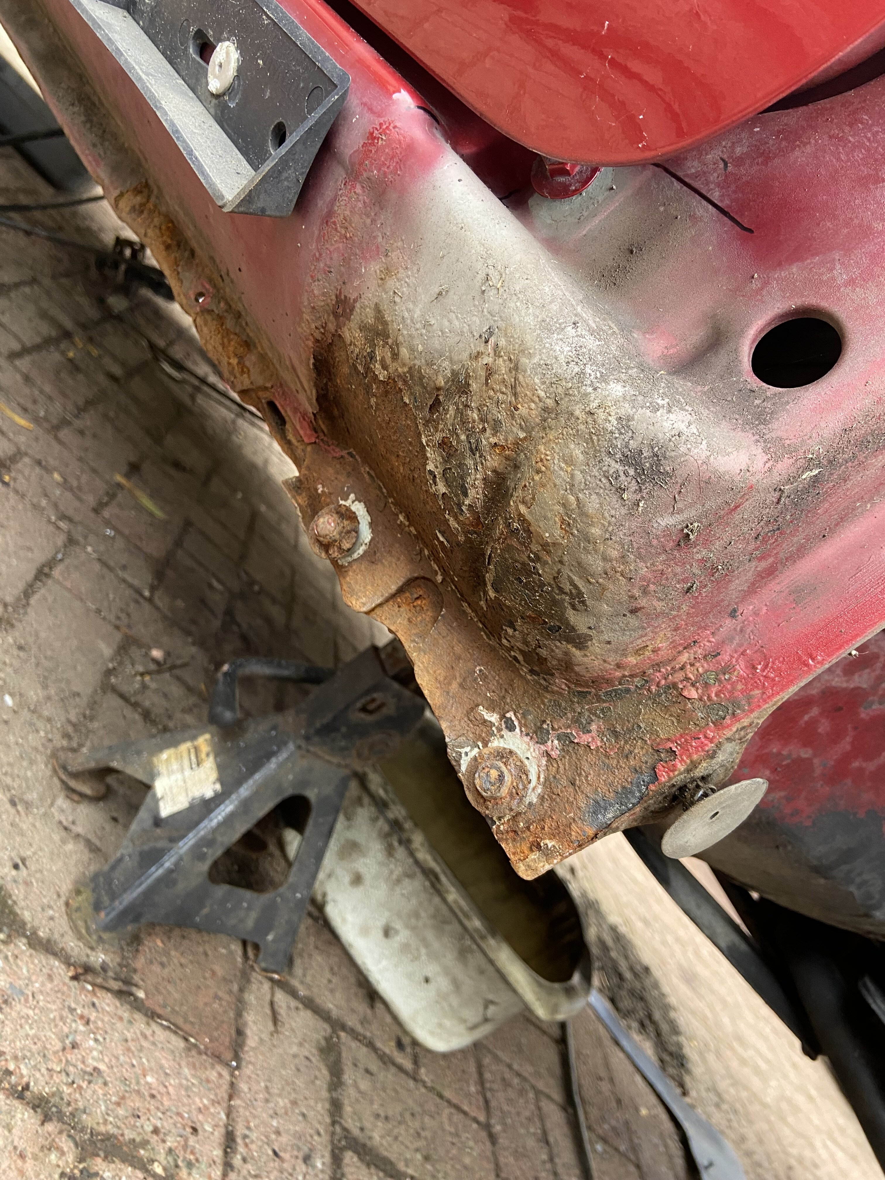

Next up off with the skirts, plenty of surface rust especially at the front of the skirts. Nothing that alarming. Followed by the wings in the hint for rust …… so far all well 😂😂😂😂 tbc
Passengers side crusty but solid
Drivers side looked solid or so I thought

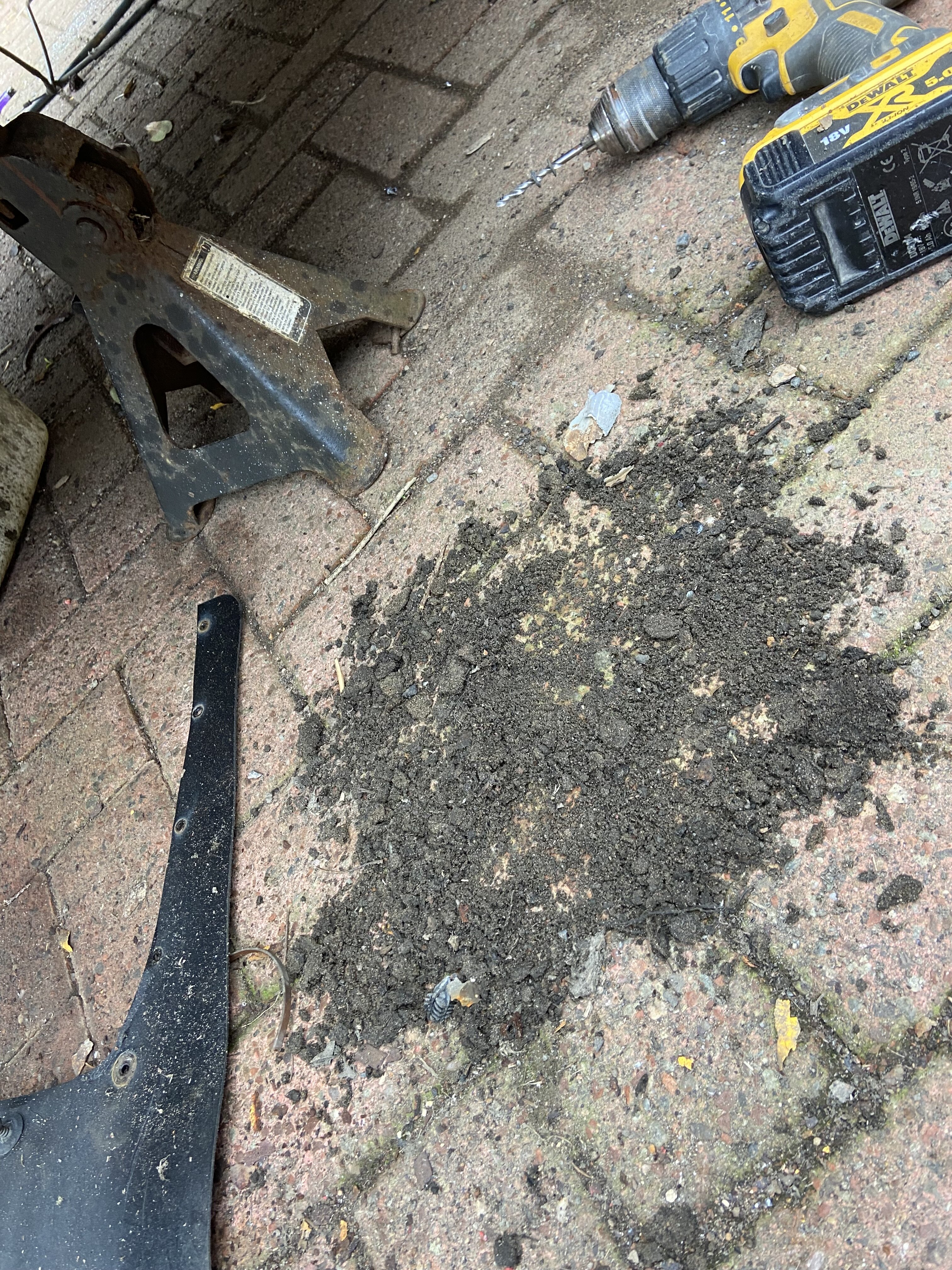

And just look at the wet trapped mud behind the skirt

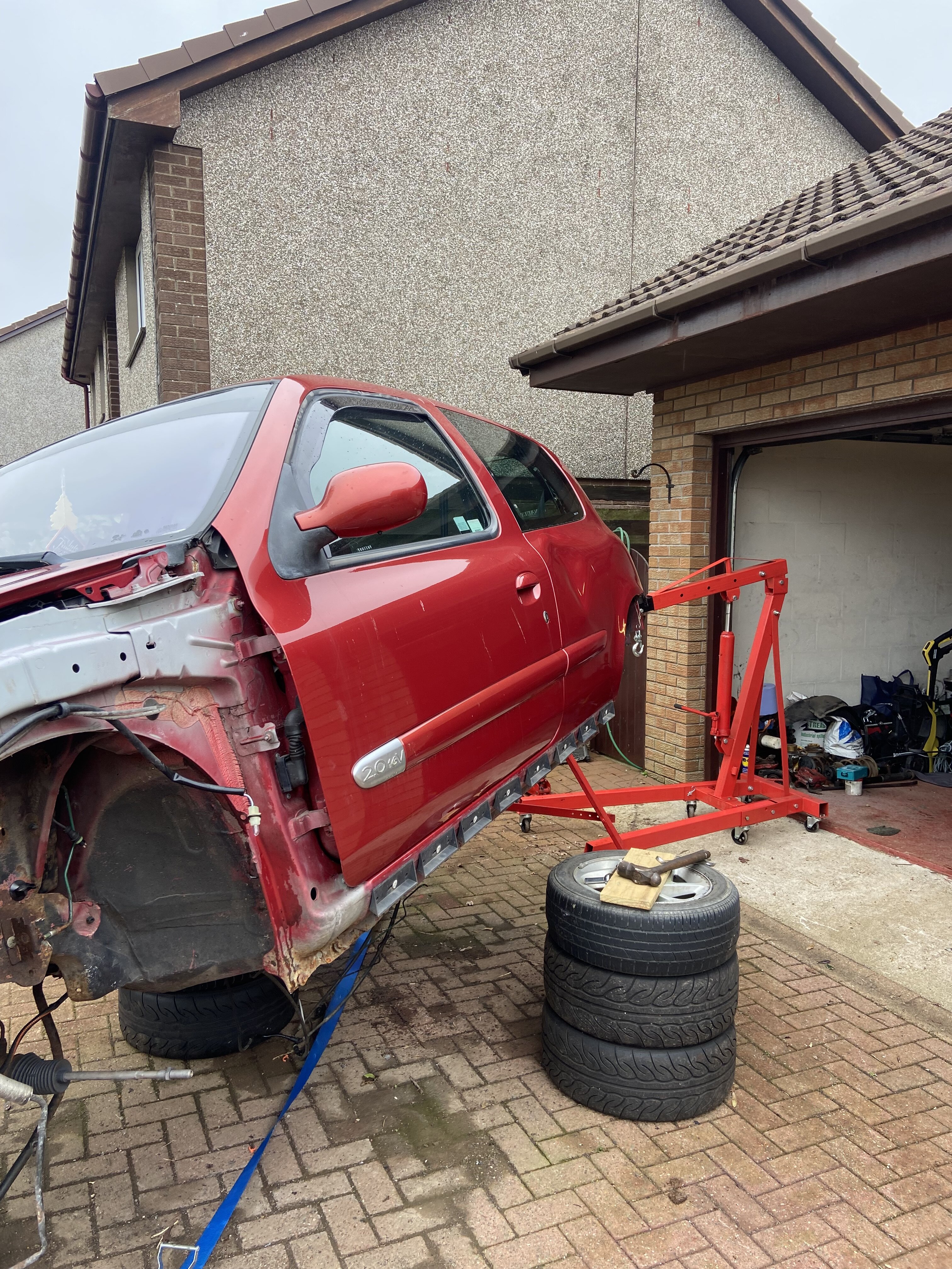

After going this far the decision was made to go all in. I do love the car, I want it to last. So tank out, subframe out followed by the engine and gearbox. Then this happened
So on the jig she went. Am I mad? Yes, will I make the show, in all honesty no not now but there is hope for 2024 😂😂
So in the house there is a room full of new/refurbished parts to build my little clio in to a very tidy usable fast road/track car. Needs to be comfy for ring trips and also a decent spec as I fancy a season trying super lap Scotland at knockhill. Everything was going so well ………

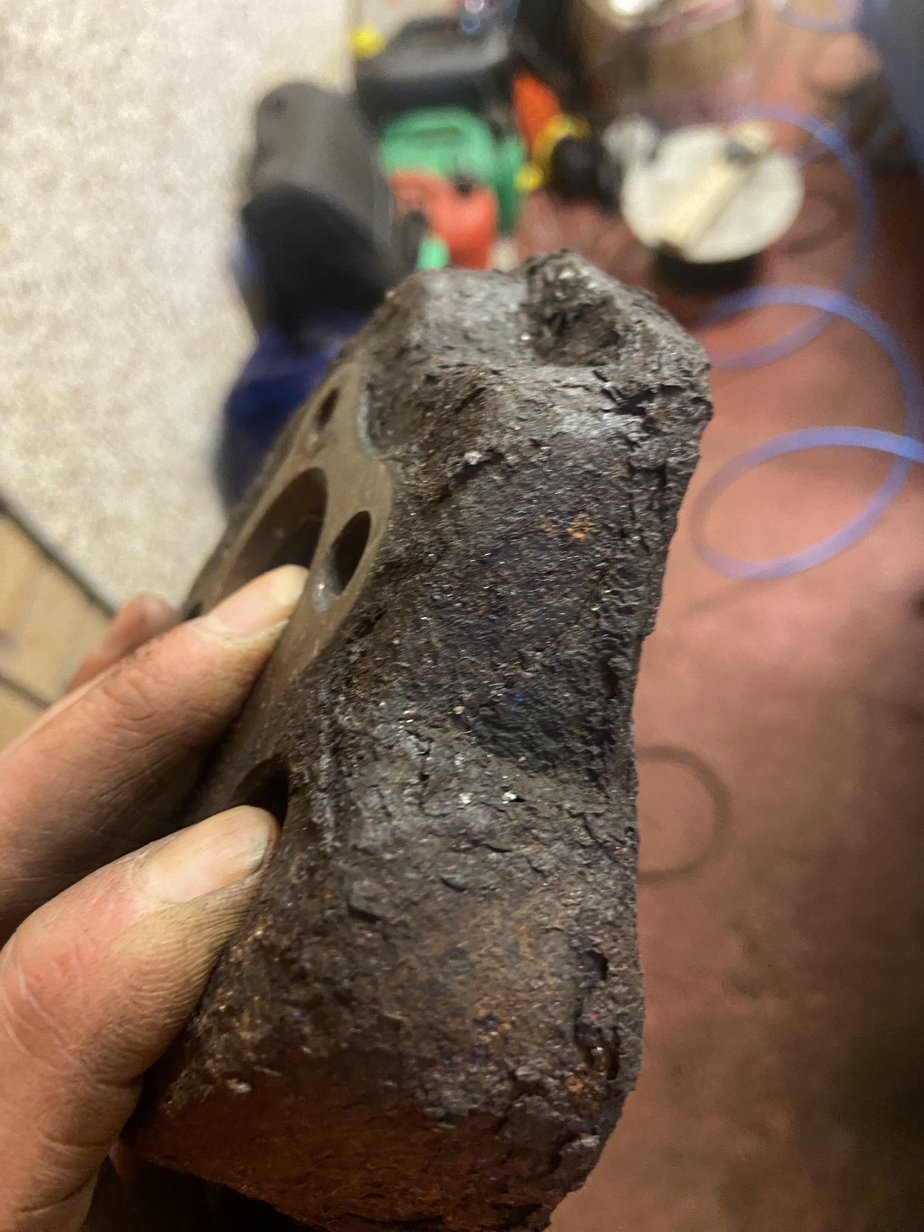

So no longer was it on the jig before it was off. The pin popped out the car spun round and smashed the rear 1/4 off the wheels. Nightmare but probably saved her from smashing into the drive
Raging as the bodywork was clean, but she’ll she track use, these things happen

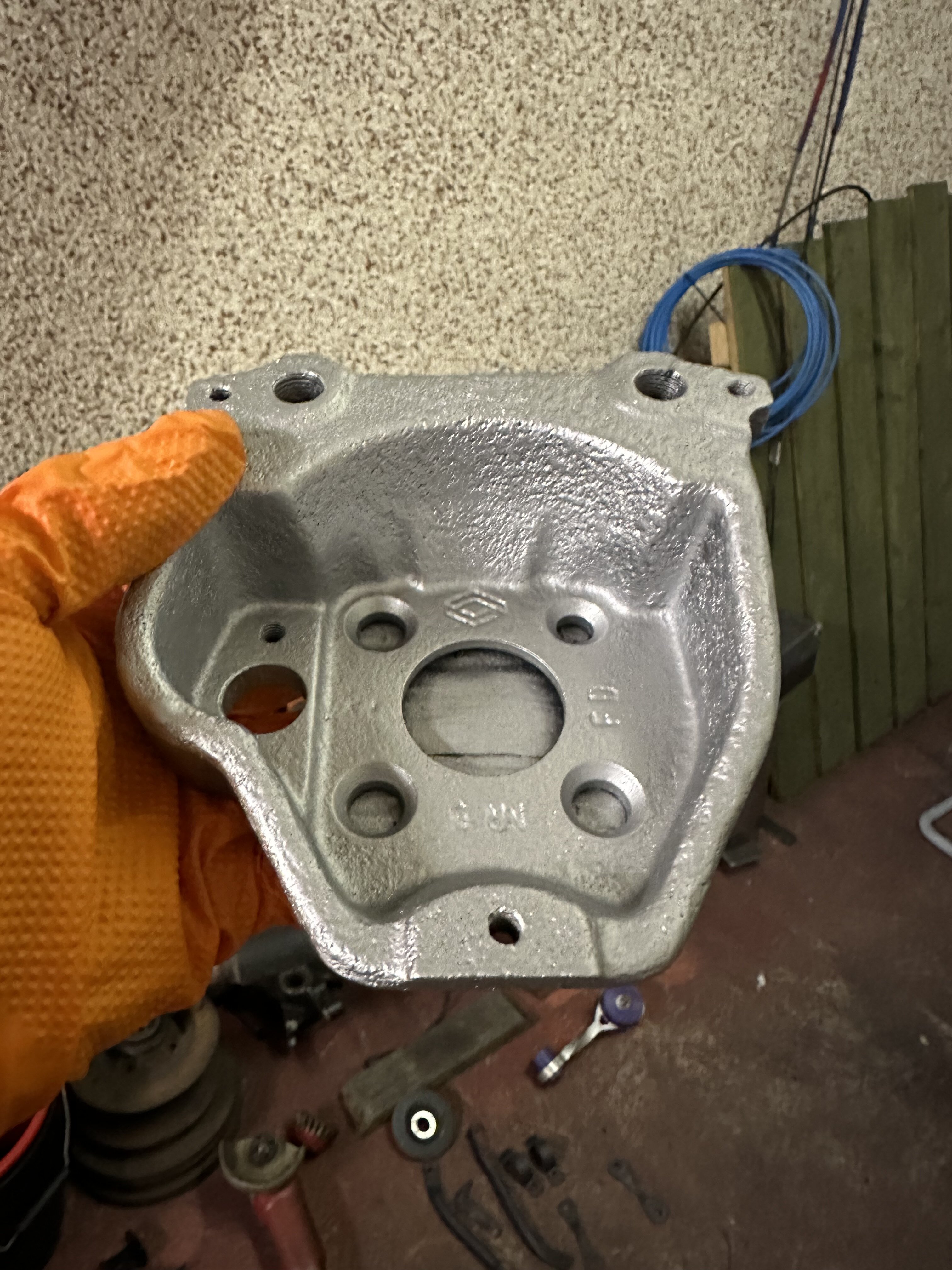

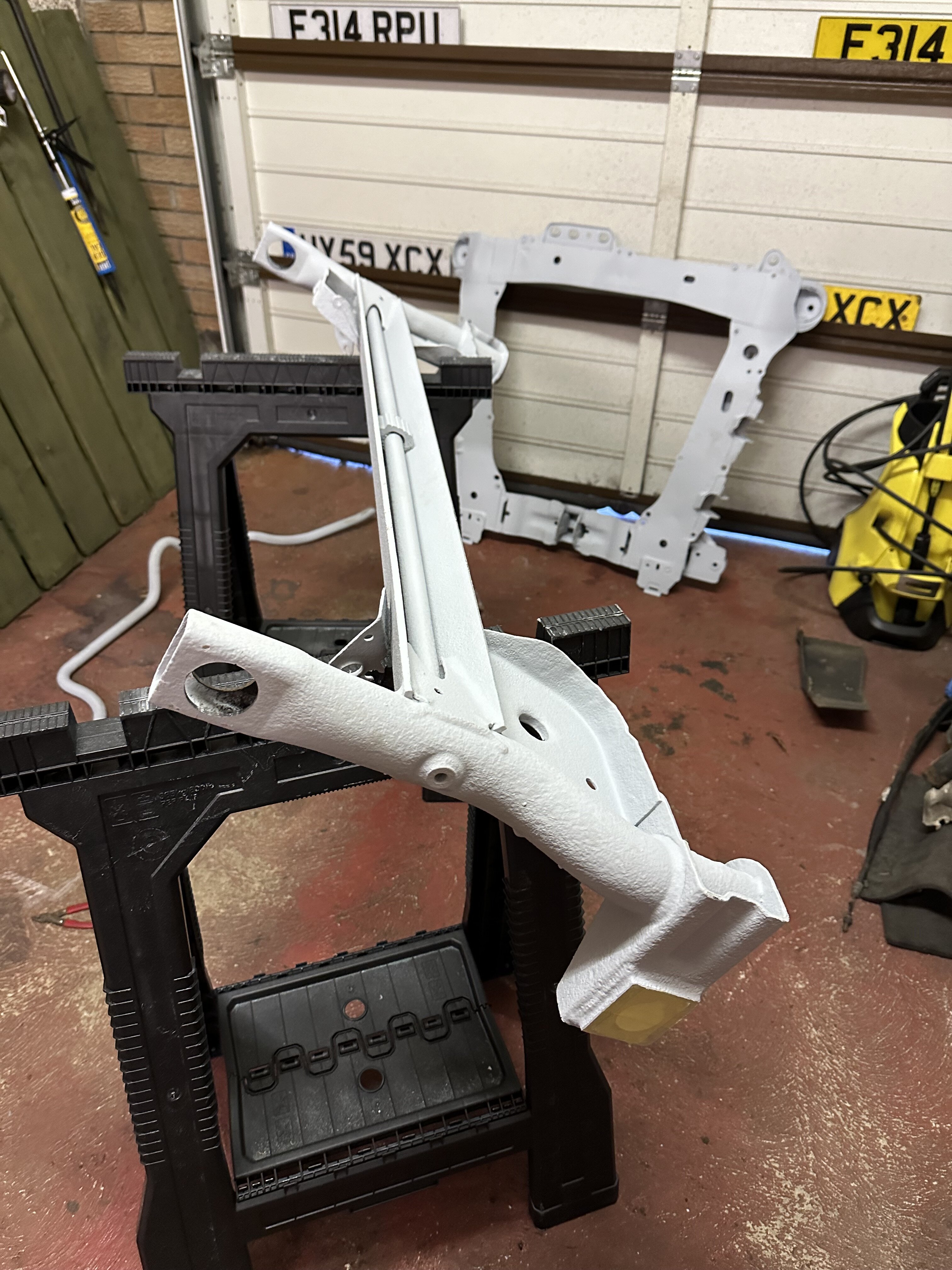

After a busy few months my attention has turned back to the Clio. The rear beam was blasted and primed by someone local.

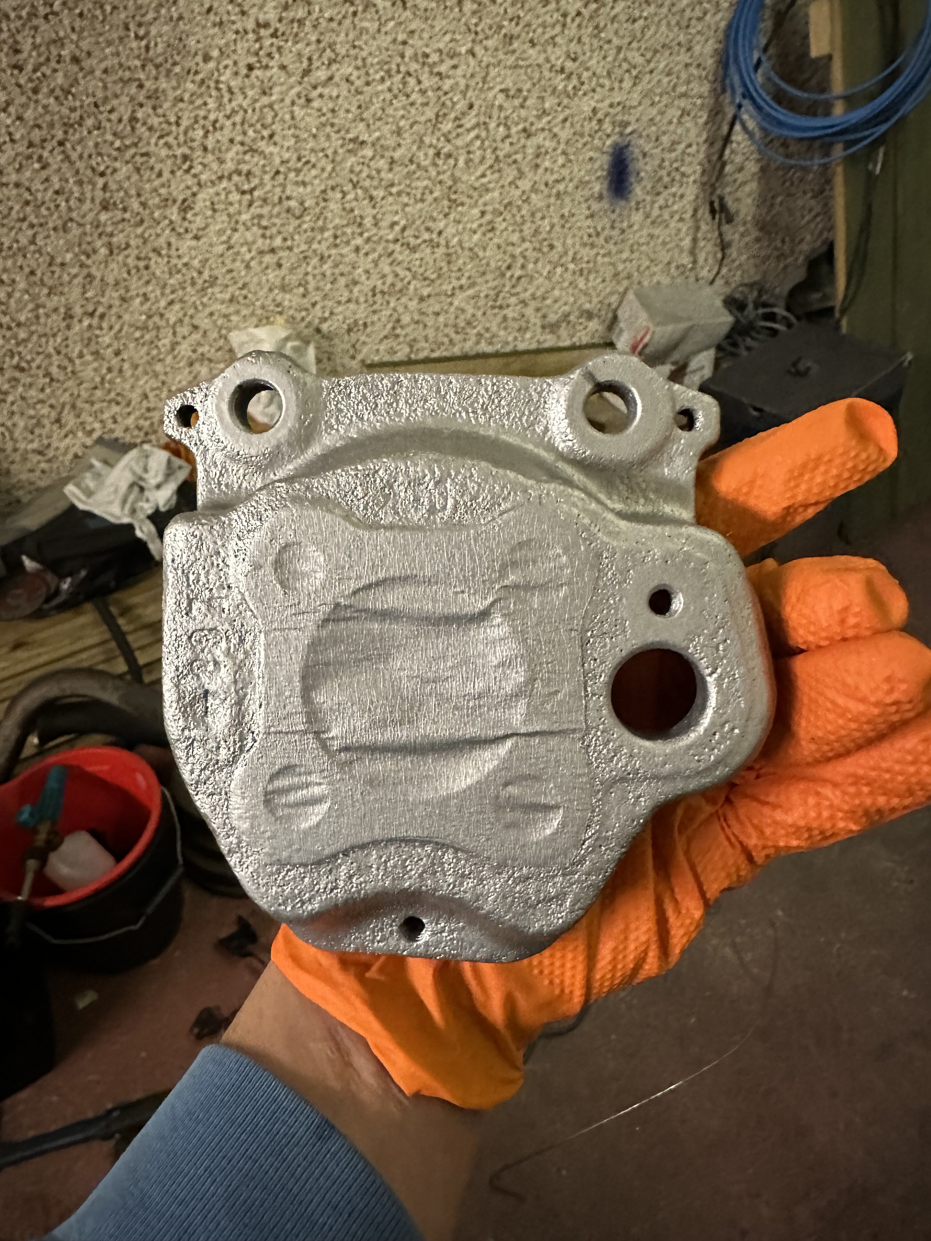

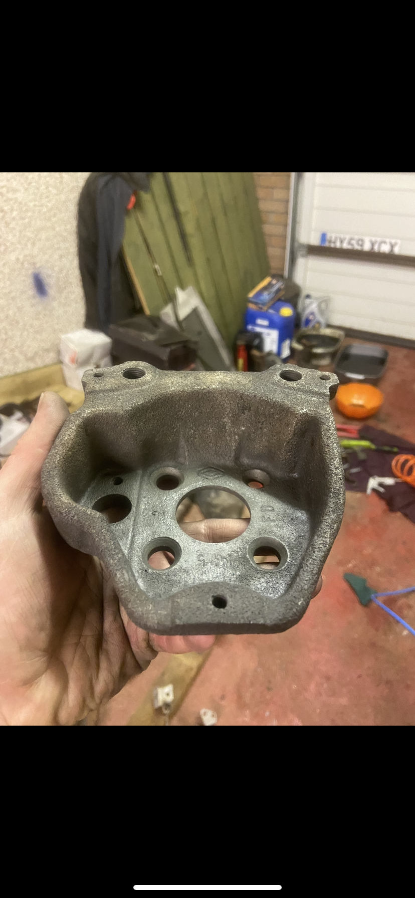

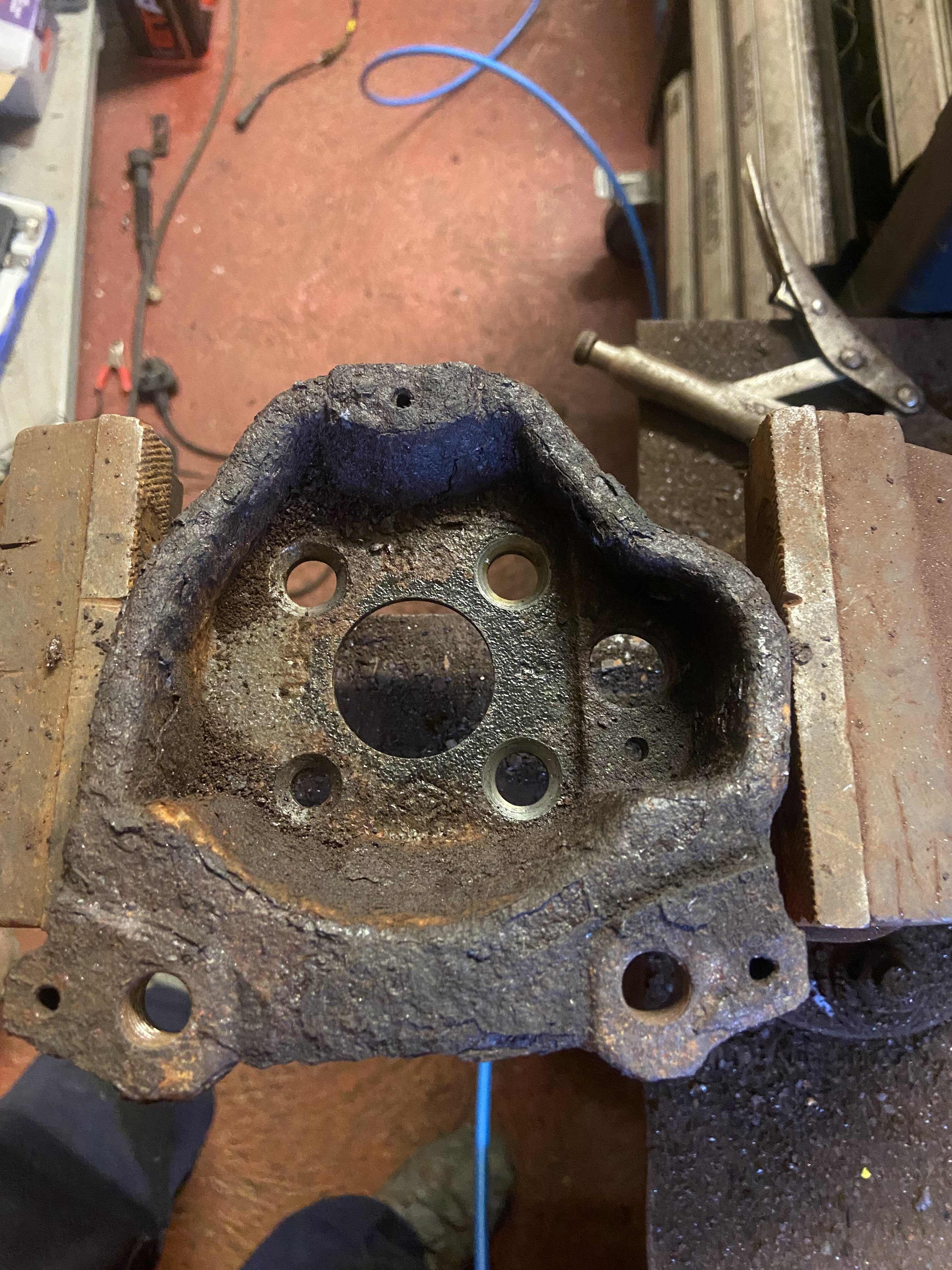

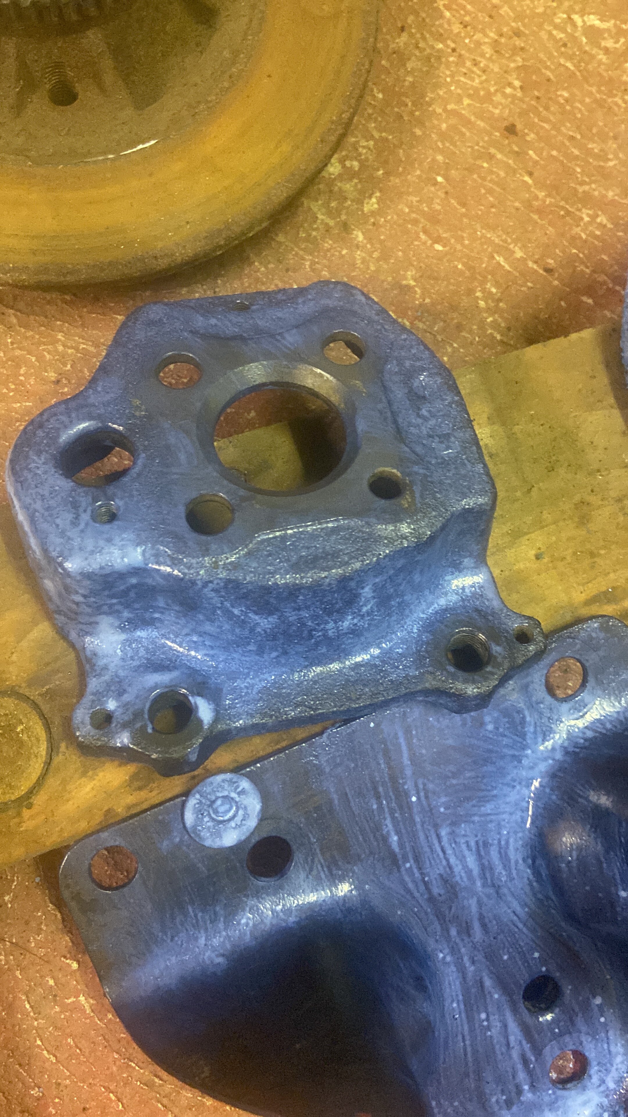

Found some time between nightshifts to finish off the rear caliper/abs mounts. Had to cut these off the axle as the nuts had rotted away. Out came the abs sensors with the help of a drill and hammer. Which left me with this
Got to work with the air compressor and needle scaler to get the worst of it off. I’m so lucky next door are sound!
With the surface rust off they went in a bath of bilt hamber deox-c along with the other bits and bobs. Honestly a fantastic product, highly recommended. You can see how well it’s came up.
Here’s the other parts after being the same treatment

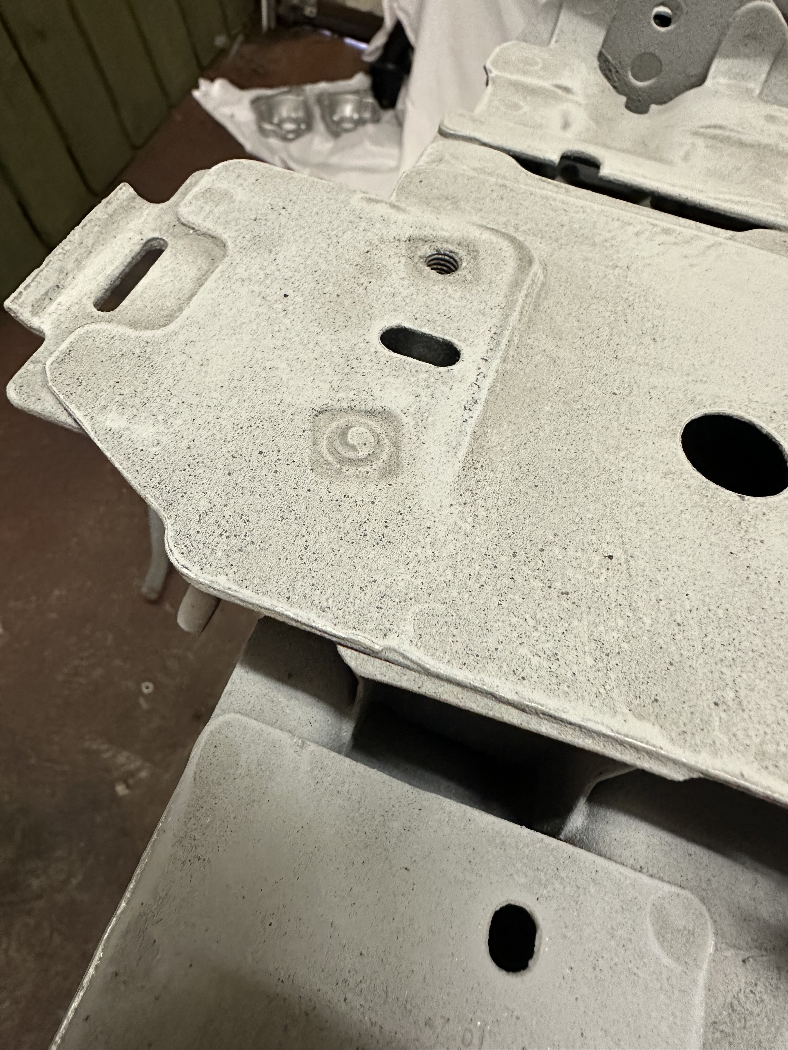

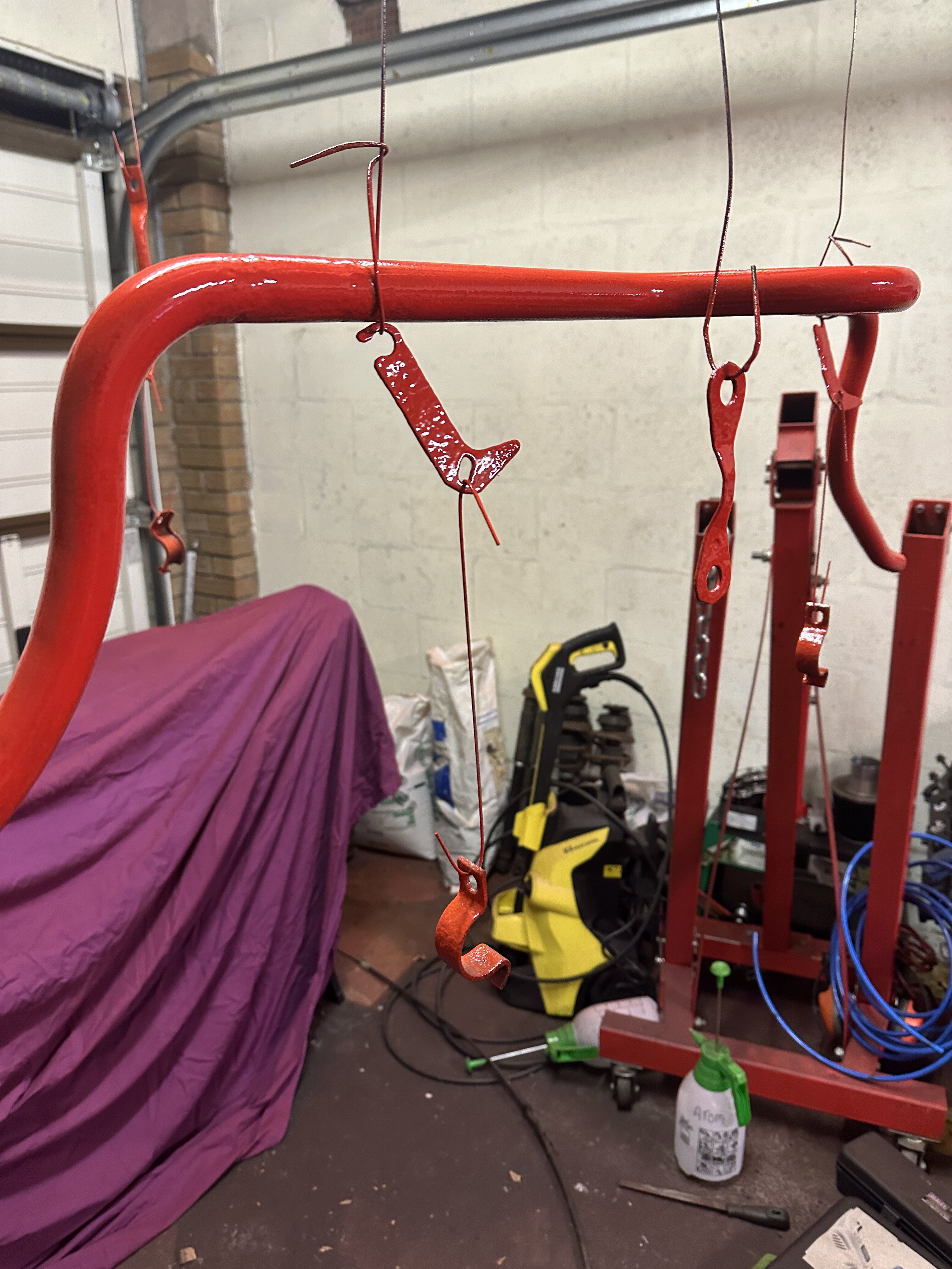

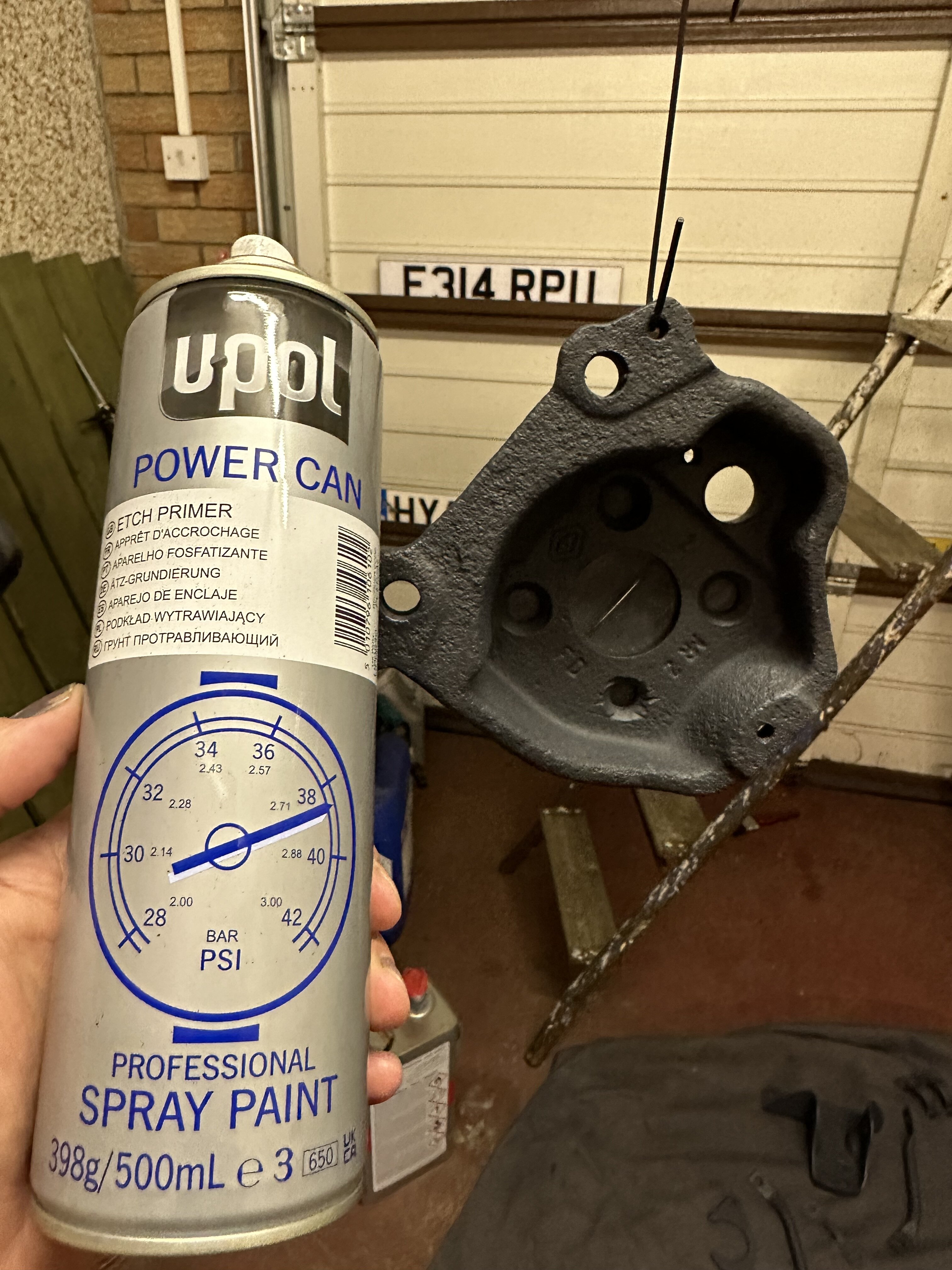

Up next everything was gave two coats of hydrate-80.
Left to dry then 3 coats of primer.

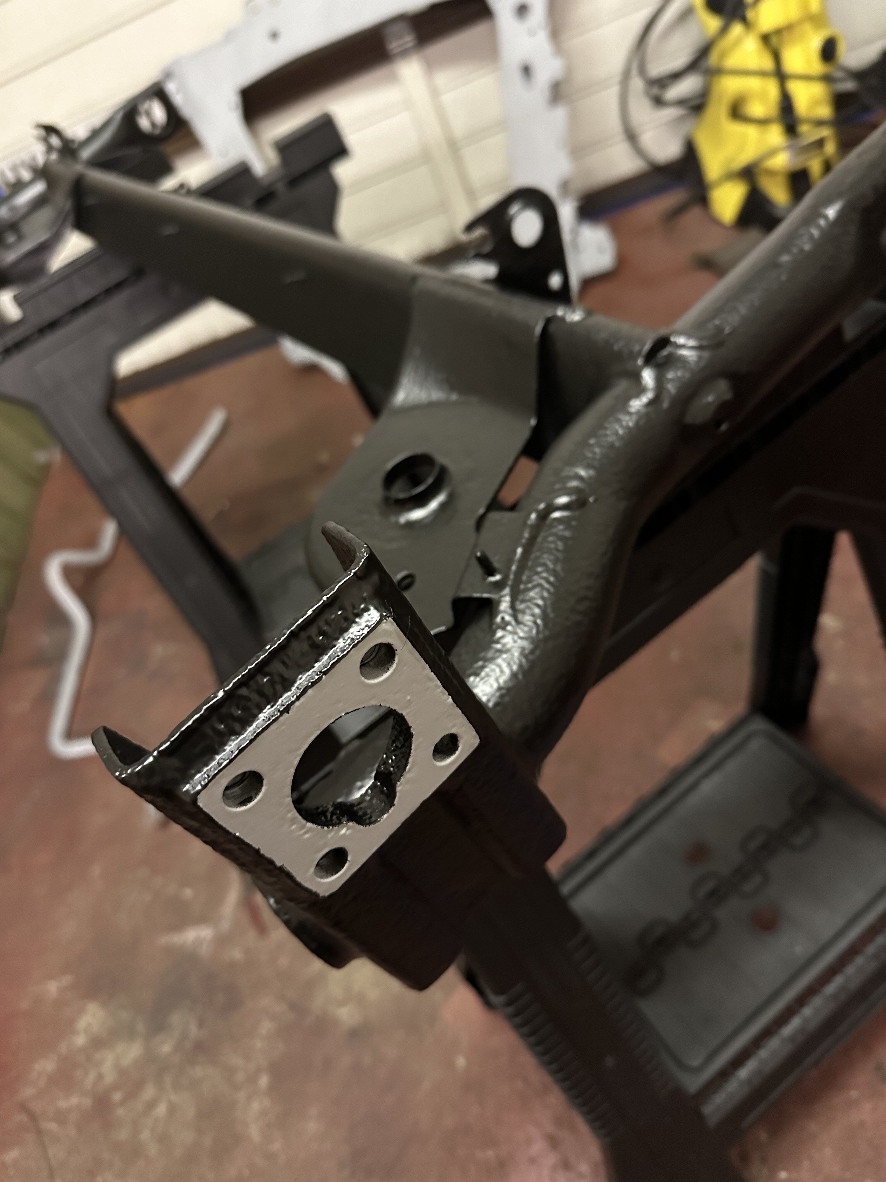

Finally paint. Happy with the results, not after a mint show car just a usable clean fast/road track toy.

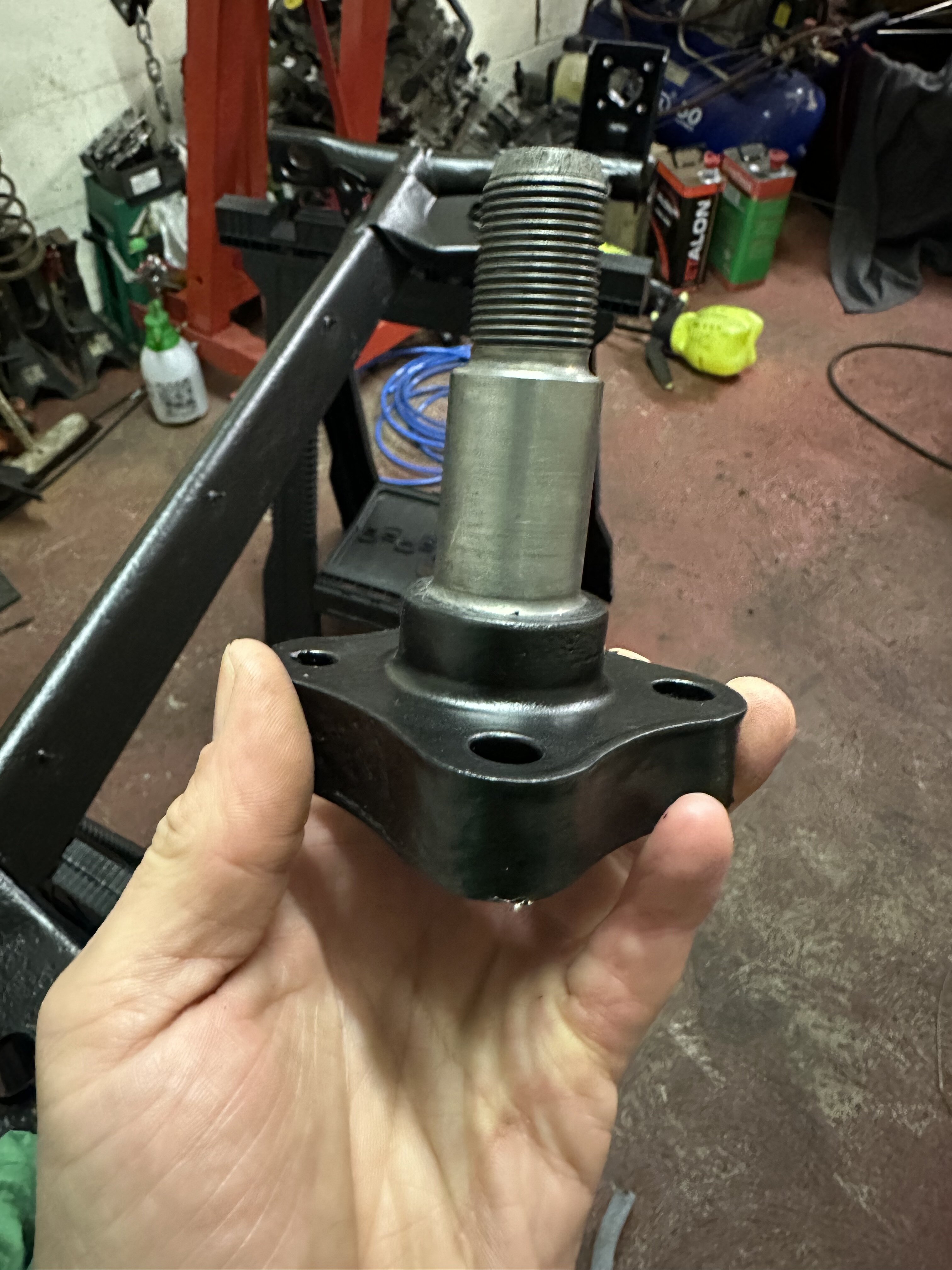

Got the stub axels and rear beam brackets painted. Rear beams now ready to build back up now.

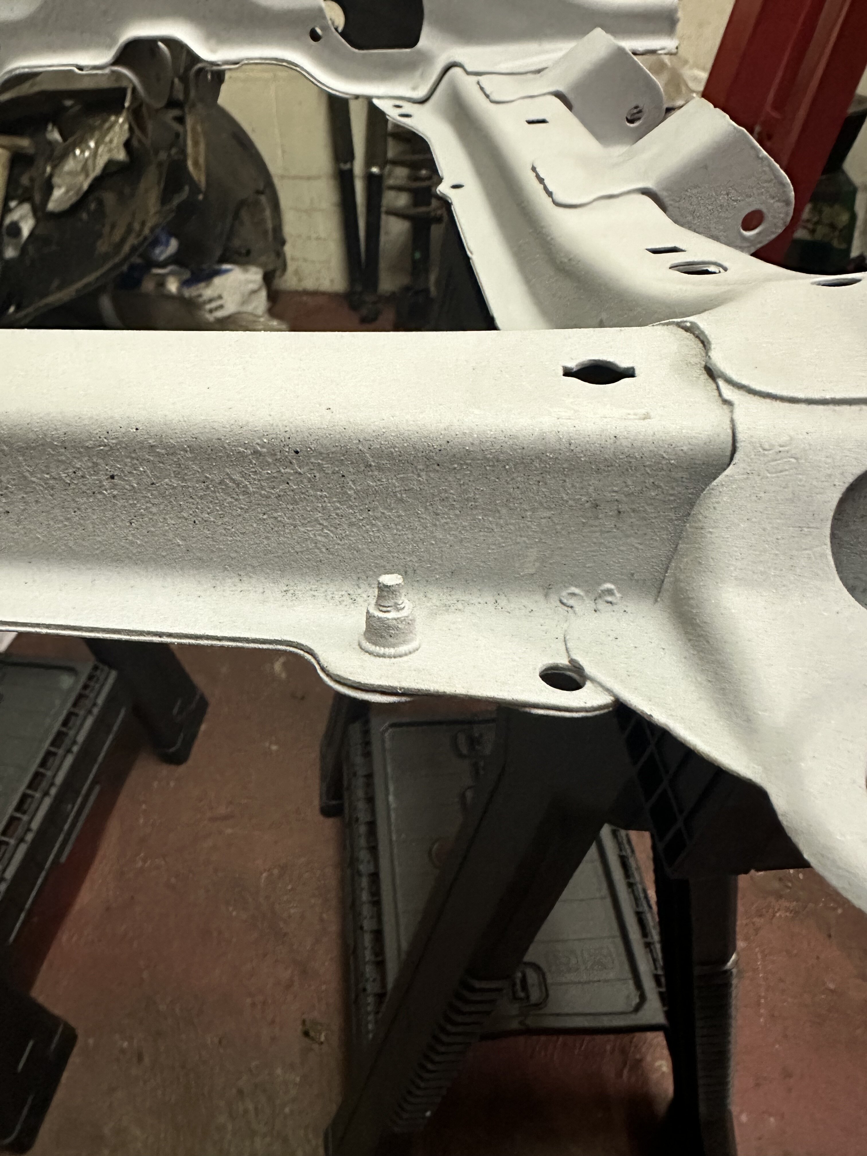

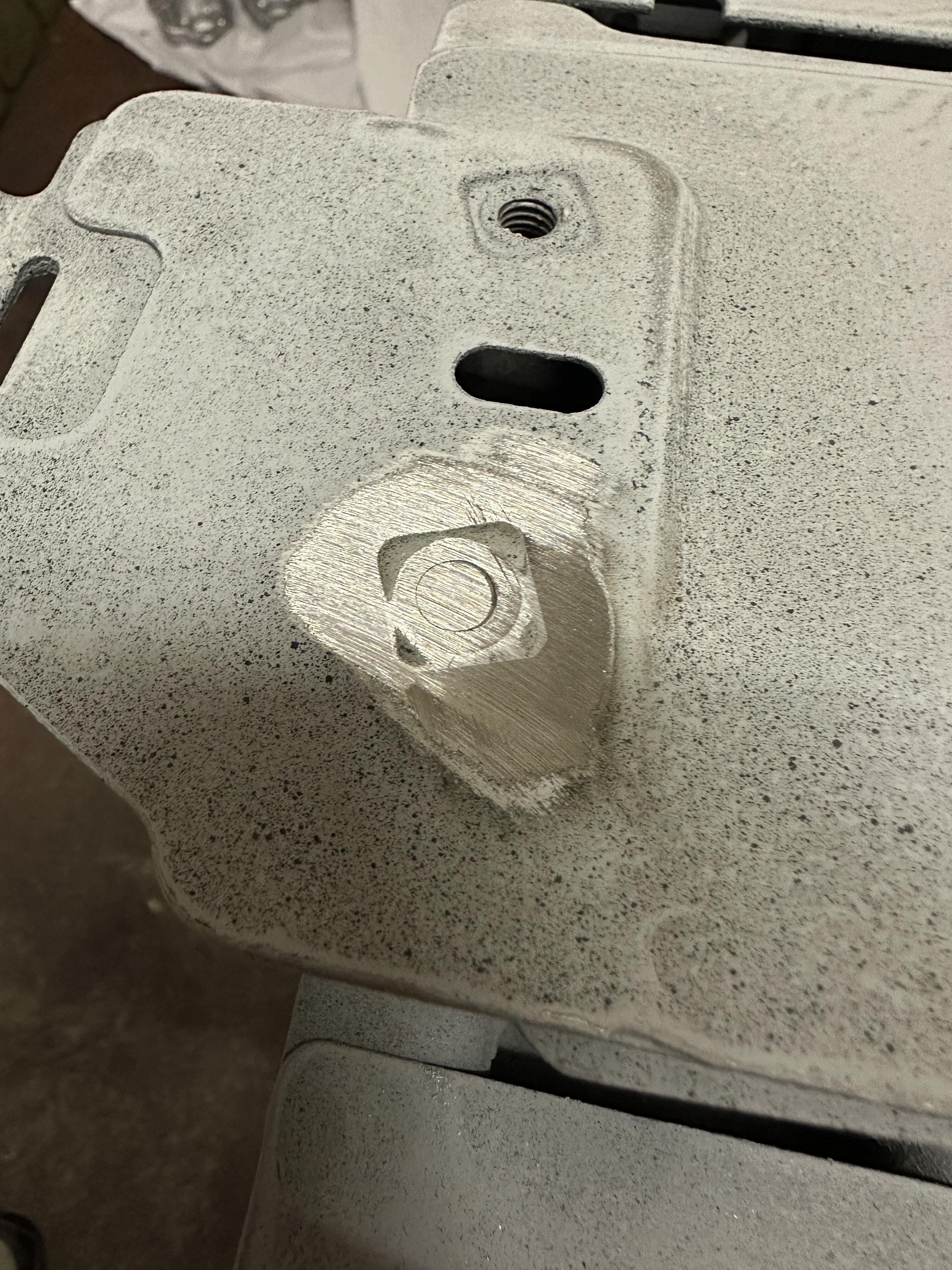

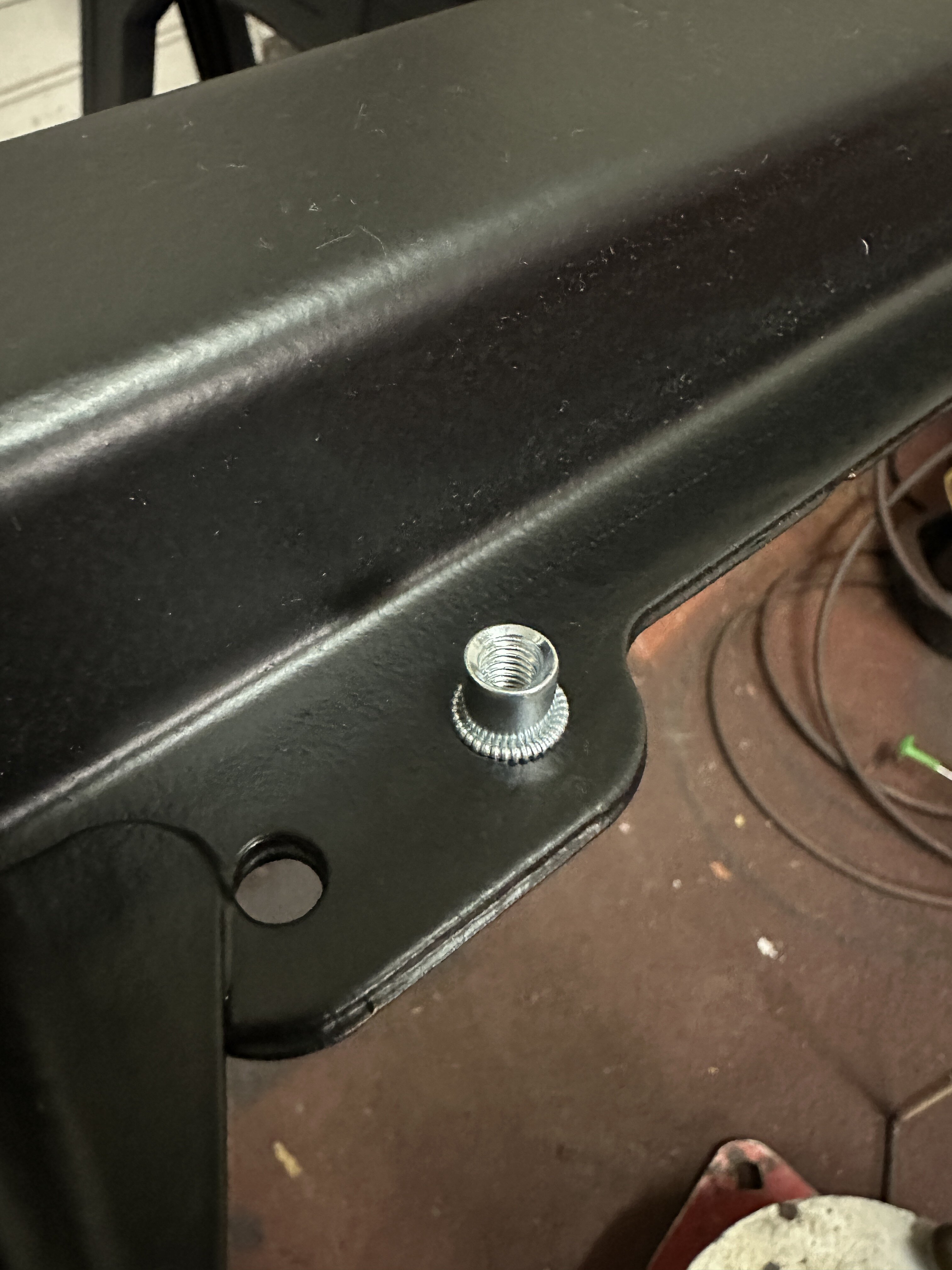

Then set about the front subframe. Started off by removing all old m6 rivnuts. The bolts were snapped in most while stripping it down. Cut then off, buffed them flush, then knocked them out with a punch.
Next up had to do the same with one of the anti roll bar threads as it also snapped on strip down. I’m glad I’m going this far, seized bolts on a track car is never going to work. Needs to be easy to work on and it’s a 20 year old Renault so fresh everything is the only way. MADNESS
Gave it a sand with 120 to smooth the primmer a bit and key it up, panel wipe and then paint. Need to flip it to paint the other side but it’s drying in the heat as we speak. Better finish with extra prep from the rear beam. Still too heavy with the paint in places!

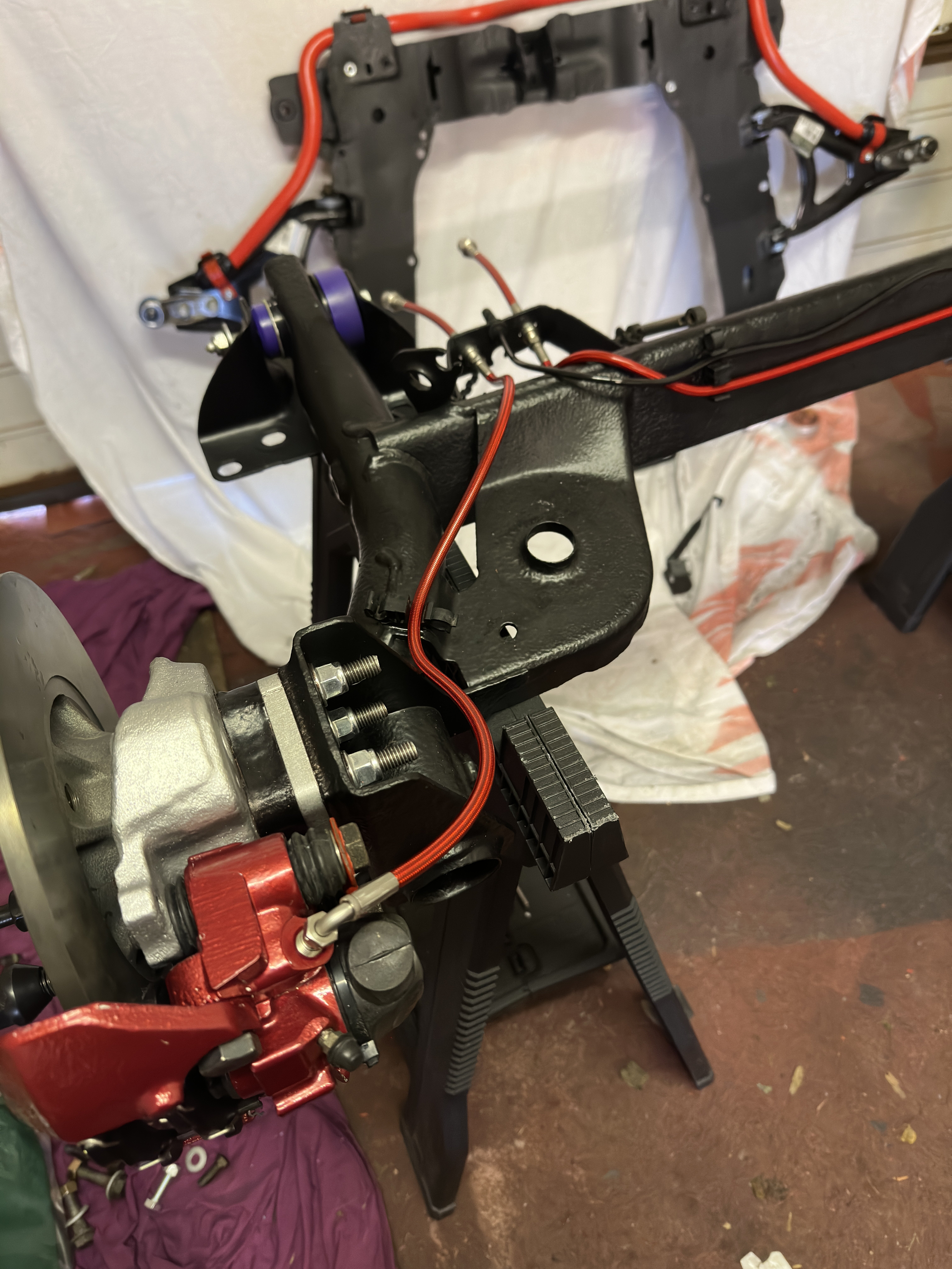

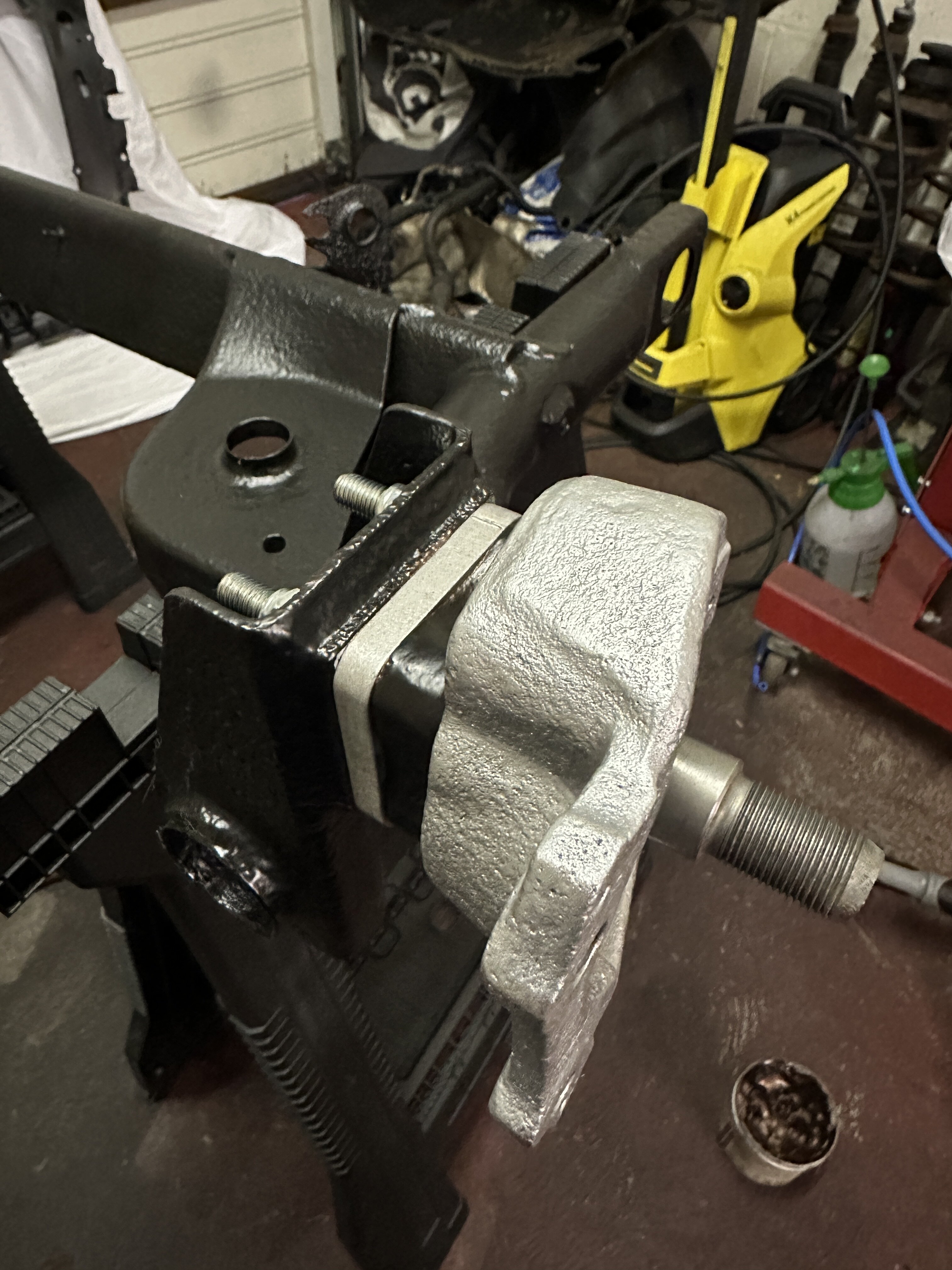

Started a new job in the new year, settled in so back to the Clio. Started to build up the rear beam on Sunday . Fitted the pms spacers and tightened everything up as per the pms fitting guide.

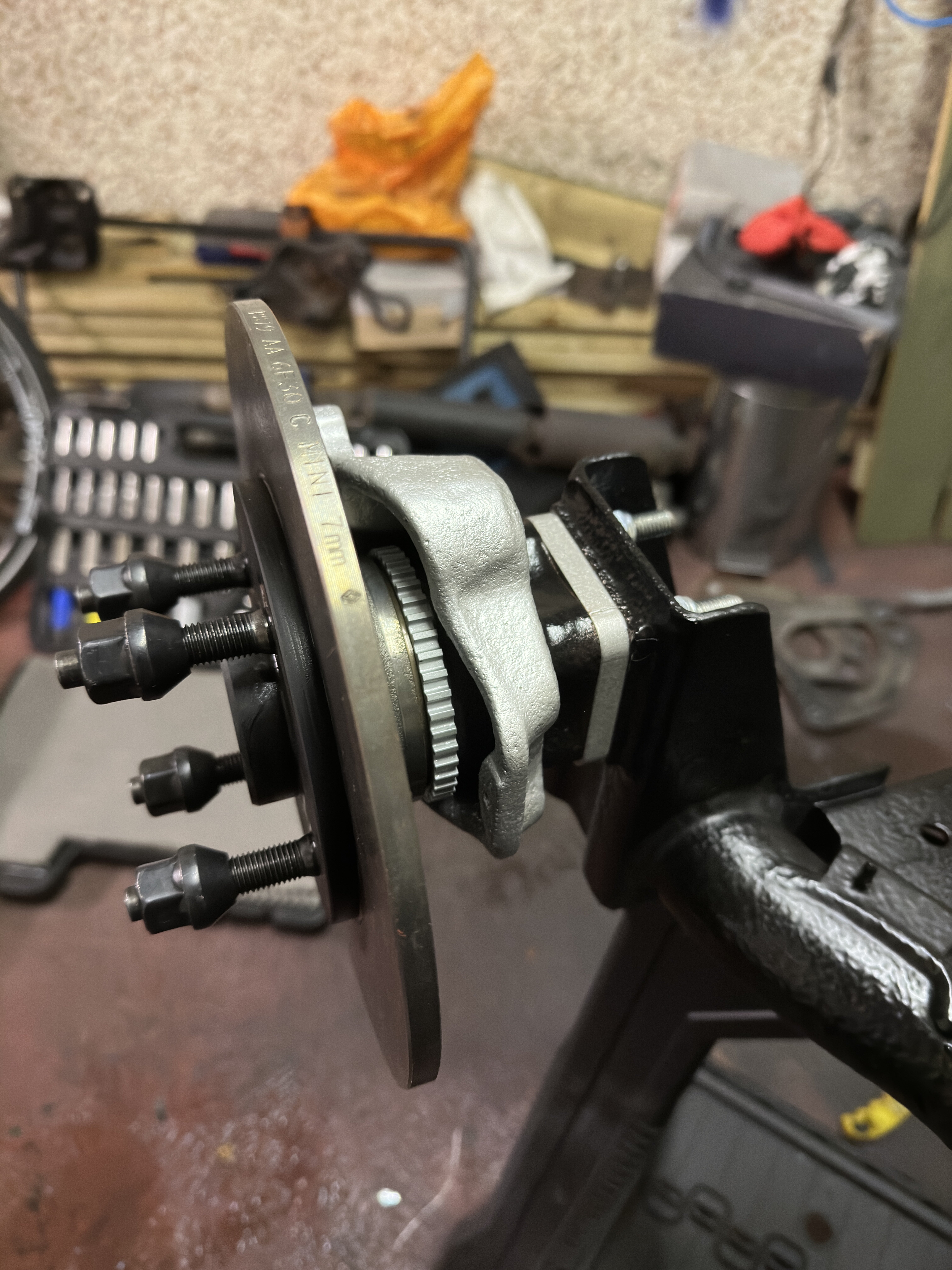

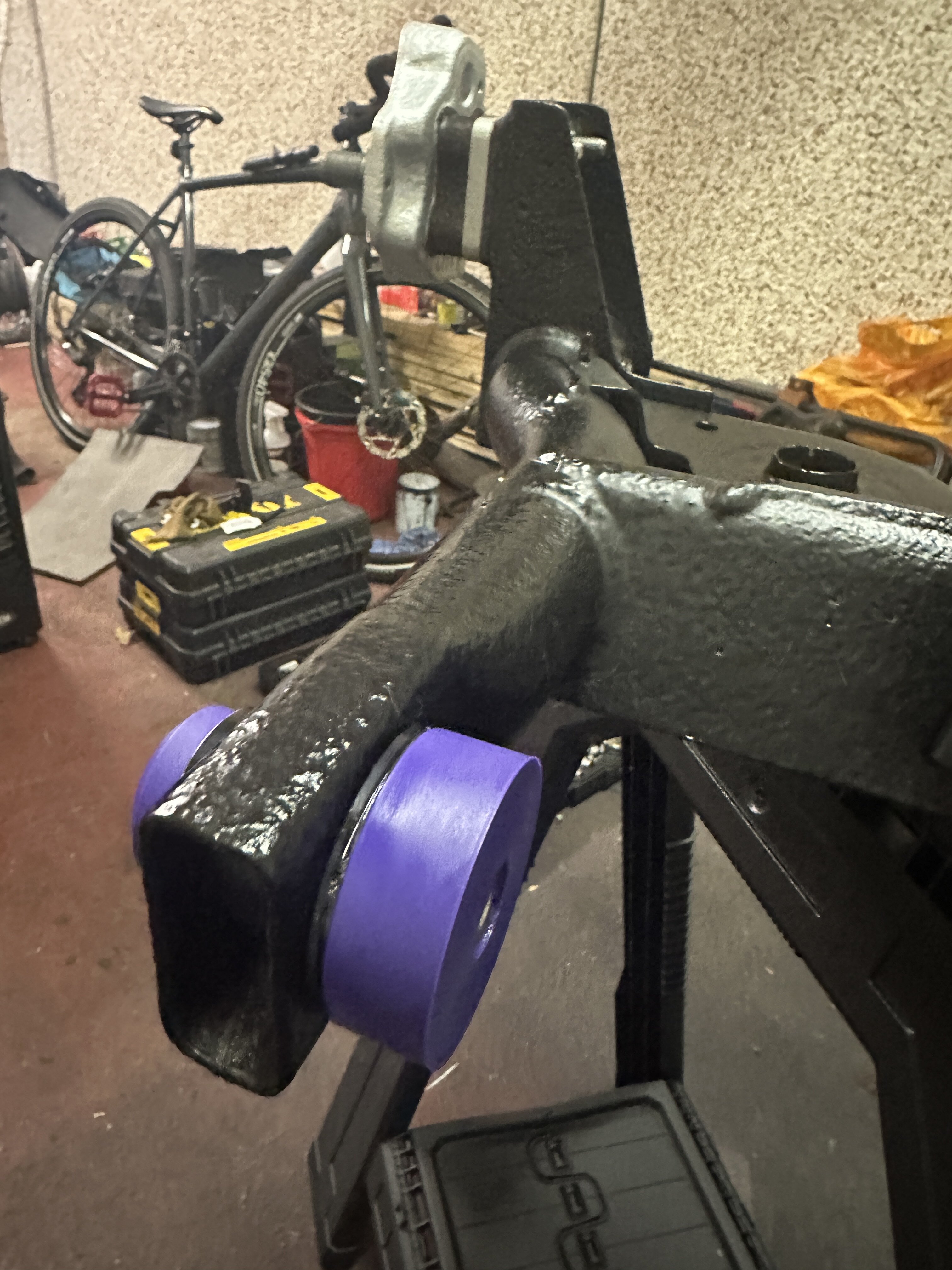

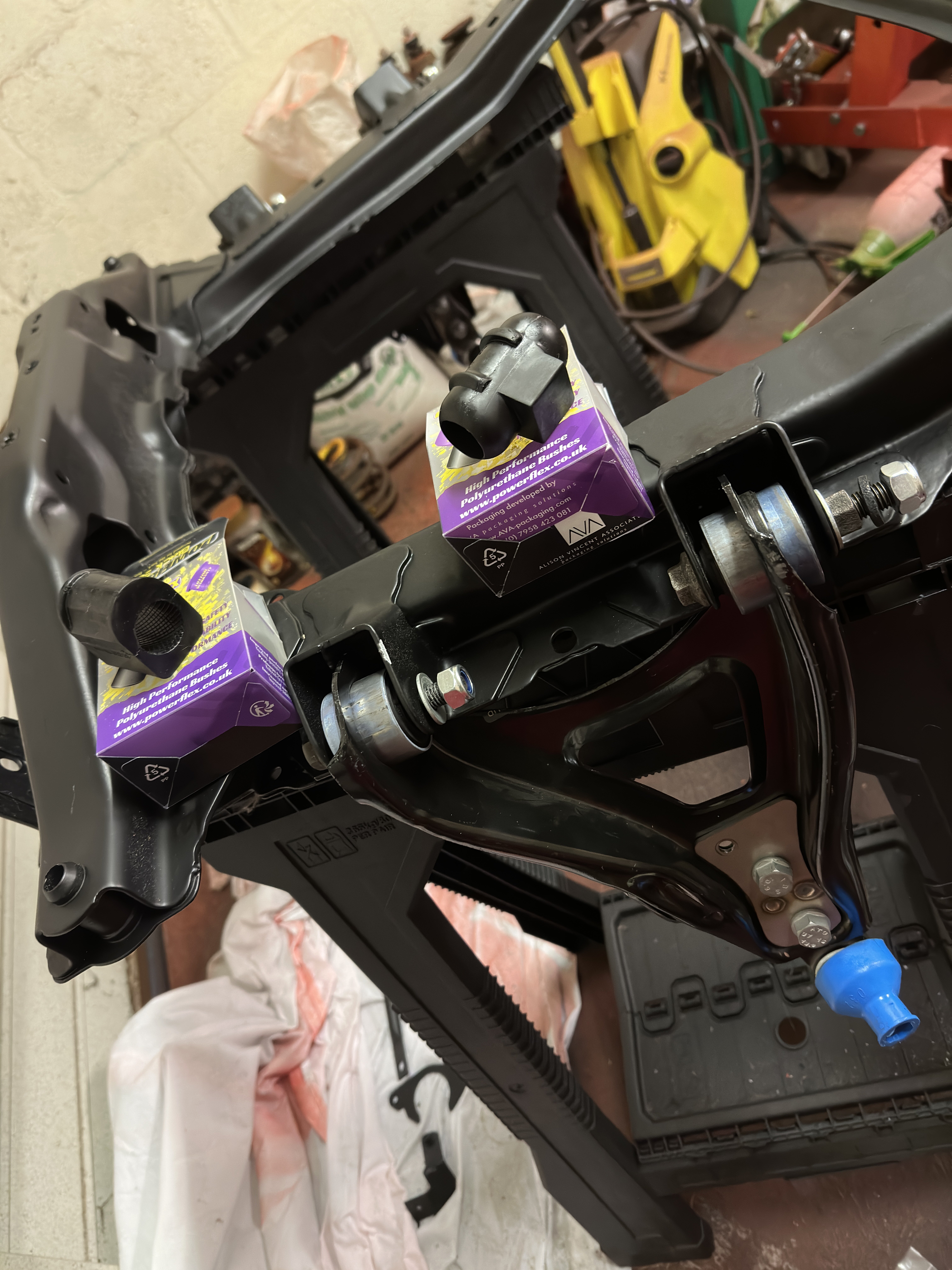

Up next in went the powerflex bushes, they were a tight squeeze but found a couple of sockets and pulled the insert in with a 10mm threaded bar before popping the purple bushes in. Wasn’t sure to go for black or purple but still want to enjoy the Clio on the road so went for the purple.

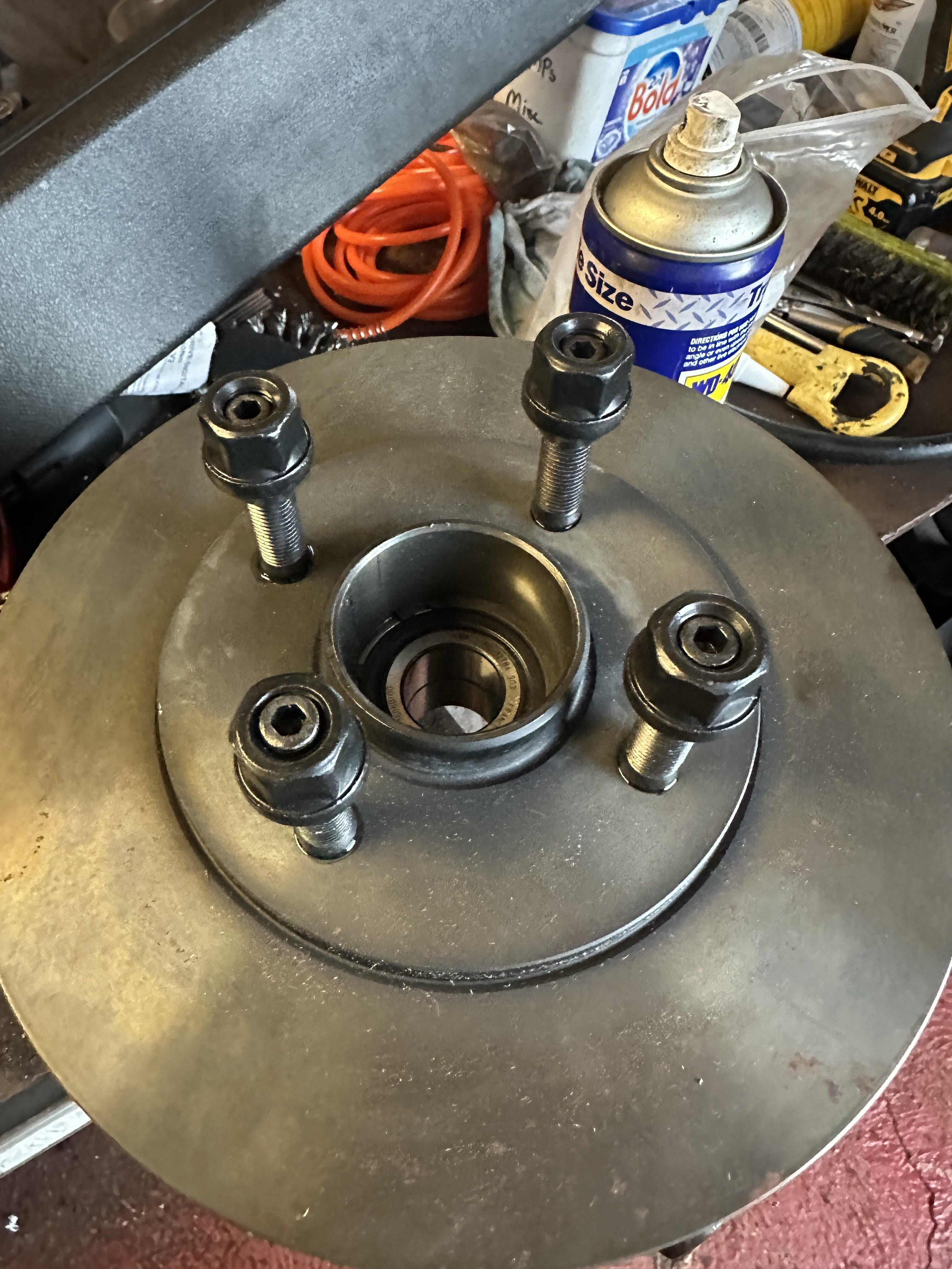

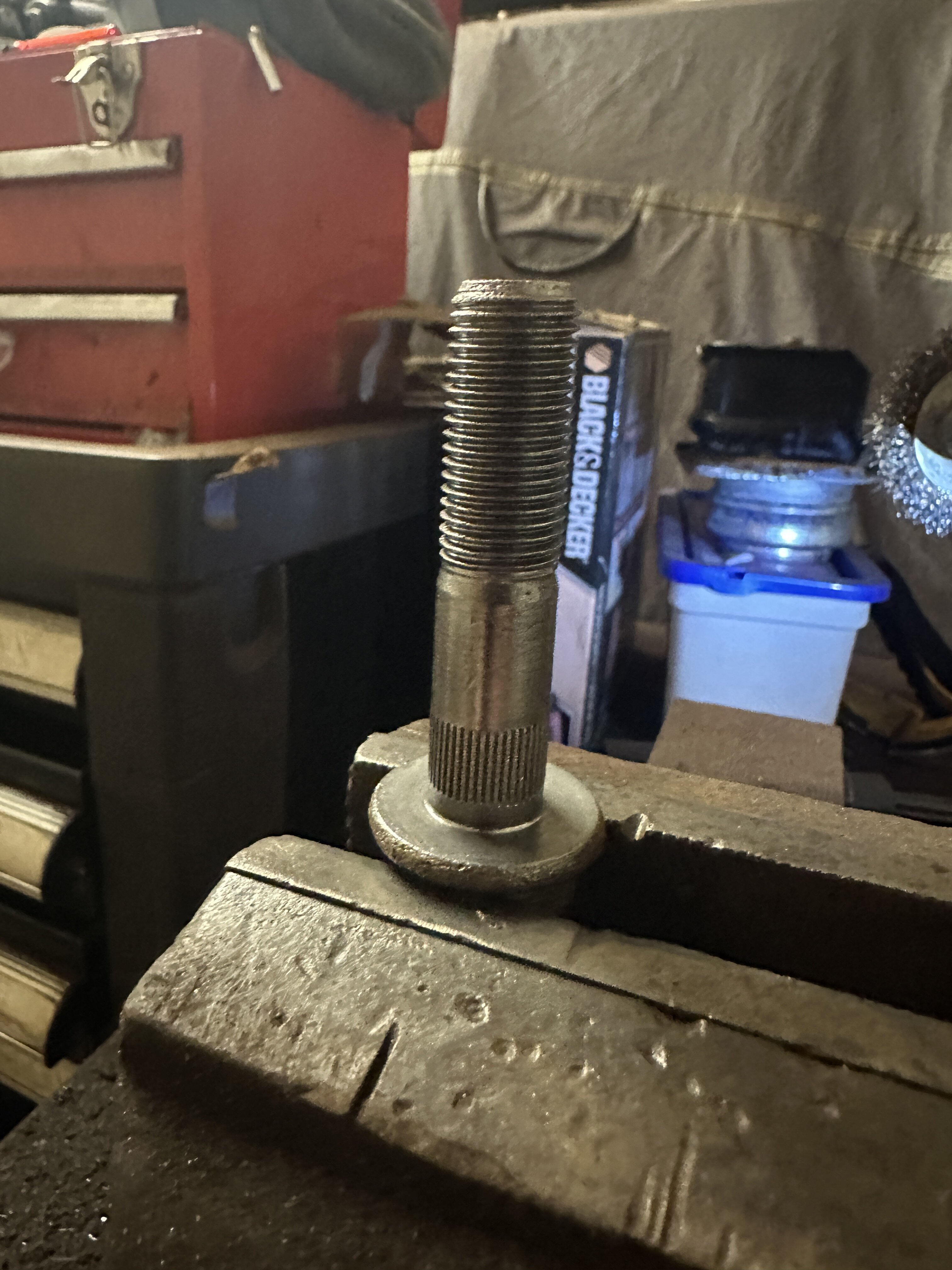

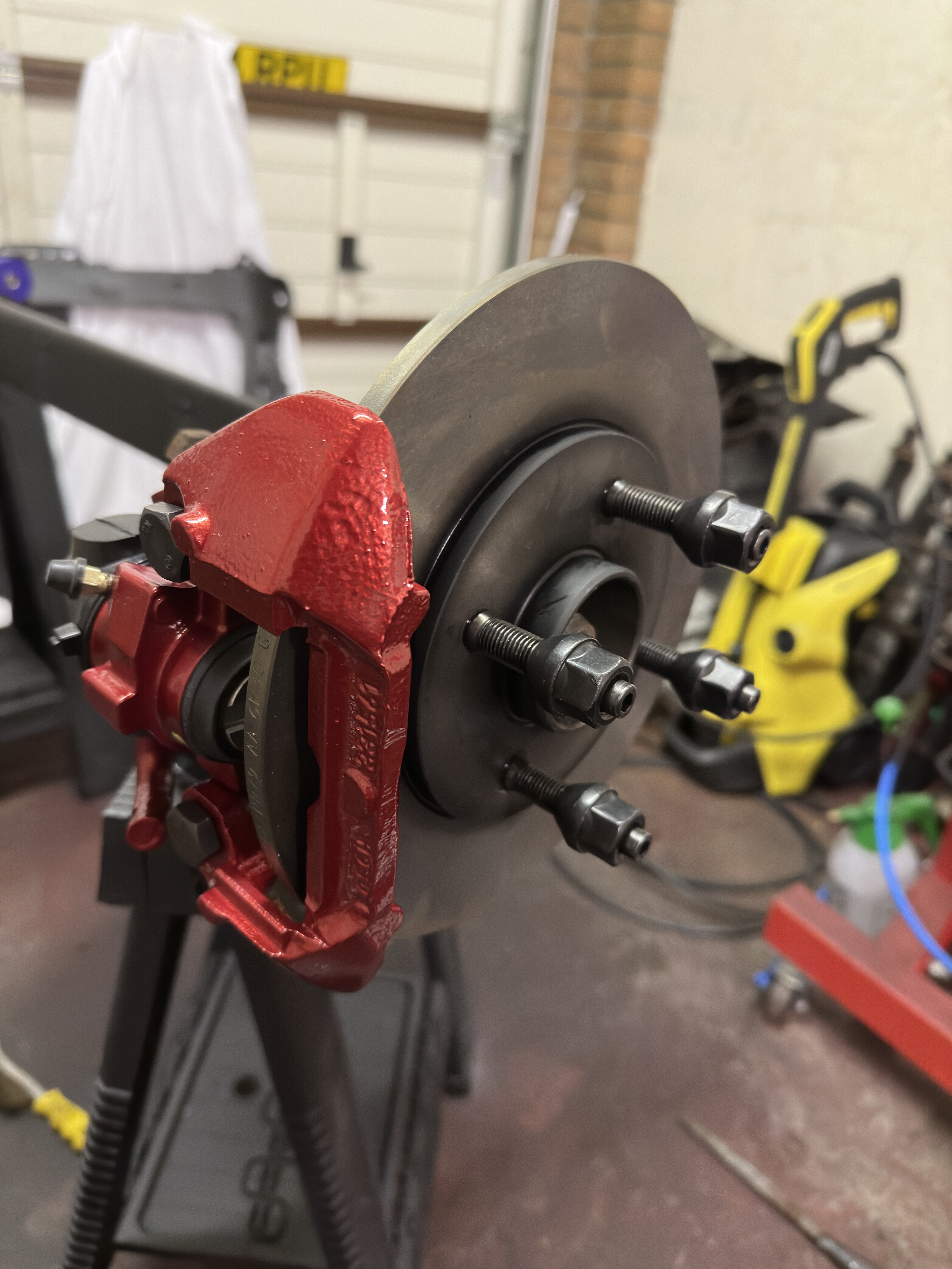

Next I fitted some 63mm pms studs to the new Renault discs but waiting on new nuts before tightening them up.
Coming along nicely. Glad I spent the time painting the beam rather than just bolting new parts to 20 year old rusty beam.

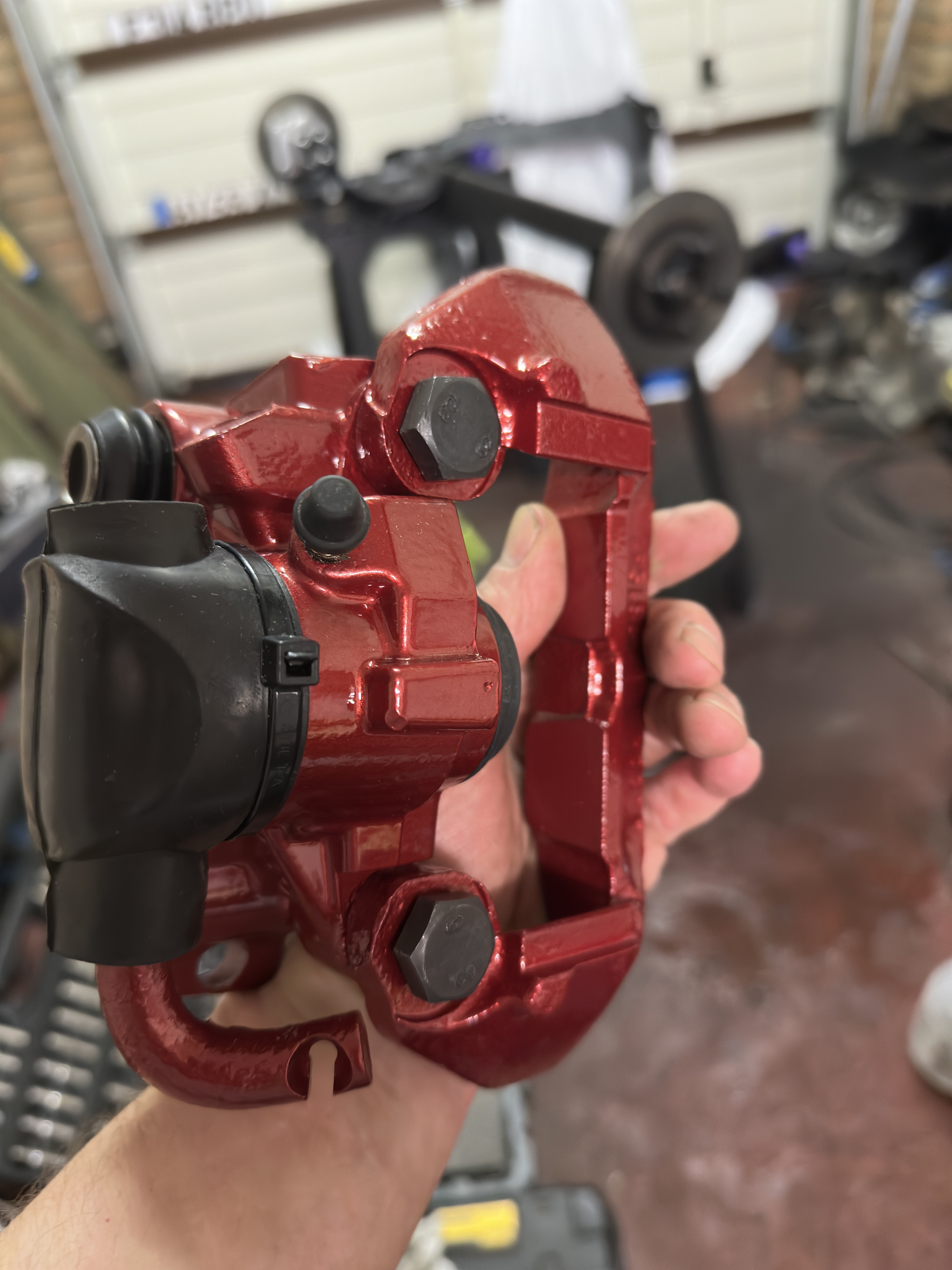

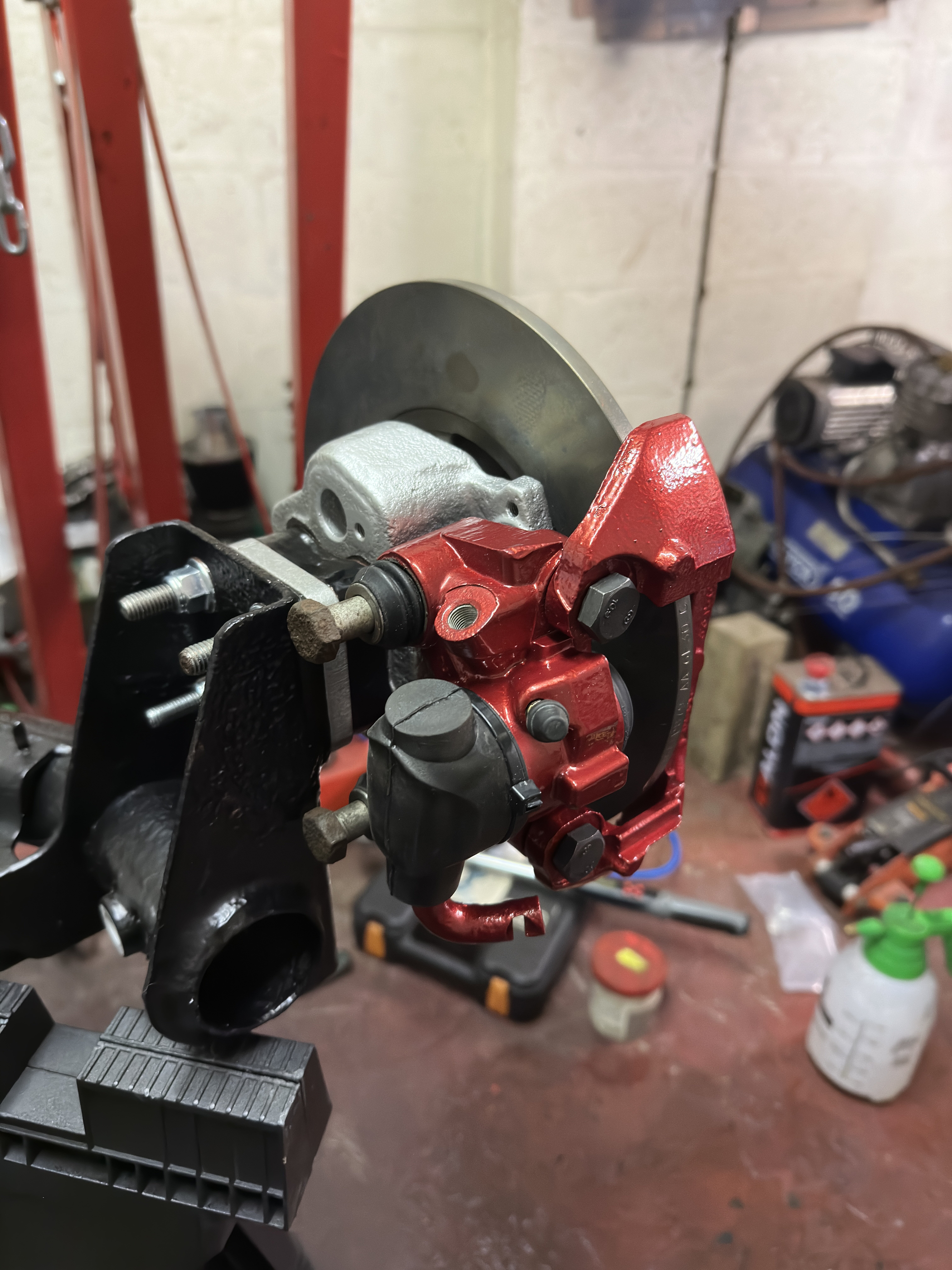

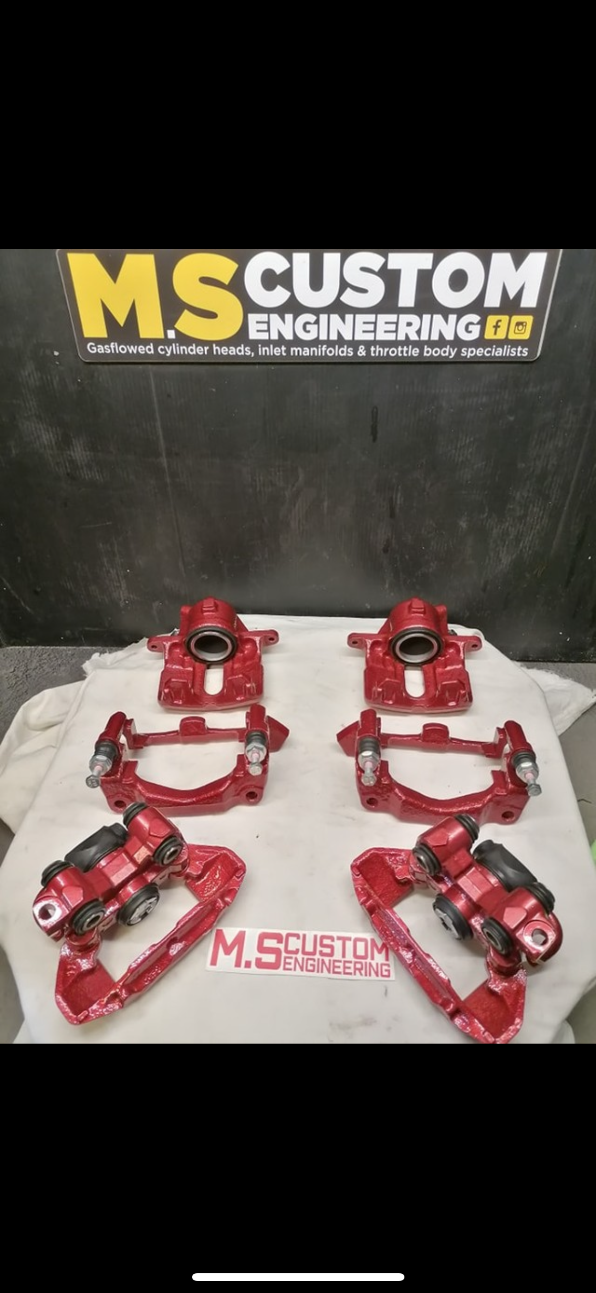

Couldn’t resist bolting the rear calipers up, bolts need cleaned up and waiting on the pad fitting kit. But look at the job m.s custom eng have done! Can’t recommend highly enough!
Finished in flame red. I have pbs pads to pop in, new brake lines to go on and need to source abs sensors so finish the job of properly.

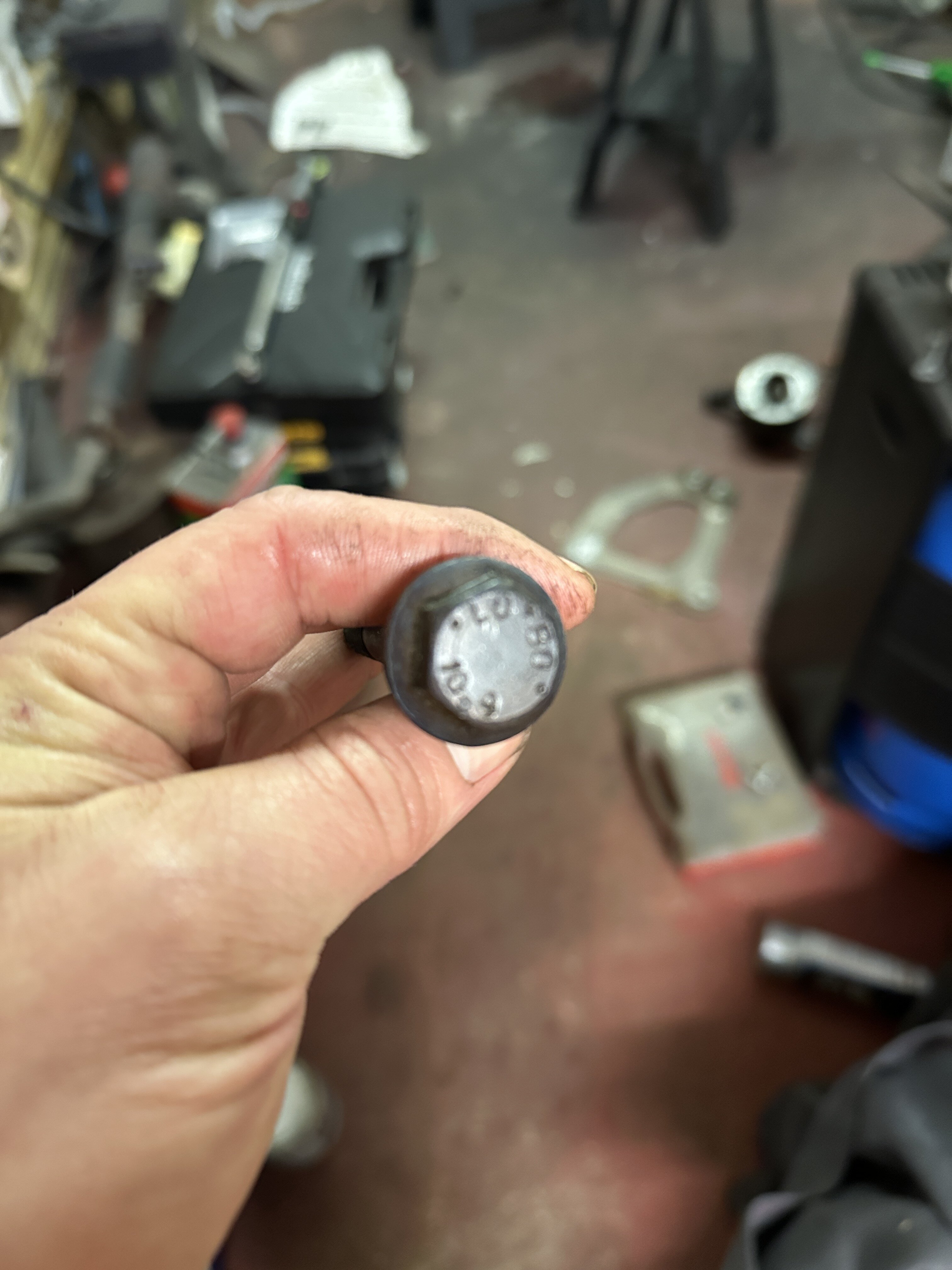

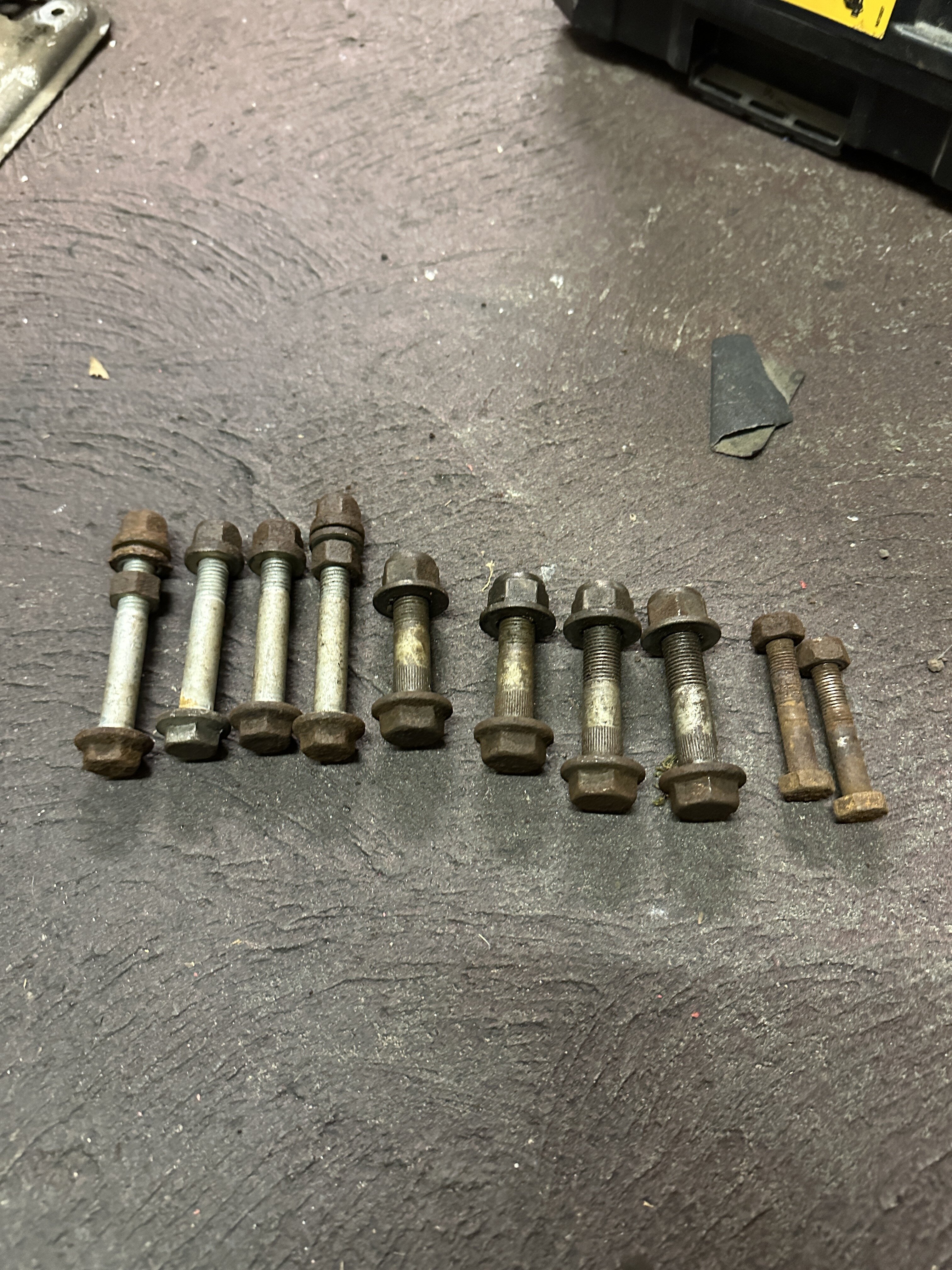

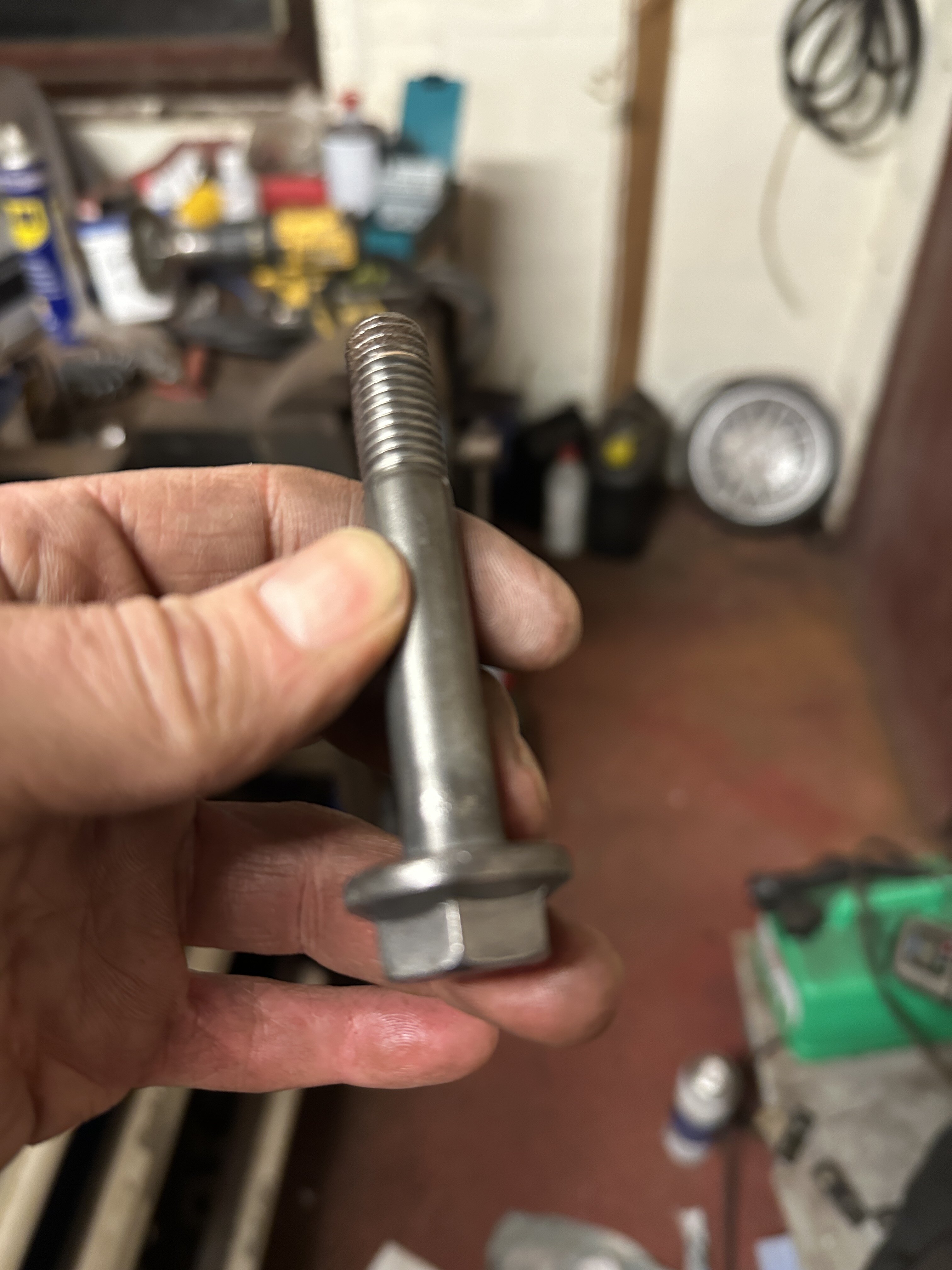

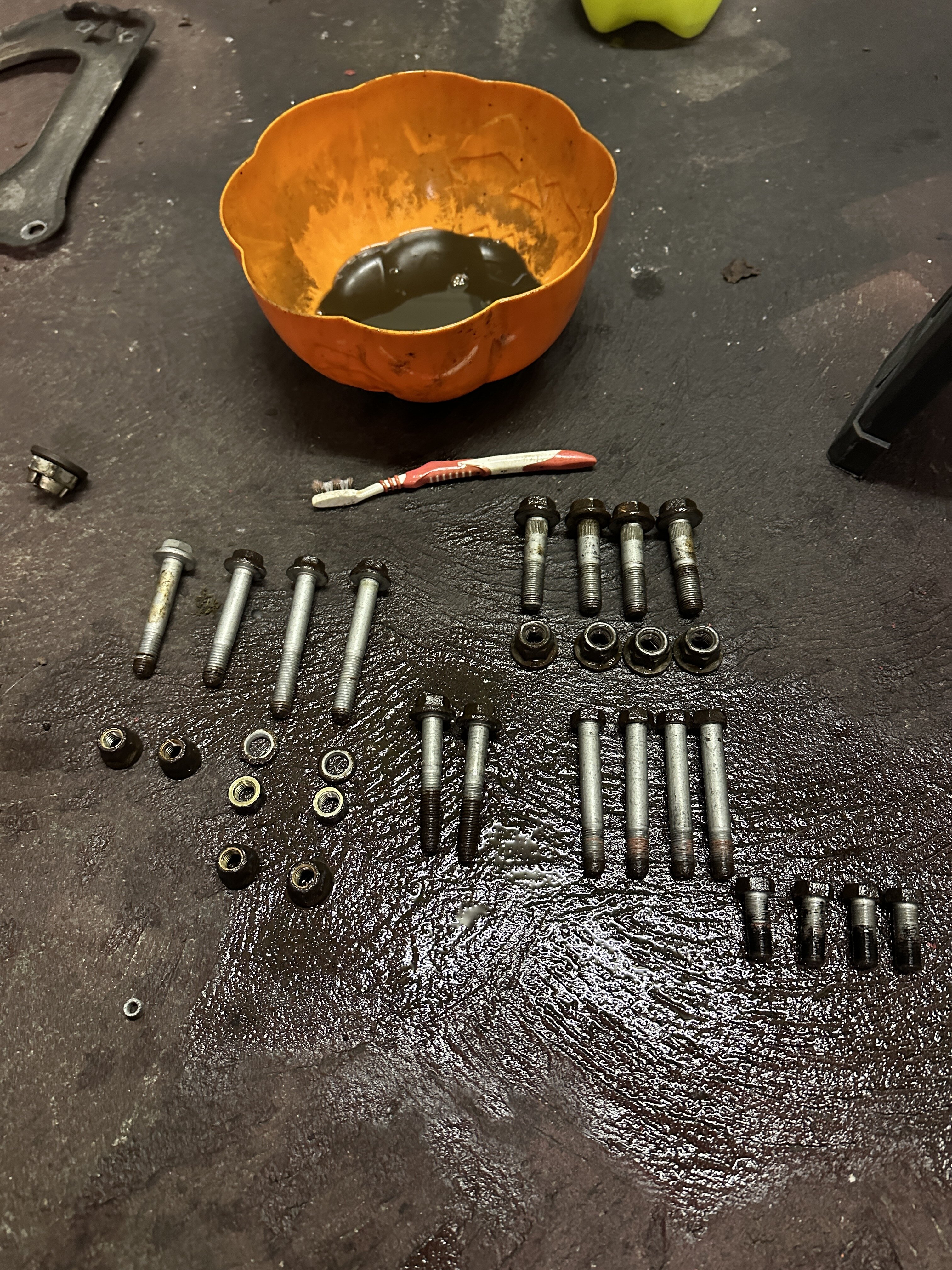

Clearly lost the plot tonight. Couple hours on the bolts with a tooth brush and degreaser.
Deox-C in the post, soak then coat. The price for new Renault ones are crazy but I’ll replace the nylock nuts.

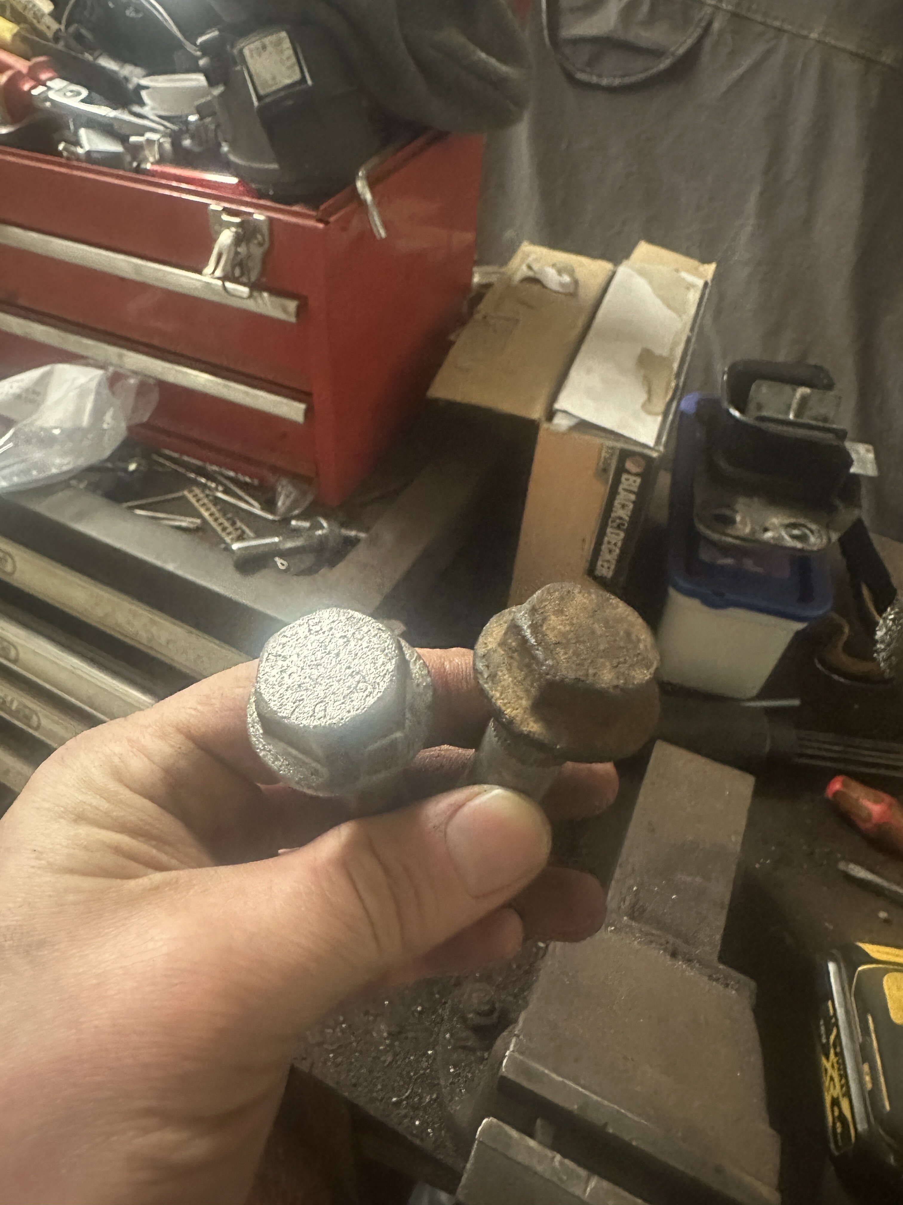

Took the brass wire wheel and the drill to the bolts and cleaned as much of the rust as I could. Some came up well and some were pitted badly.
Then using a thread file I cleaned the threads getting the copper grease out and making sure they were decent.
The front anti roll bar brackets got the same treatment.
Then all went for a 48hr soak in deox-c. Leaving me with clean useable parts that I can actually get a socket on without hammering it on!
I then heated the the bolts up and dipped them in new oil I had laying about, the results aren’t as good as hoped but it’s miles better than old rusted bolts. Don’t think I had enough heat in them. But if I put it on its roof at knockhill it will hardly matter!
My Dad was given a lift of nuts to source and will drop them off tomorrow. Also got him to get bolts and nuts for the rear beam and subframe.

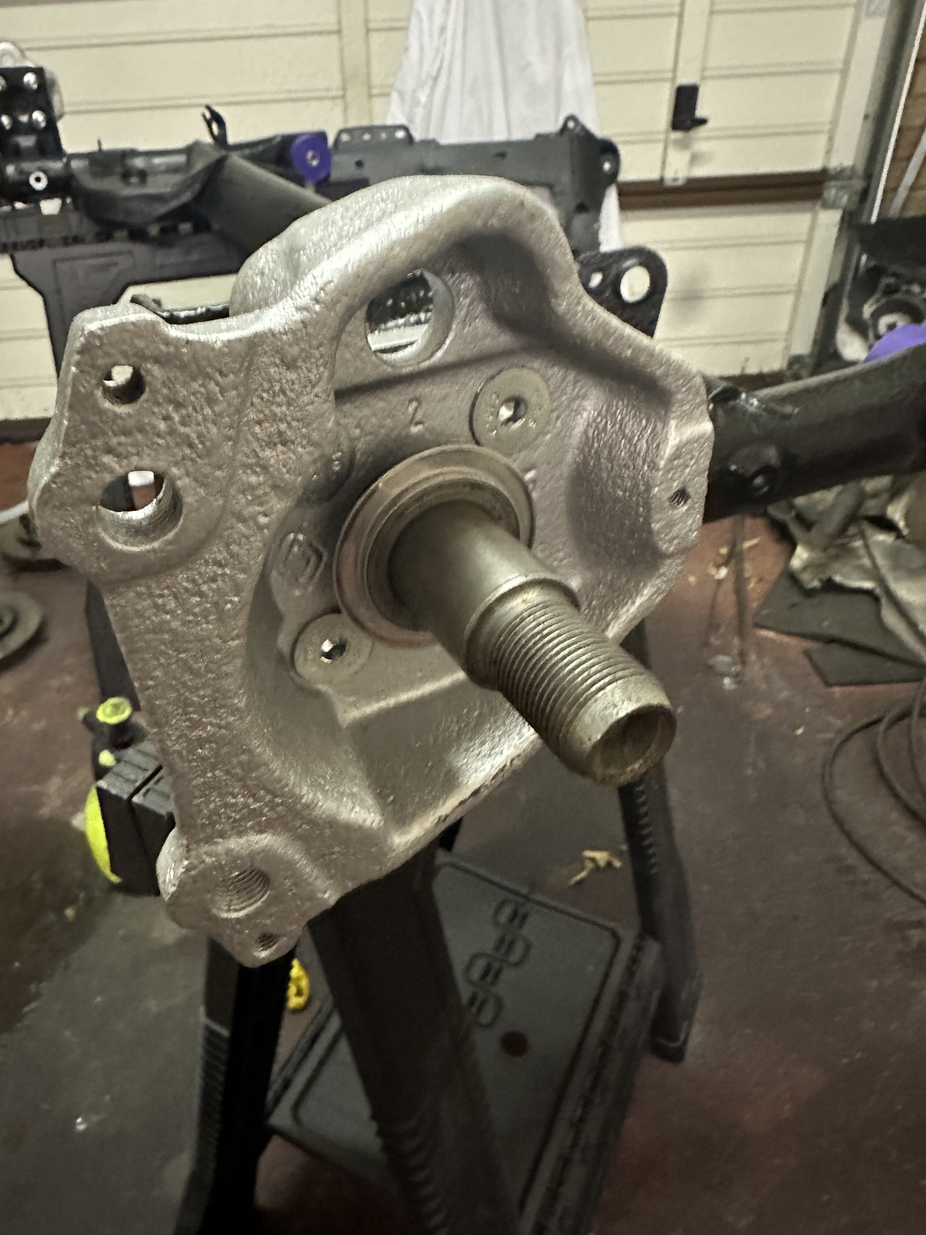

Raer stub nuts are here so flung them on, will need fully tightened once (if ever) the cars on the ground. Bolted the rear beam mounts on with new Renault nuts and bolts.

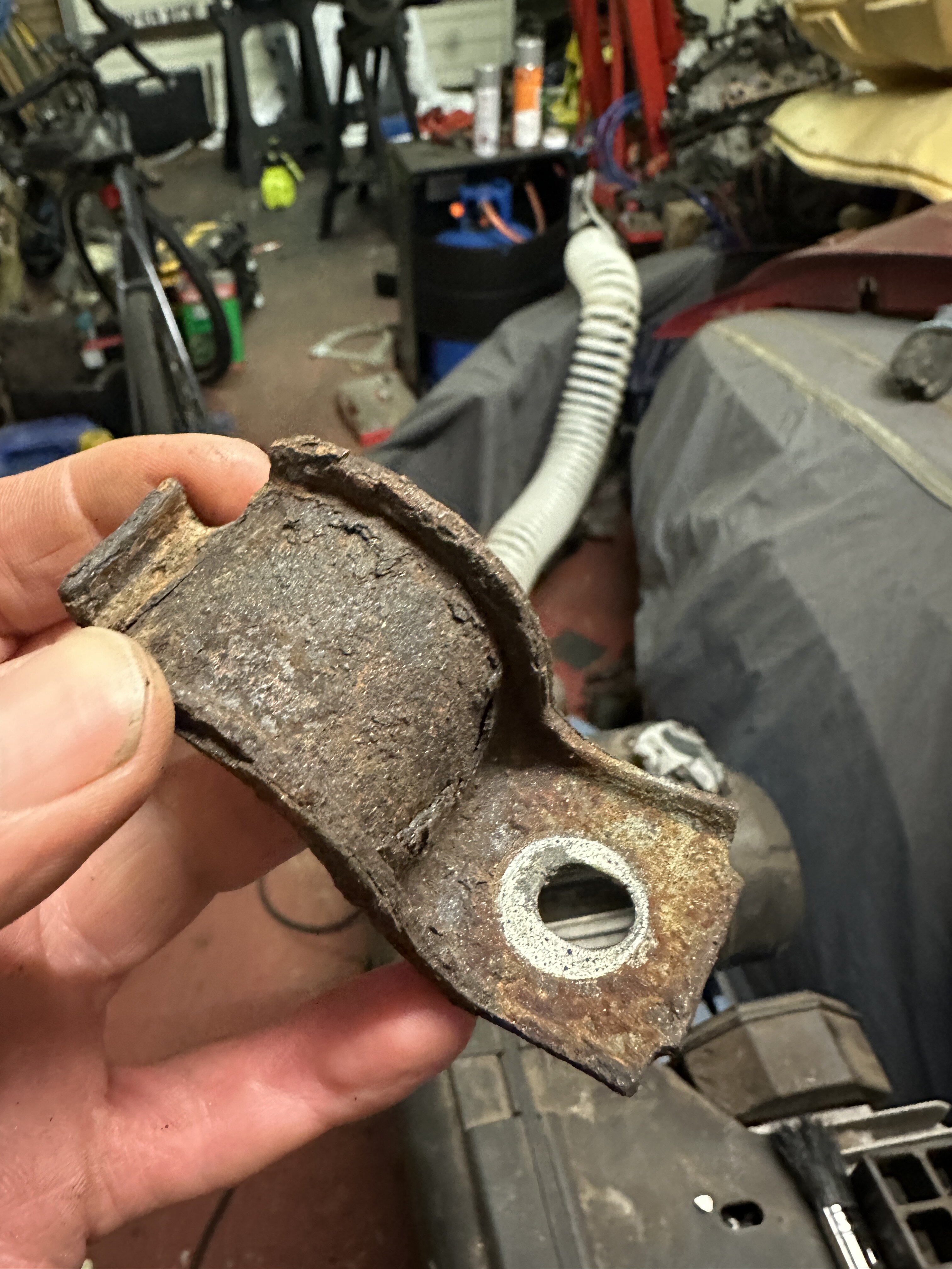

Cleaned the rear beam clips up. Will add some tiger seal as the threads and clips are worn to ensure they stay put.
Just need to fling the pads in, run the new brake lines and get abs sensors to finish the rear beam done ready.
So the rear beam pretty much there. Fitted the clips with some tiger seal. Probably should have ran the brake lines and fitted p clips instead, just for a better fitment.
Then got the rear pbs pro track pads fitted along with a new grams spring kit.

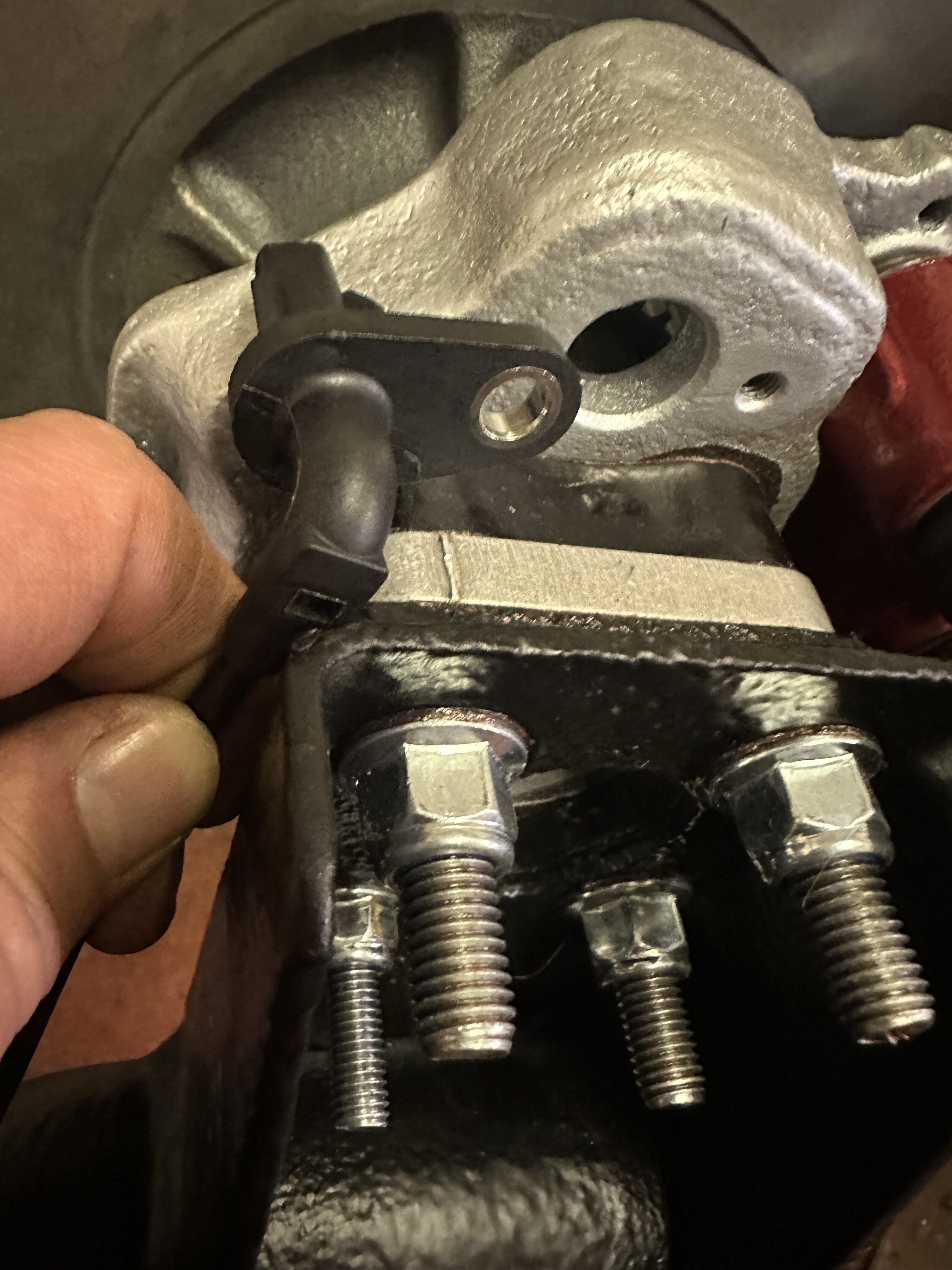

I did toy with the idea of ditching the abs but all it takes is one lock up and the cars wrecked! So went for proline braided hoses in red. I’ll probably get small ties secure these into the clips so ensure no rubbing.
Always knew the abs sensors were going to be a mare to get but tms (local car parts supplier) tried and were very close! Length, grommet location and plugs correct just the cable was on the wrong side of the sensor so wouldn’t fit!
I’ve 2 new handbrake cables to go on but still need 2 dust covers for the stub nuts and the correct abs sensors before it’s complete! Some time, money and effort just on the beam but it does look better than before……..

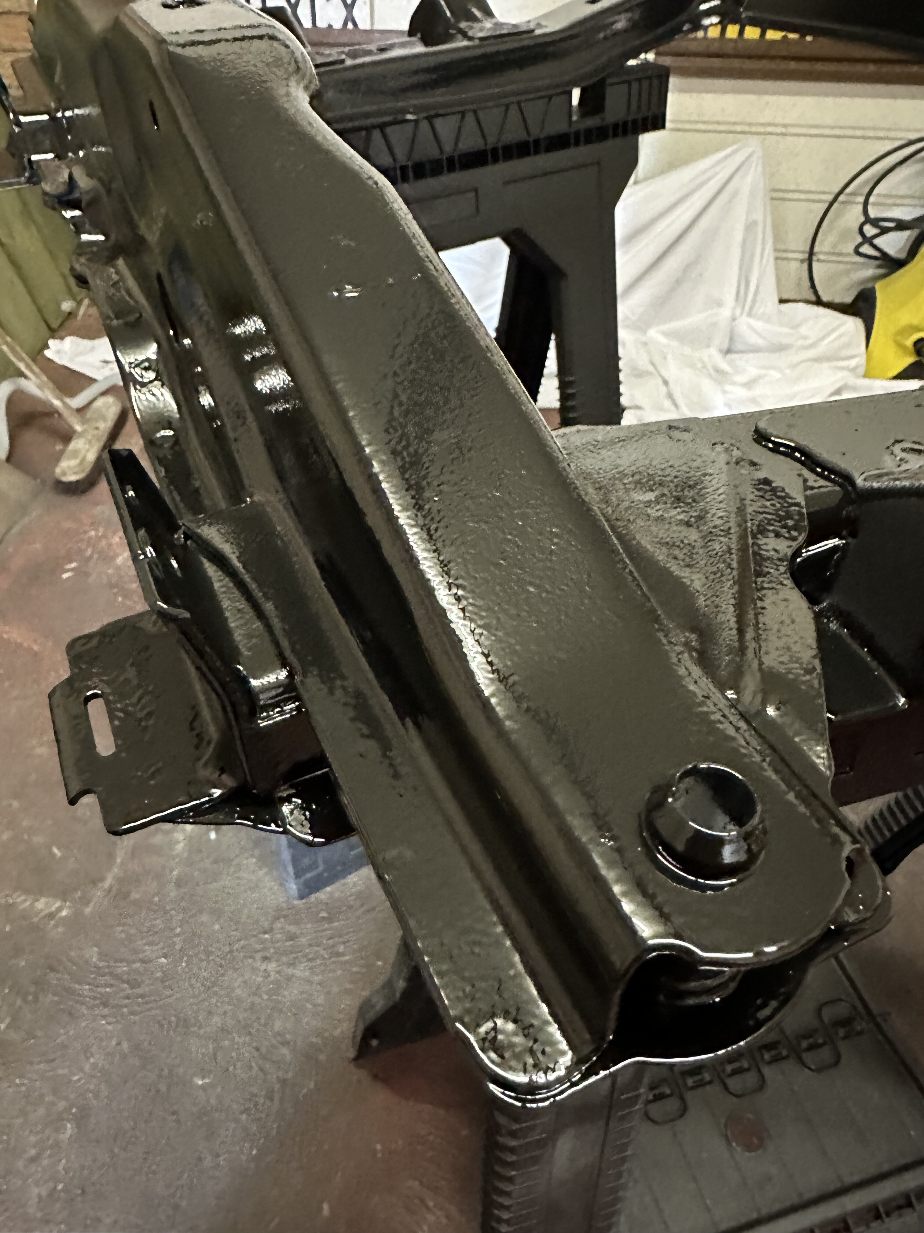

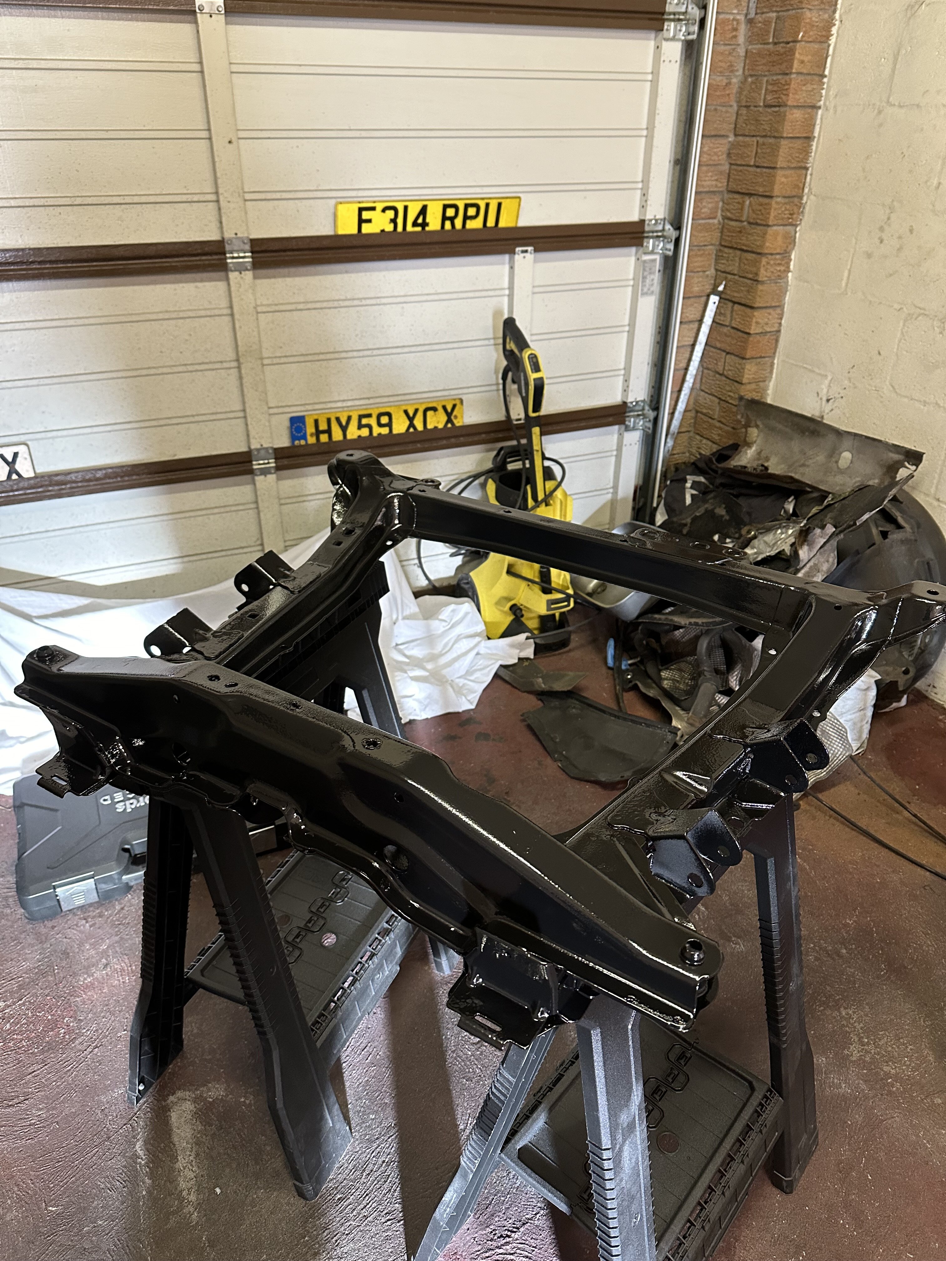

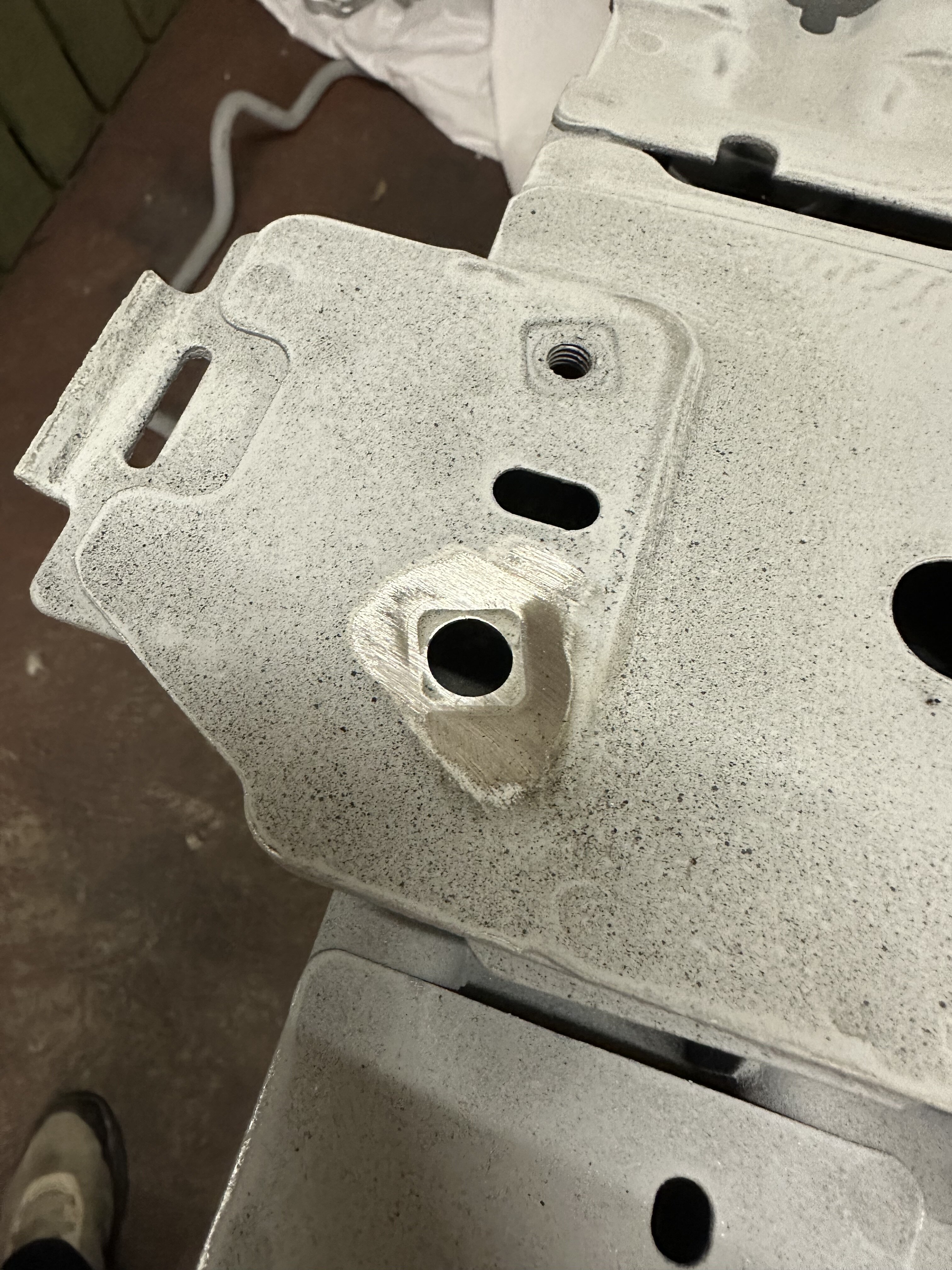

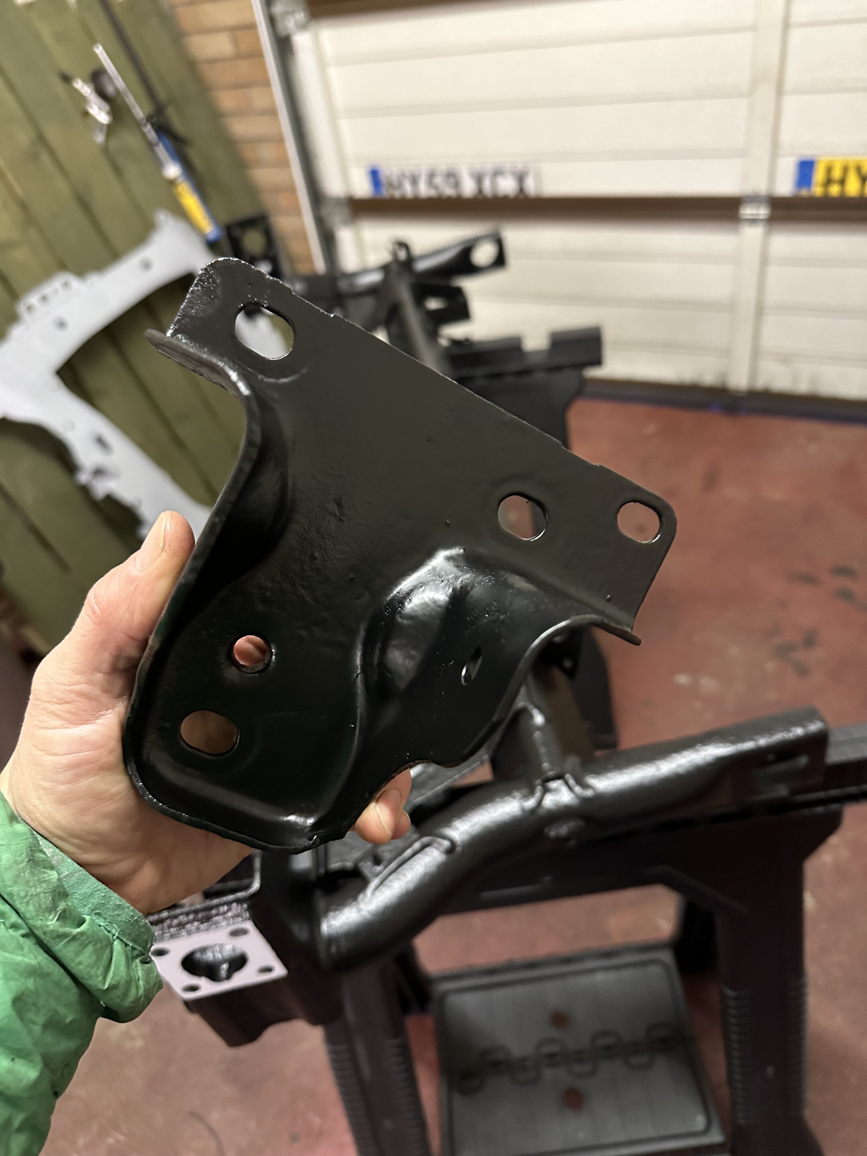

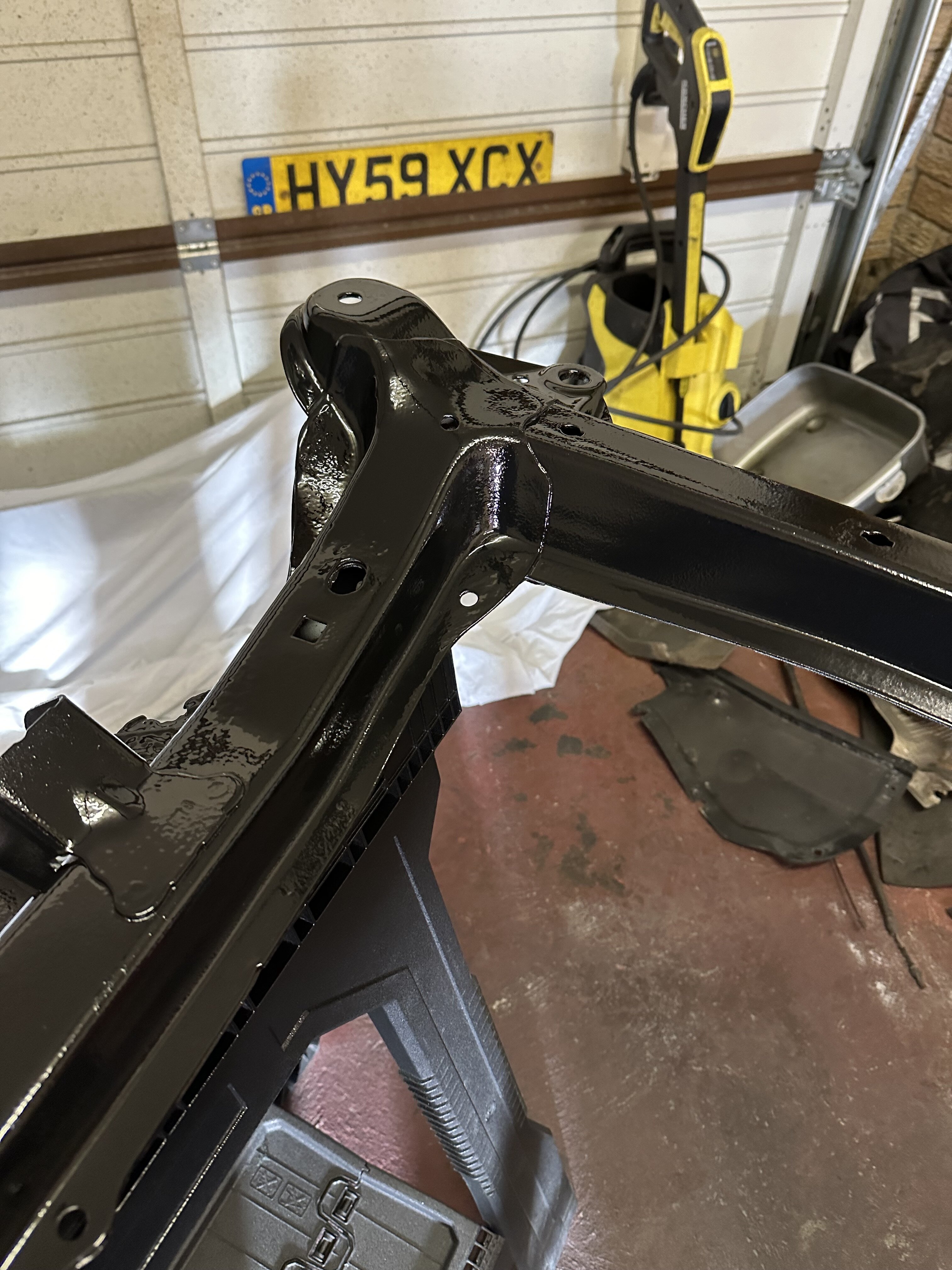

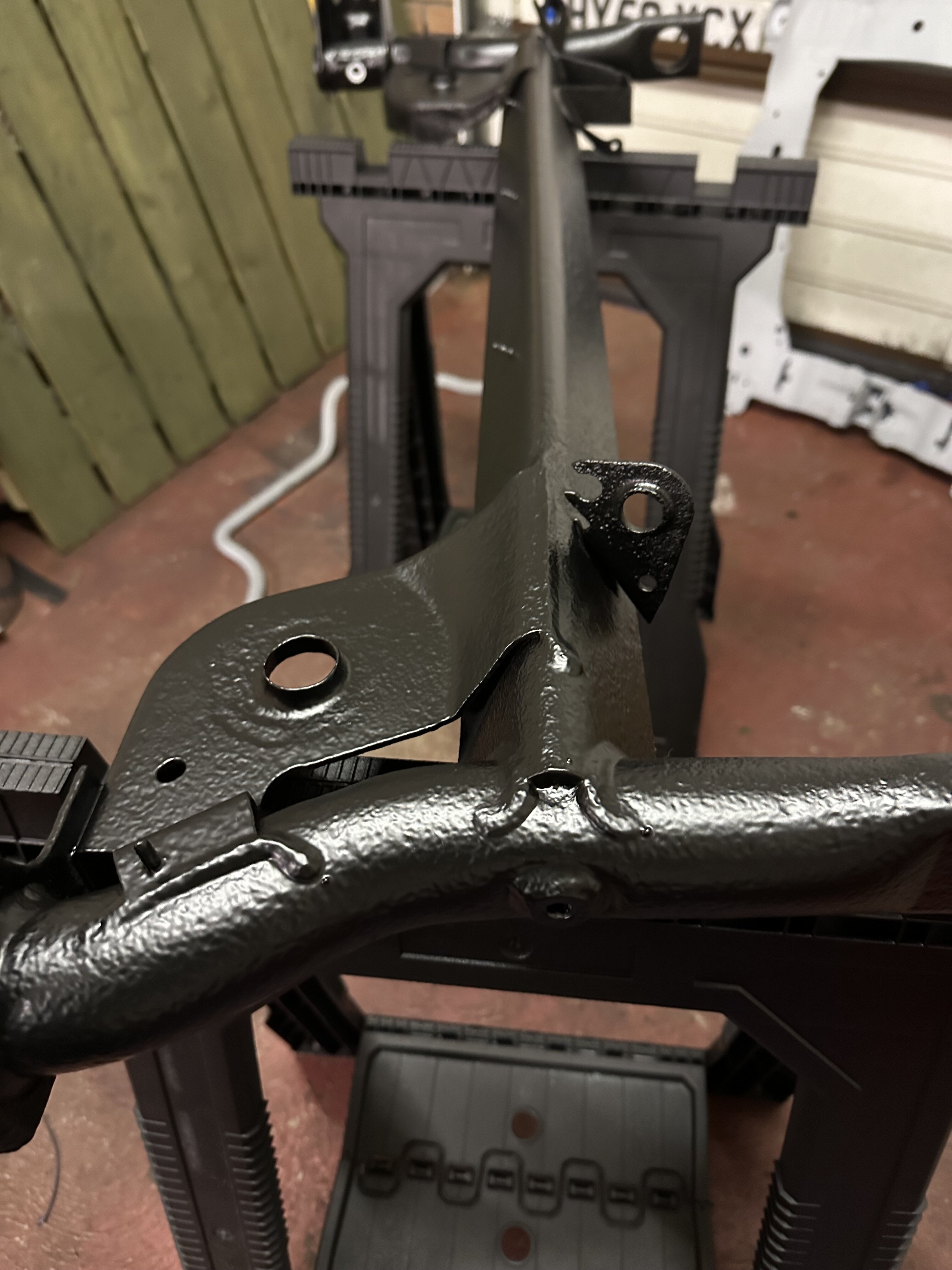

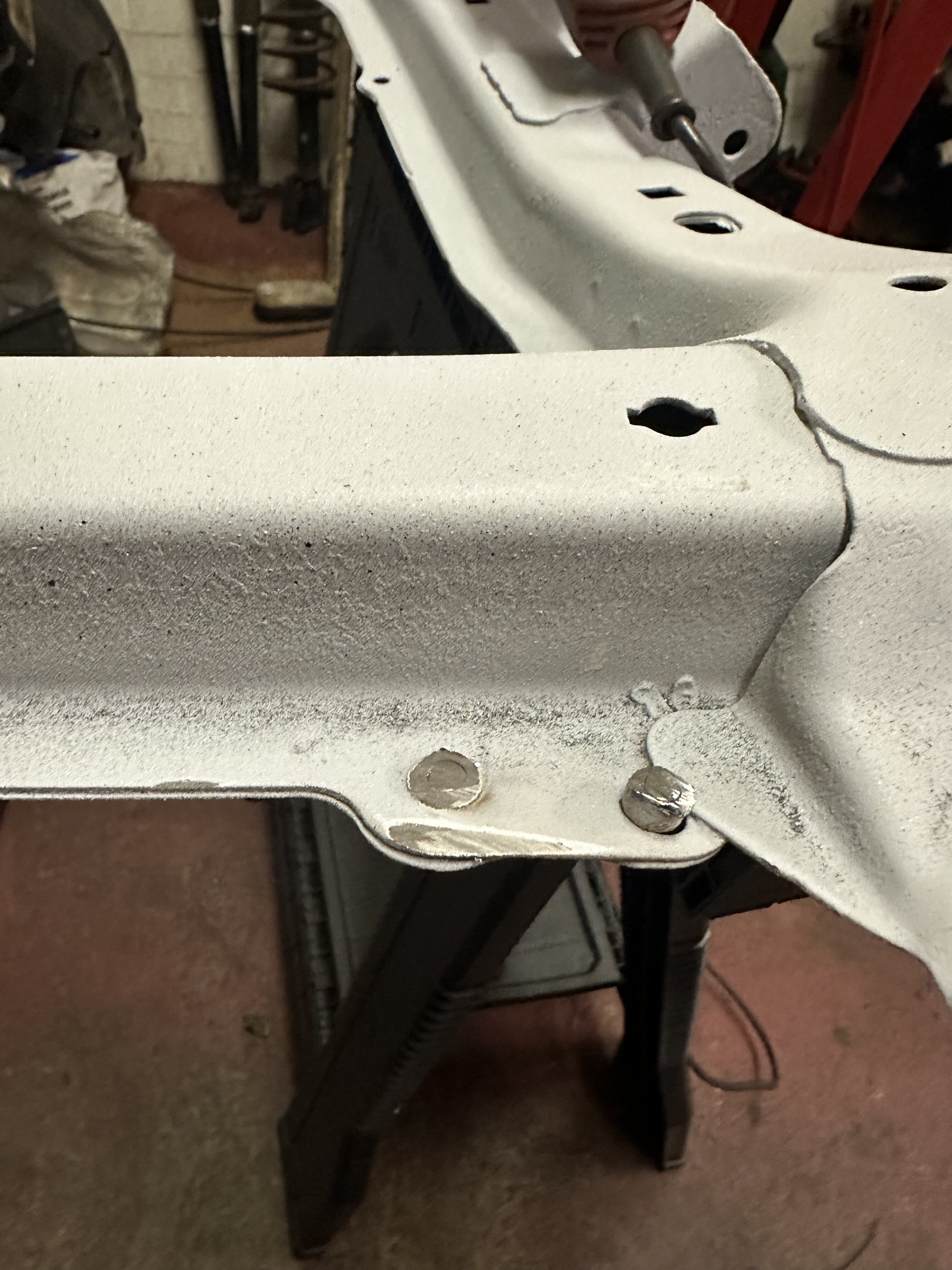

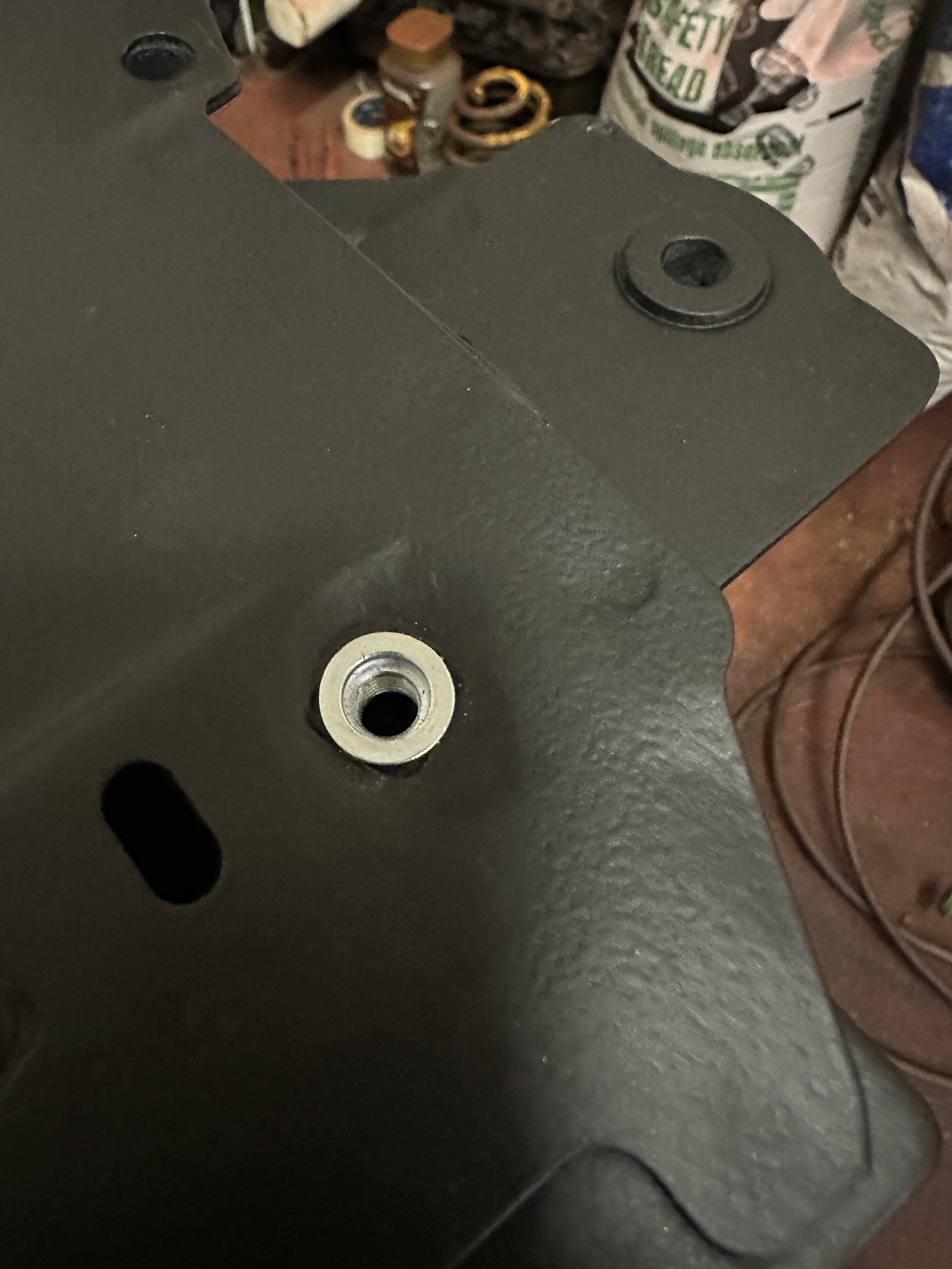

1st step on the sub frame was replacing the damaged rivnuts that I had removed before painting. If you haven’t got a rivnuts tool it’s a fanatic investment
Out came the rust buster em 121 in bright red, I’ve covered everything in the garage with over spray and I mean everything! The engine and box are a shade of pink now. Various brackets and the anti roll bar got 3 coats. I’m happy with the finish, with more care and time it could be better but it’s a track car at the end of the day.

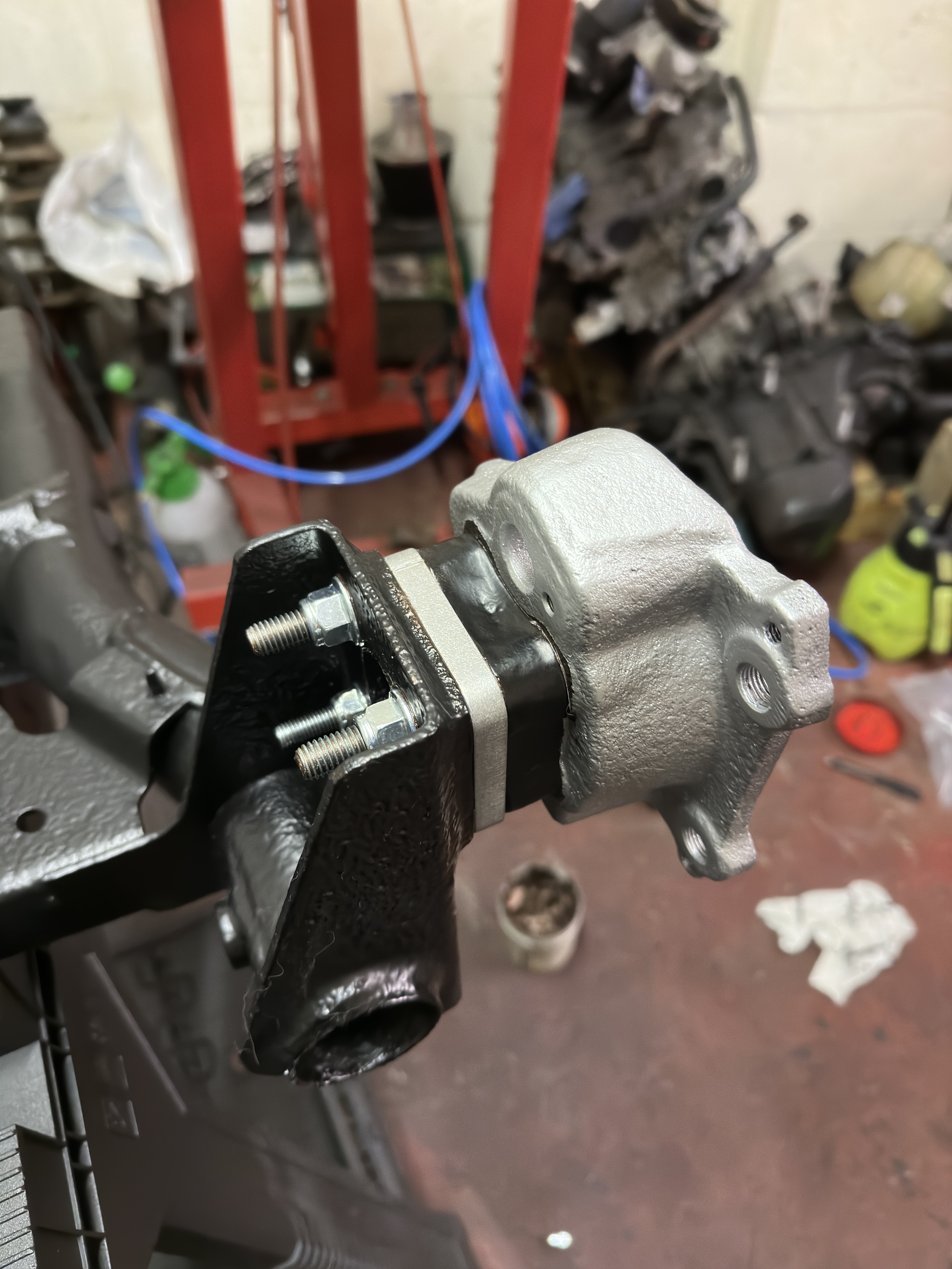

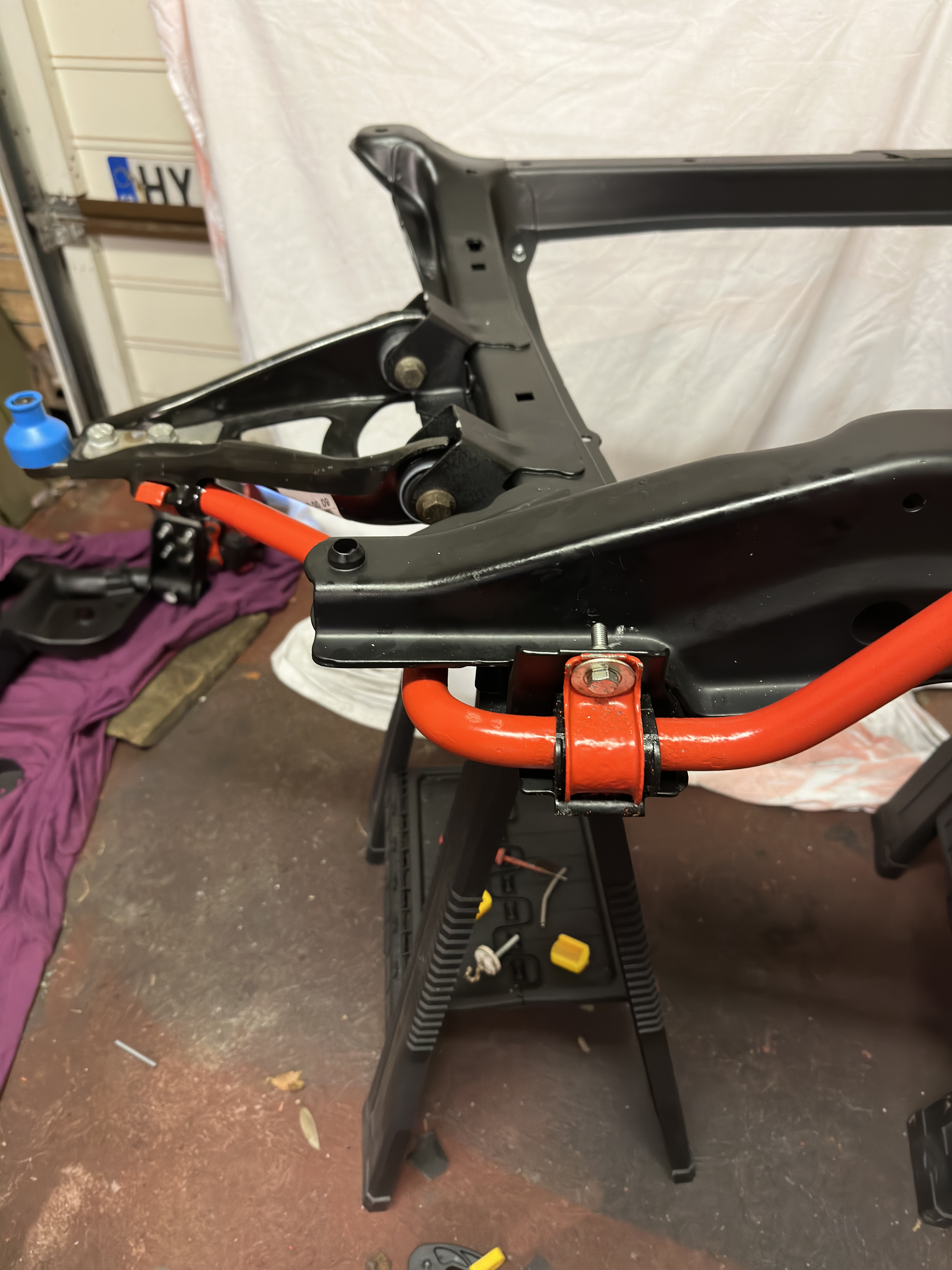

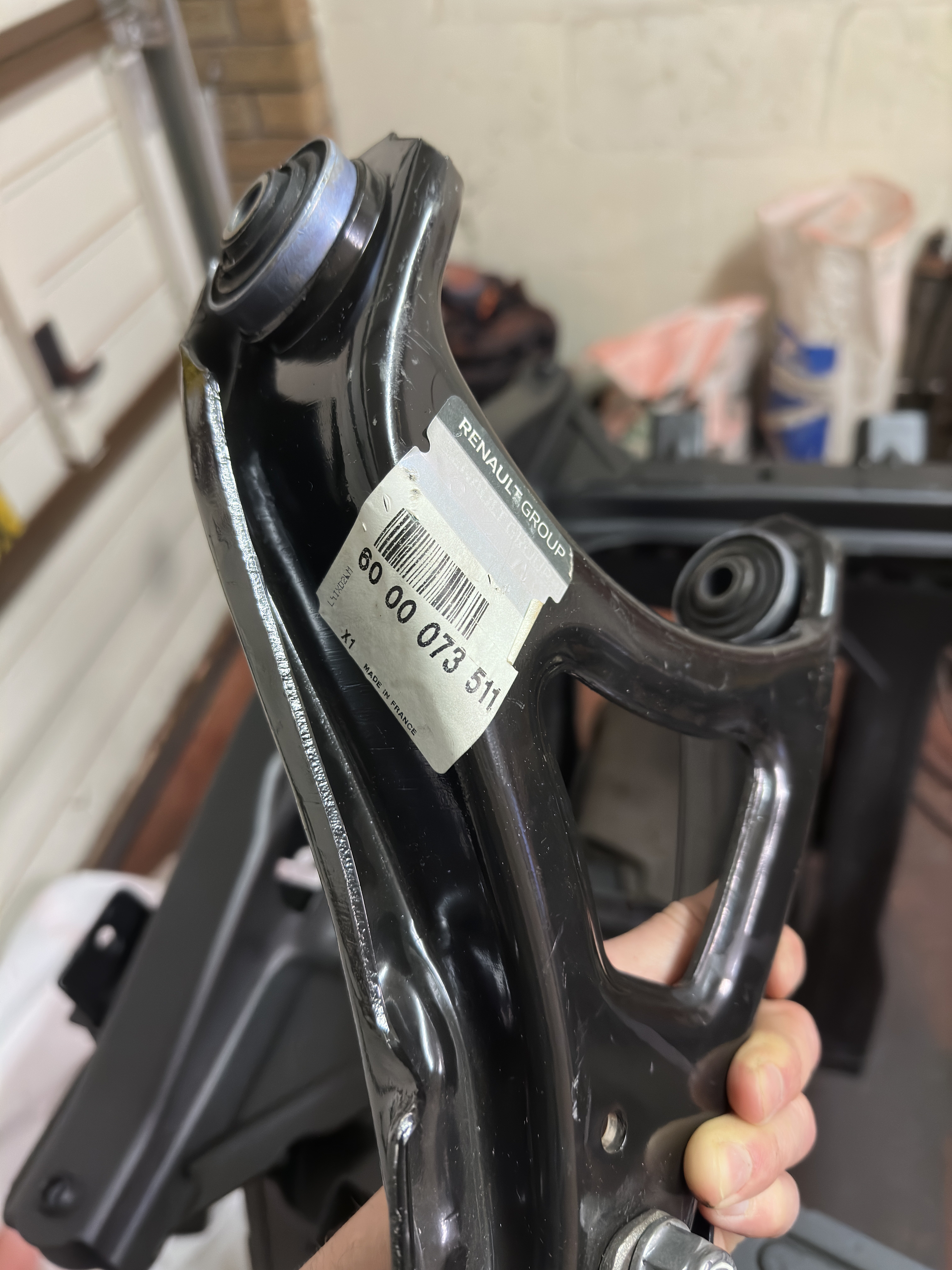

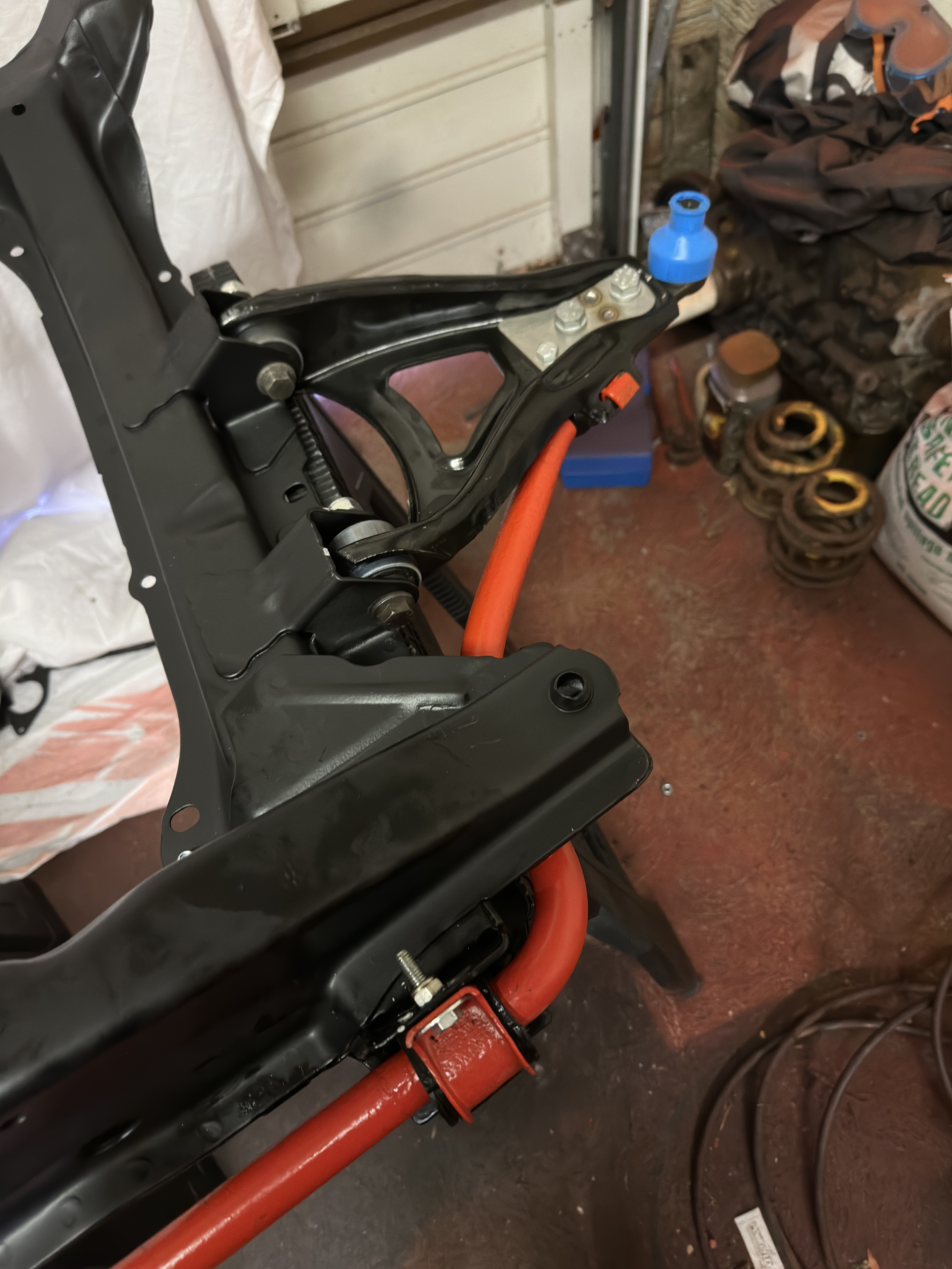

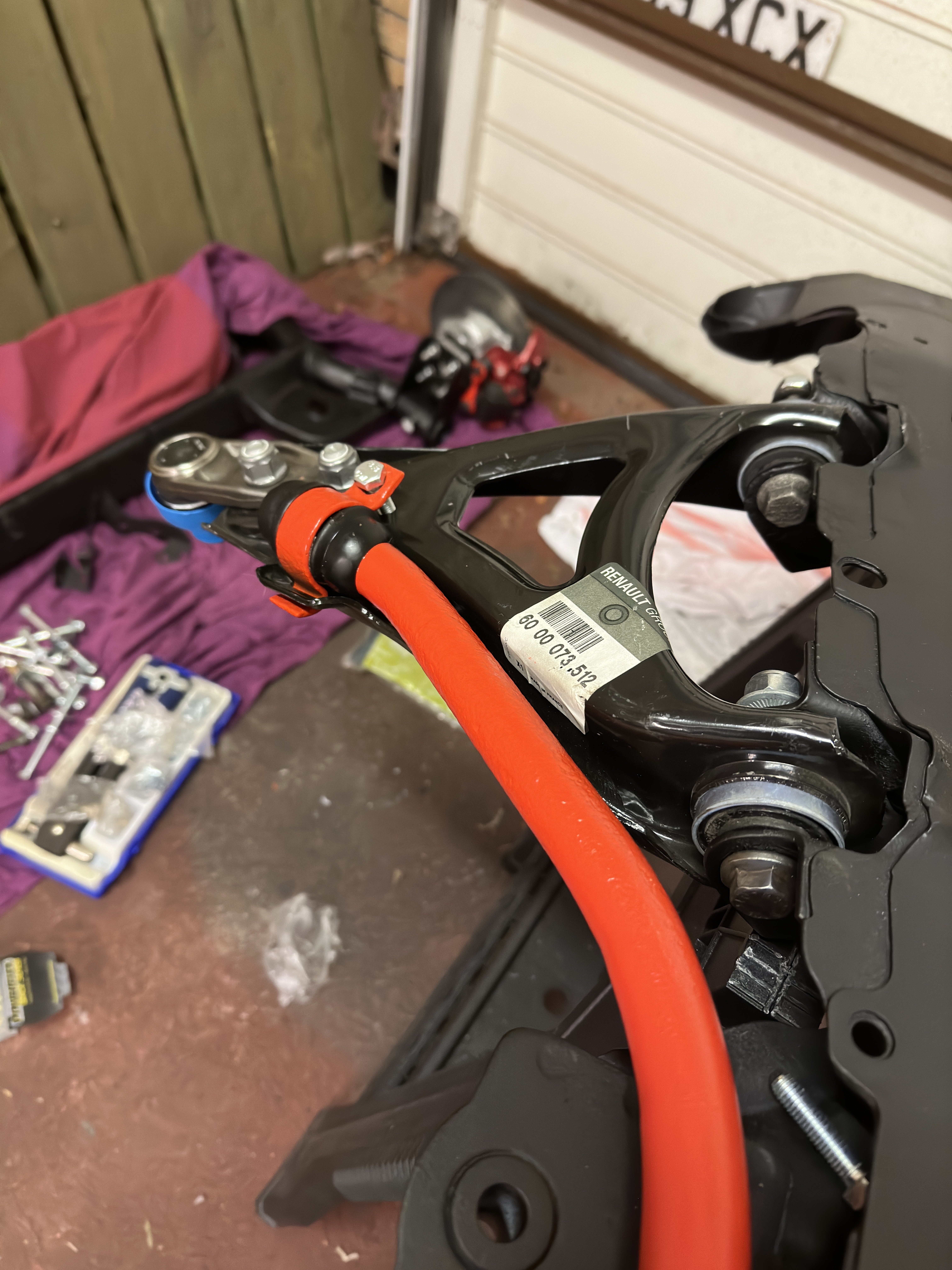

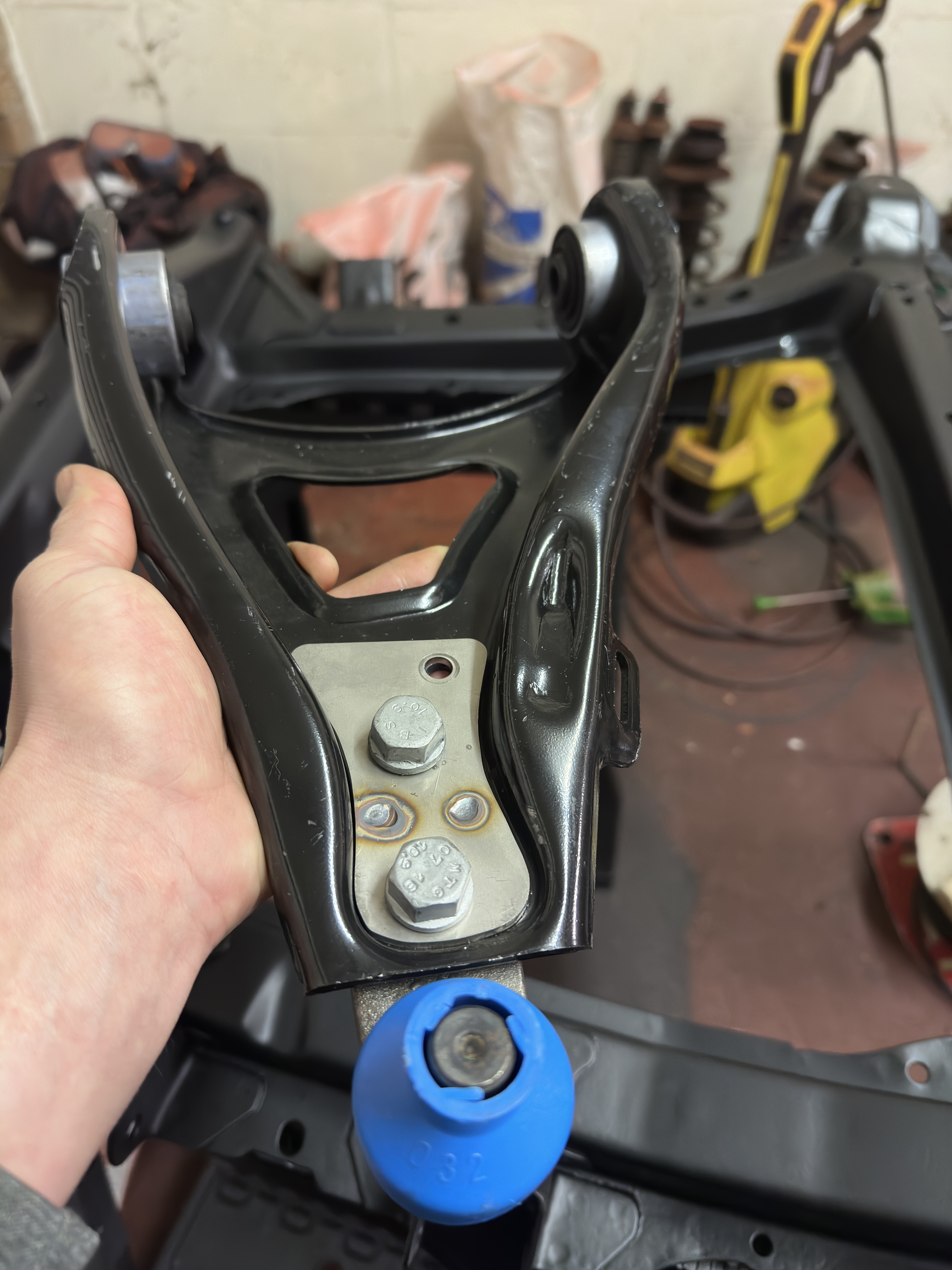

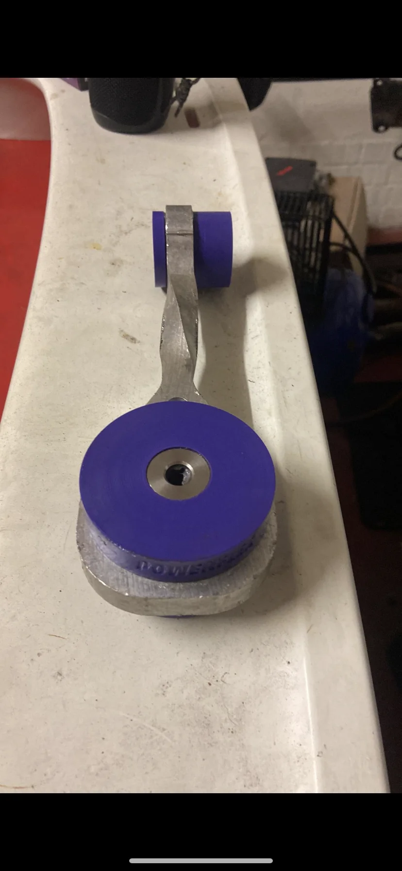

With everything painted and repaired it was time to bolt new parts to it. Firstly the new bottom arms, the whole reason this started after the elongated ball joint hole caused me such a headache. New Genuine Renault ph1 bottom arms from pure motorsport with the stainless plate fitted for correct camber that I bought ages ago before I started this thread. When the Renault bushes are done I’ll upgrade but for now they will tighten the front end up.
Yes I could have bought some cheap arms and pollybushed them but I do like good quality parts where needed. I also had bought Powerflex black series arb inner and outer bushes…… probably should have went purple as these are tight to fit, but in they go. It has to be better than what fell out!
Bolted all together with the bolts I saved with new nuts and it’s looking pretty good if I do say so.

1st step on the sub frame was replacing the damaged rivnuts that I had removed before painting. If you haven’t got a rivnuts tool it’s a fanatic investment View attachment 1685726View attachment 1685727
View attachment 1685730View attachment 1685731

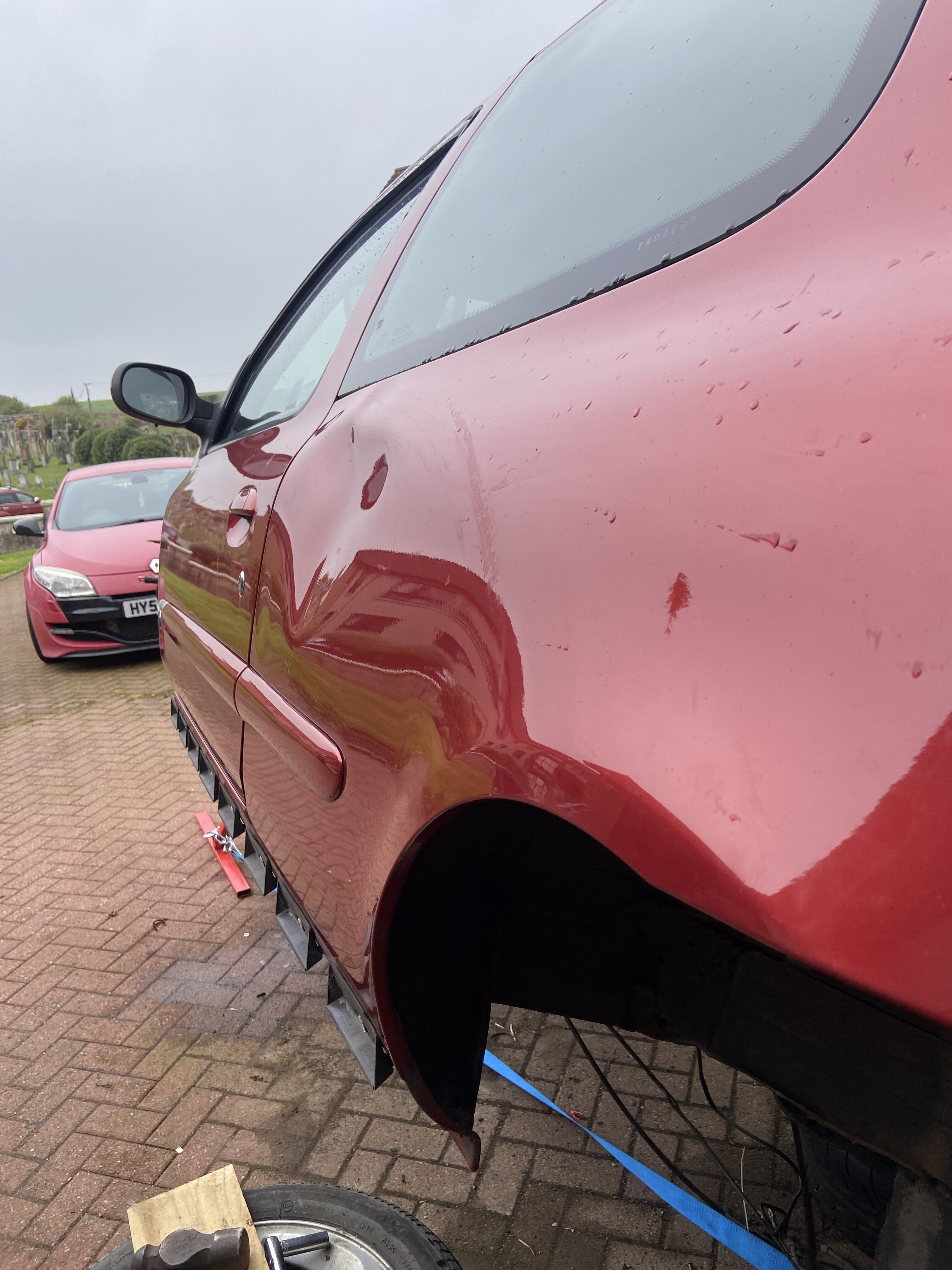

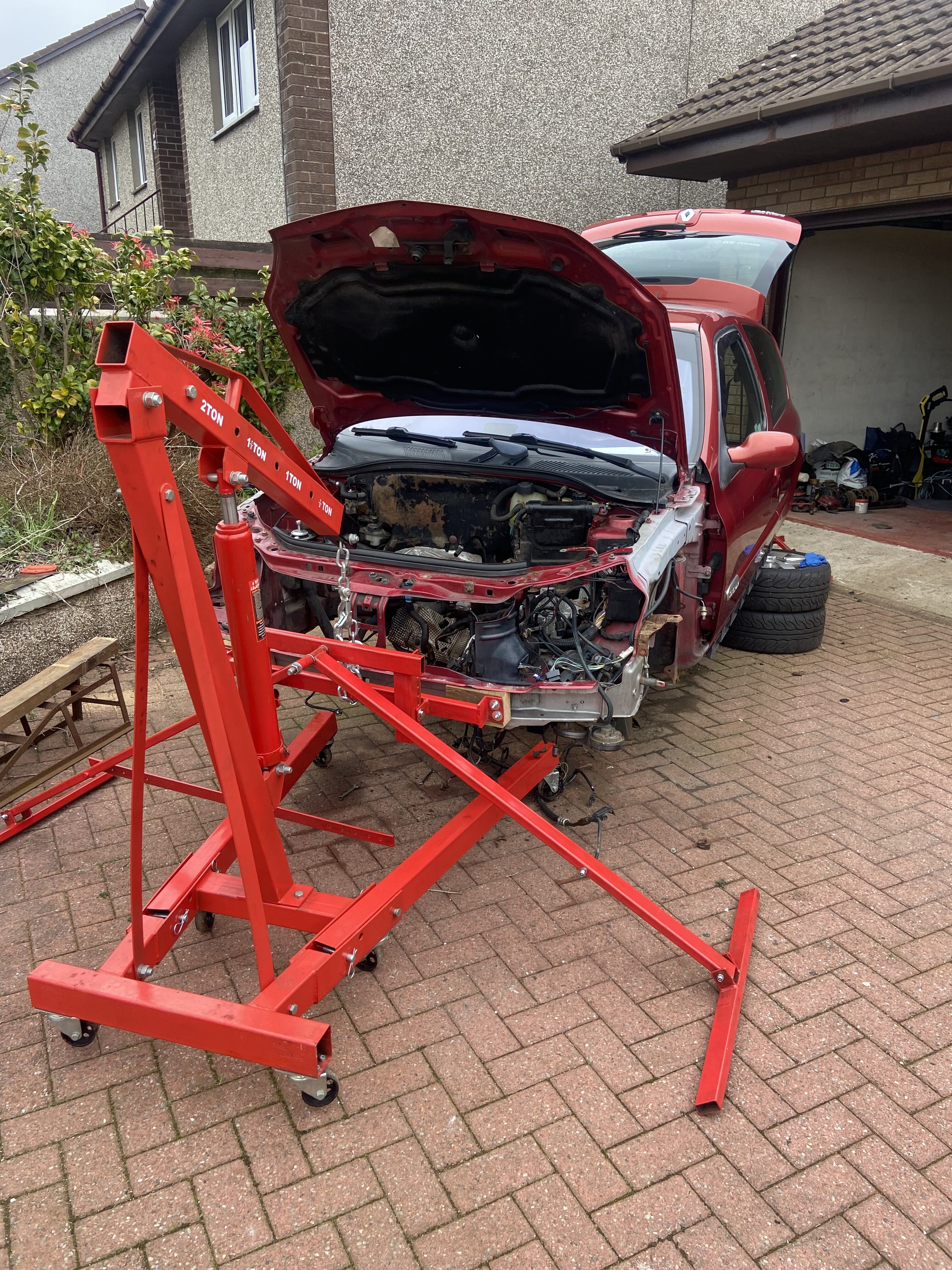

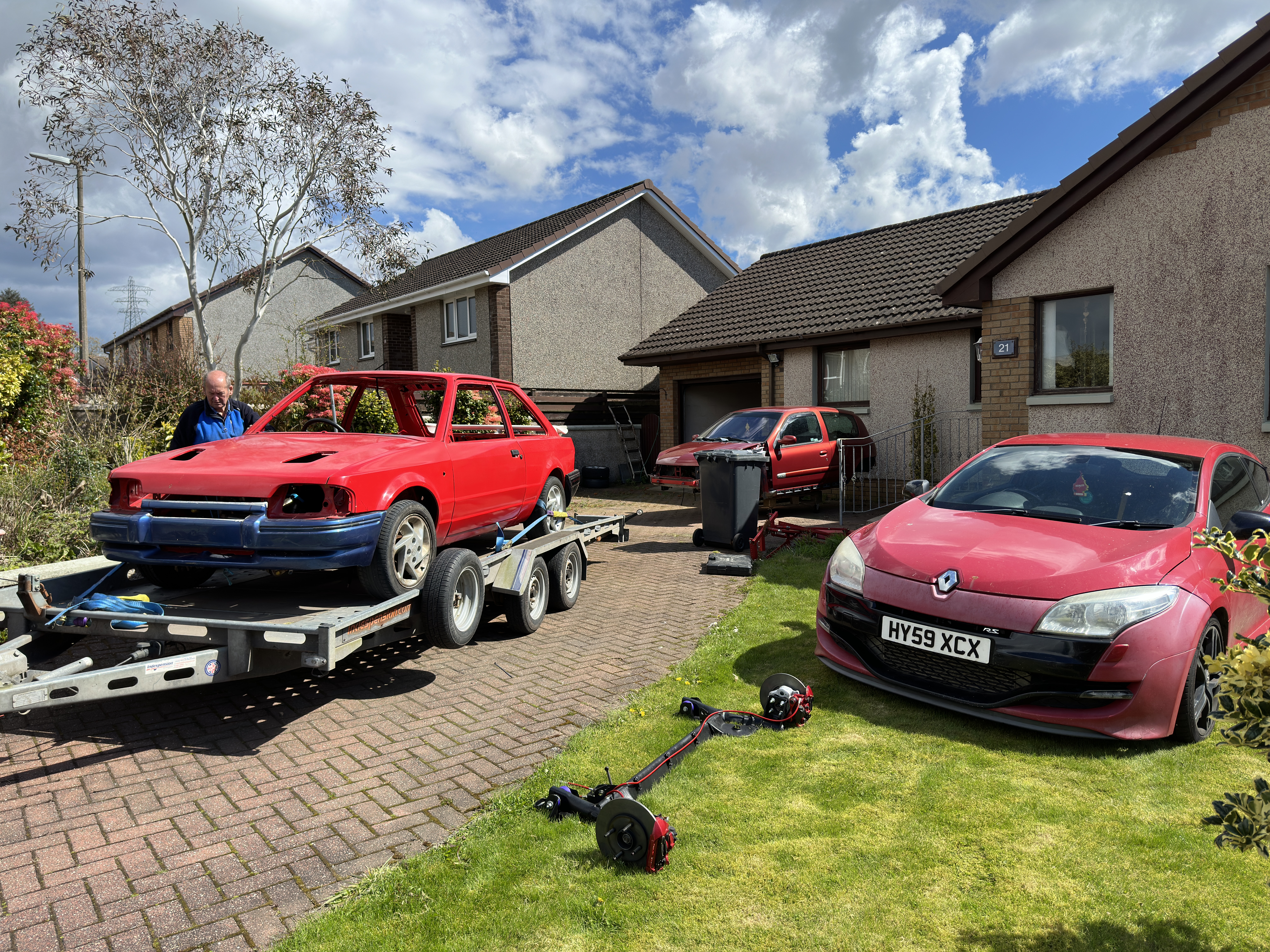

Had to dig it out of the garage 1st, then we trailered her off. Had to take the comps of and fling the standard wheels on for fear of damaging them. Had all 3 of the cars in the sun. A collection of red RSs!
Well red…….. Ruby the Megane has went pink after a poor paint job after the ex ditched her in back ice.

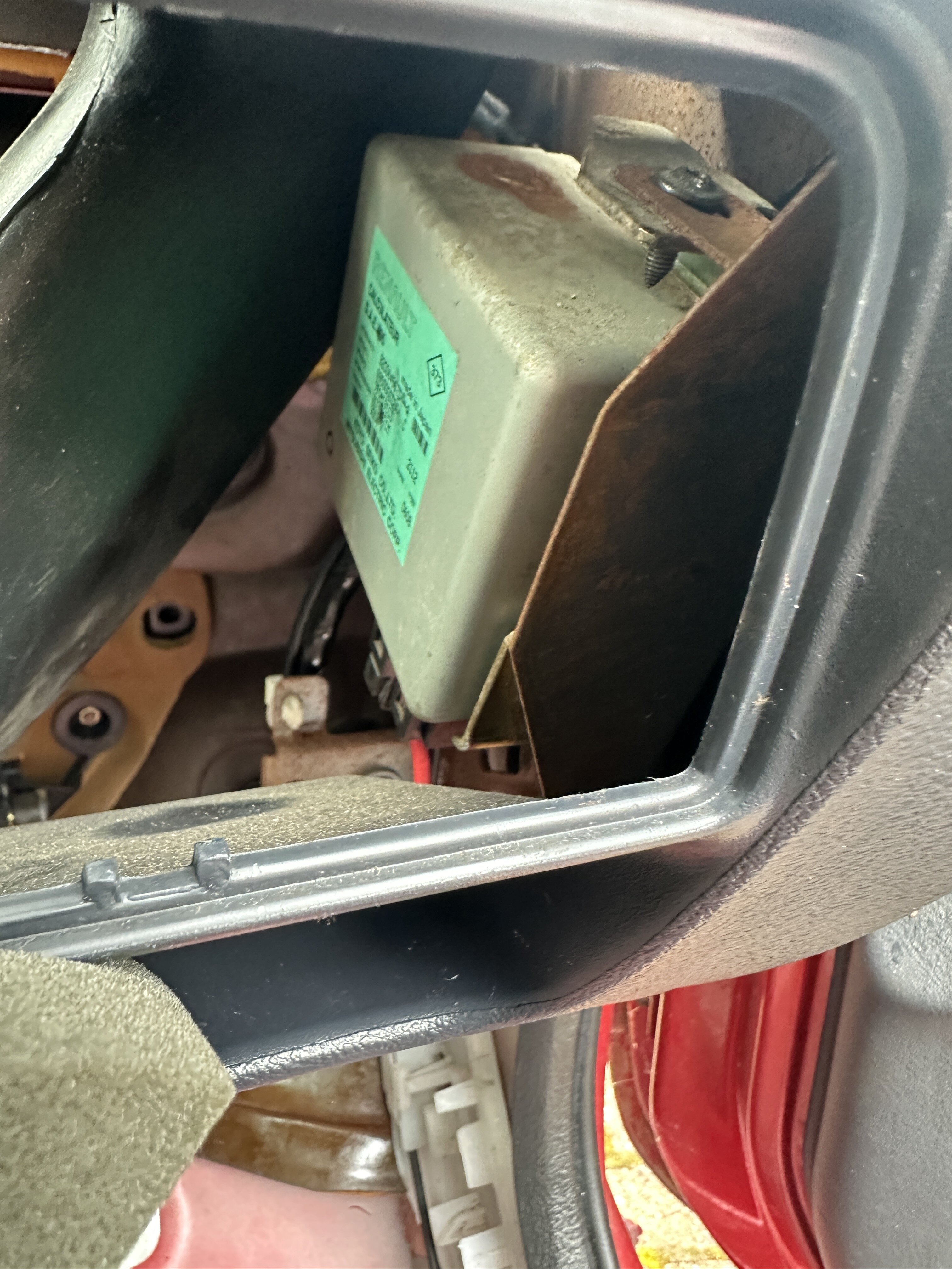

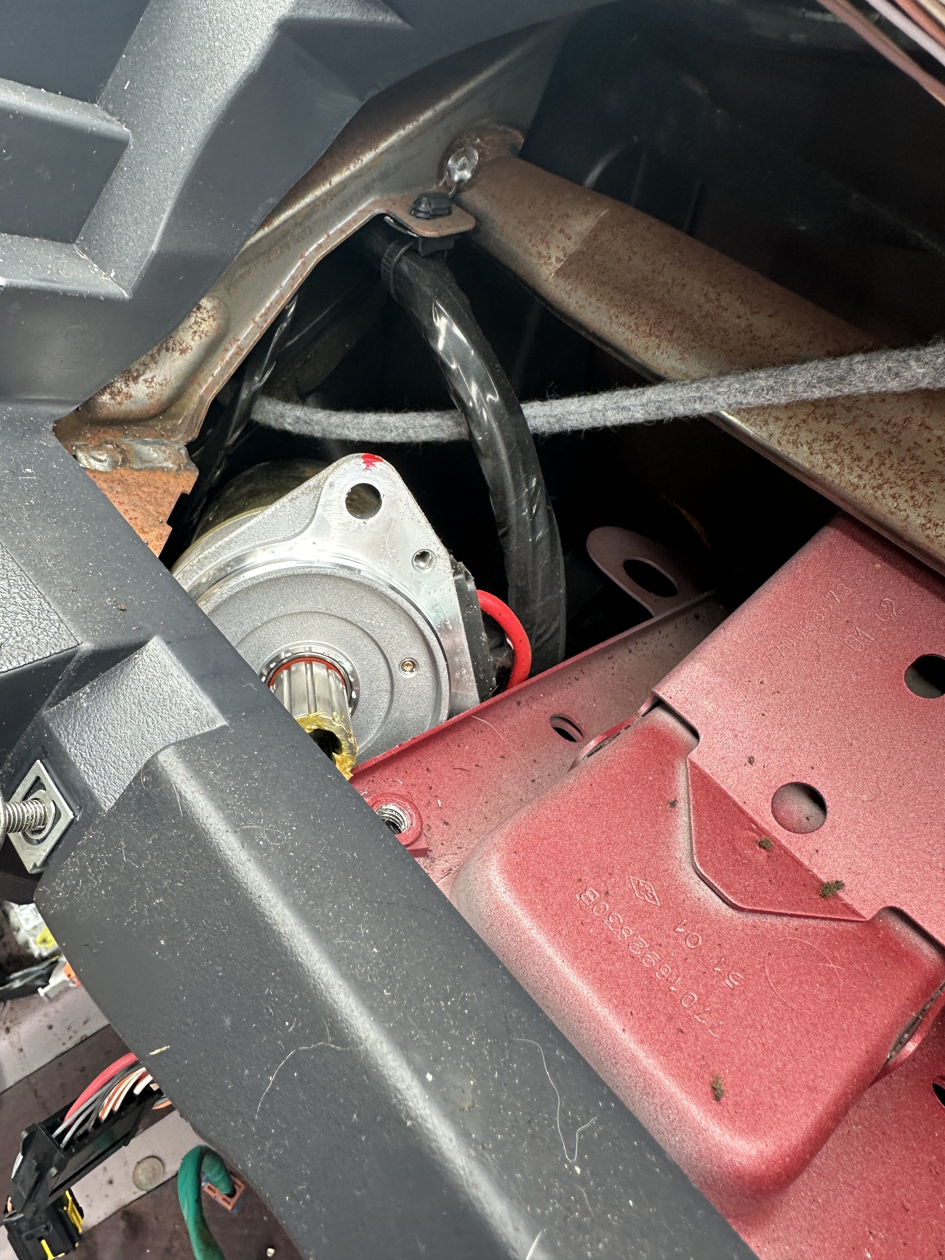

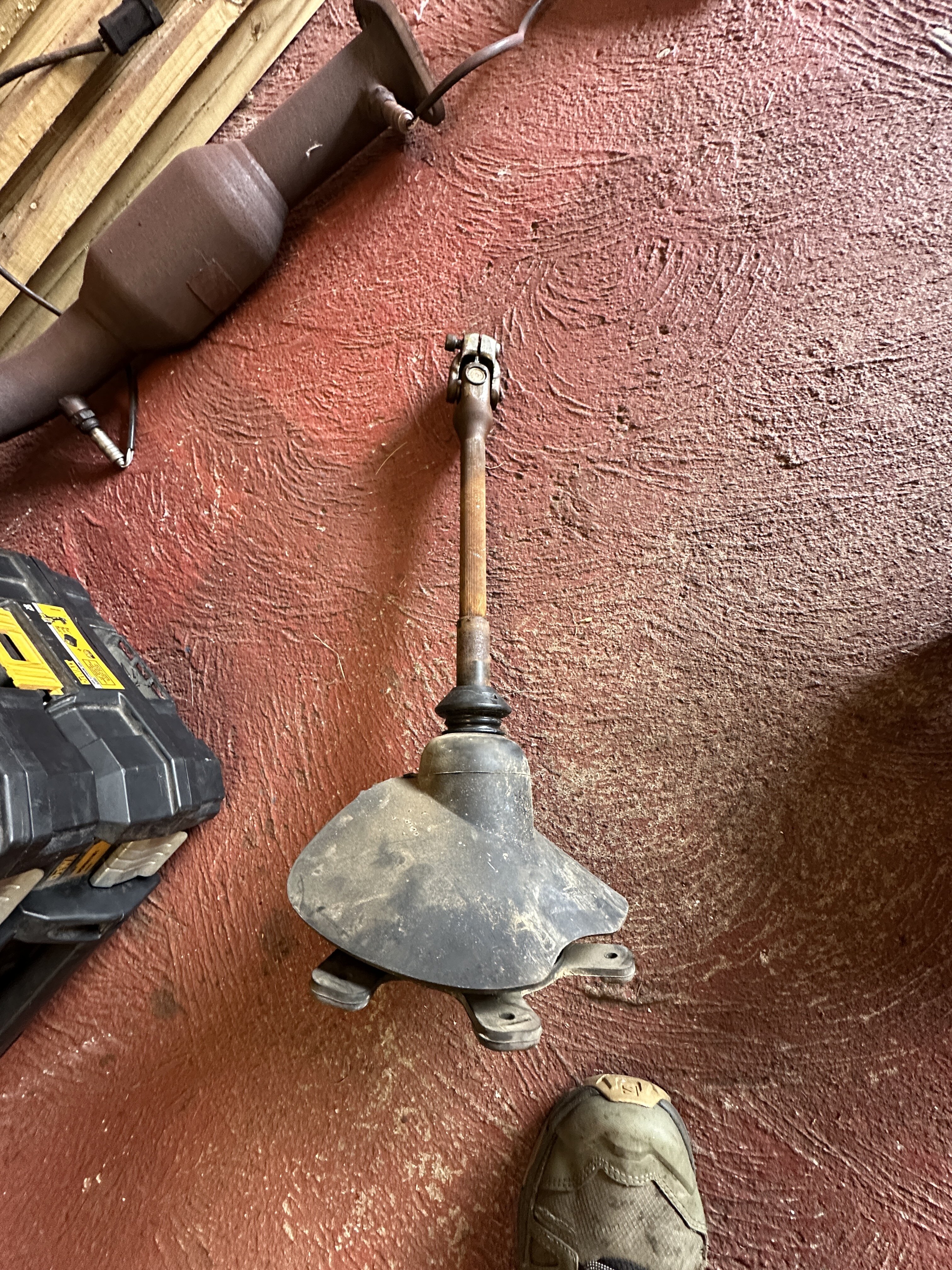

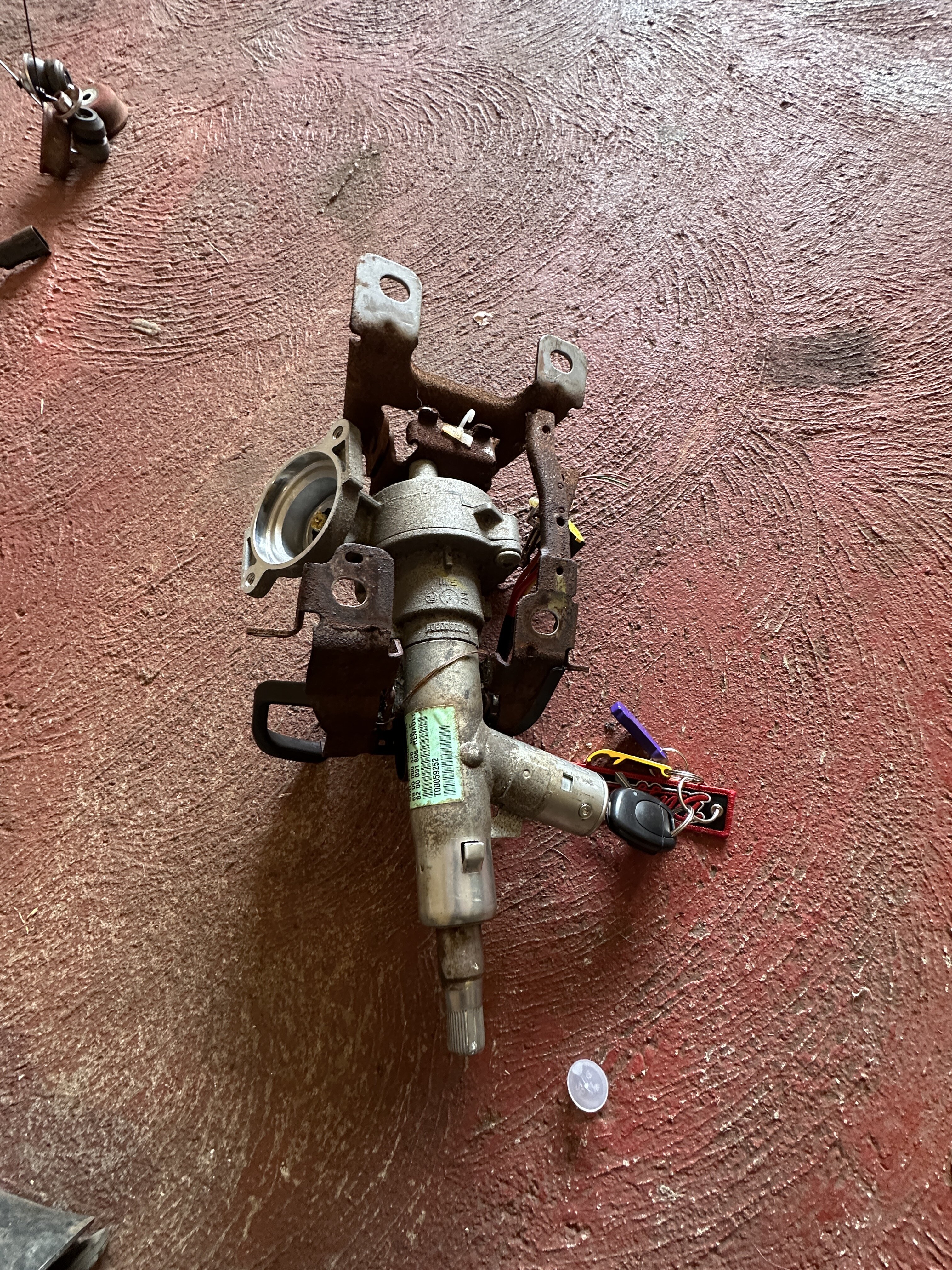

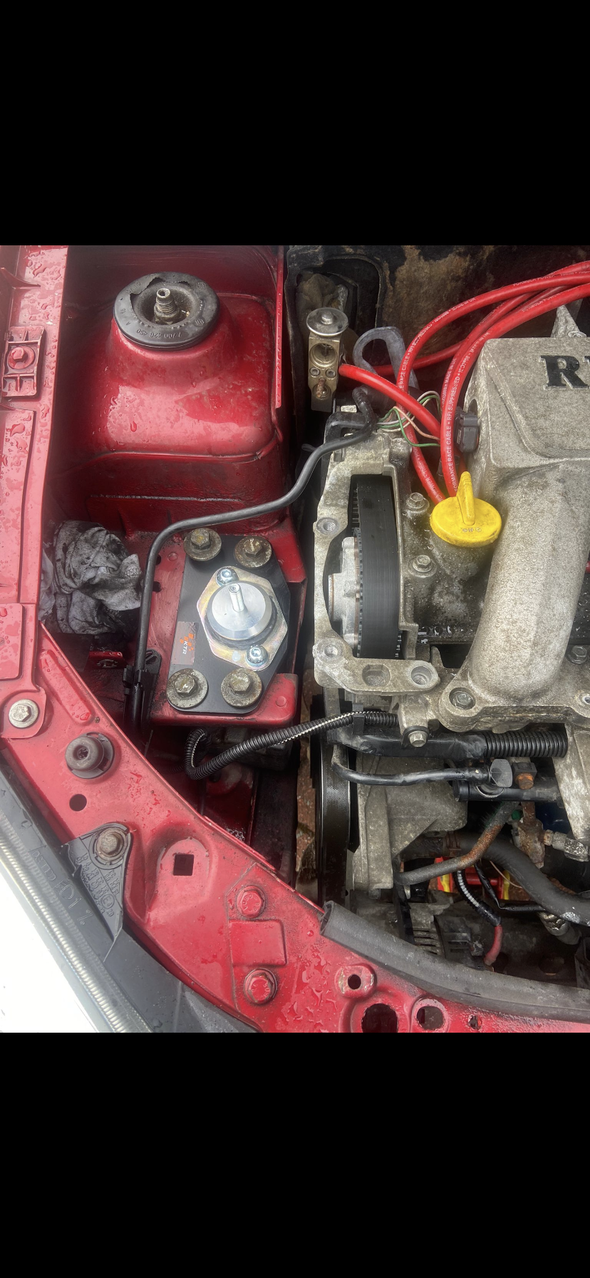

Decided to go epas, I knew where there was a dci waiting for scap so got everything free. Defo worth it when it’s went this far and getting all the old pipes out of the bay will be a bonus.
Stripped the motor off and made it easy to fit as per the guide on here! Love the Clio sport so many time saving guides!
Fitted the epas ecu too so just need the kit from eBay, will order this when I’m moving the battery and do the wiring in one go.
