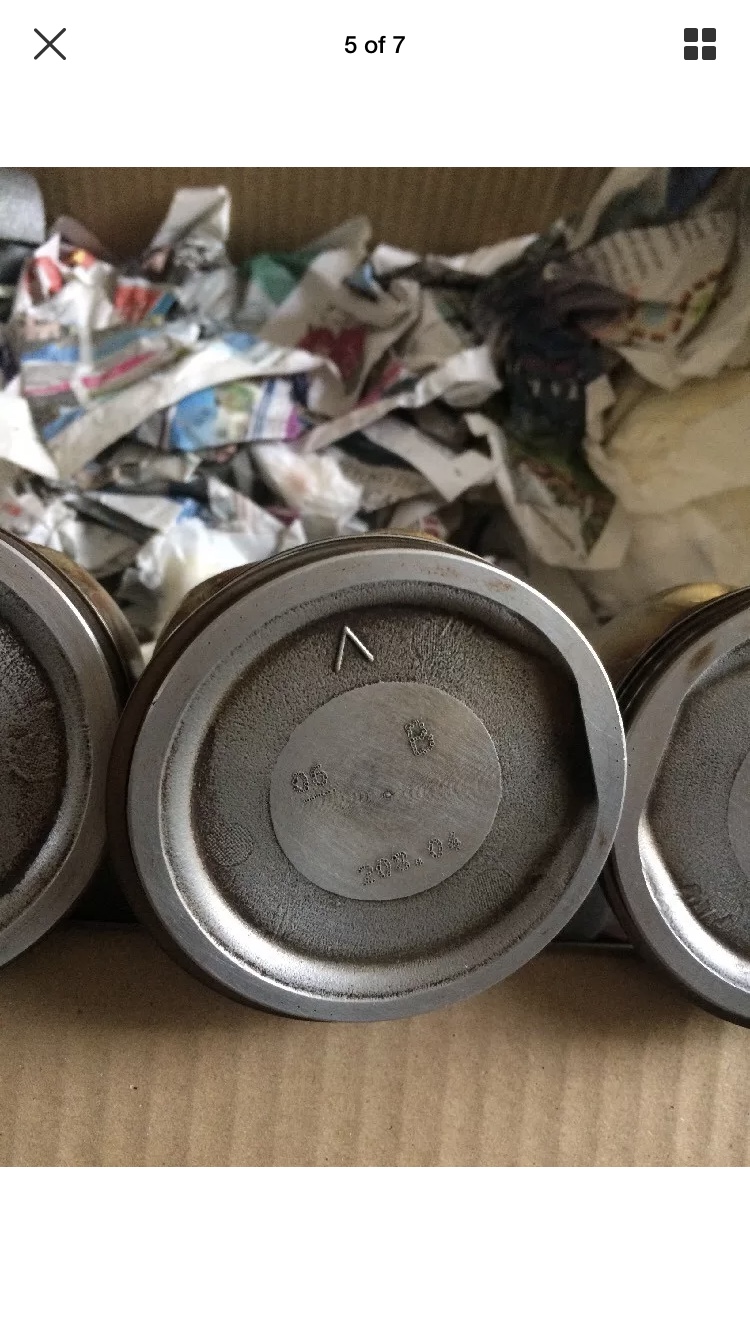

Hi guys, I’m after some info... fitting megane 225 OEM pistons to a Clio F4R block and wanting to retain VVT... I have been told I’d need to get some valve pockets machined into the crowns. Can anyone give me any drawings or info on this? Or recommend someone who can/has done them that I can possibly send them too?

yup, double check the pocket depth but the meg gasket is about 1mm thicker so is going to get you about there, also am sure i've heard of a couple of people running vvt with meg pistons and possibly just 225 gasket.

I’ll be running a 1.3mm gasket anyway to get to 9:1 ratio, but Chris@ efi said they run very close so worth getting the slots done
