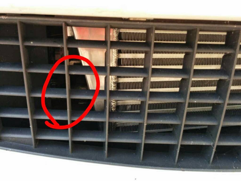

Found a leak in the r26 ac system, and I've got a new ac switch and new seals for the pipe in that area. Does anyone know if it's just a question of undoing the pipe, replace seal, get ac regassed?
Yeah pretty much, the pipes can corrode quite badly there, ease it out carefully and clean as much corrosion off as possible, more than likely it will leave the seal in the condenser, they are rigid seals but will come out!
