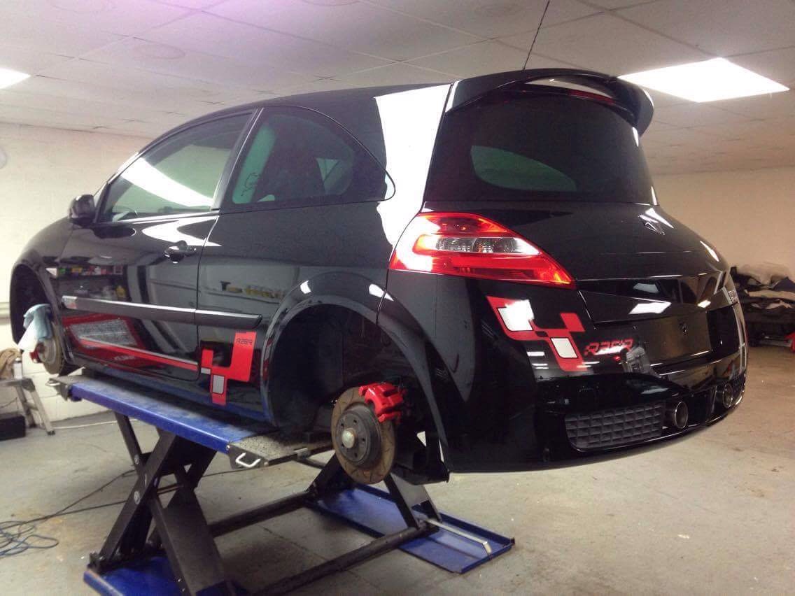

No chance if that lol, it's used daily...

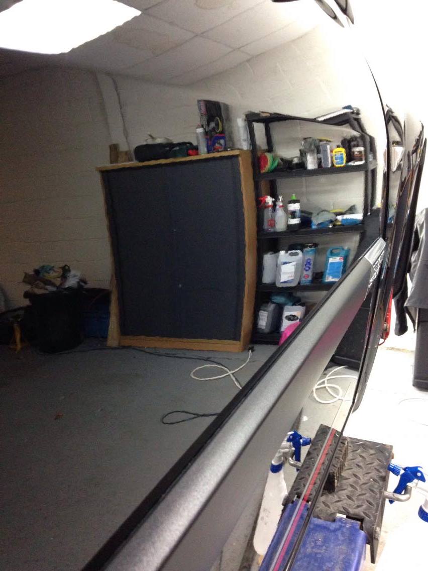

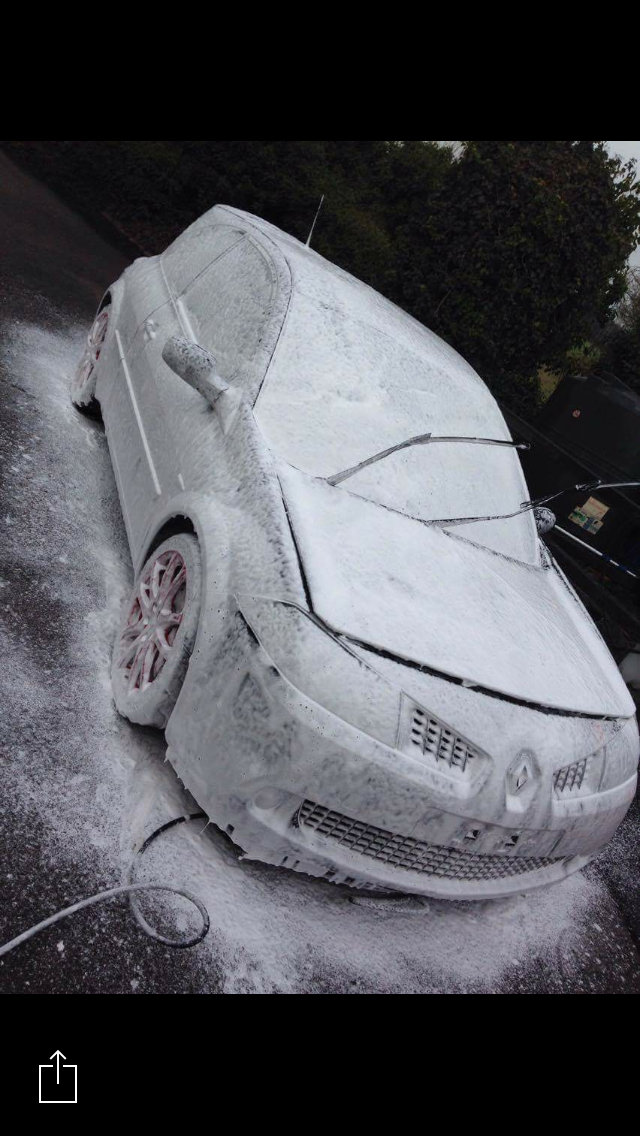

I think it's safe to say it's never been clayed before and perhaps not waxed in a long time....
Test panel

That panel is super shinny. once its done you'll cringe when you drive it in the wet.
I almost think you may buy something else until the weather improves so it stays mint.?
Naughty Boy
Brembo! Brembo! Brembo!
Nah the reason for this work is to protect it from the elimants and only requires washing and drying. I have all the right gear to keep it looking this good but I am not skilled enough to get it to this stage.
  FN2 Type R +MK6 Golf
Ah right well that makes sense, enjoy it.

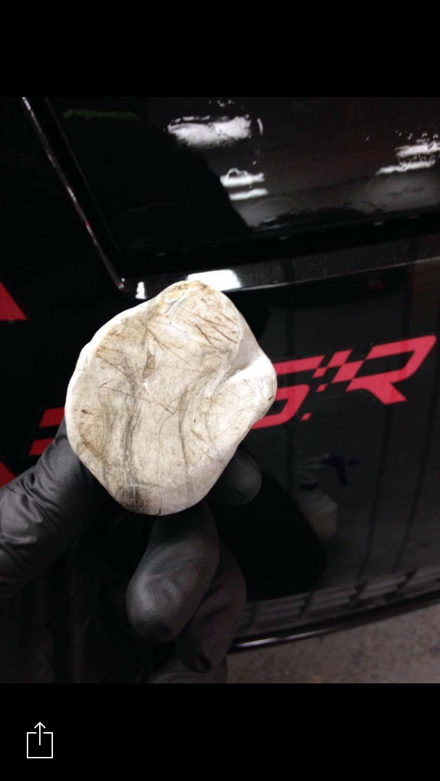

Looks amazing Ant. Detail is cheap for that level of work so well played.
Always make my mind boggle at so called professional detailers removing tar with a clay bar though. @JD .
Scrooge
  E55 AMG
Isn't that kind of inevitable? Removing the tar if you're clay baring it, I mean lol.
Some tar on the car bar is expectable, especially on a black car where you will miss it during the tar x/tardis stage but that's a hell of a lot of tar on that clay so it's clear he hasn't used tar x or he's only done one hit, not wiped the contaminated areas enough and definitely isn't folding the clay enough.
The reason why that is a booboo is because with car paint you want to limit contact time as much as possible so the more you're dragging that s**t over the paint the more damage you're doing therefore the more correction you have to do meaning that you're taking more clearcoat off.
Ultimately it's very small amounts but this is detailing and it's good to be anal.
  Evo 5 RS
Yeah that occurred to me afterward, the fact it's black won't help matters. I have enough sympathy and little enough experience to leave clay baring for when someone I trust can correct the car. Thinking of checking out Nick at SL Restorations prices once I'm happy with the paint.
Gally
They don't get better than Nick.

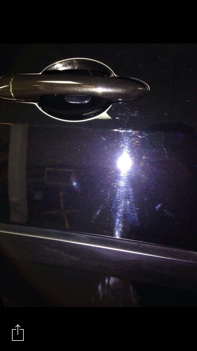

Also you should have zero to very little tar on a clay bar. The deeper the scratches inflicted the more clear removed when polishing. No wonder the before shot looked so bad... it was caused by the detailer!
Naughty Boy
To be fair the paint had very heavy contamination and it had heavy swirling from the off. As long as the end result it what I expect than job done :)
