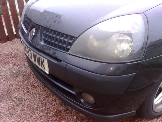

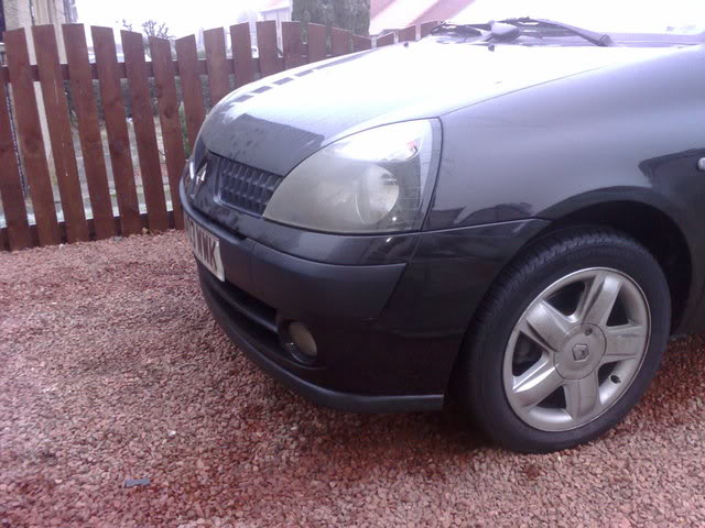

over the past two days in the freezing cold i decided to do some small things to a very dirty little car ;) hope u like.

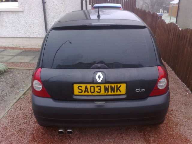

got the grill from renault for 40, the splitter for a fiver from the scrappys and just filled the hole for the wiper with a grommet till i can find a new plastic base without a hole to replace it with.

looks like mine without the splitter and mines gold lol. my rear wiper also looks like a nipple. NICe

looks good. need to de-wiper mine, but i'm gonna wait till the spring when i'll be using the wipers less
i need a meggy splitter as i ripped mine off, they hard to fit?
looks :cool: btw!
nah really easy to fit man :) cut a couple of inches off either end so its close to being the right size but with about an inch spare, then there should be little triangle shape latch things on the underside of the bumper, sit the splitter inside that and screw into the bumper with self tapping screws. i started with the centre then done one side at a time. it would be easier screwing it in yourself and getting a mate to hold it in tight to the body, especially at either end of the bumper, but i managed to do it myself, then i used a stanley knife to chop down the excess, think it would make it smoother and straighter than a hacksaw :)
